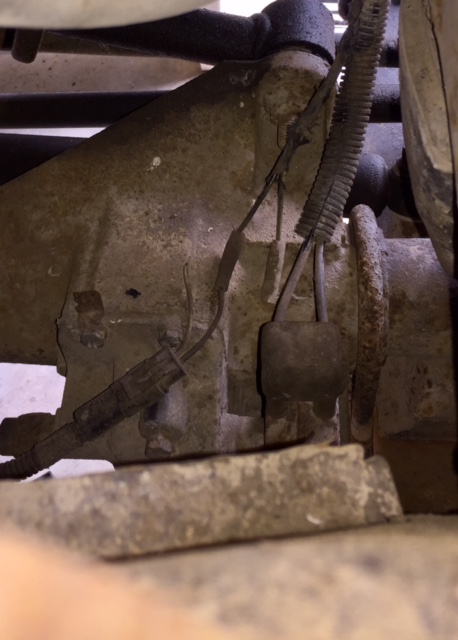

And additionally I found a loose open wire where the 4 wheel drive is engaged. Not sure if this could be one of the culprits?
Thanks again!
And I meant to also say that I purchased a NOID light and computer safe probe so I think I have what I need. Thanks again!
On the first picture post , the casing is clearly split and at the minimum , must have been arcing but what oil,is packed from the factory is long gone . Give it last rites and pitch it .
On the second picture post , that's the front axle shift motor . Won't have any bearing on the no start . When it's up and running , that'll be another project . Doesn't look functional as it sits .

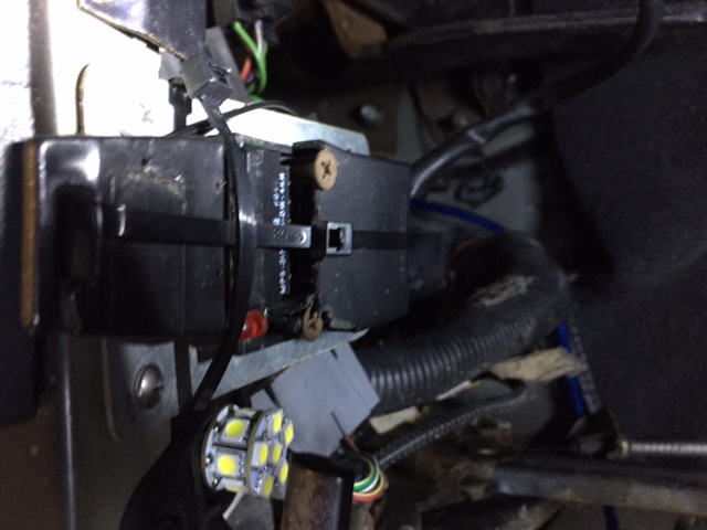

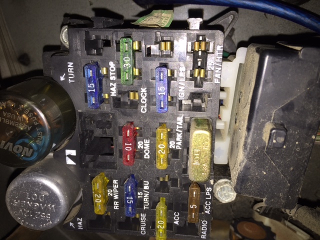

I cannot identify that " module " , I'll call it , or its purpose. I'll have to say it's an add - on since its zip tied and fastened with sheet metal screws . Can't find it on a FSM ( factory service manual ) . Curiously , we would be interested where it's wiring goes and connects . Ok , a oil pressure sending unit switch was replaced due to a major leak ( typical) and trashed the distributor ? That being replaced , the engine ran afterwards .

Before this however , please check and verify all fuses , under the hood and under the dash.
The ignition fuse under the dash ishould be checked . Don't remember was that for the cranking circuit , which works . Good to check ( ignition switch in ON position ) fuses on both terminals to ensure connectivity of voltage flowing from supply and into the circuit . Of one side reads good and other side dosen't , that will have to be investigated . I believe you already have a problem on the blower motor circuit , previously posted .

that looks like some kind of alarm. I don't remember anything like that on either of the yjs the wife and I had. that could be your trouble.
Trace the wires to the module. Could it be a remote starter? Being cracked it may be damaged causing the no start issue.
