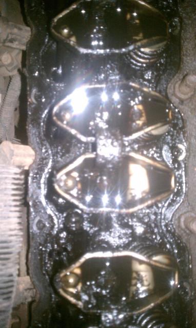

My old 4.0 with 480,000 kms.

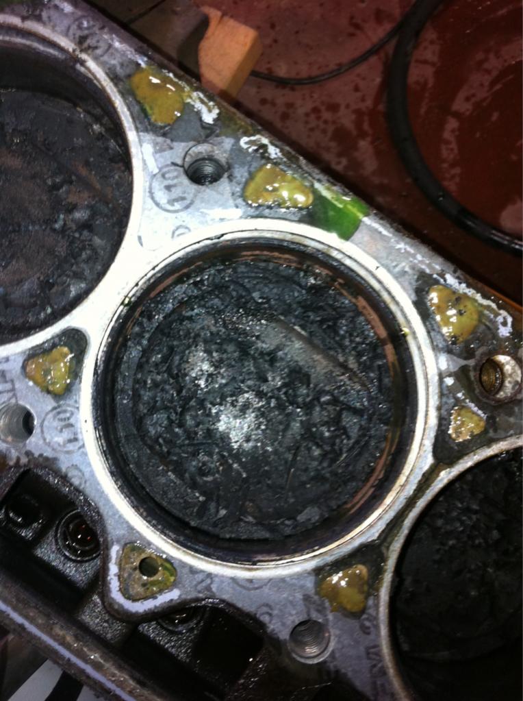

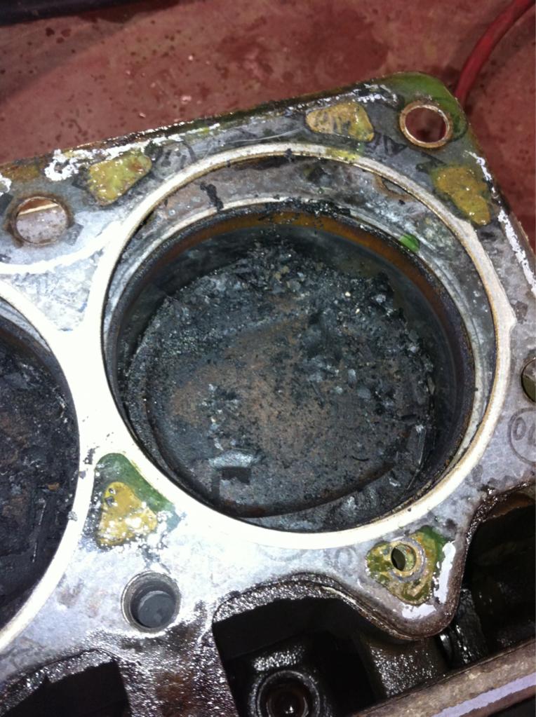

Im gunna build a stroker to store away. There is very little taper and will clean up nicely with a .030 bore.

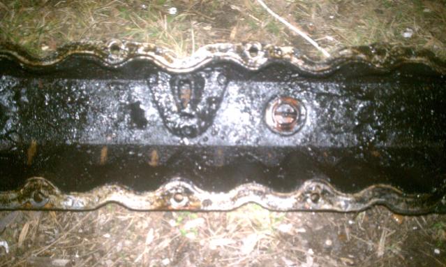

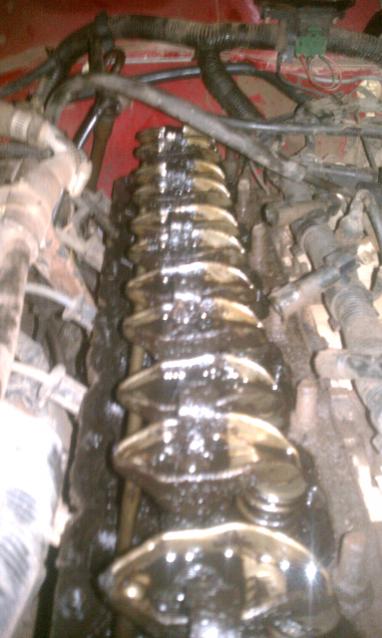

I pulled my valve cover off to replace my valve cover gasket and I stumbled upon this... would a good clean from above along with a good clean from underneath and then run some seafoam be enough to clean this up or is there a bigger problem I should look into? I really can't afford to rebuild right now so any feed back would be appreciated

I wouldnt try to flush it. Thats pretty bad. Flush that and you risk hzving bigger particles break away and plug something. Keep clean oil in her and hope for the best.
