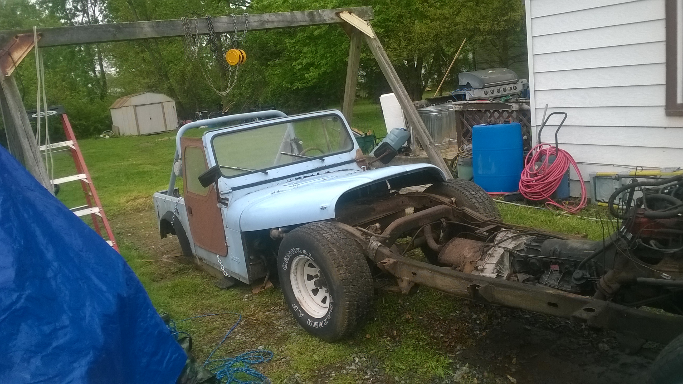

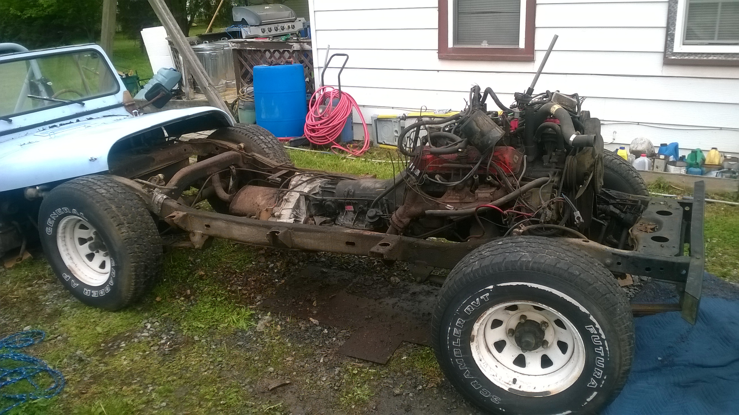

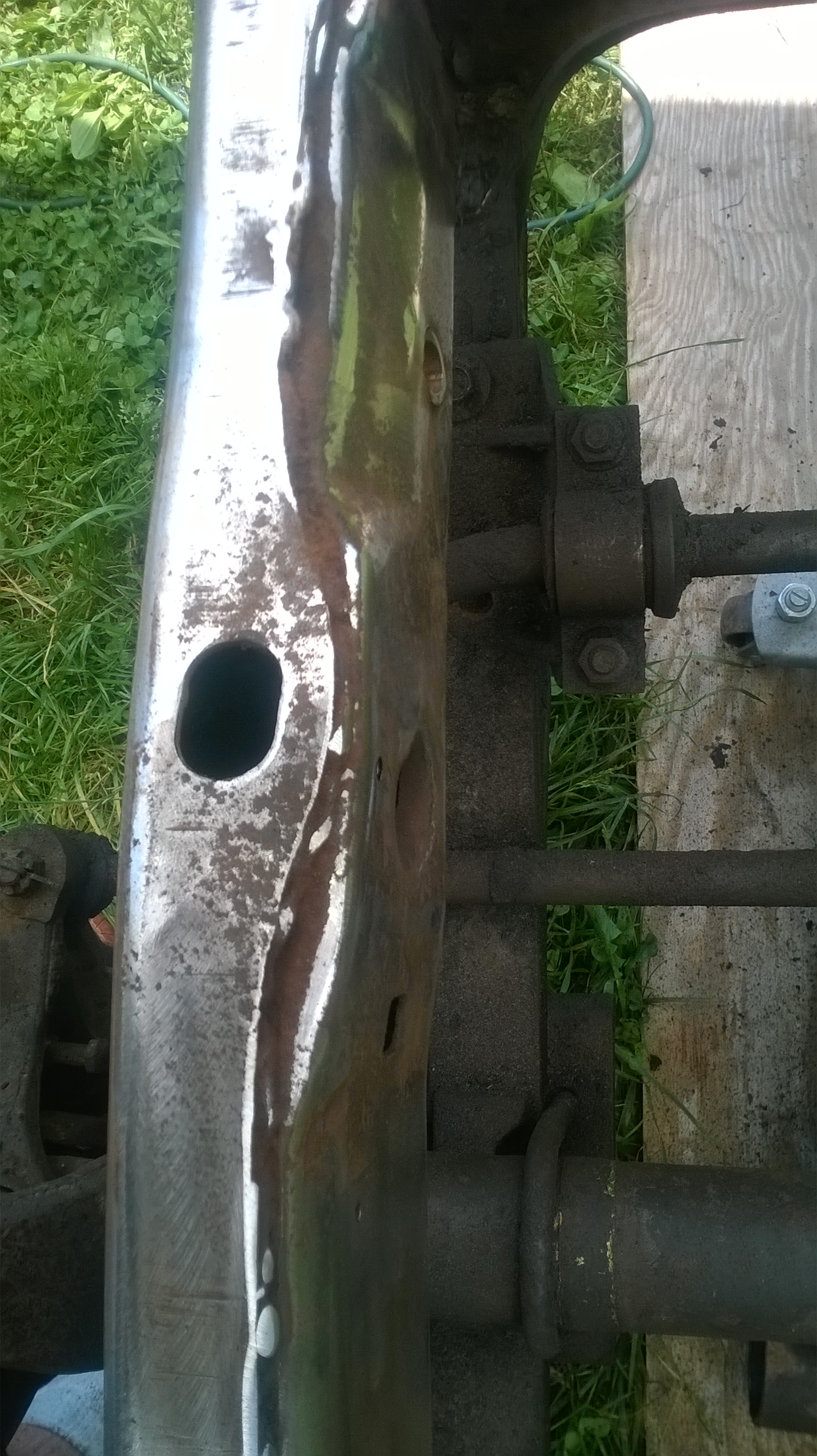

today i finished pulling the body off the frame of my 1979 jeep cj7. I have a tub from a 83-84 cj7 i am thinking of replacing it with. Mine had a lot of rust repair needed. everything on this jeep is original. it appears the quadra trac was rebuilt because the case has orange form-a-gasket on it. dana 30 in the front with 3.54 gears according to plate and build data stamp on tube. Rear have not i.d'ed yet, trans is hydromatic th400 auto. Have to cut and replace the body mount blocks off the frame as they are all beat.. found a complete set at quadratec for $100. ( sorry if i am not suppose to mention companies in posts) gonna pick those up this week.. the trans had three vacuum tube that weren't hooked up but the hard pips were there. figure that went to the vacuum system for the passing gear and to change the gears.

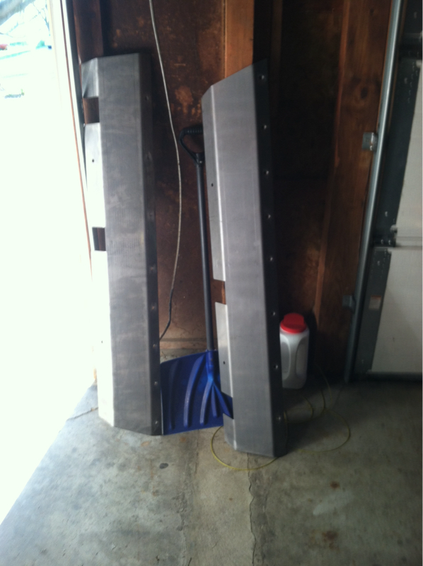

Just got my boat sides, installing them tomorrow.

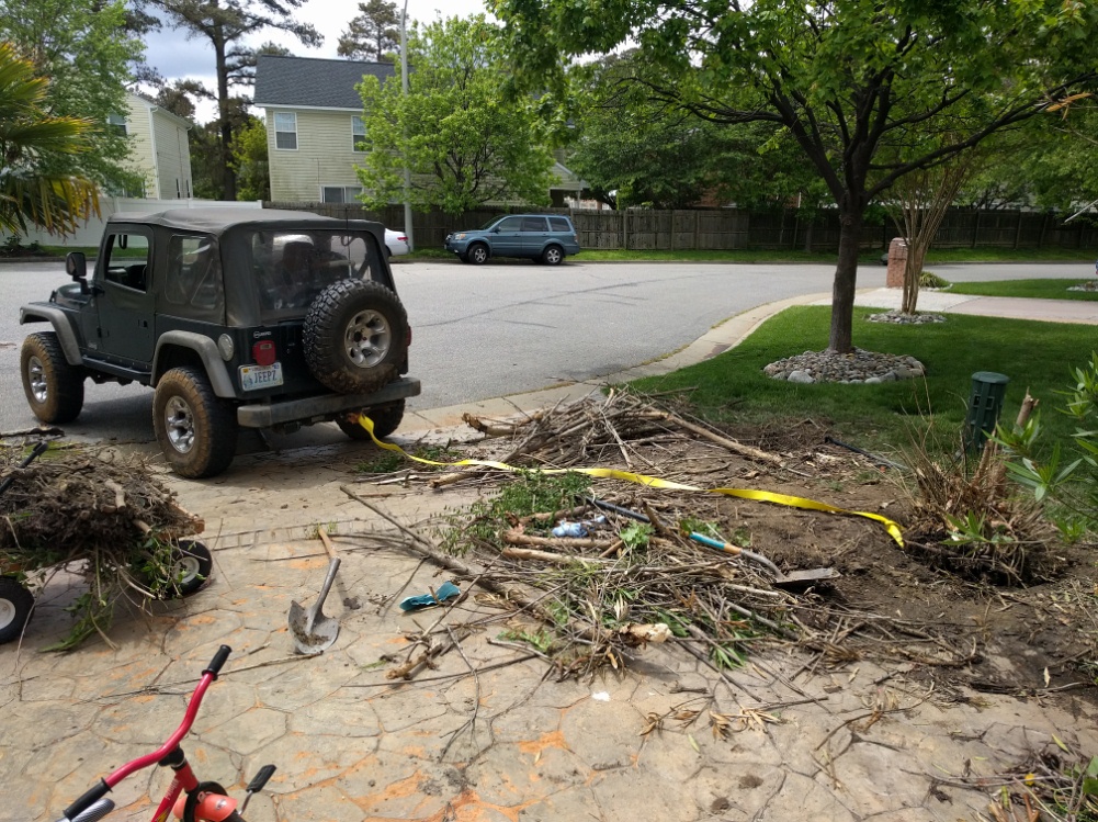

I did a little gardening with the Jeep. I had to drop it in 4 low, but that bush finally relented.

Terry, id you yank bushes a lot make a choke piece out of steel cable (loop on one end hook on the other) OR use a small link high strength chain, the cable just loops once and goes through its one eye loop and hooks to the vehicle, the chain comes back from the vehicle wraps twice then comes around the standing length from the vehicle once and hooks back on itself making a self tightening loop. These don't give as much as the tow strap, and pull the bush bundle in tight on itself, making it easier to bull them as one bundle without cutting them down first, If they stop the jeep add the tow strap in between them and the Jeep for the stretch and snap multiplier effect. A trick I learned as a young man doing landscaping during the summers

Thanks for the tip Dragon. I'm not a fan of gardening, so hopefully that's the first and last time I'll be pulling plants.

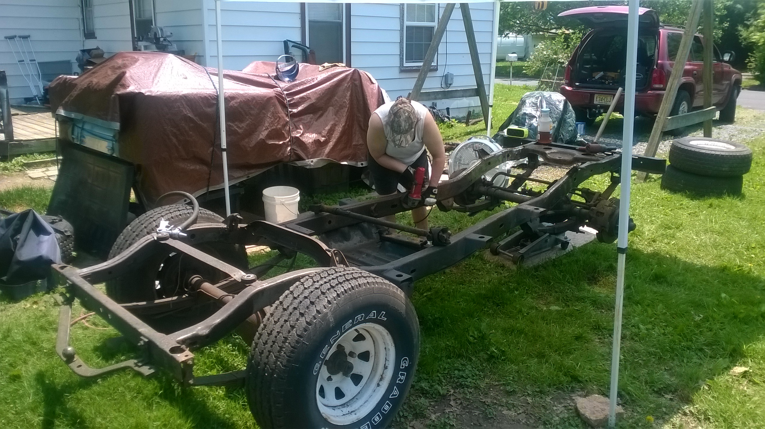

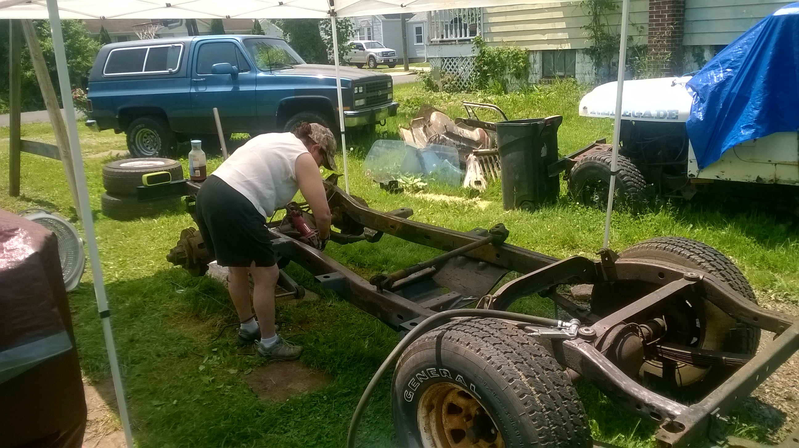

so today Wife and I finished wire wheeling and flapper wheel sanding the entire frame. removed the axles from the frame and have the frame up on saw horses. We ordered this product called rust seal from KBS. got a kit that comes with wash , metal prep, and sealer. Works like por 15 they say, i'll let you know. Started to disassemble engine to check it out and see if i really need to rebuild it or just freshen up. Pulled upper intake and found lots or crud under area where the push rods come down through. I was thinking of pressure washing crap out of push rod intake area but not sure if it will hurt engine or not. I will probably be pulling heads too so I can check out pistons and lower bearings. Got the original paint color amc blue for the engine also to paint engine with once it's all cleaned up. Can't wait till this is all done... this is for the wife and she has yet to pick a color.... she likes 4 different ones.... tangerine twist, lapis blue, root-beer and and cinder red. Have to return the rear floor pans I got from classic to current fabrication as they do not have the same contour in the rear foot well area. the new outboard supports I bought matched exactly but the pans were like 3/8 inch short from touching them. can't have that flex in floor area so I'll be ordering some new ones from quadratec soon. They say they are identical to original we'll see.
