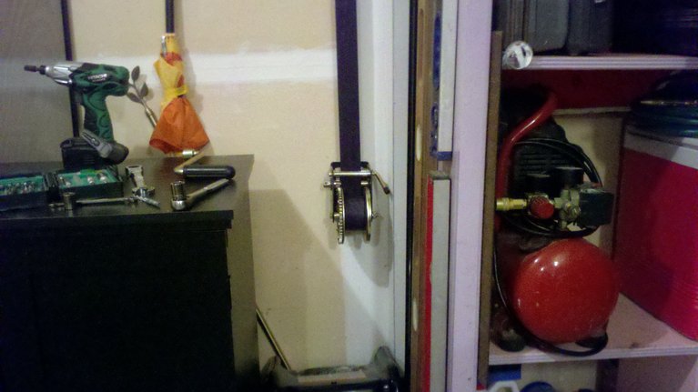

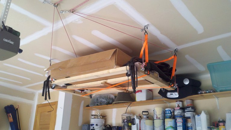

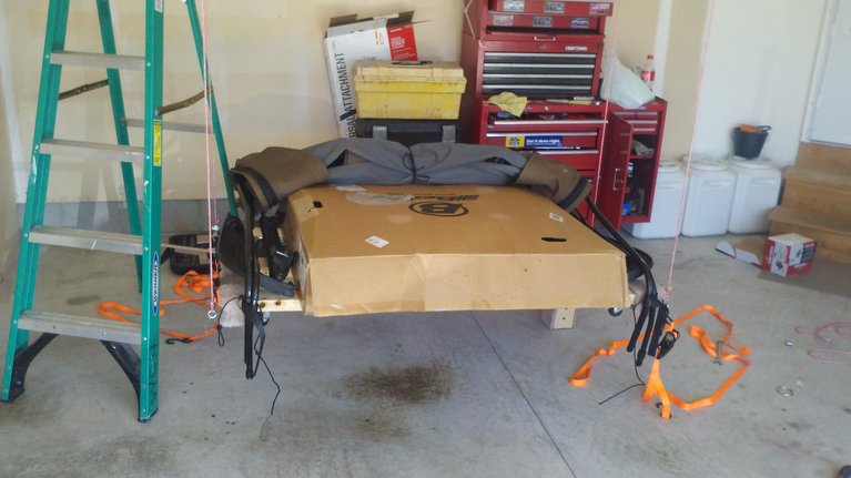

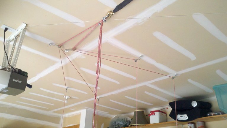

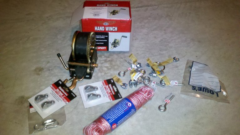

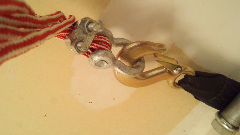

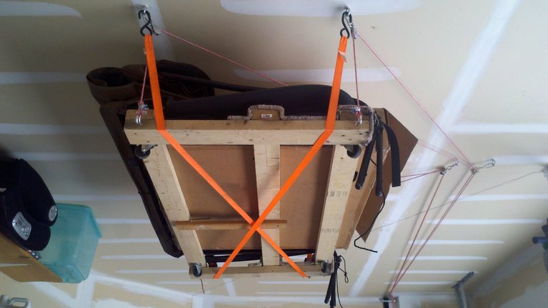

Finished up my Top Hoist :D
I bought a hand winch and rope from HF and various pulleys ,eye hooks, cable clamps and quick chain links from Lowes
Installed the winch on the wall
Put 2 eye hooks with a piece of galvanized pipe between them as a "pulley'' to get me around the corner of the wall to ceiling
Then put the 6 eye hooks and pulleys on the ceiling(making sure to hit a floor joist) also put the 4 eye hooks on the platform that used to be the hardtop dolly. i also ran the rope through every pulley.
I used a small D rind to transition from the rope to the winch hook.
Last i put my summer windows and soft top on the platform and raised it to the ceiling, I put 2 ratchet straps on to keep it up in case something fails.
