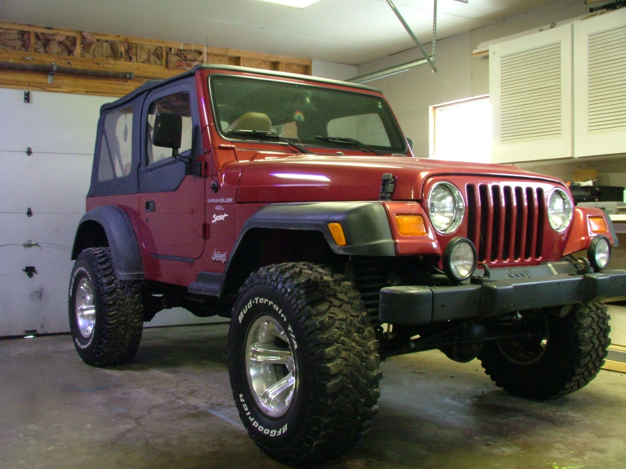

15 x 10's with a 4 inch backspace are perfect, then you won't need wheel spacers. These are American Racing Tailgunners 15x10 w/ 4in backspace with 33x12.50's.

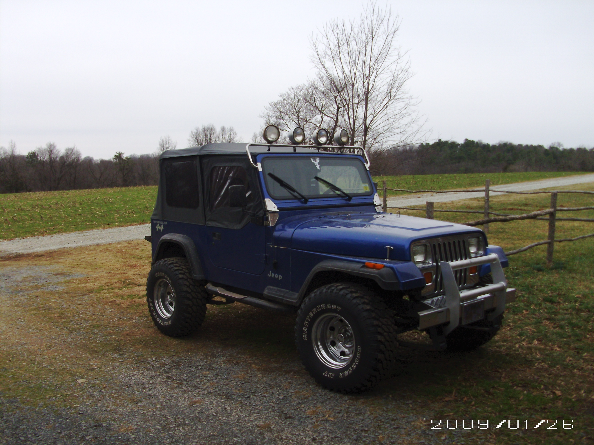

I agree with cam. I have 33 x 12.50 BFG m/t's mounted on 10" rim & it is a perfect fit.
