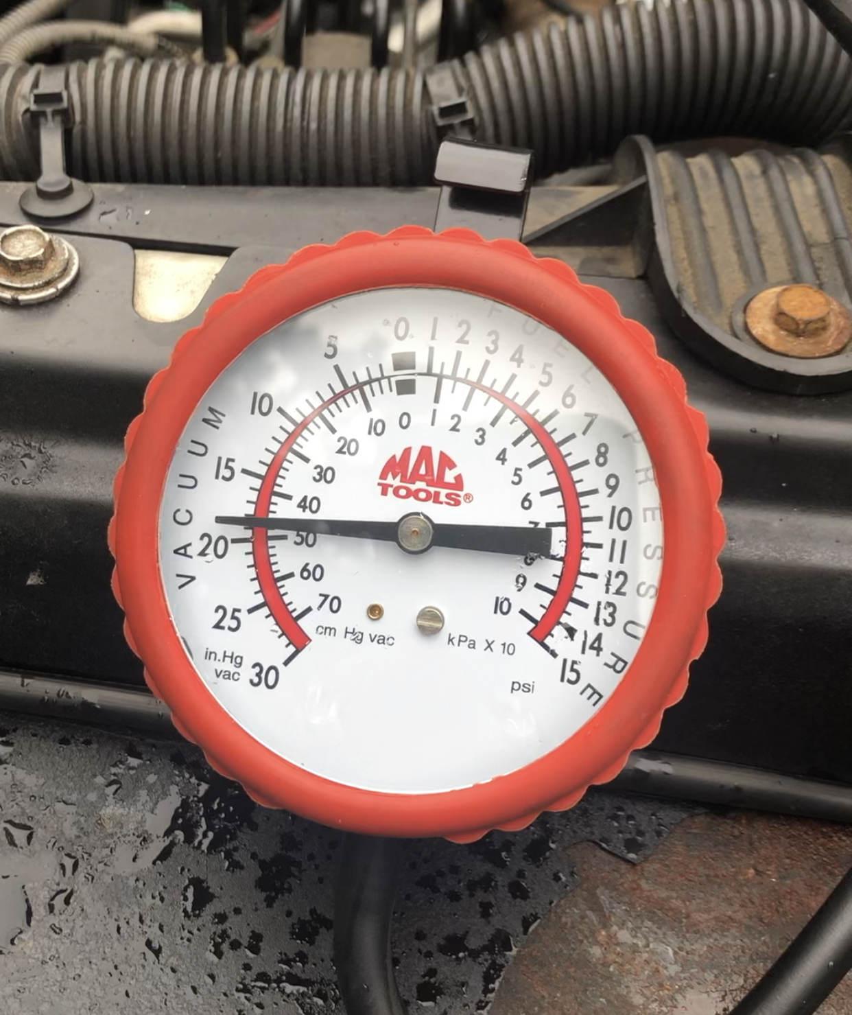

Ok so the mechanic that did my engine lent me his vacuum tester and I took some video but I can not upload it here so I got a still of where the gauge was sitting at an idle around 750 - 800 rpm’s. This seems to be in the normal range from what I have read. Unless I’m reading it wrong.

that is acceptable vacuum.

I figured that was an acceptable vacuum just wanted another pair of eyes to tell me so.
Vac looks ok. What changed you said you idled at or above 1k rpm?

I guess when it was idling at 1000 I wasn’t giving it time to warm up. After it warms up the ide drops to the correct rpm’s (around 750-800).
