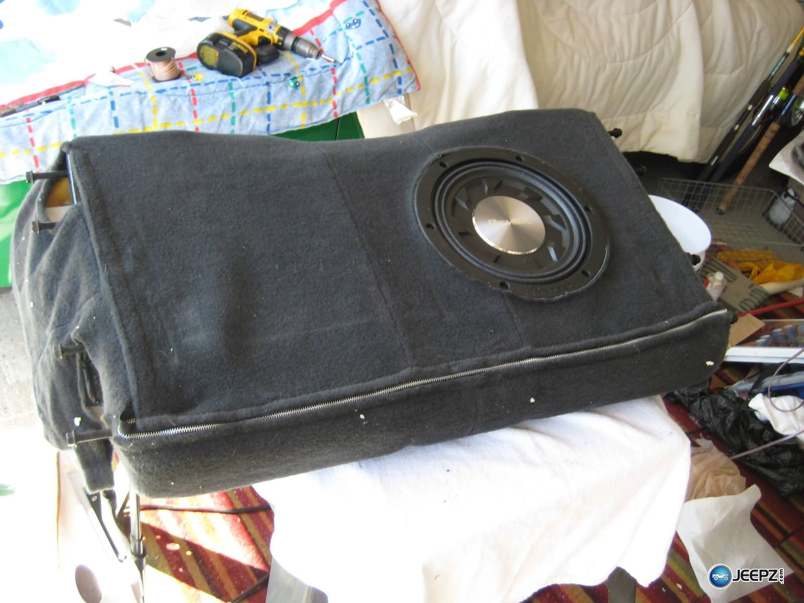

Cut a hole
You really don't want anything making contact with your subwoofer while it's moving, so I cut a hole in the carpet under the jeep seat to accommodate it.

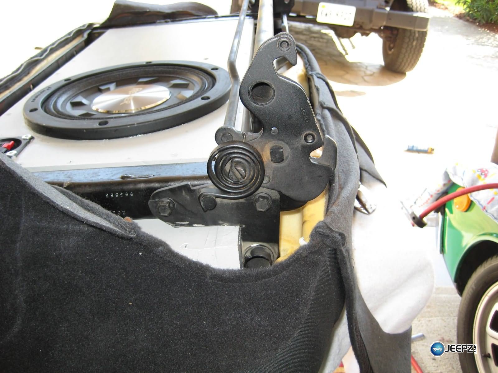

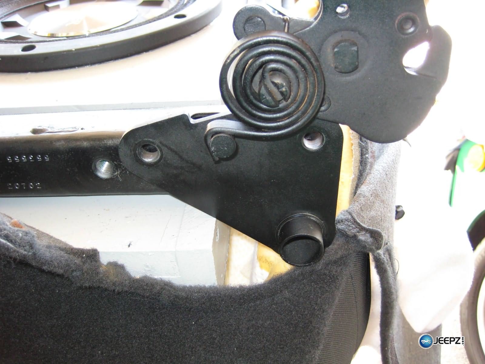

Notching the bar
Now, before you can zip the seat up, you have to use your grinder once again. This time you'll be cutting the bar that attaches the seat to the floor. You can see in the first photo how the new box keeps the bar from attaching correctly. Just cutout the section you see in the second photo.

hey man that is awesome i have never seen it down that way. does it only work with shallow mount subs i have a 12 with about a 6.5" mounting depth. how much room was under there. o and where do you have ur amp located. later
You have to have a shallow mount sub. I only had about 0.5 inches to spare with my shallow mount 10.

You could to 2 10's, or even 3 8's in this box. You'd be hard pressed to put a 12 in though - unless you made it deeper.
I'm a pretty bad woodworker - this was probably the first serious project I had ever done, so I guess I put 10 - 15 hours into it (just a guess). The box was cheap - just to large pieces of MDF, glue, screws, and the like - probably under $100.
