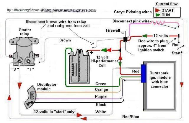

Was studying the diagram you posted , can't say what vehicle it was intended for , but its contributor , mustangsteve , leads me to believe its for a ford mustang ? AMC did as you may know model some of their cars , trucks , etc. using ford parts or design . Chrysler and GM were used , but for later year CJ's , ford parts and design were common. I once owned a '78 jeep cherokee with a 360 , same engine as a 304 , just smaller displacement, that's all. Haven't had that truck since the early '90's , so I had to reacquaint myself quickly to help .
Anyway , this diagram shows a brown wire which apparently goes to the ignition switch . I really do not know what the contributor is illustrating , modification I think , but that is why we need the manual to precisely wire your jeep . We'll get you there . Good job brother ! Greg92jeepxj

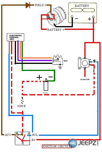

yeah i think the diagram says its from a mustang also i did use your battery circuitry for those others trying to hardwire their own ignition system. these two illustrations seem to work good together
