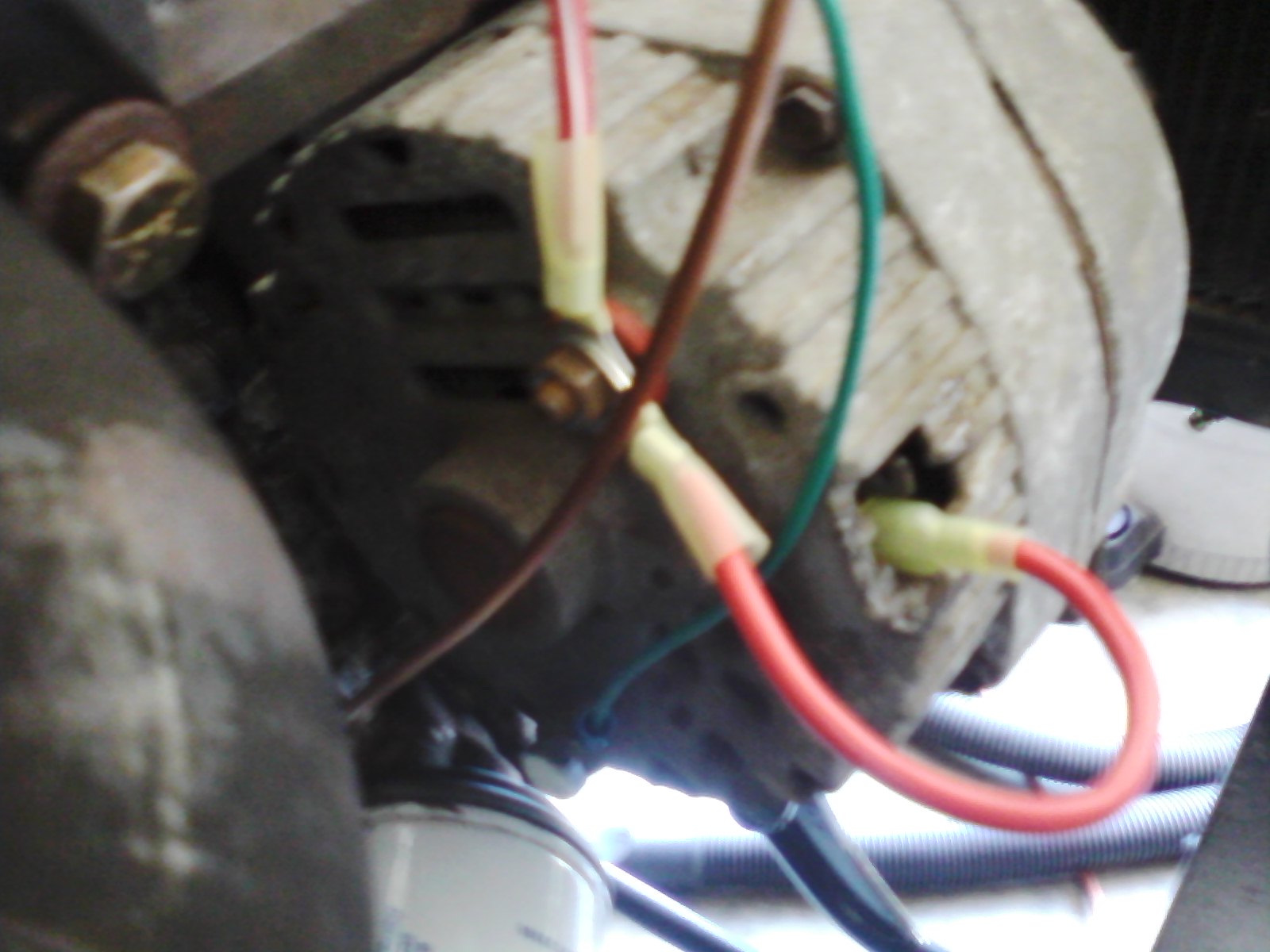

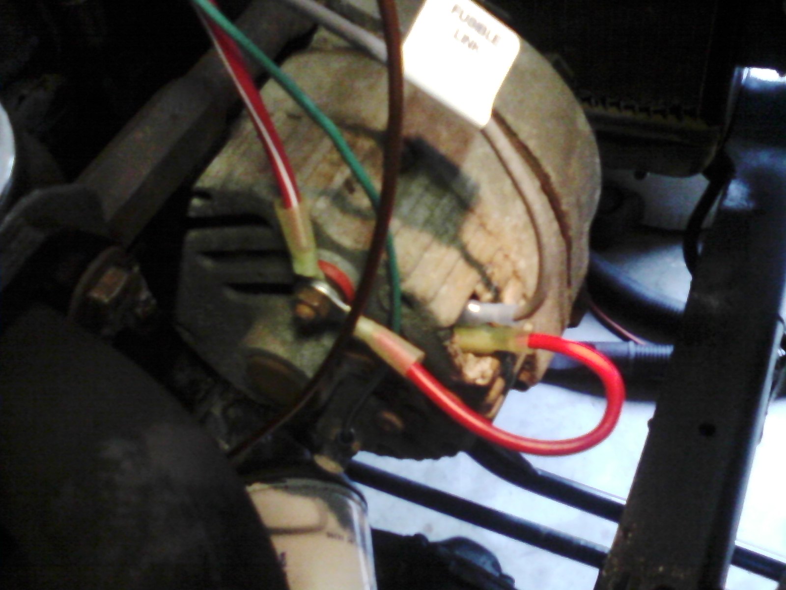

i installed new starter, solenoid, starter cable. and ignition switch
still fried my starter

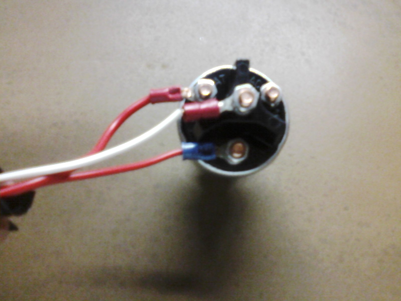

enclosed is a pic of how i wired my ignition and a pic of my ignition switch and alternator
upon some research I've found that i don't need the exciter or grey wire off number "1" terminal on alternator i had this spliced into the battery wire at ignition switch or battery pole on the ignition switch (its also important to know that at one point i had this incorrectly spliced into the ignition wire at ignition switch on the ignition pole) but ill be getting rid of this altogether
could it be that i have a bad ignition module

Was looking at last weeks thread , starting to get confused . Correct me if I'm wrong , but it looks like you have a 14 ga. wire to give battery power to ign. switch , a white wire to crank solenoid , and a red 16 ga. I terminal red wire to feed ign. ? If I am looking at the pictures right , I think you got two power sources to your ign. switch ?
Big ga. Red wire from load post to battery terminal on key , small ga. red from I terminal of solenoid ign. Terminal on key , and white wire to S terminal on solenoid . I cannot find where key is energizing ign. module . The diagram helps , but I cannot see all of the ign. , run and start circuit versus the diagram . I do not see a yellow wire on your alternator . What is the green wire for ? A ground ? There is a green wire in the harness to solinoid . That looks like a GM DELCO alternator , the two top wires should go , one to dash light and one to BAT. Terminal to excite the voltage regulator. Where does the fusible link wire go ? I do not see a problem with the cables . Still confused . Cannot yet determine why starter burning up .
Dont the starter only get 12volts when key is turned to start position, and when the key is in the run position there should be no volts to starter (only start position)????. If starter gets constant 12volts while in run position, wouldnt that burn it up???? If so, then I would look at your connections at the starter, and ignition switch. If I remember correctly, that s the way it is on my jeep, I get no volts to starter untill I turn the key all the way to start position, then when I let go of key (engine started) there is no volts to starter at the small terminals of solenoid.
Yes , I agree , the starter should only get 12V when key is in START , that would be the only time the two studs would be connected electrically by the internal coil of the solenoid . That question was raised , but was the test conducted ? It should only be a matter of looking for voltage on the stud going to the starter cable with IGN. on. If voltage is read , and key NOT in START , that should be a defective internal coil in the solenoid ? But I am wondering , coils being magnetic like in a relay , is there a field energizing this coil , even to a minimum of kilovoltage that is causing heat , burning up starter ? Of course we want the wiring verified correct connections , but ultimately we do need to know is voltage present at stud where cable goes to starter when key is NOT held in start ? Yes , I agree . If 69jeepcj feels wiring is correct and agrees with his jeep , since wiring from one model year to another due to different ign. modules , then we must be certain voltage is only present where it needs to be and when . My only question now is has any wiring been changed from original , not just replaced , but has a change in ign. systems been made warranting rewiring harness for that purpose ? Is ign. , distributor , alternator , etc. stock? I am still worried however if TWO LIVE wires are connected to solenoid top posts inputting to internal coil causing coil to remain energized AFTER key is released from START ? Is coil defective ? Are connections wrong ? We cannot leave no stone unturned . All will have to be checked since this problem still exists after parts replace .

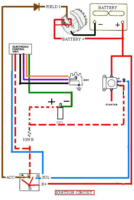

i took a pick of an illustration of my complete wiring job

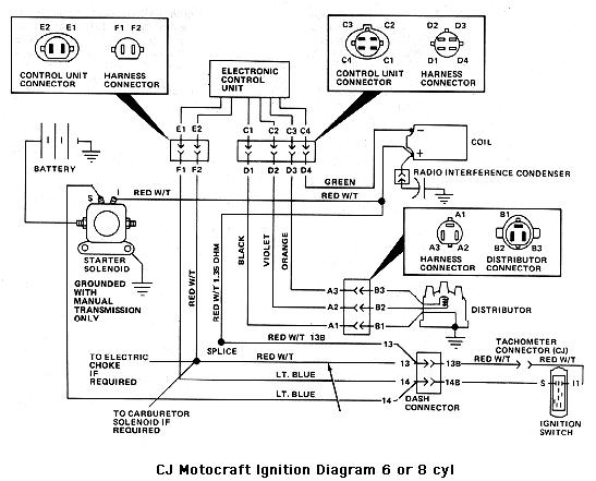

Looking at the last pic you posted. It really looks correct to me, "except" you have the aux from the ignition switch going to your soleniod with a 30 amp fuse. The AUX is for things like your radio, cig lighter and things like that, it doesnt go to the soleniod, that may be your second 12 volt source to the starter as it supplys constant 12 volt source to your accessories, we dont want that going to starter. As greg mentioned, that green ground wire at the alt is puzzleing to me as well. I cant compare your wireing to mine as the PO rewired the whole jeep and I think he just used what ever color wire he had laying around, There is red for grounds and all sorts of stuff, I would have to trace each one to see where it go,s and I have points, (no module which has more wiring).
yeah, I'm pulling the green ground alt wire
and ill pull the batt/sol 30 amp circuit
have yet to hit it with the volt meter
will follow up
ok pulled the red 30amp circuit out now i have nothing
my question is where does the ignition switch get its power source to direct to either the
ignition or the starter
should i pull 12v's from the positive pole on the battery(not the solenoid) and connect to the ignition pole on the ignition switch (along with the ignition circuit already on that pole) . would that not power up the ignition circuit when the key is turned on to the ignition mode then power the start pole when i roll the key on to the spring loaded start position

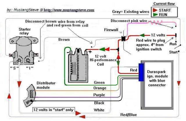

Sorry to miss your post , I am trying to keep up with your progress so that every day is a day of progress toward completion . It literally gets confusing when we read different color codes on the dura spark ignition module . I am hoping to see the mailman deliver my original reprint of the 1980 AMC jeep shop manual soonest as I need to verify if that module on your jeep is correct . Although that would not cause the starter to burn out as they have been , I want to be certain that the module absolutely matches the system your jeep requires. I have never seen these modules drastically different , not to say you can use any one on any engine , computer controlled engines may have a difference , but lets not throw that in the works as that is not the case here. I just insist on being able to say what is right and what isn't since we are not willing to just burn up more starters and damage wiring harness through trial and error.
Agreed , it should not be this tough , but it seems we have a unique problem , a modification may be at fault. I say this because there is a dash mounted ign. switch when there is supposed to be a column mounted switch . Not certain that plays a part , I don't think there is any different resistance value to contend with there, but we cannot leave no stone unturned . I've never seen starters burn up like this . Only once did I see a defective solenoid crank a starter when the B+ connection made. All connections were verified too. A new solenoid to replace the "new" solenoid fixed it. While this is not happening to your jeep , something is causing starters to overheat.
If no voltage is read with ign. on at the cable from solenoid stud to starter , key not in crank and ign. on , then Lets be sure the rest of the jeeps wiring harness is correct to rule out incorrect current route. The moment I get that manual , since I cannot trust anything else I get my hands on , I will study from column to coil to starter what is supposed to be versus what we got .
i intend to copy and send you personally all pages concerning your jeep's under hood and dash wiring to help,you get it right . Every electronic ign. I see , seems to be similar , but I want the wiring diagram a 1980 CJ 304 CID is supposed to have . We are correcting what someone did prior to,your purchase of your jeep are are faced with putting it back together. I could say why not just get a harness from Painless wiring , but I would not tell someone to spend that kind of money when it may not be necessary . I'm sure that with parts from the other jeep , there is no reason why a proper harness cannot be made. Even if wires must be individually put together as you have been doing , the end goal is to have a complete and correct harness. Only the book will tell us that . That being done , we can isolate errors more efficiently , if the problem does not magically fix itself. Stranger things do happen. I rewired a friends '92 olds delta 88 under the hood using spare harness for a donor car ( a '92) and we finally got it started after months of try try again , research and pulling our hair out . It's got to be right , or it won't go. We have one thing on our side , you don't have to deal with a PCM , just a solid state ignition system.
Your post shows a diagram that is basically similar , but I only got that car started by following the book . WE CHECKED EVERYTHING that was of relevance and concern. No wonder no station or diagnostic wanted the job . With the book , we must get this beat. If asked why I am so adamant regarding this jeep , it is likely I may have to deal with this someday if I land a CJ5 of my own. What greater way to get a start than here ? If I found one not running for a good price , I will be in the same place as you . That is why the determination. This is not my first no start , I have learned that not all are basic , but unique. We will prevail . Greg92jeepxj

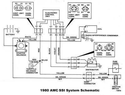

Found these diagrams , see if they compare to your existing wiring harness until I get the manual.

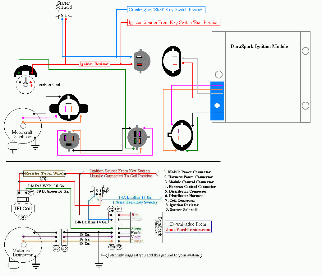

this illustration seems to be working
no volts to the starter
this one also had no wiring to the "i" pole on the solenoid
Your most welcome , and we would really like to see you get your jeep running too . Nothing more worse than looking at your jeep , probably the one you always wanted and you can't even drive it. Trying to remember , but , I think you put a starter in after the first one burned up ? Now I don't remember if that starter is ok , or not ? If it is , an old trick we used to do when a solenoid went bad , connect the two large studs , which bypasses the internal coil and cranks the starter . It is best to use a remote starter switch for safety and good connection . If you don't have one you can use a jumper wire , but this is battery voltage so you want good gauge wire . A jumper cable will work. To prevent electrical damage to ignition switch and ignition module , disconnect both wires from the small terminals when doing this . Connect one alligator clamp to the battery side stud firmly and touch the opposite side momentarily. You just want to see the starter spin to confirm the starter is good. Be careful , you will see sparks. This is why I really suggest you have a remote starter switch . I would not blame you if you do not feel comfortable doing this . The only safe way is the remote switch . They are not expensive , but if you can borrow one or maybe autozone can rent one ? I would not want you to jeopardize any more electrical than already has . But we do need to know is the starter working. If it is we have something to work with . I really hope it is. It is best to test in the vehicle as I keep hearing parts store bench tests unreliable. Starter should be checked under load . Forgot to ask , but did you try to connect a voltmeter set to read battery voltage on the solenoid (S) stud and the starter stud cable ? You can just clip the small alligator clips of the meter to the terminals and have someone crank starter while you read the meter. You should read 12 volts as key is in START position. If not , solenoid dead.
please be careful in all electrical tests as we do not want further damage , especially that you got a replacement ignition module. Also , with ignition in RUN or ON position , with a test light or volt meter , look for 12 volts on the ignition coil + side. That is where electricity will go when you turn the key to ON or RUN . You should see 12 volts with ignition on , not cranking starter.
If you manage to get the starter to crank reliably , like normally should and engine won't fire (run) , look for voltage on the ignition coil - (negative) side to distributor while cranking.

i do have a 4 pole solenoid but this wiring doesn't have me running anything to the "i" pole as did the others
