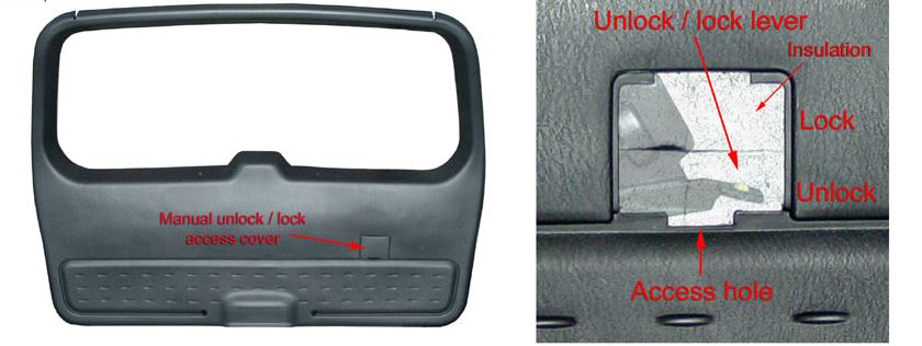

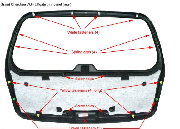

Climb into back remove a small cover photo #2 in tailgate trim panel photo #1 shows where it is.
3 & 4 show the lever you will move upor down

Thats good info K-2 Thanks. The wiper works but I cant hear the sound of the electric lock moving. I was wondering what that cover plate was and now I know. This weekend I will open the hatch by using that release lever and inspect the locking assy and fuse #8. Hopefully it just needs some spray grease or good ol wd-40 to fix it.

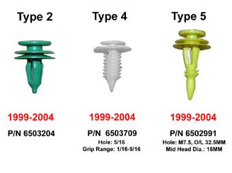

suggestion get 4 each - NAPA an cross reference P/N
