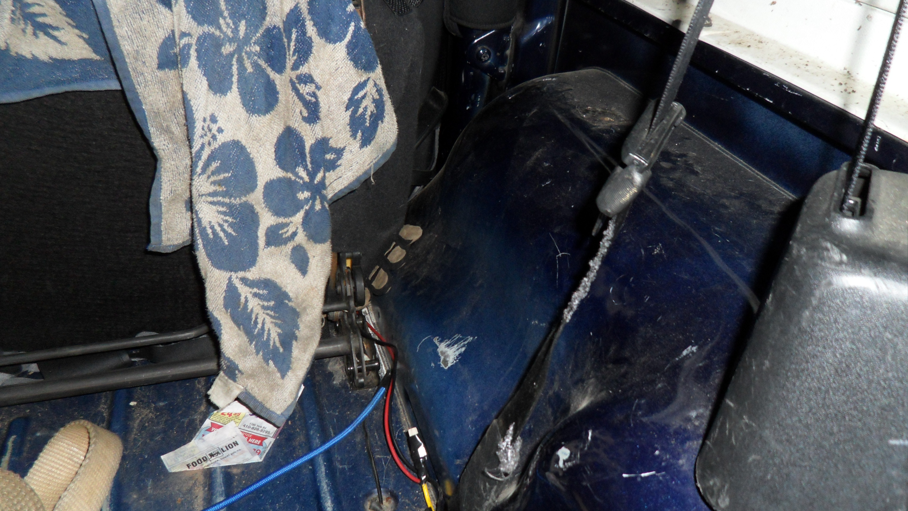

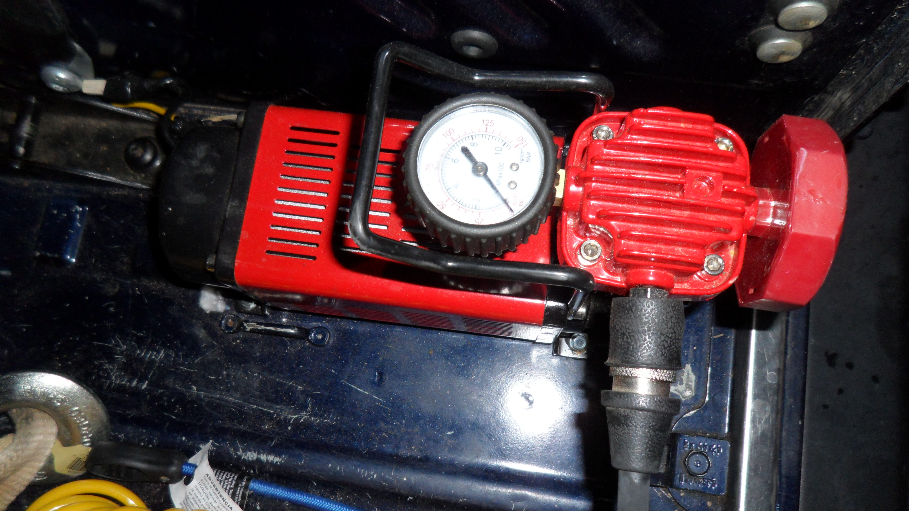

The SuperFlow MV50 is not intended to be hard mounted. It comes with a carrying bag, a coiled up hose that is roughly 20' long (guesstimating here) when stretched out, and a cord with an inline fuse and 2 alligator clips to hook it up to a car battery.
If you like you could just throw it in your Jeep and hook it up when needed. I however wanted to hard mount it so a) I wouldn't forget to bring it with me when I needed it and b) it wouldn't be rattling around the back of the Jeep.
The compressor comes with four little rubber feet to keep it from sliding around while it runs. I popped the rubber feet out and used 4 self tapping screws to mount it to the rear of the Jeep, making sure there was enough clearance for the back seat when needed.

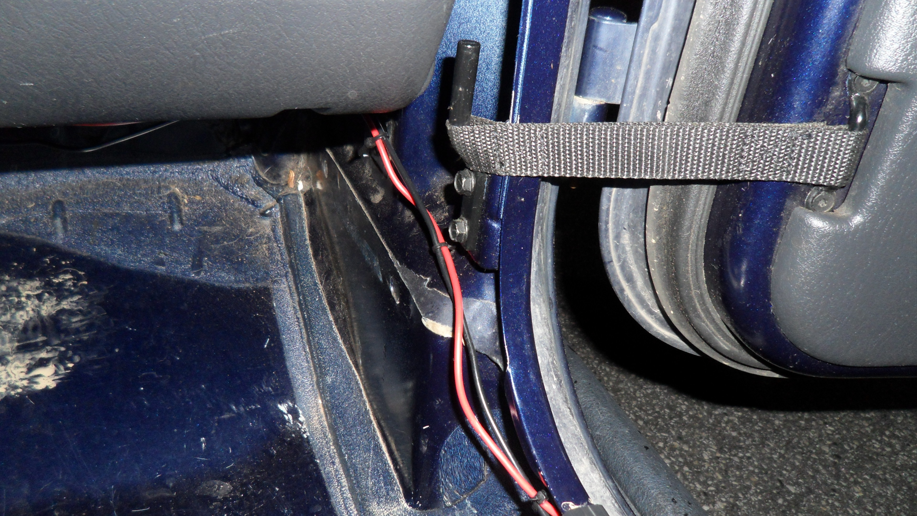

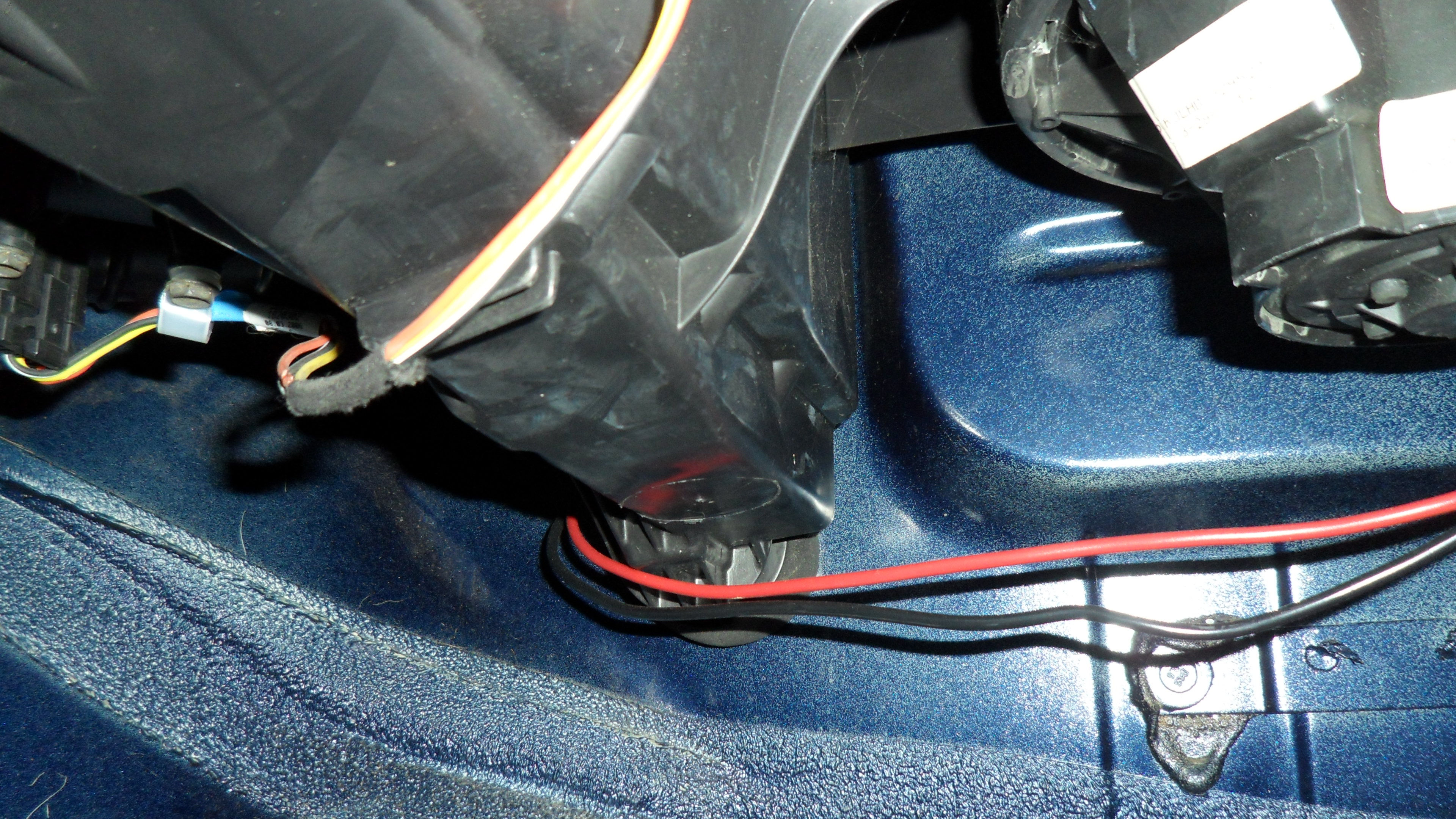

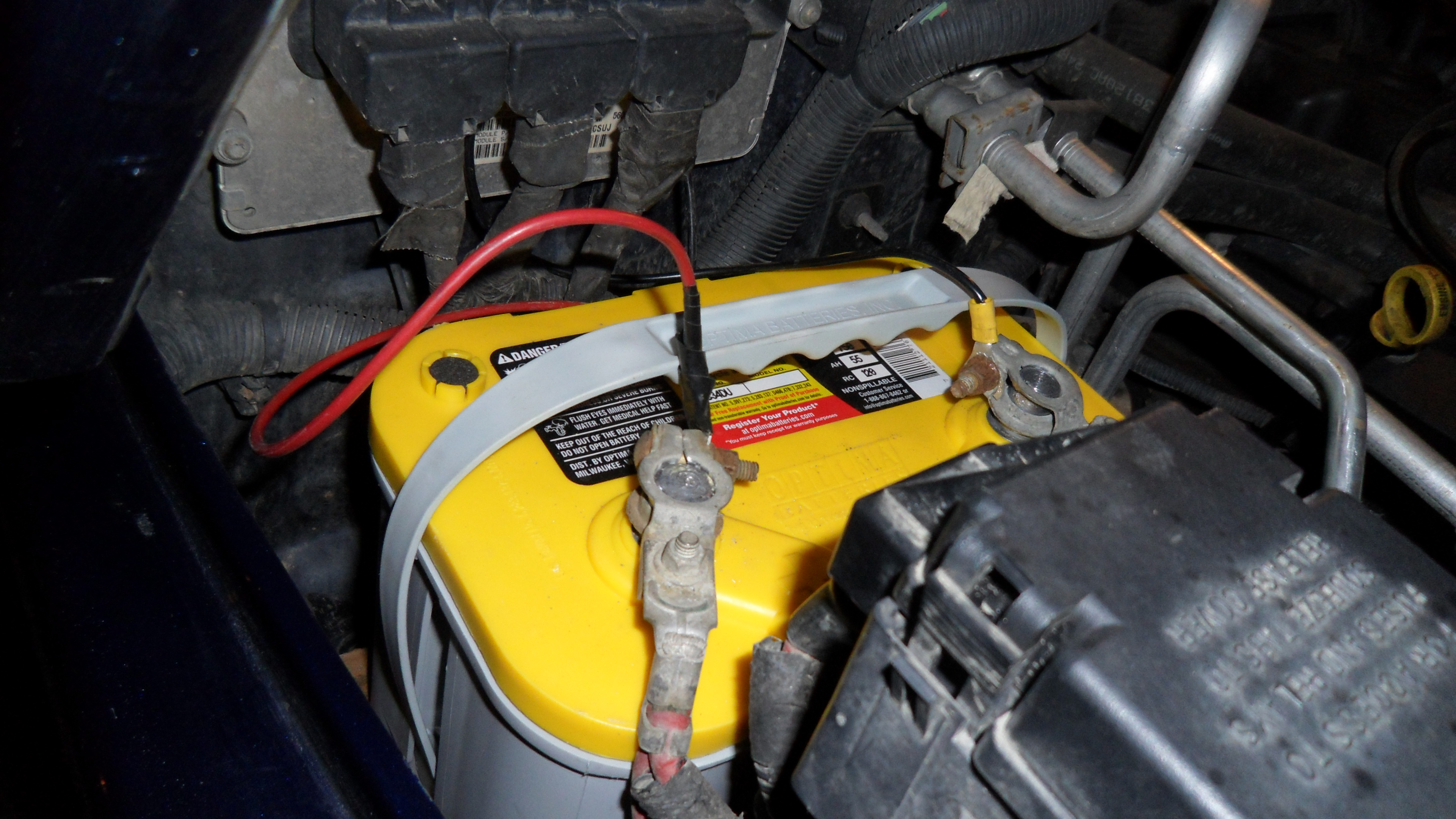

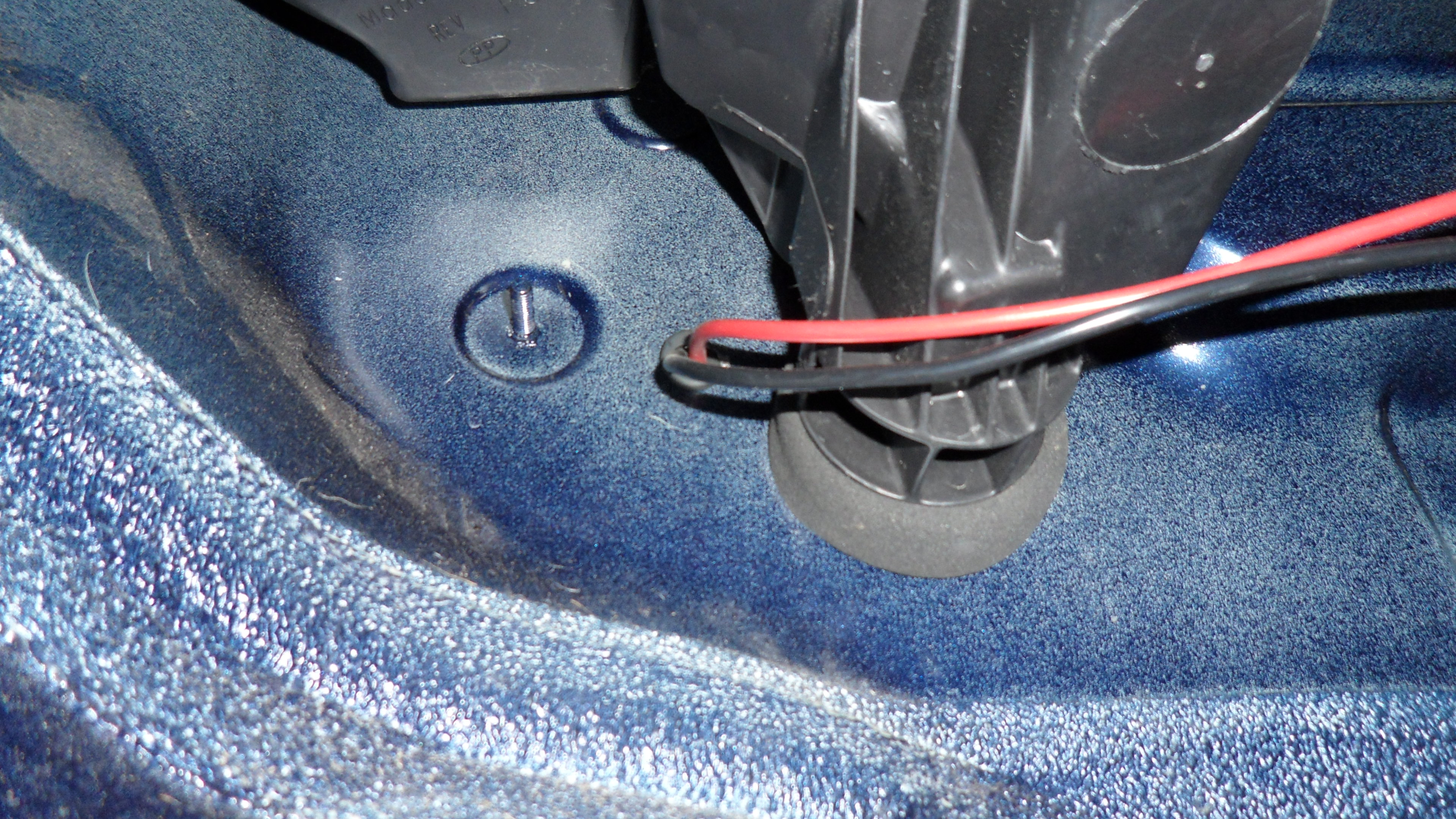

Now for the wiring. The cord that the compressor comes with is long enough to reach from where I mounted it to the battery (this is a TJ, I make no guarantee that the same is true for an LJ or 4 door JK (or 2 door JK for that matter).
Initially I just routed the factory cord up the passenger side, cut off the alligator clips, drilled a hole in the firewall, ran the cord through the firewall, stripped it back and hooked it up to the battery terminals. Unfortunately I was blowing the inline fuse every time I turned the compressor on, so I ended up cutting the factory wires off (including the inline fuse) and running new 12ga wire and added a new inline fuse with the housing from AutoZone. Since I did that, I have had no problems with it whatsoever. There's a switch on the back of the compressor. Whenever I need air, I just hit the switch. The hose is long enough to reach all four tires easily from where the compressor sits. Here are some pictures of the wiring. Note: Be sure to use a grommet to protect the wires when you drill a hole in the firewall!

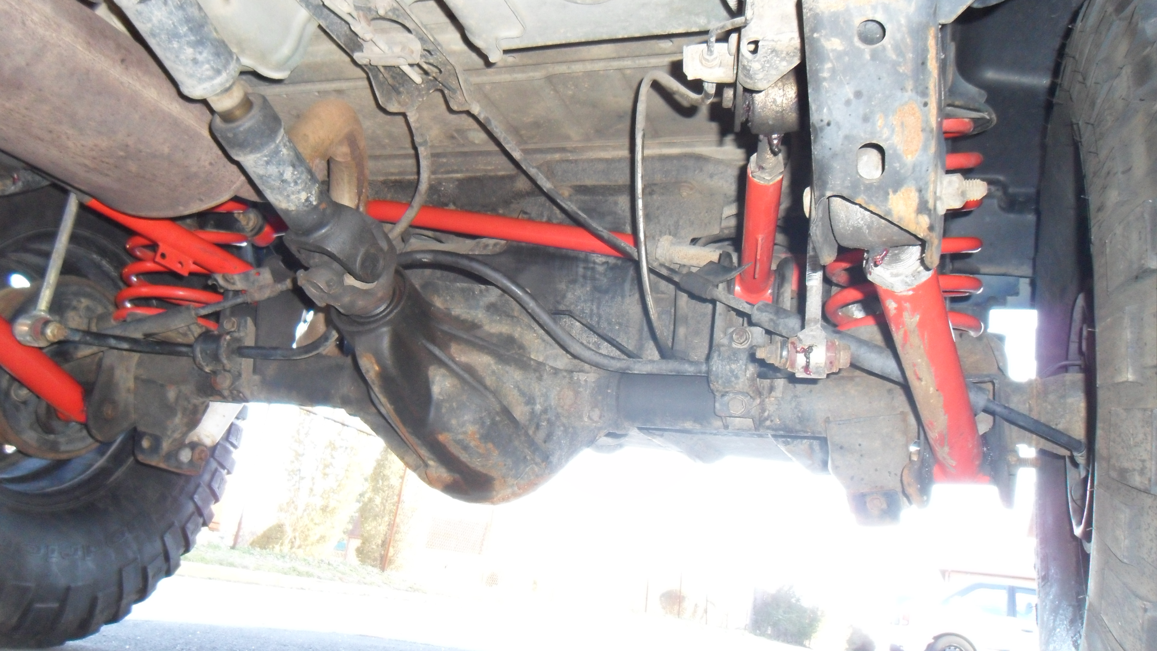

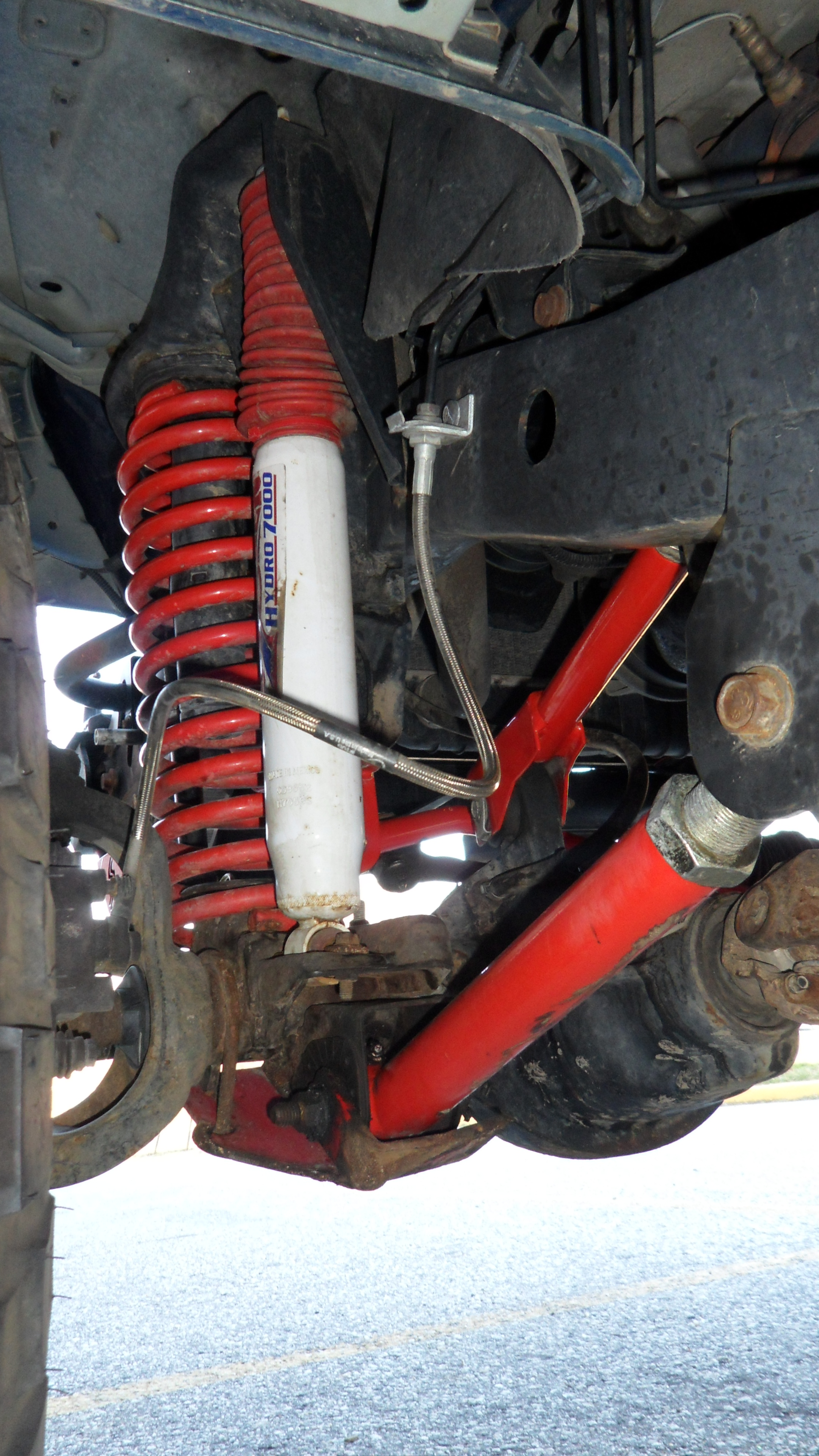

Last thing - the factory battery finally called it quits last week, so I upgraded to an Optima Yellowtop. No complaints so far. I was bored this past Sunday so I cleaned all the control arms and stuff with degreaser - probably wasted effort but at least I got to hang out under the Jeep for a while :).

Oh, almost forgot to review the compressor! Once I solved the fuse-blowing issues, it works great. I usually run about 8-9psi on the trail and 20psi on the street (may sound low, but on my setup it gives me the best contact and most even wear). The SuperFlow MV50 will air my tires up from "trail level" to "street level" in about 2 minutes per tire. I haven't had any problems yet but will let you know if anything comes up.

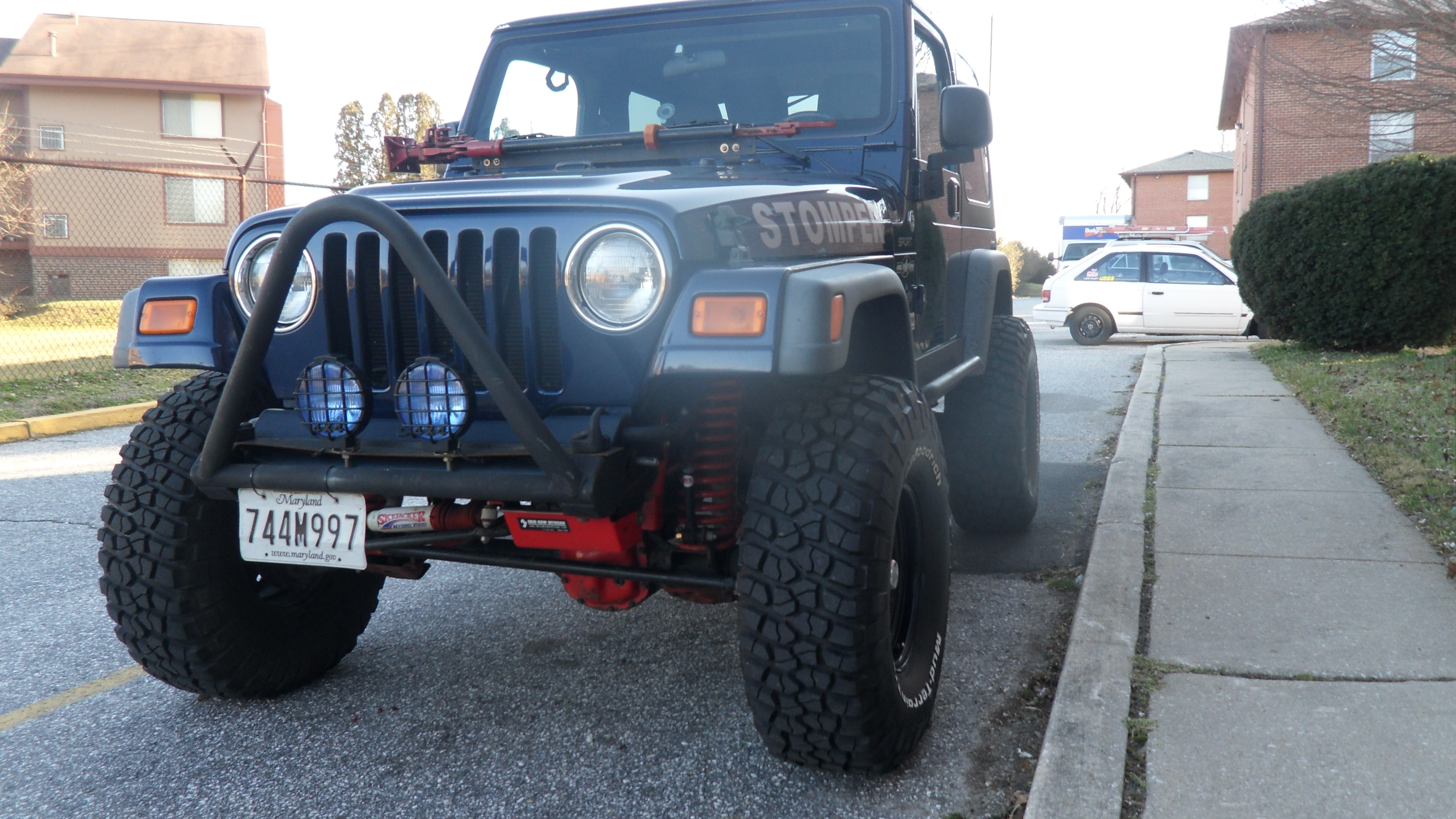

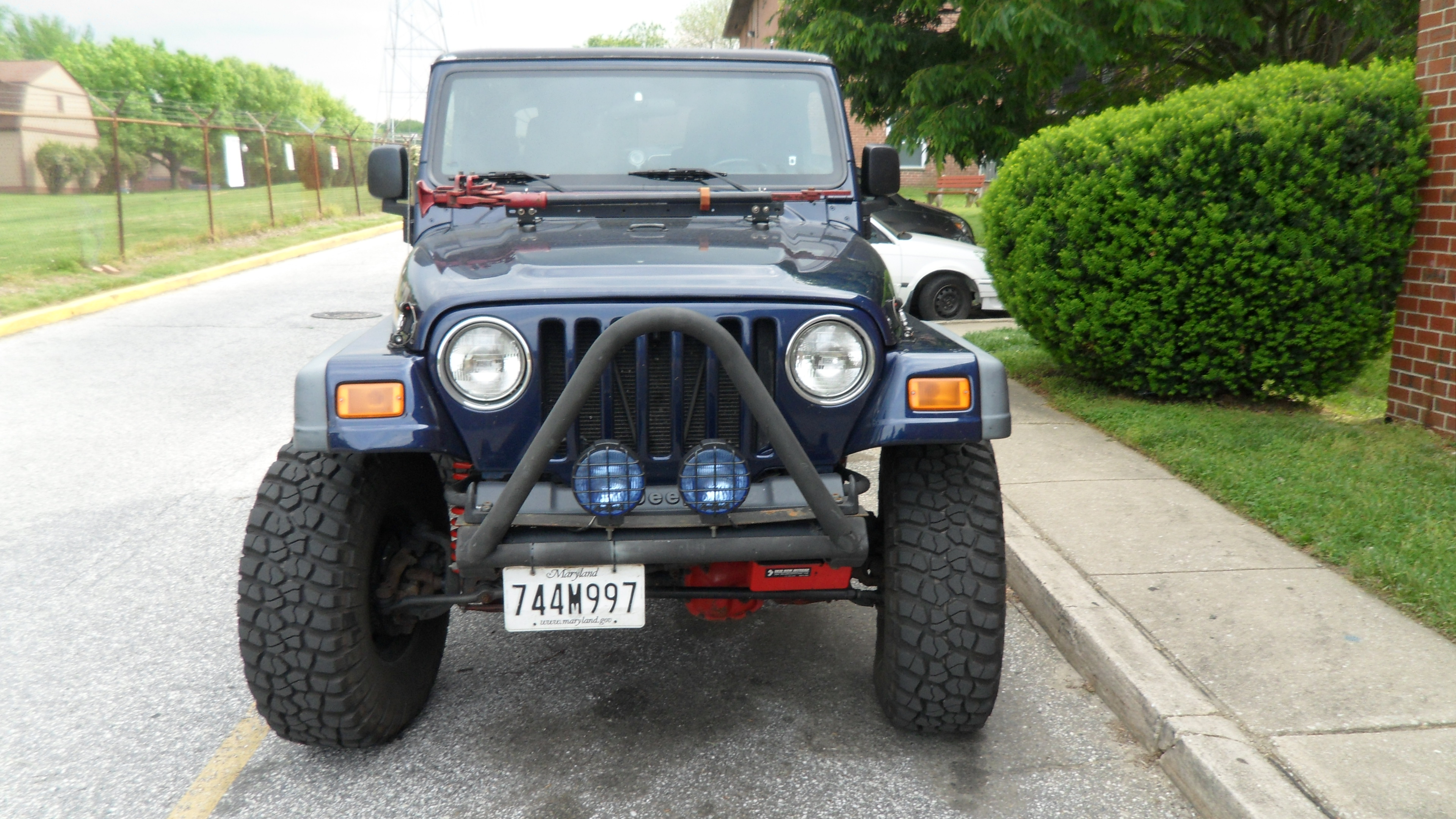

What kind of Fog Lights are those?
Sorry for the delayed response. They're just a cheap set of "4x4" fog lights from AutoZone. I think I paid like $30 for them. As mentioned earlier in the thread, I had factory fog lights but one was broken off. I tried unsuccessfully to find a replacement factory fog at the junkyard and found those at AutoZone and decided they looked about the same as the factory ones and were cheaper than a KC or factory replacement. They came with an aftermarket switch/wiring harness/fuse block but since I had the factory fog light wiring I just spliced the factory wiring to the lights so they function just like the factory lights.
