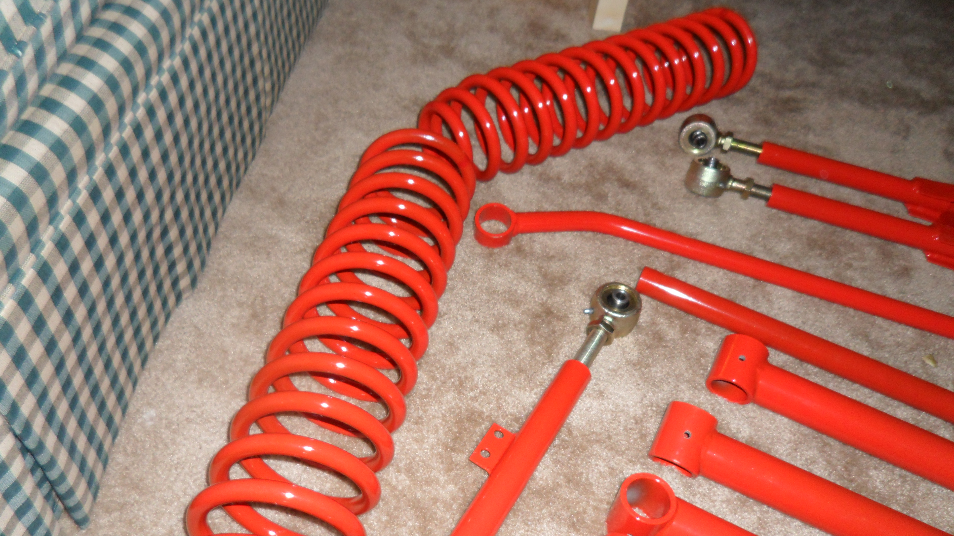

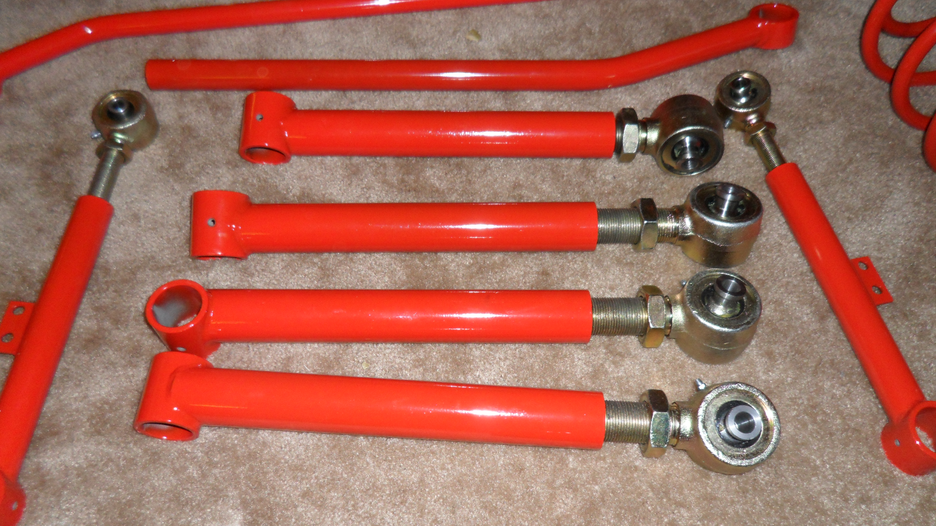

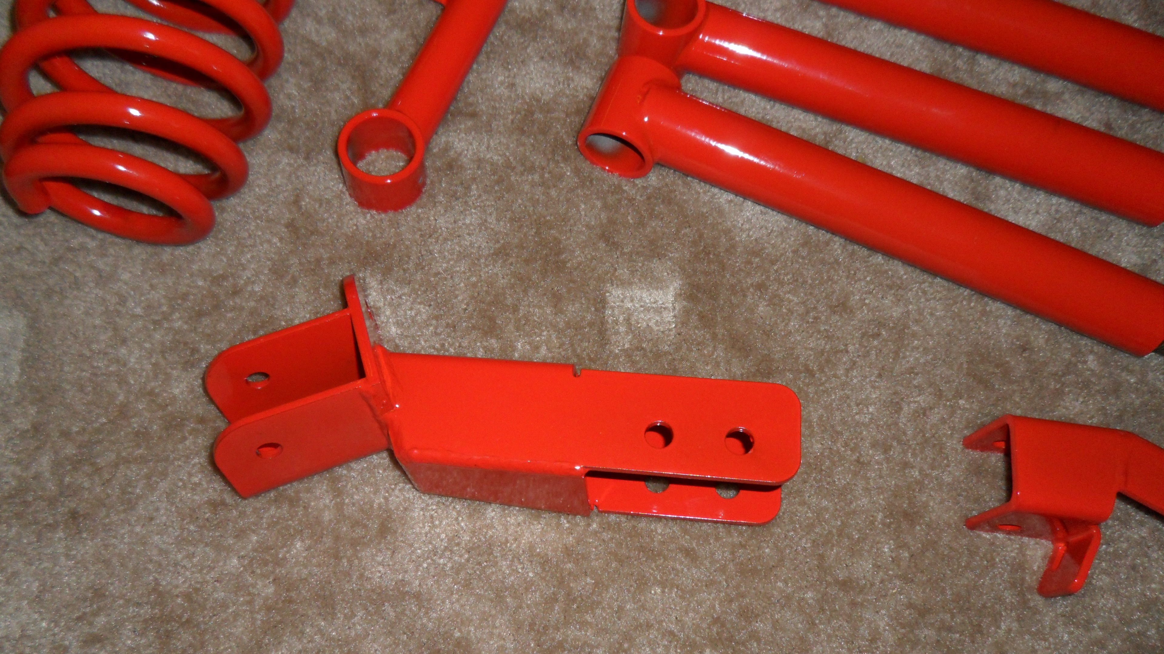

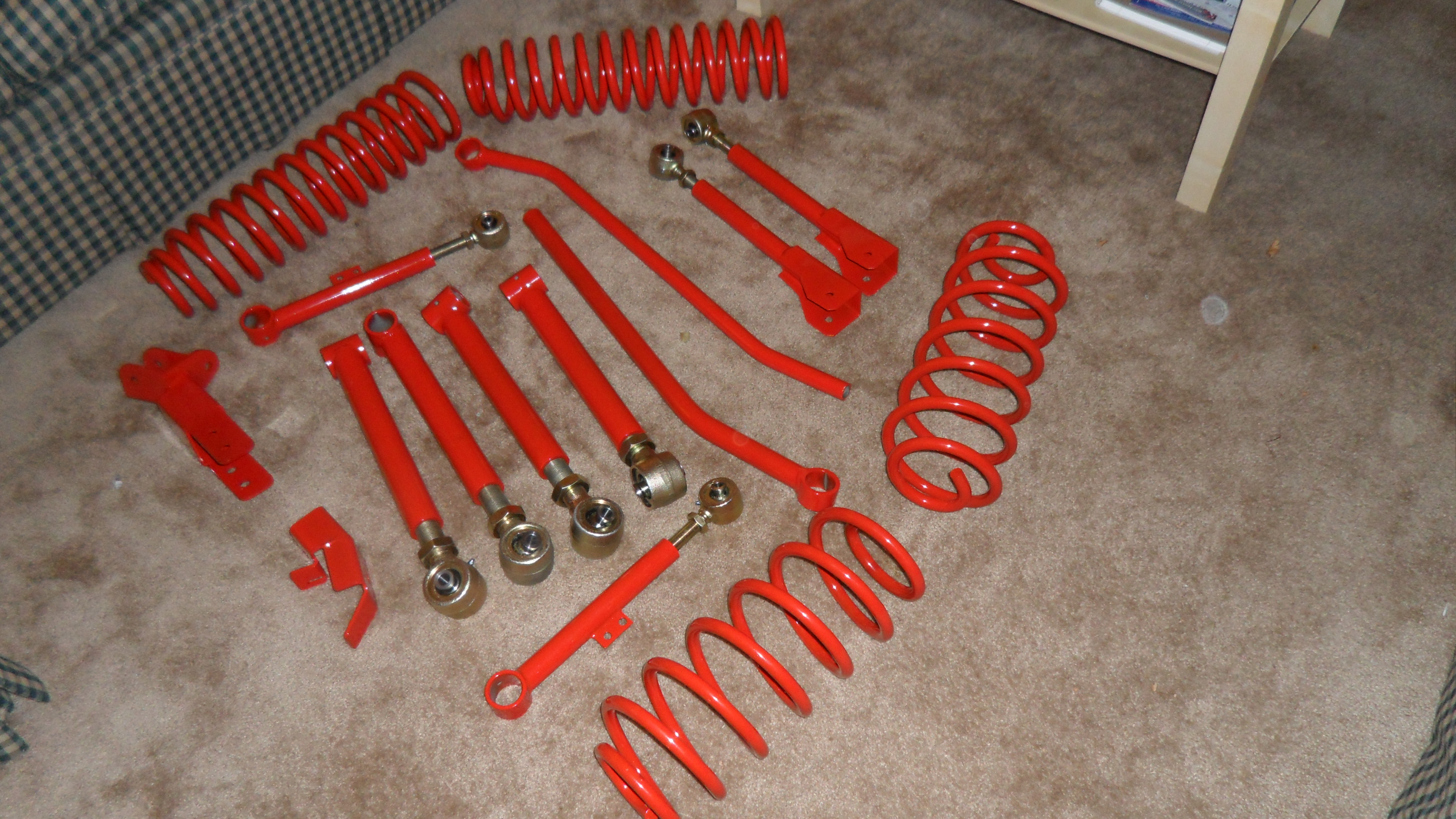

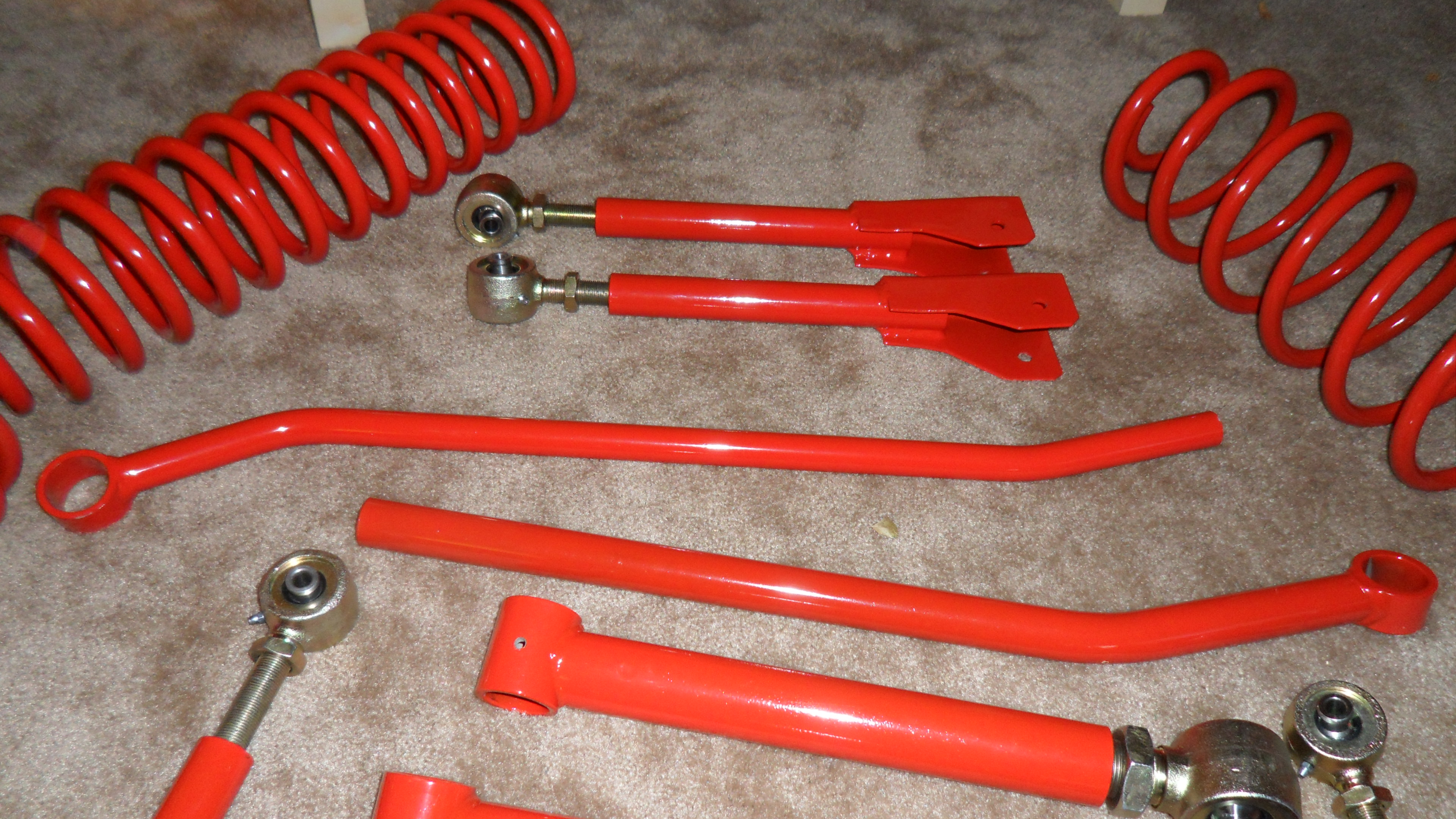

Got the parts back from the powdercoat guy. Everything is done except for the belly pan. We fabbed it up yesterday with the Rusty's oil pan/transmission skid and it looks like it's going to be a relatively easy fit. Hopefully he'll be able to finish the belly pan this week (it has to be sandblasted because they shipped it by just sticking adhesive shipping labels on it instead of putting it in a box). It will be the same red as the rest of the parts. Here's what the rest of the suspension looks like - Skyjacker springs, Rough Country x-flex control arms, Rough Country adj. front trackbar, and JKS adj. rear trackbar (the brackets are for the trackbars). Only things that didn't make it into the picture besides the belly pan and misc. hardware are the heim joints for the track bars, Currie motor mounts, JKS 1.25" body lift, Skyjacker shocks, and the PORC SYE kit.
By the way, the powdercoating cost a total of $400 - $200 for sandblasting/prep and $200 for the actual powdercoating. This doesn't include the belly pan, which he said would be less than $100.

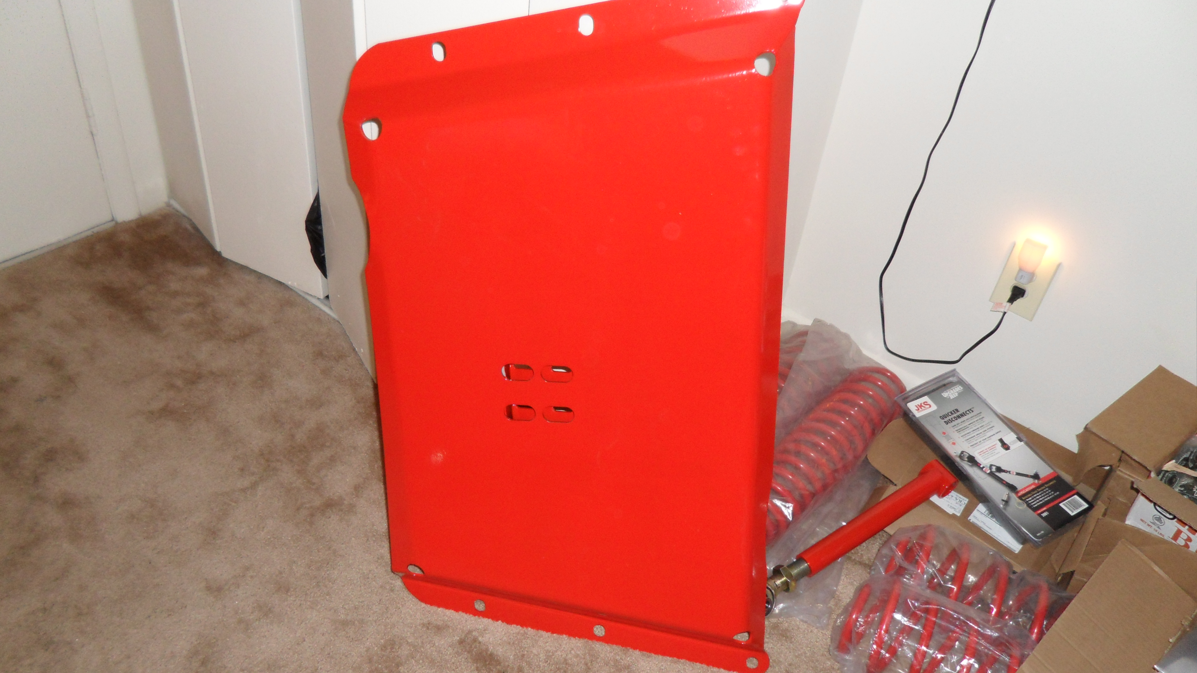

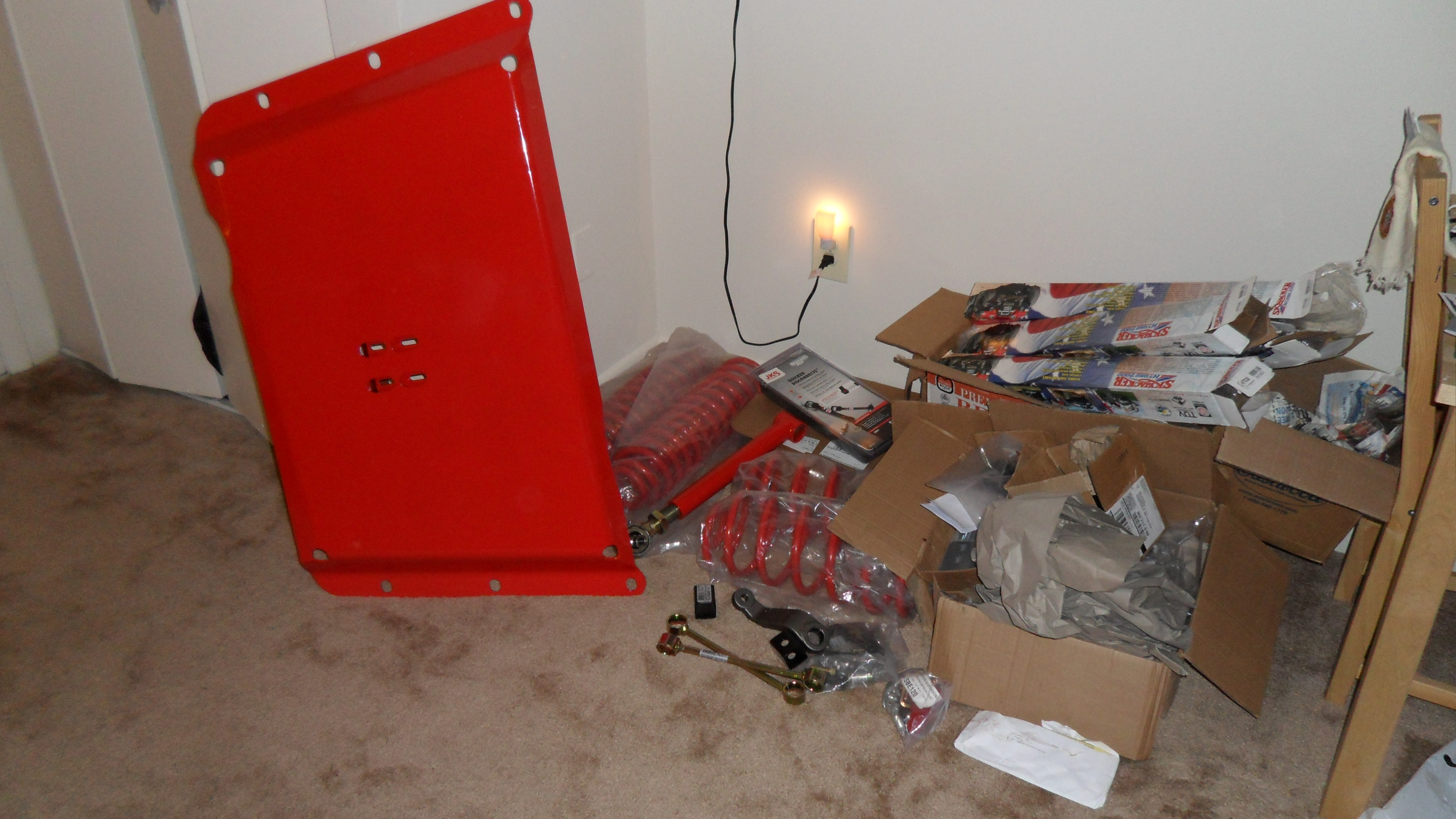

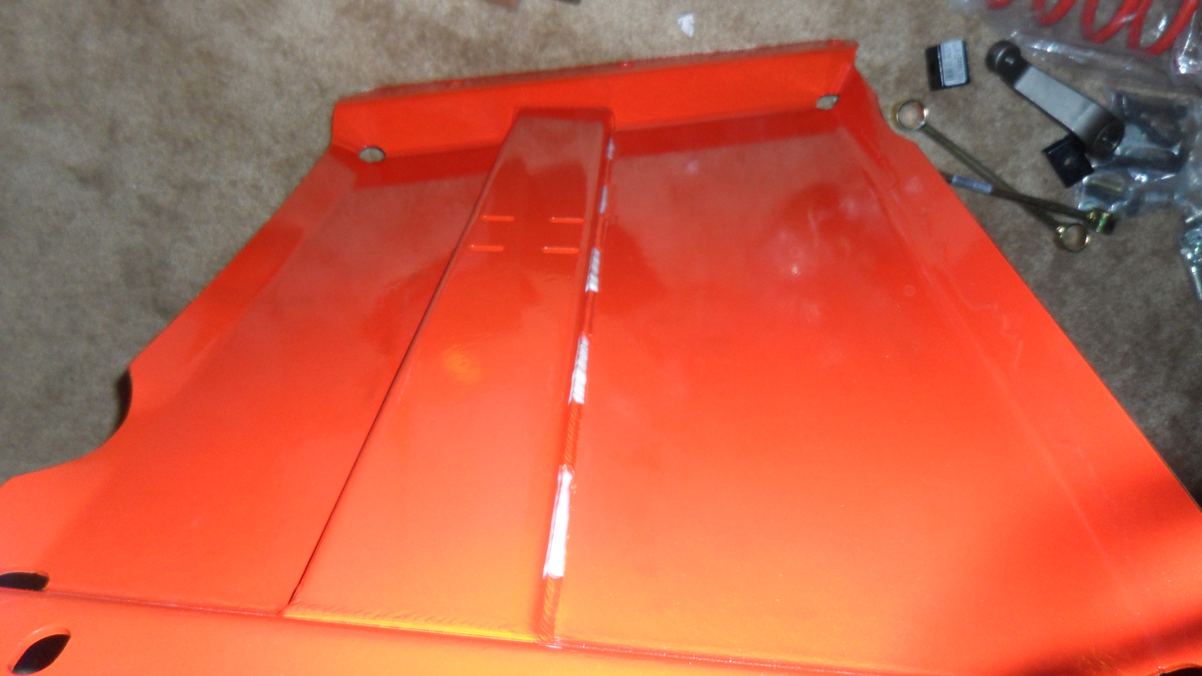

Got the belly pan back tonight. Everything's ready to go. We're set to start work on Wednesday. Here's a few shots of the UCF belly pan with powder on it, and everything else piled up ready to go to the garage. I'll update this thread hopefully with lots of pictures as things progress throughout the week.

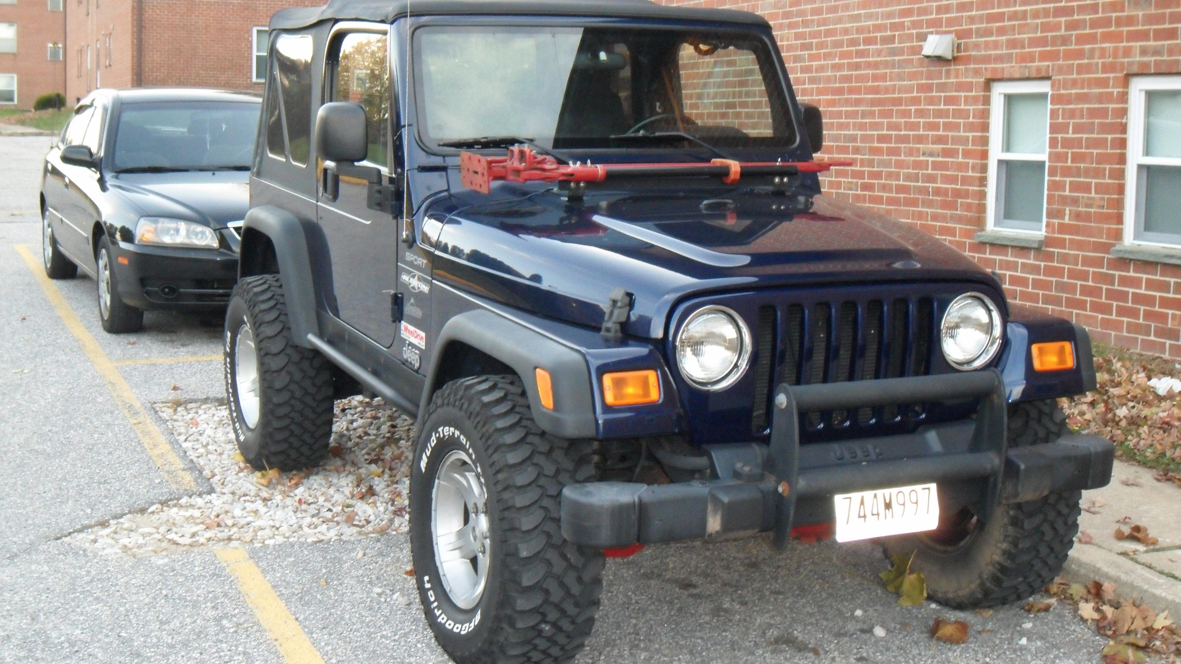

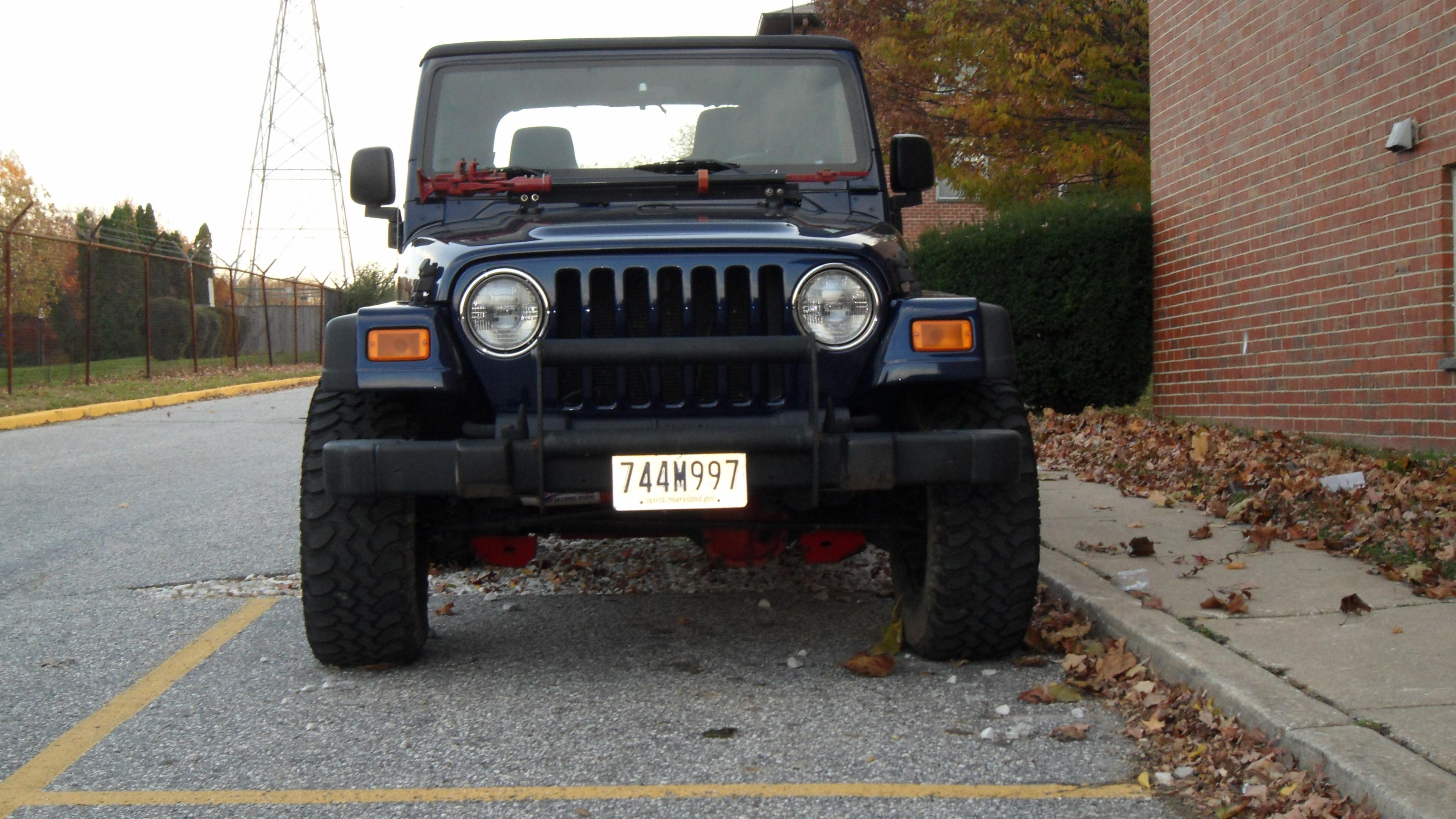

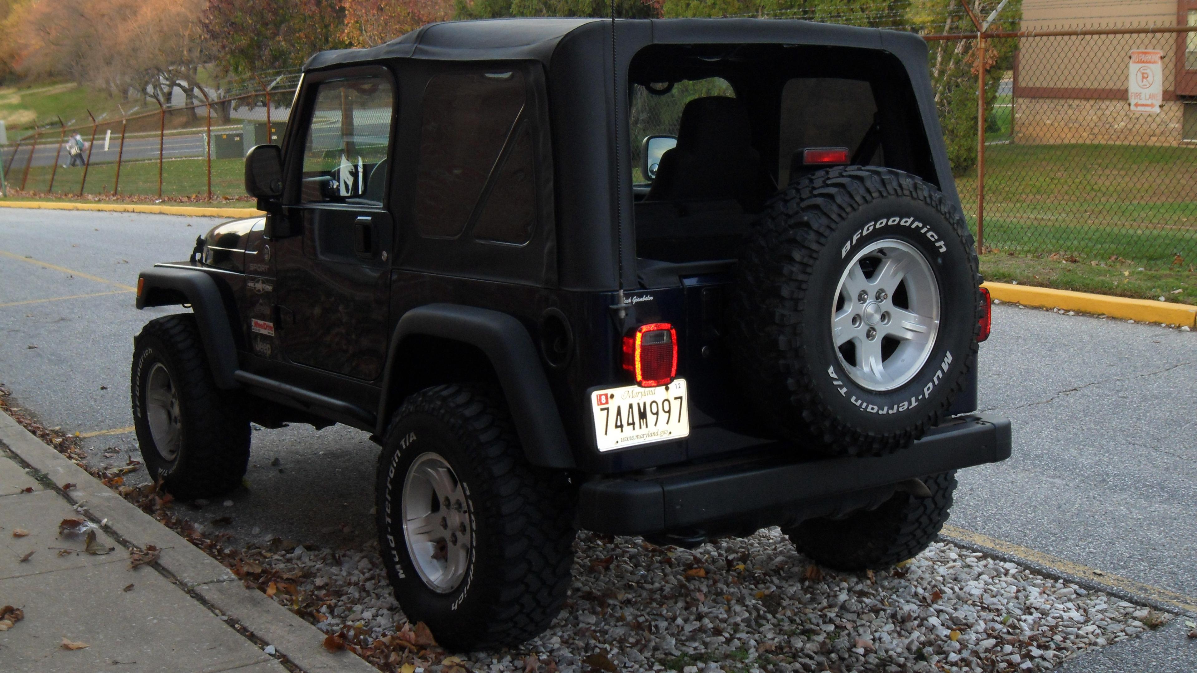

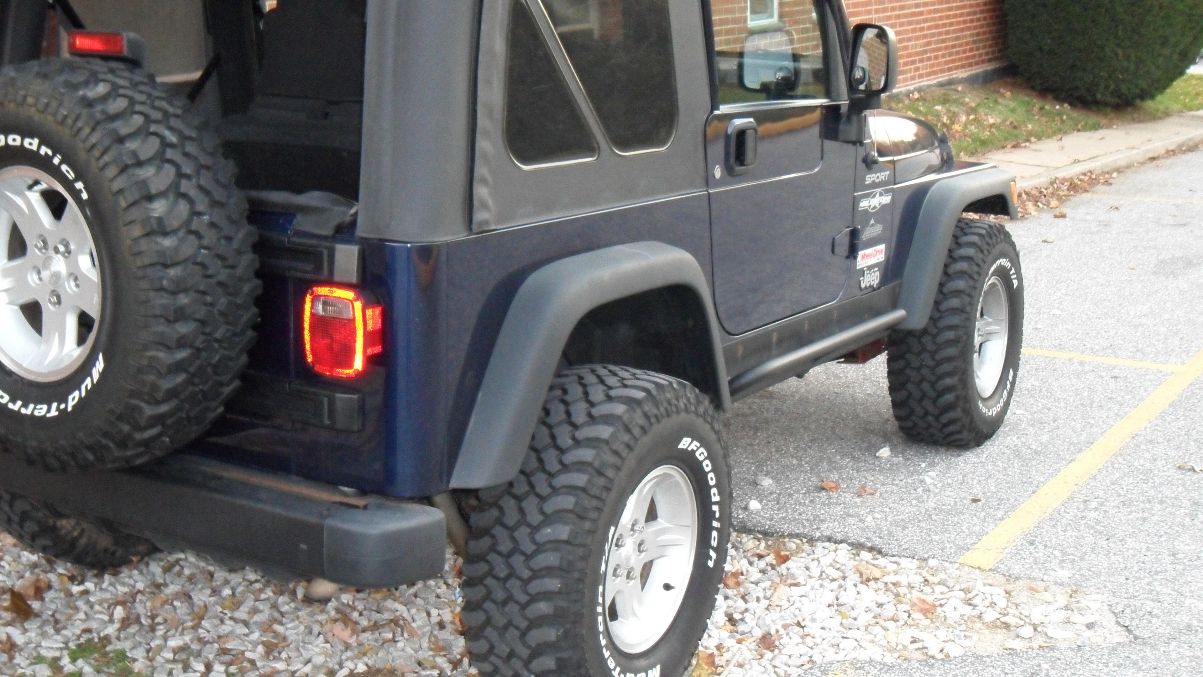

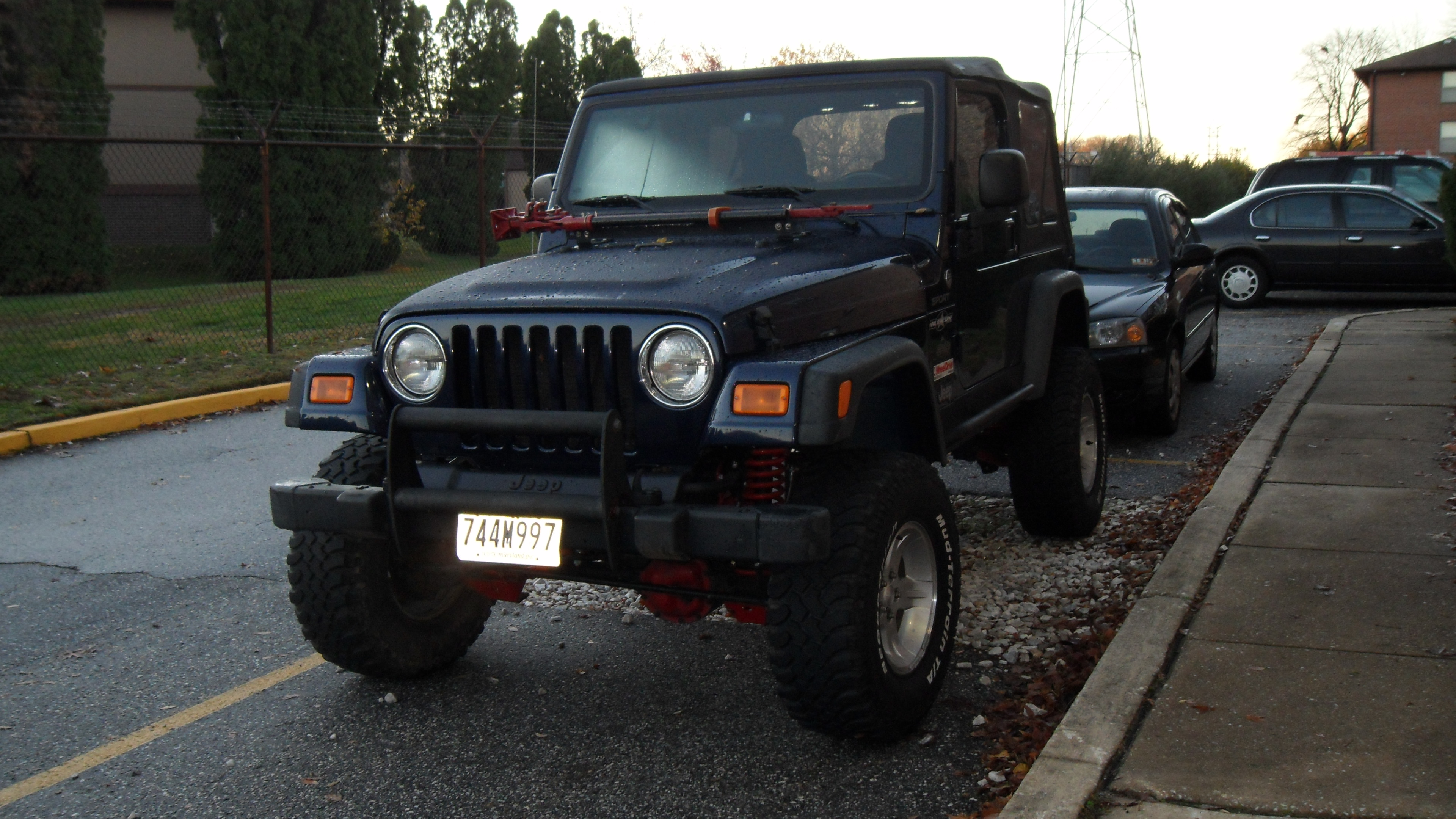

I believe the factory called it "Midnight Blue". Here are the "before" pictures taken this past Monday. I might be able to get you guys a quick update picture or two tomorrow.

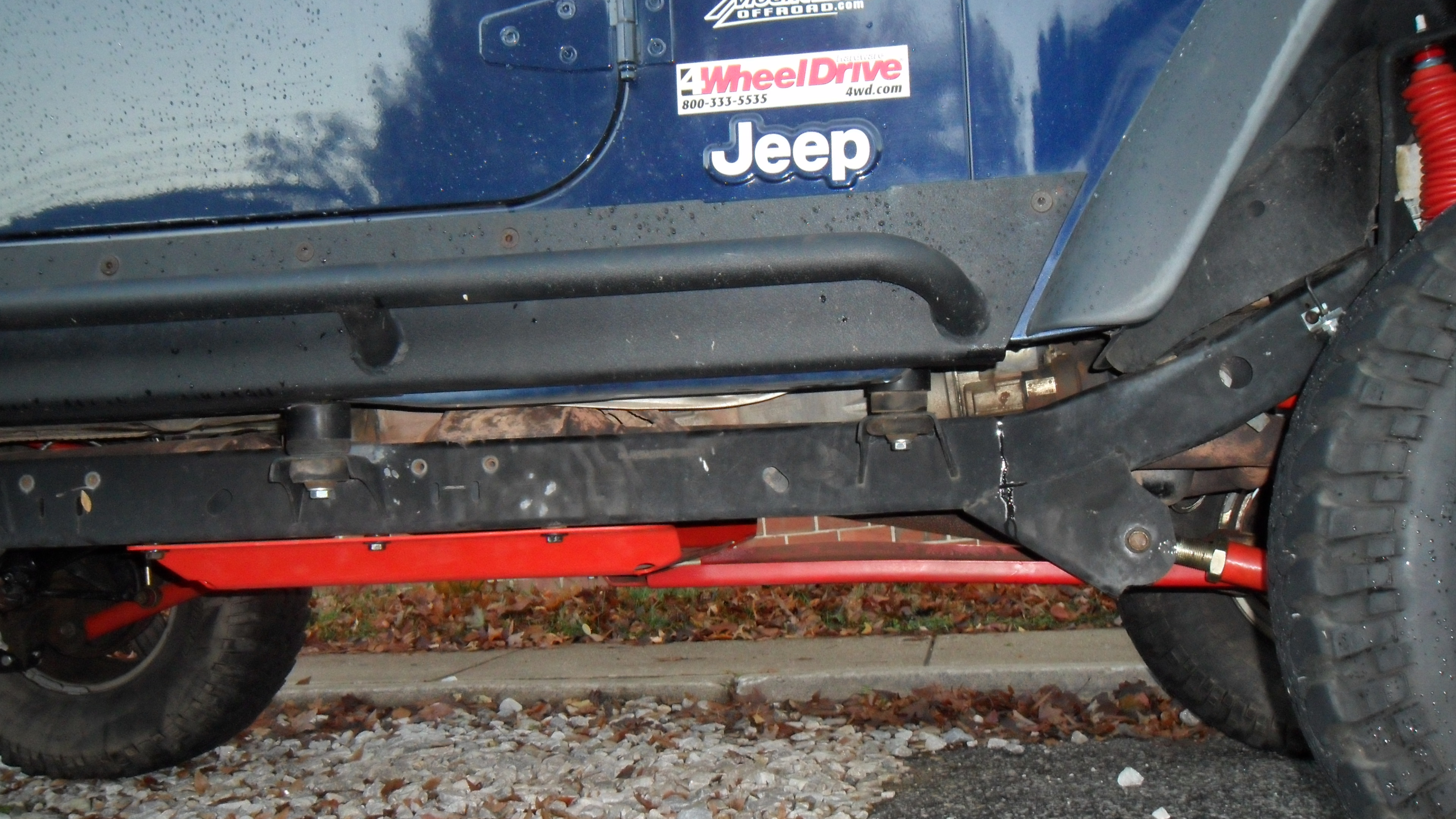

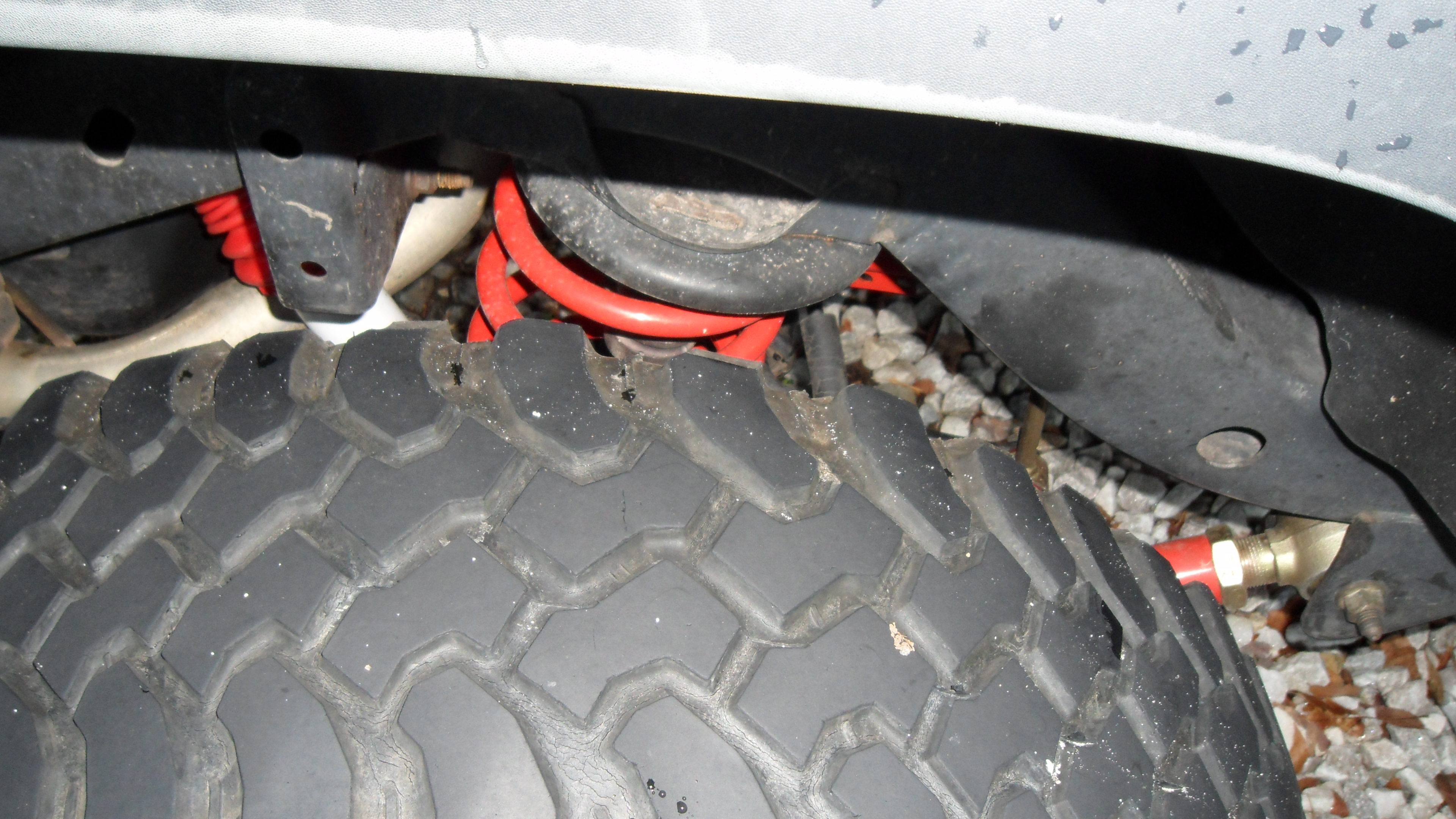

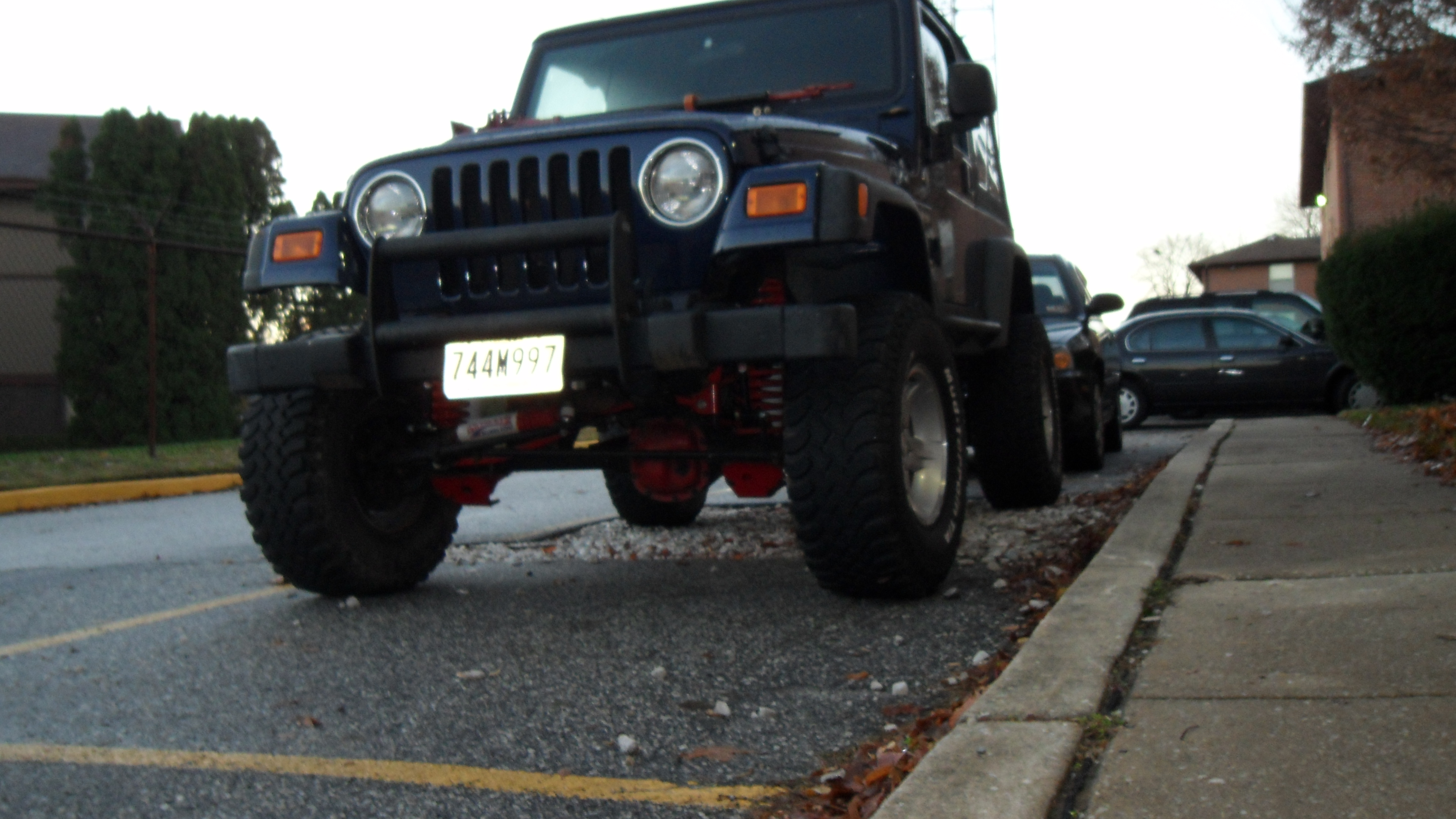

Ok, Phase I is now complete. Everything's dialed in and the alignment is done. Just got home. Unfortunately it's pouring the rain and dark so I won't be able to get any pictures until tomorrow. It looks really good though. The only problem is there is now no way my wife is going to be able to get into the Jeep so I'm going to have to fab up some kind of steps. Any ideas? 8)
Re: Quick Update on my TJ project

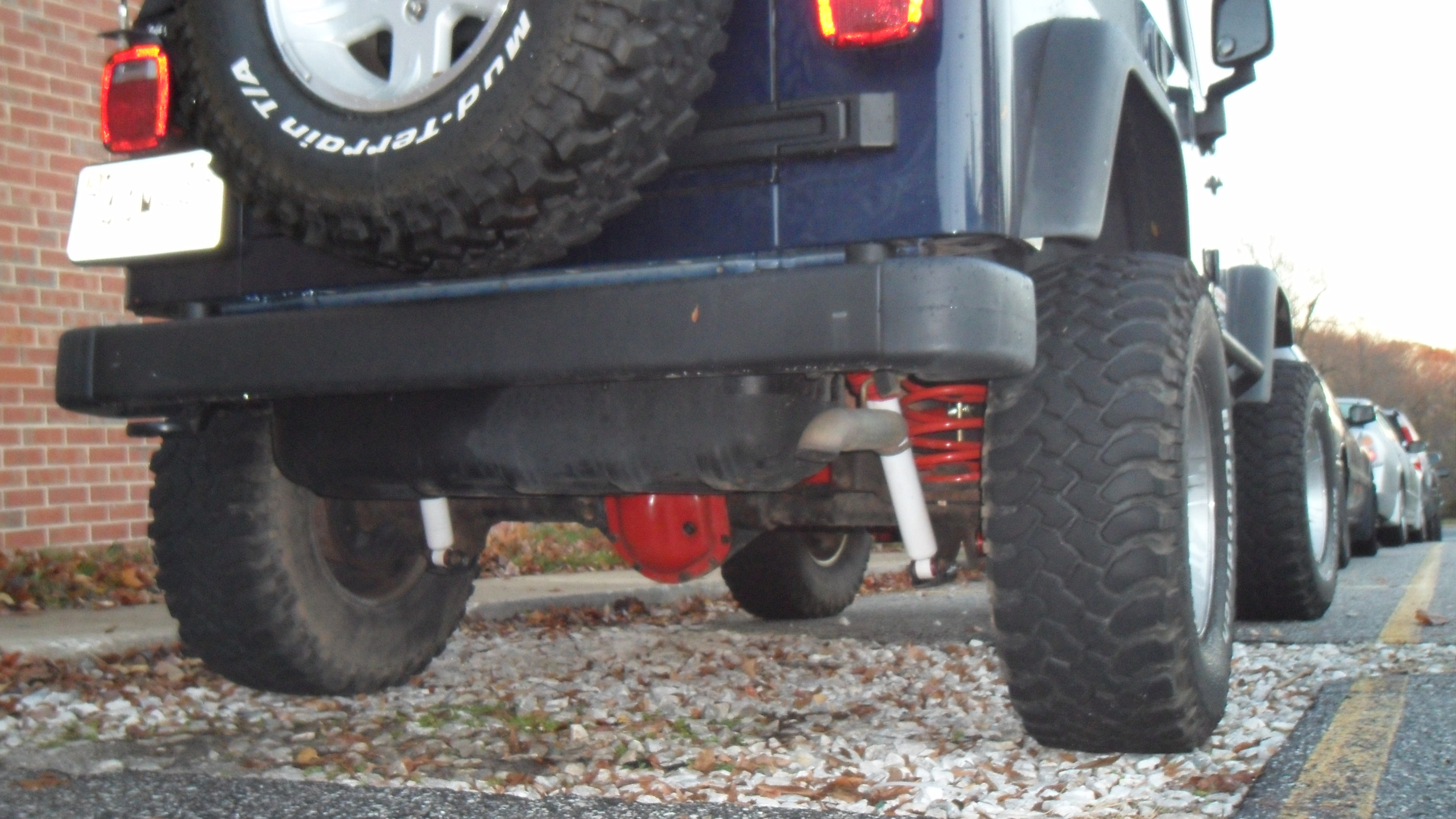

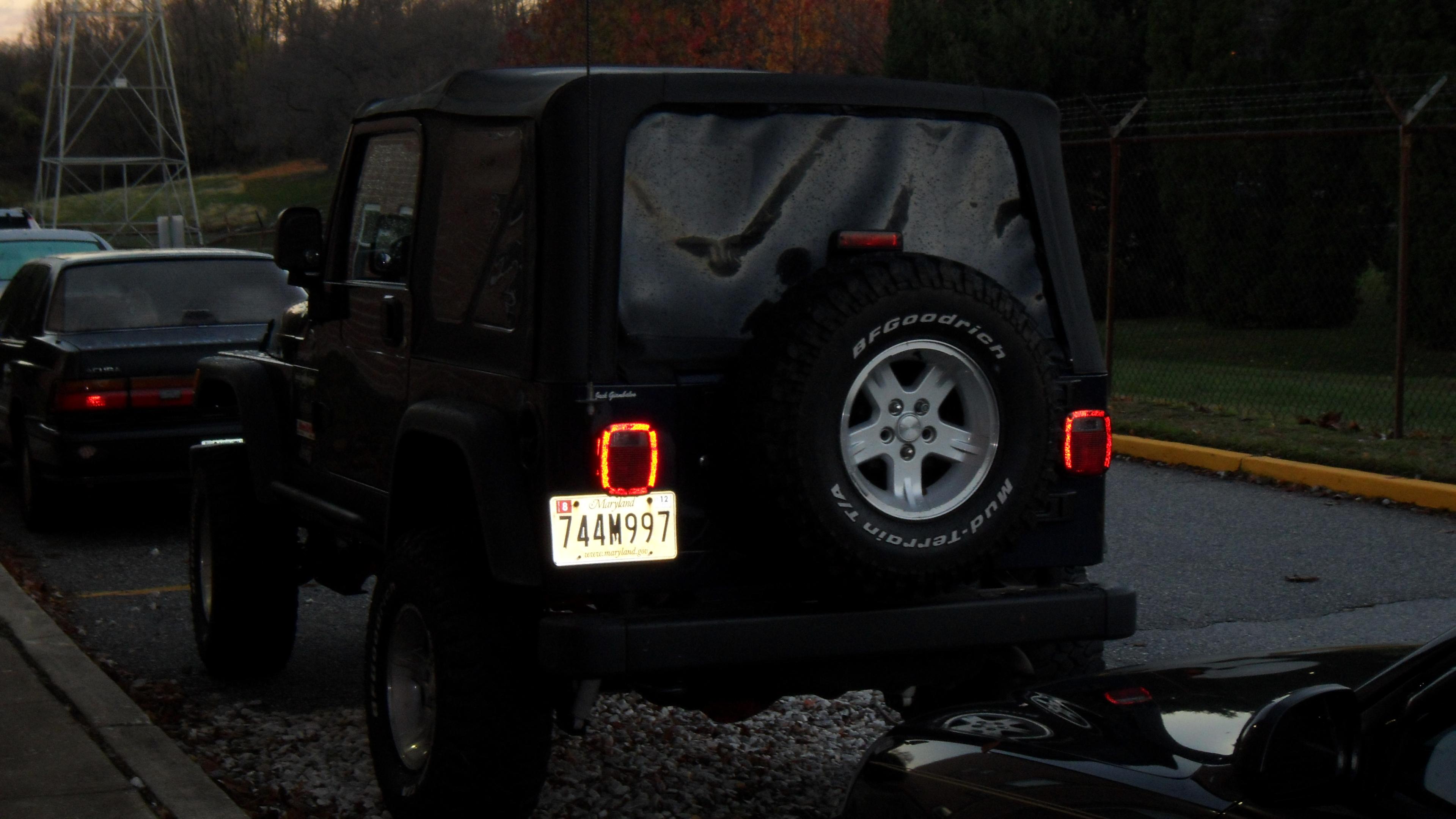

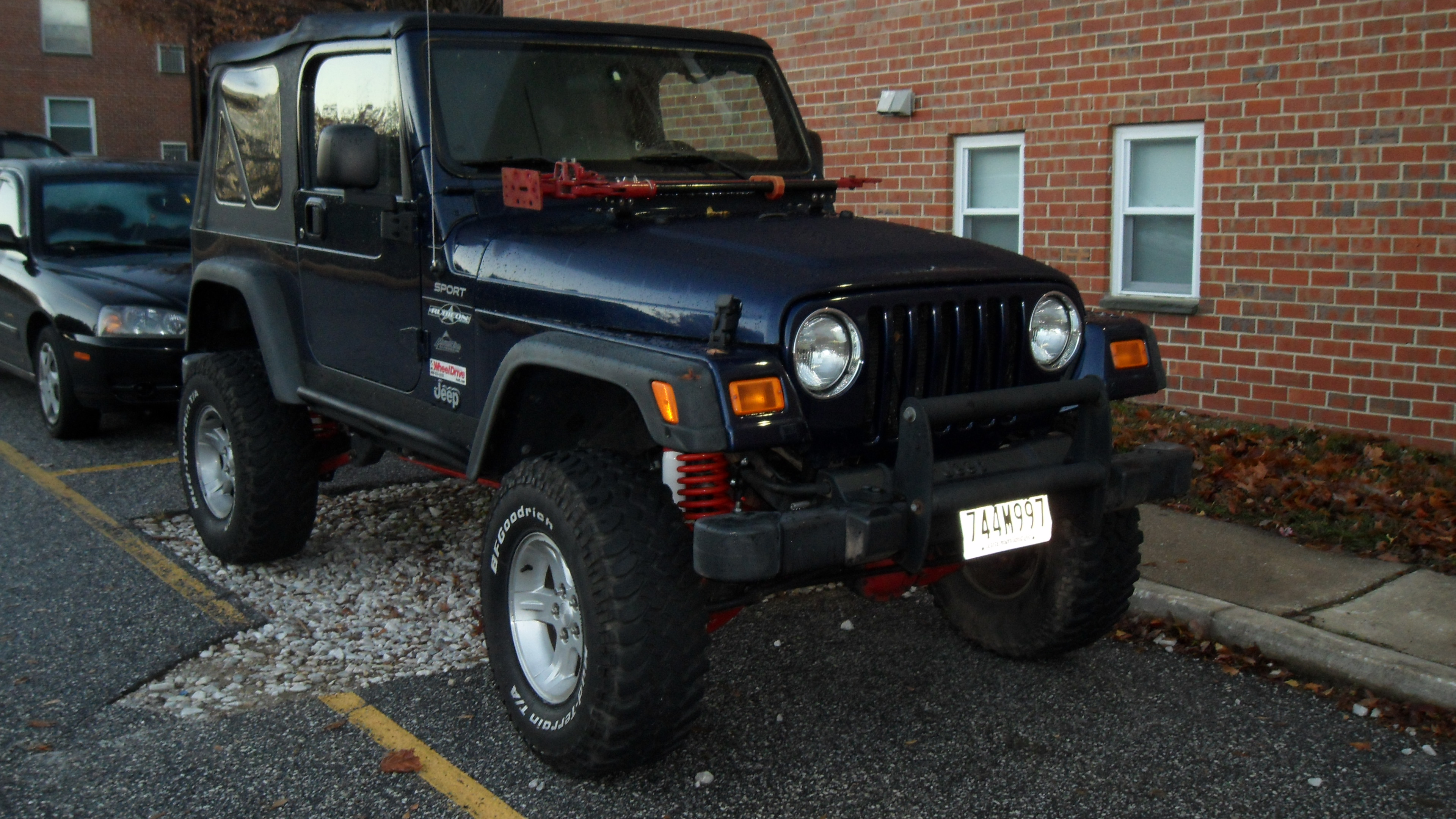

Here you go...quick batch of photos taken this morning before I left for work. Sorry they're not that great, I'll try to get some better pictures later.
I need bigger tires now...
