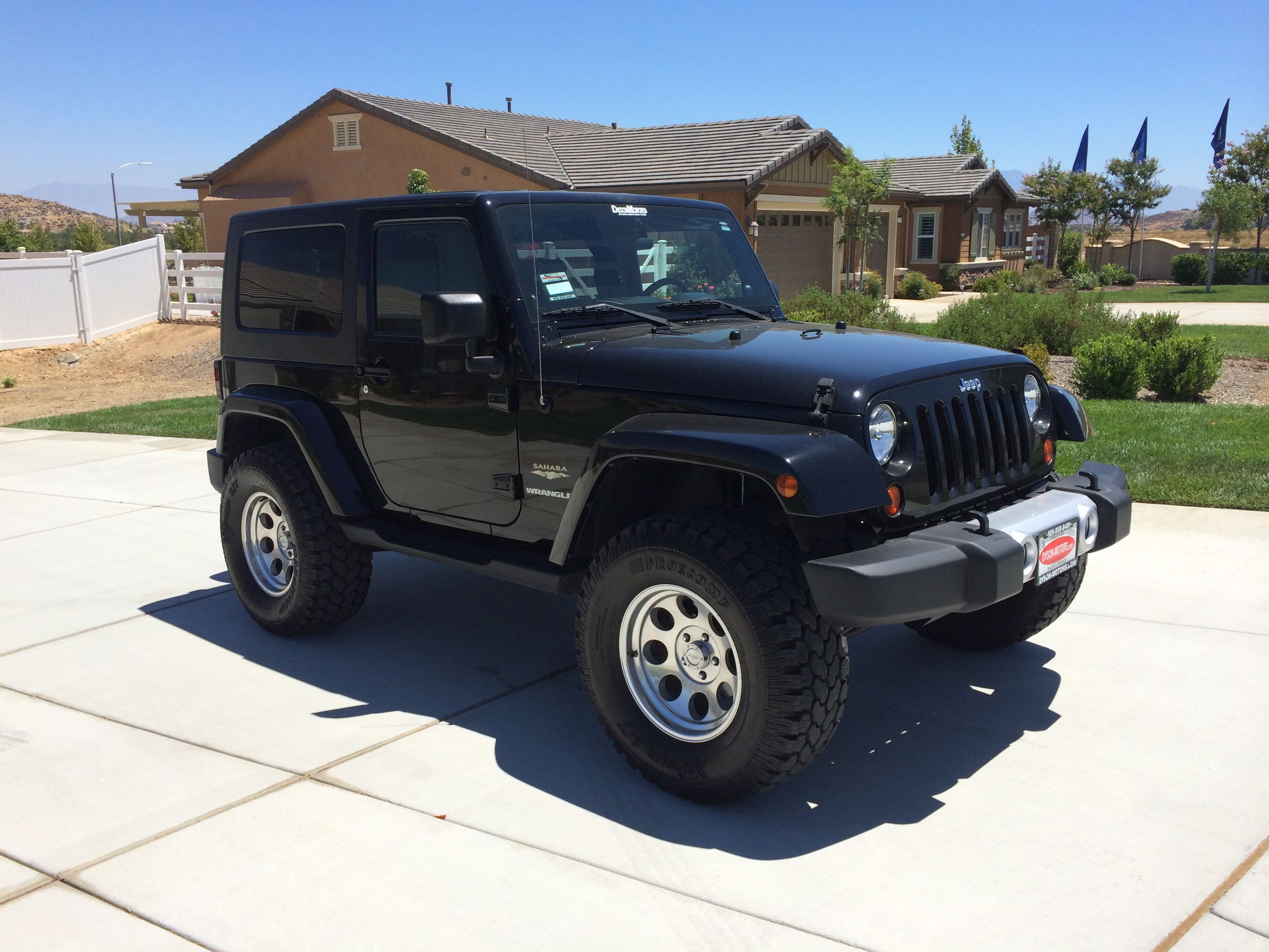

Hi all,
I just purchased a 2008 used Sahara 2 door, which has a 3 to 4 inch lift on it (not sure what brand), wasn't able to find out what type it is one the numbers underneath it). 17" rims and 35" tires. I took it for a test drive at the dealer and it drove fine. I had it flat bedded to my house. and I began having some issues with it drifting a little bit to the right while driving it(the wind making it worse). I went to Off Road Warehouse and they installed a set of new caster stops and did a front end alignment, also had a new (upgraded) steering box installed, both were about $600 to have installed. Now when I drive it, I have an issue where it doesn't seem to drive straight. I always have to do slight micro-corrections to get it to go in a straight-line. I've talked to my mechanic, who installed the new steering box(which is a friend of the family and has a shop in this area) and he says he'll recheck it, but he thinks it might be as good as it gets. I have a hard time believing this as I had a 2004 Jeep Sahara, which was also lifted, but did not have this issue and also, it didn't do this before I had it flat bedded home.

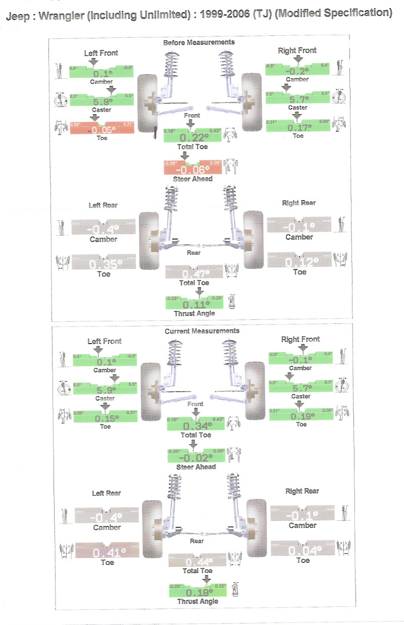

For my 2 cents I'll recommend a Firestone lifetime alignment. I've probably had my Jeep aligned 5 times there. If you ask they'll provide sheets like these (Keep in mind these are TJ specs).
