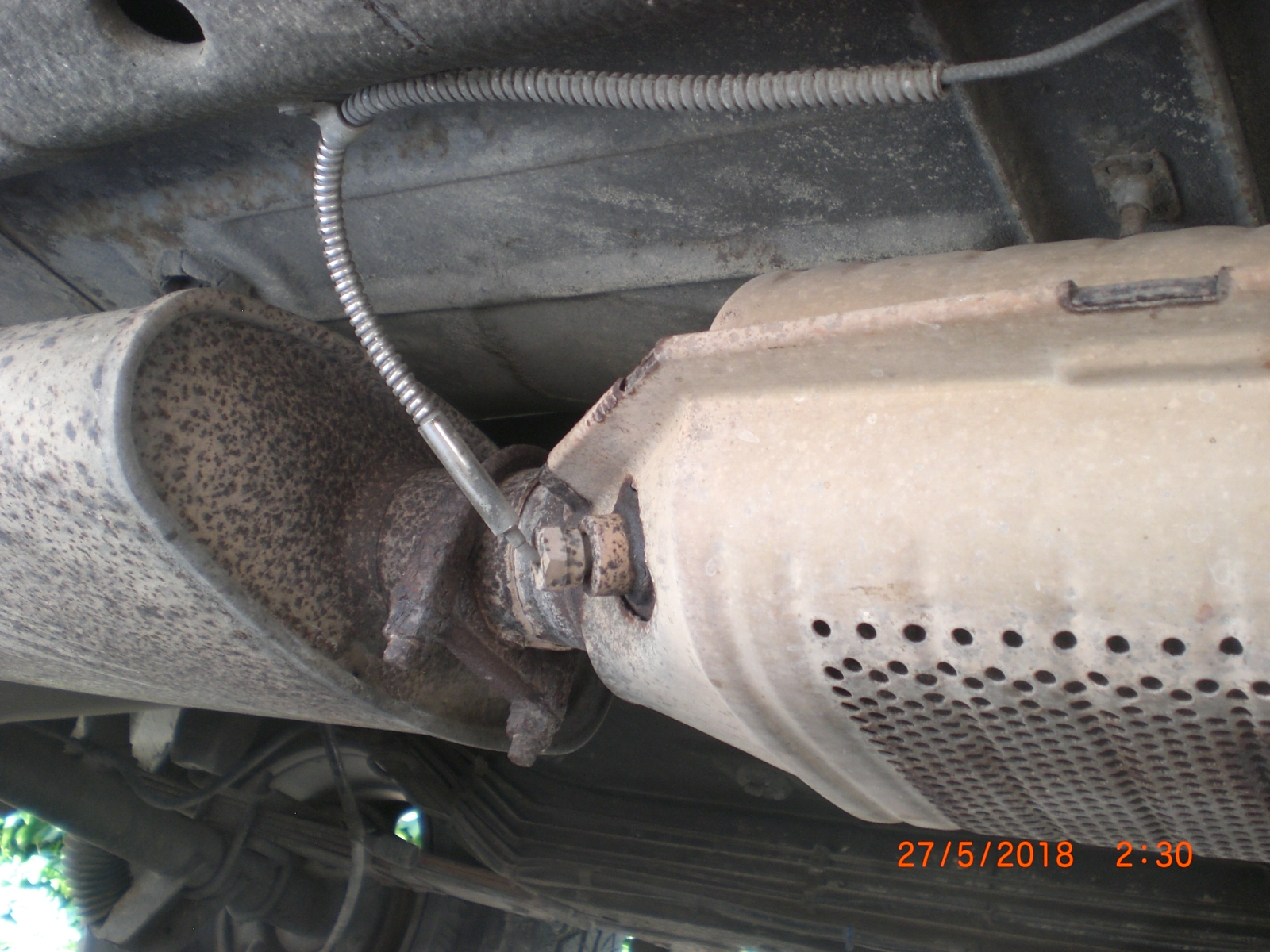

I have also been looking at the temperature sensor on the cat that could be an oxygen sensor but isn't.

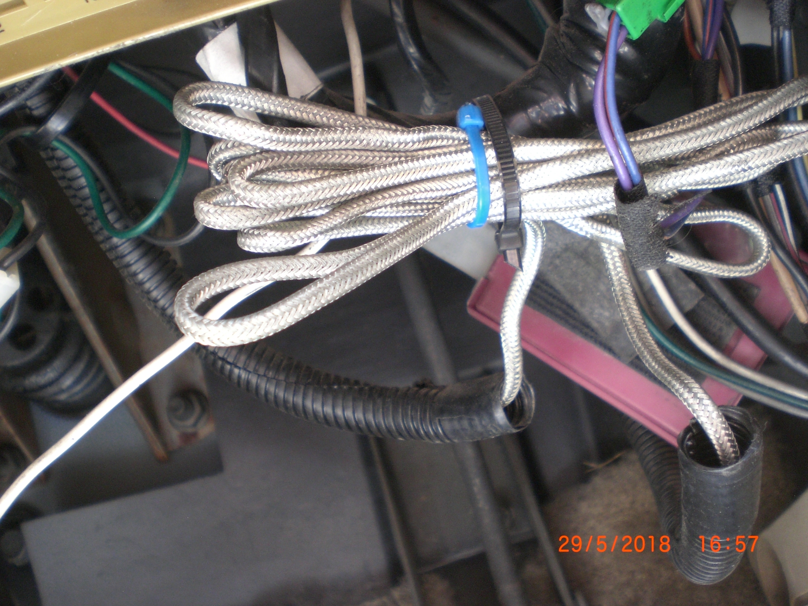

It is actually a thermistor probe, see attached pics. No one can tell me why it's there or what it does. EGTs were not fitted to Jeeps at this time.
The braided lead (2 core ) runs up to behind the dash near the steering column to a small 'control' box. Being a thermistor it will change resistance with temperature like most sensors. Thereafter I have no idea.
The only clue is that this Jeep was exported to Japan when new, then imported to the UK where I bought it, so it might be for some strange Japanese requirement. We bought two of these Jeeps about a year apart and they both have it.
Not knowing what it does makes it impossible to check so I really need help here. Can anyone offer any suggestions or recommend somewhere I could ask some questions? Is there any way to contact Jeep themselves? Thanks......Mike

if you unhook it, does it cause any changes in the jeeps behavior? i wonder if they have some weird check in japan that is required and that is how the testers access the results?

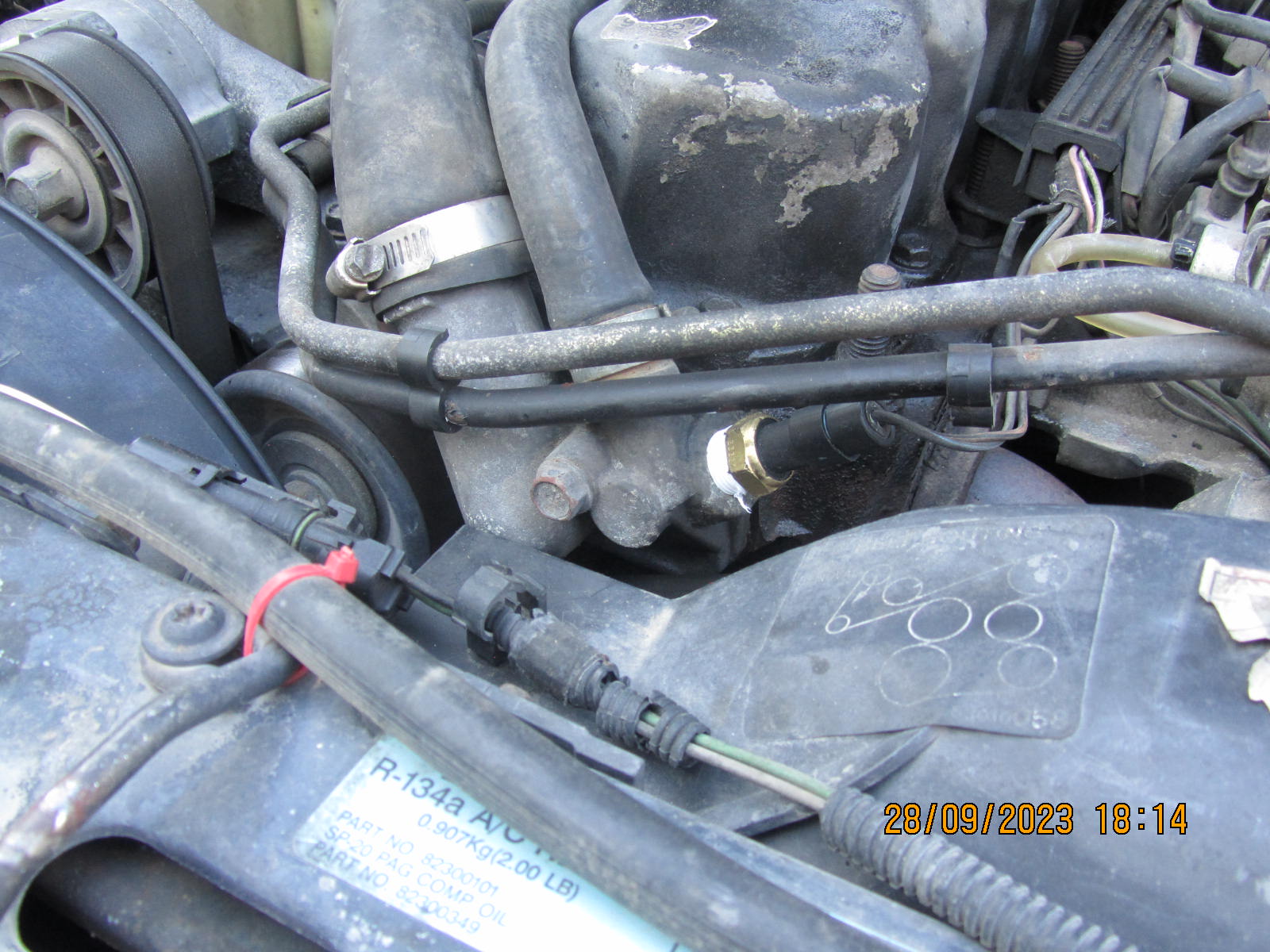

Mine is RHD so things will be in different places to what you are used to, but I think everything is there somewhere. I've attached some pics.

The sender should be just past the intake, near the firewall, if i remember right. But you said the gage works so no reason to mess with it.
The sensor you replaced on the thermostat is the fan controller.
