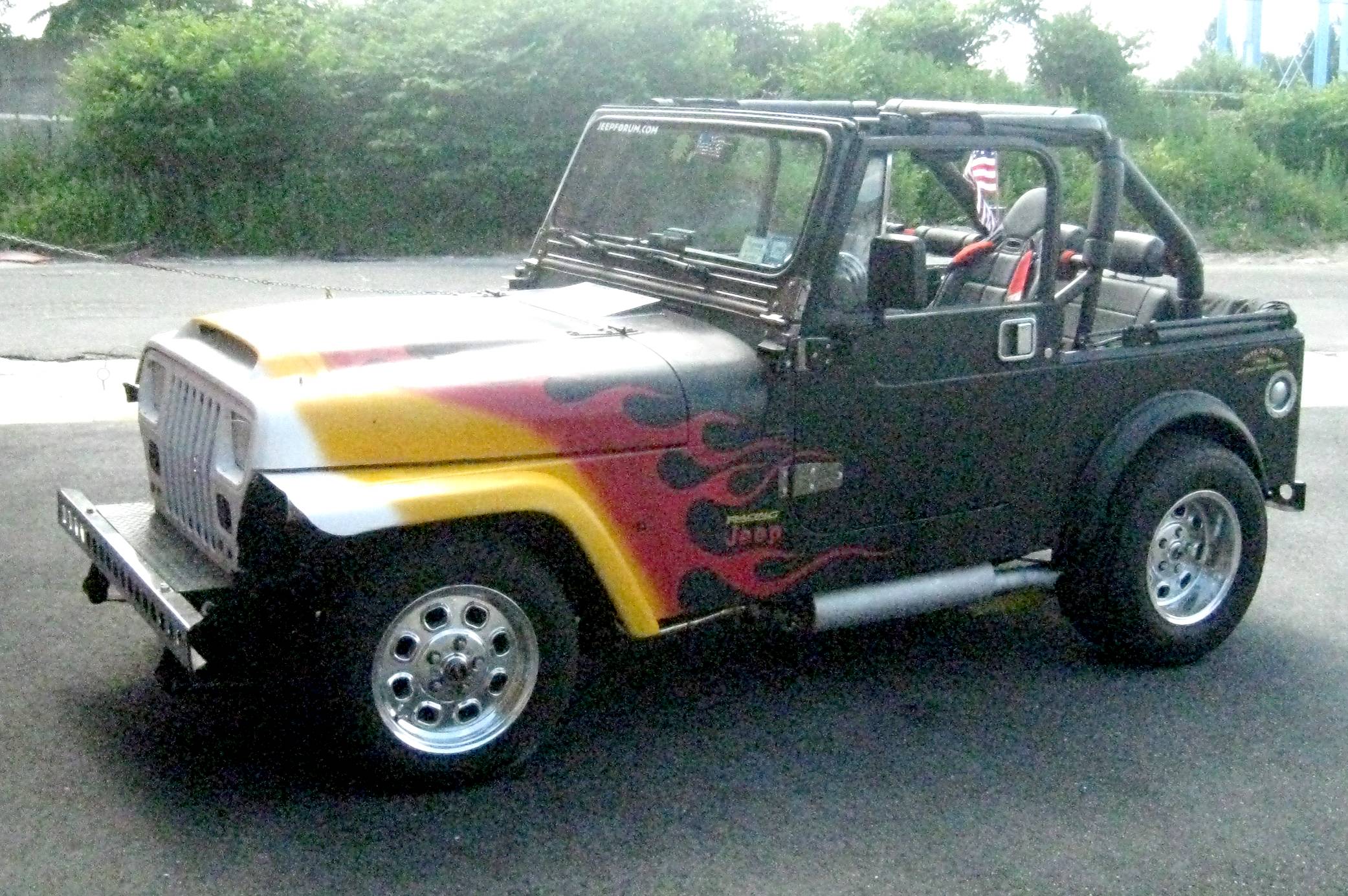

We weighed the car and it is 2906 pounds (between 710 and 780 at each corner). The engine was rated at 450 HP. According to 1/4 Mile ET Calculator
I should do 11.43 at the track. But the car feels much quicker than that. Like I said, although it has been over 20 years, I had driven cars that were said to run in the 12's and I had no problem driving them all out. This thing really frightened me, but maybe it is just because I am not used to the power (or perhaps I am just getting old LOL). I have to keep driving it around and getting the feel of it before I would venture to the track. Which reminds me that having the car street legal gives me a huge advantage to someone with a track only car. The only time they would get to drive it is at the strip, and since you can only make a few passes on a crowded day, it would take a long time to get comfortable in your own car.
Conventional wheelie bars will be a problem. Since my fuel cell and battery box protrude through the floor, the wheelie bars can not mount straight to the differential. I am thinking about having something come out of the back of the traction bars, perhaps. I have to speak with the chassis fabricator, Bobby, to see what ideas he has. But he already showed me that a standard mounting will not work.

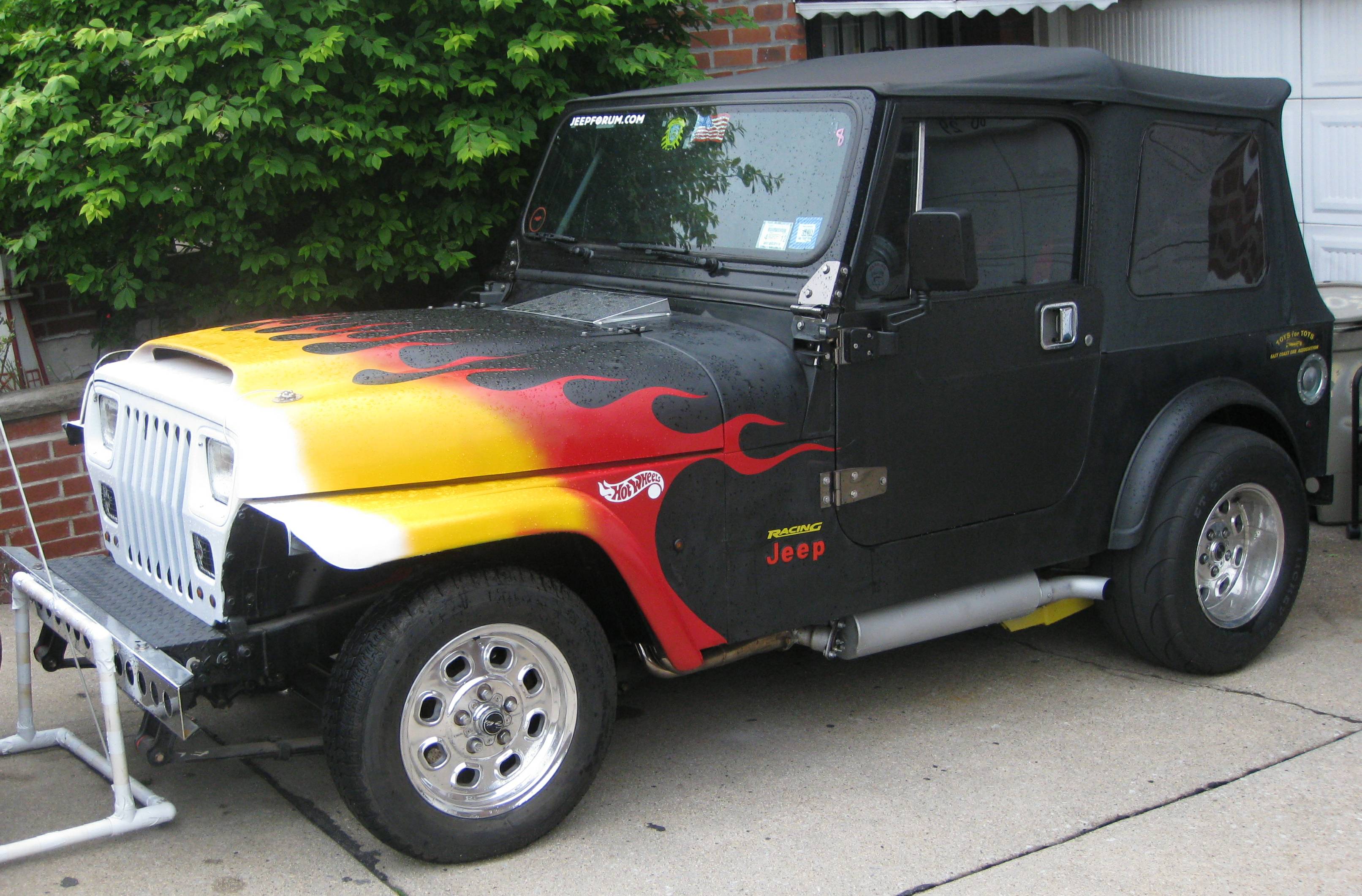

I met someone at a car show last Sunday that does stripping. He offered to do my car (for free), then I went home and did some masking and painting. I saw him a couple of days later and he said he would do the rest of the car for me.

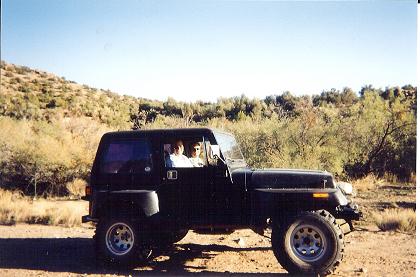

Hey Lee, I found an old pic of my old black YJ!! yeah I used to own one too. I didn't want to drop it because my swampers would o rubbed.

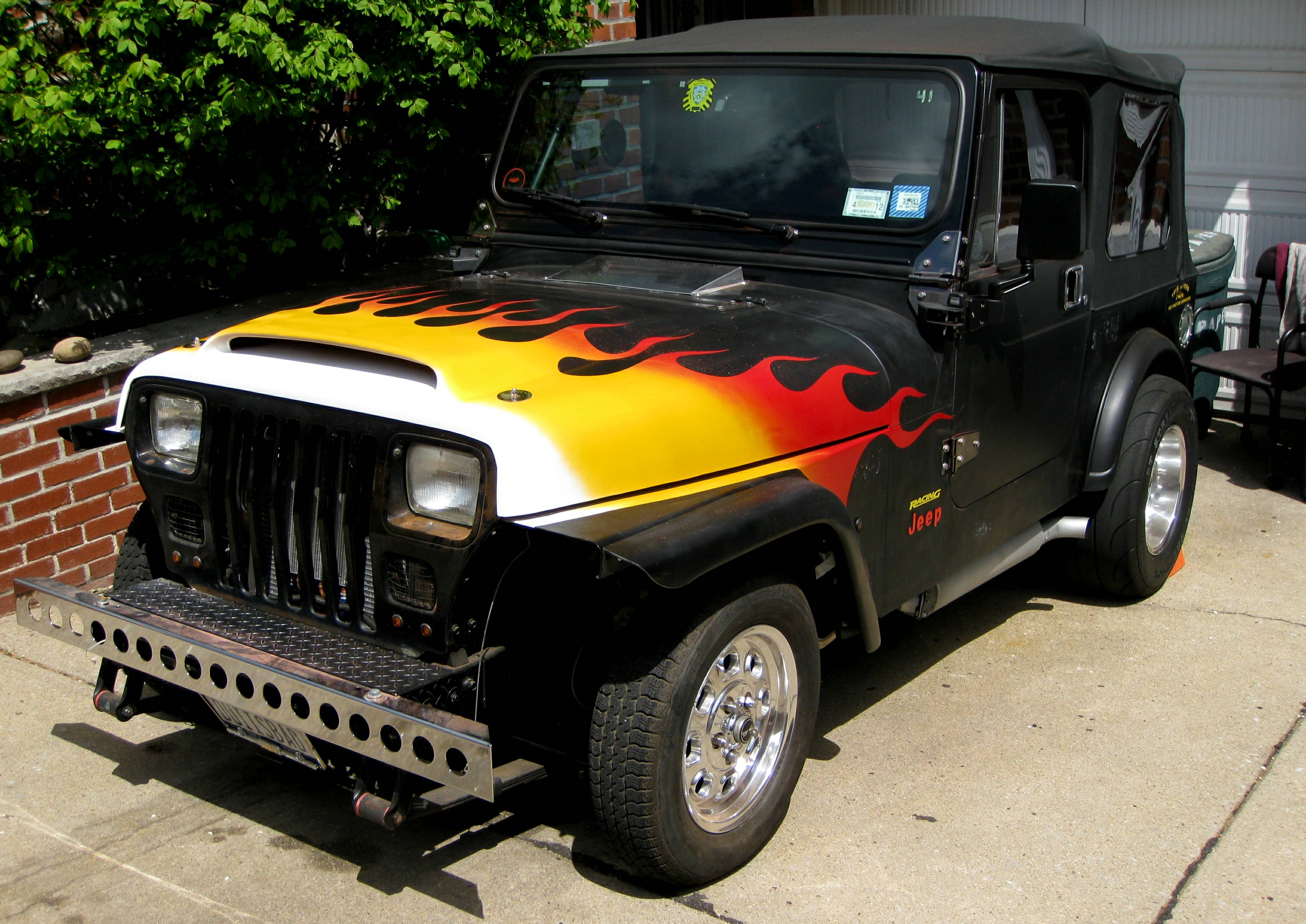

I had my Jeep at the shop today putting in a front stabilizer (single shock). Huge difference, by the way. Several people that came by asked if it was still four wheel drive. I told them that I didnt need it anymore, since my rear tires are now twice as wide so I get the same amount of traction:lol:

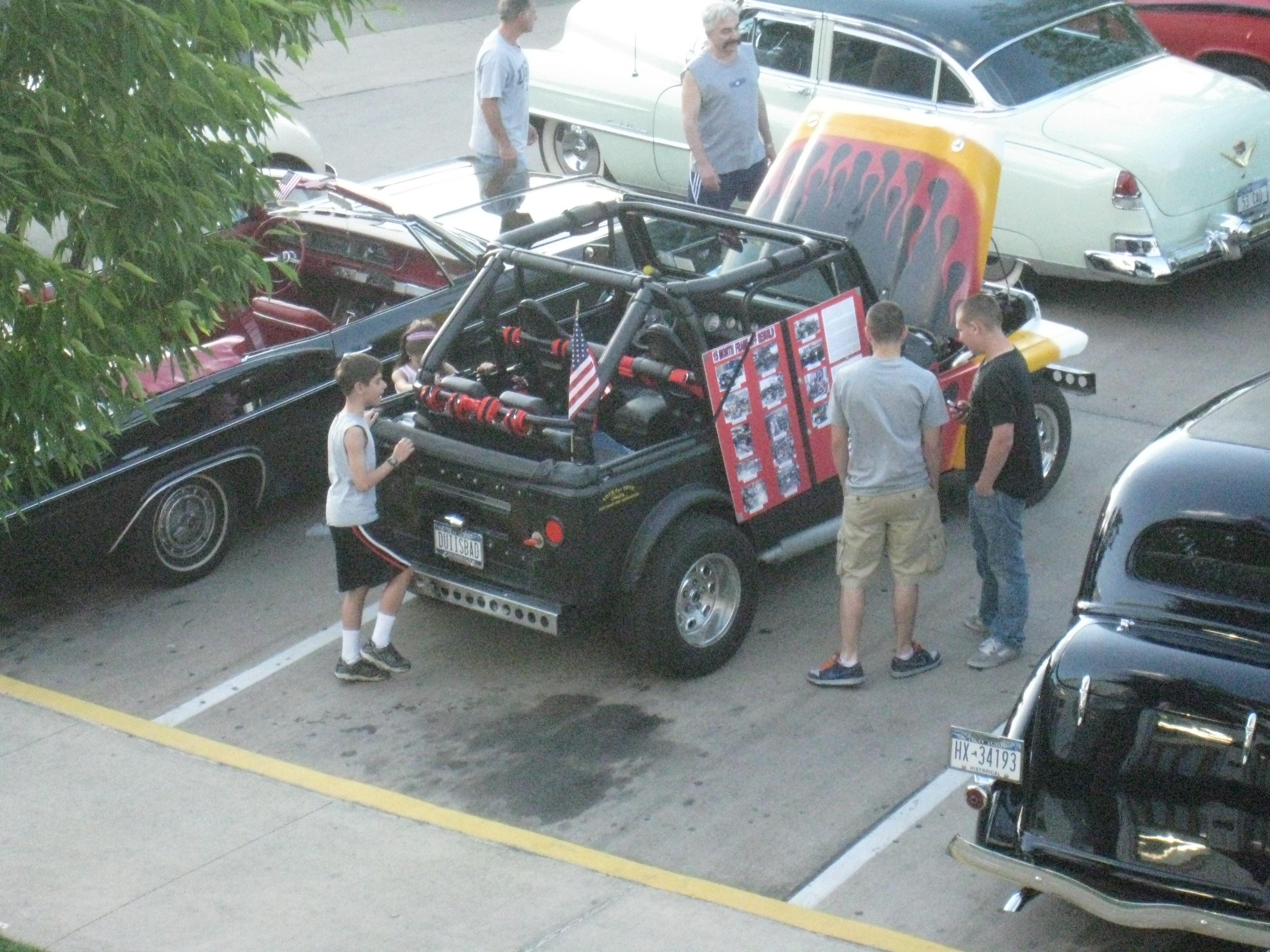

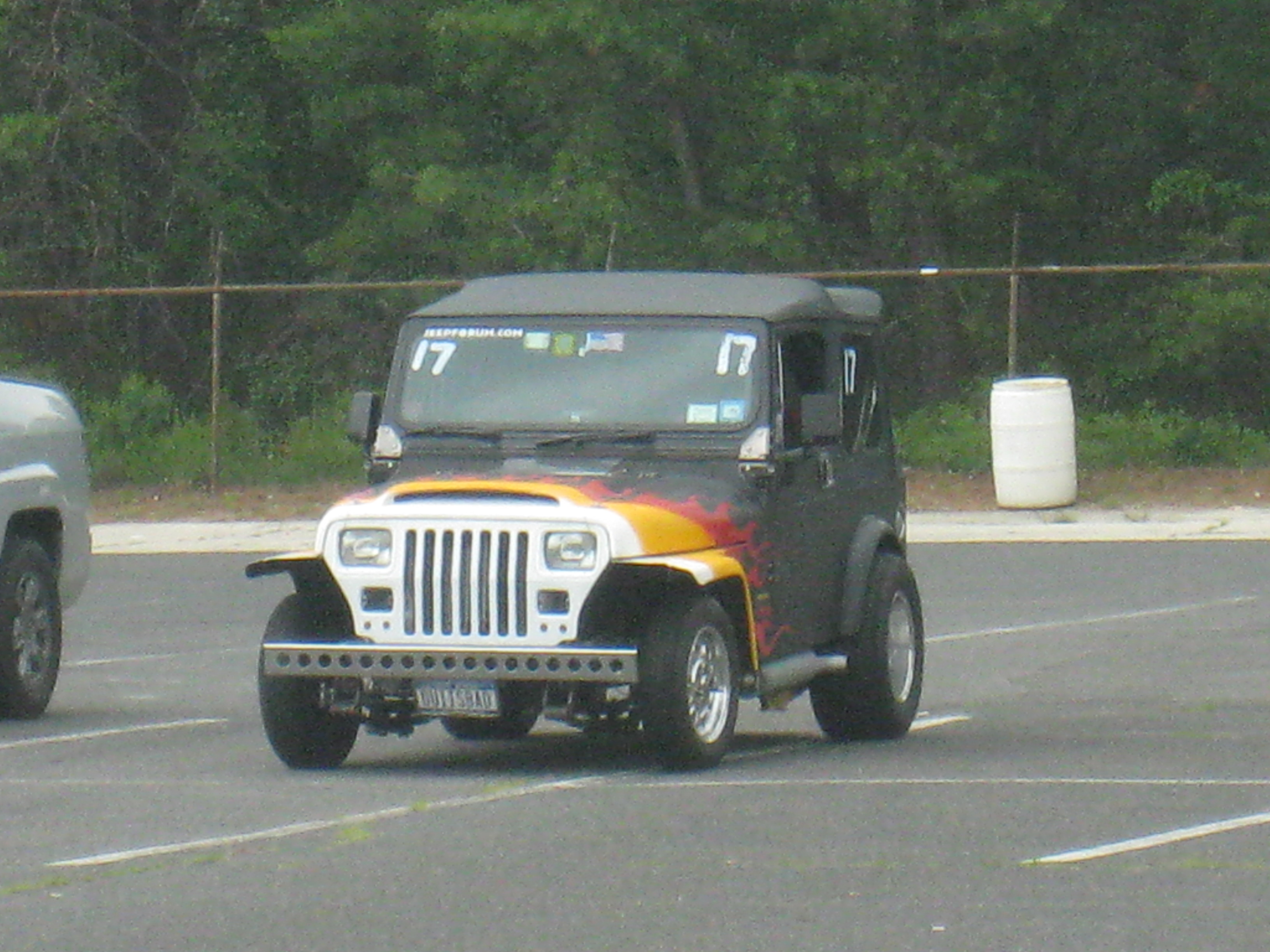

Gets lots of attention at shows. Took it to the track a few days ago-best time 13.1. Needs head work-rocker studs never threaded and pulling out. Plan on getting Edelbrock heads and roller cam for an actual 410-430 HP.
