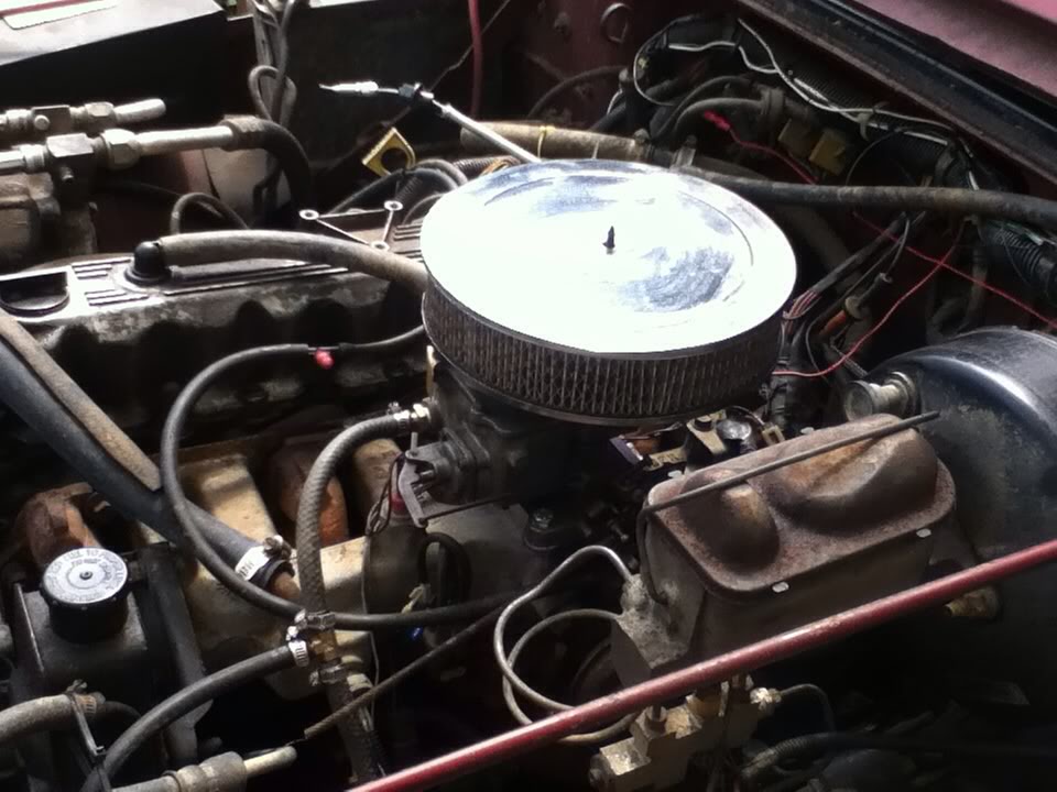

i got a 1.21 venturi carb from a buddy here in town that ran it on his yj. he said it ran fine but i couldn;t get it to run right. had a hunting idle and ran rich with 54 jets in it. so i swapped to this 1.14 carb that i got from an 82 bronco sunday. cleaned it up and its doing good but the test will be the cruise down the highway so i will let ya'll know later
new carb

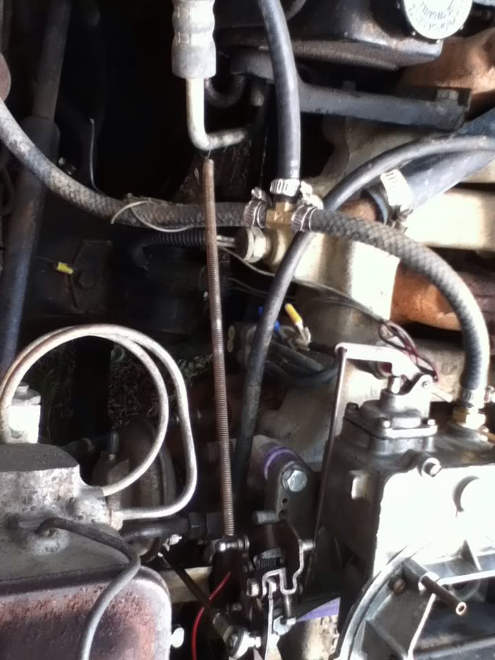

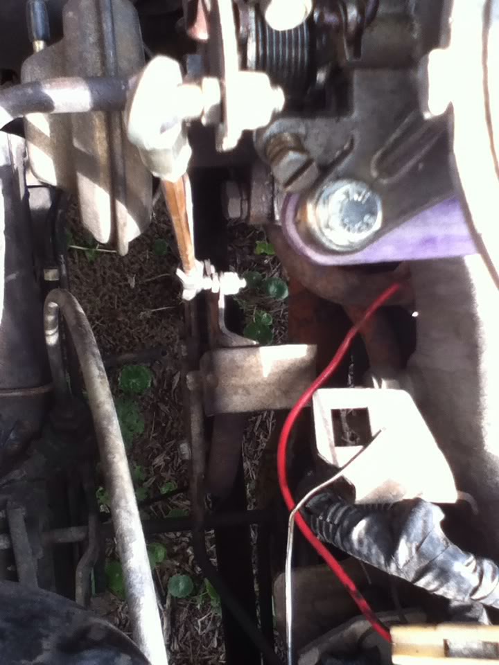

linkage
linkage
linkage

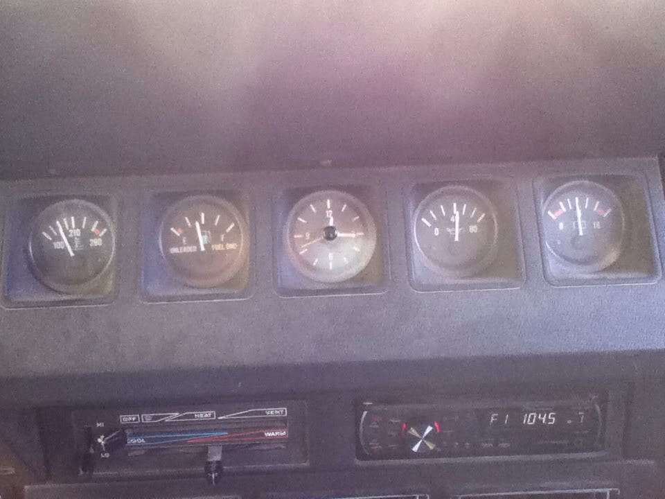

gauges

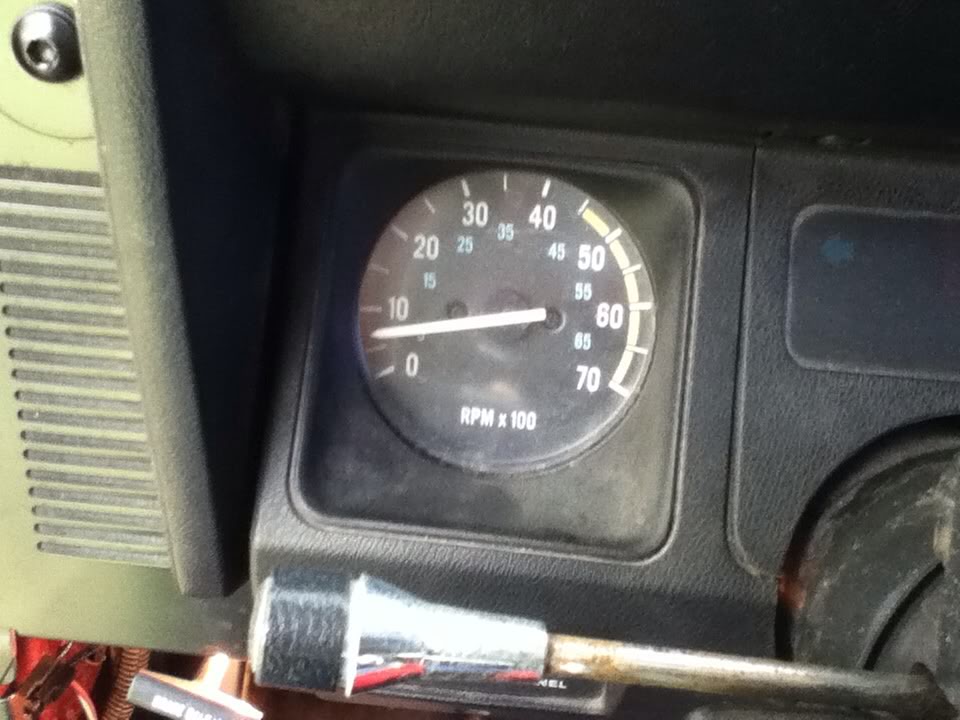

idle in neutral

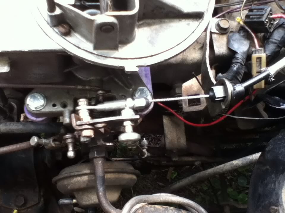

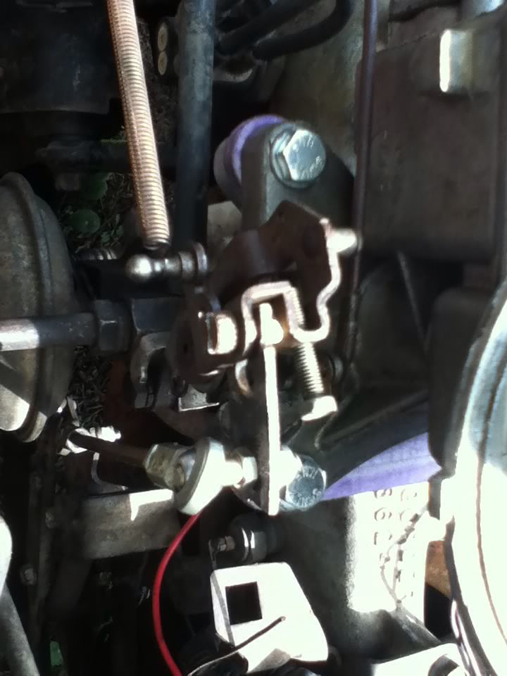

the only trouble i am having is an of idle bog. it acts like an accelerator pump but i am getting fuel so maybe the linkage is set too high.
what hole is ya'lls linkage set into? mine is on the top one.

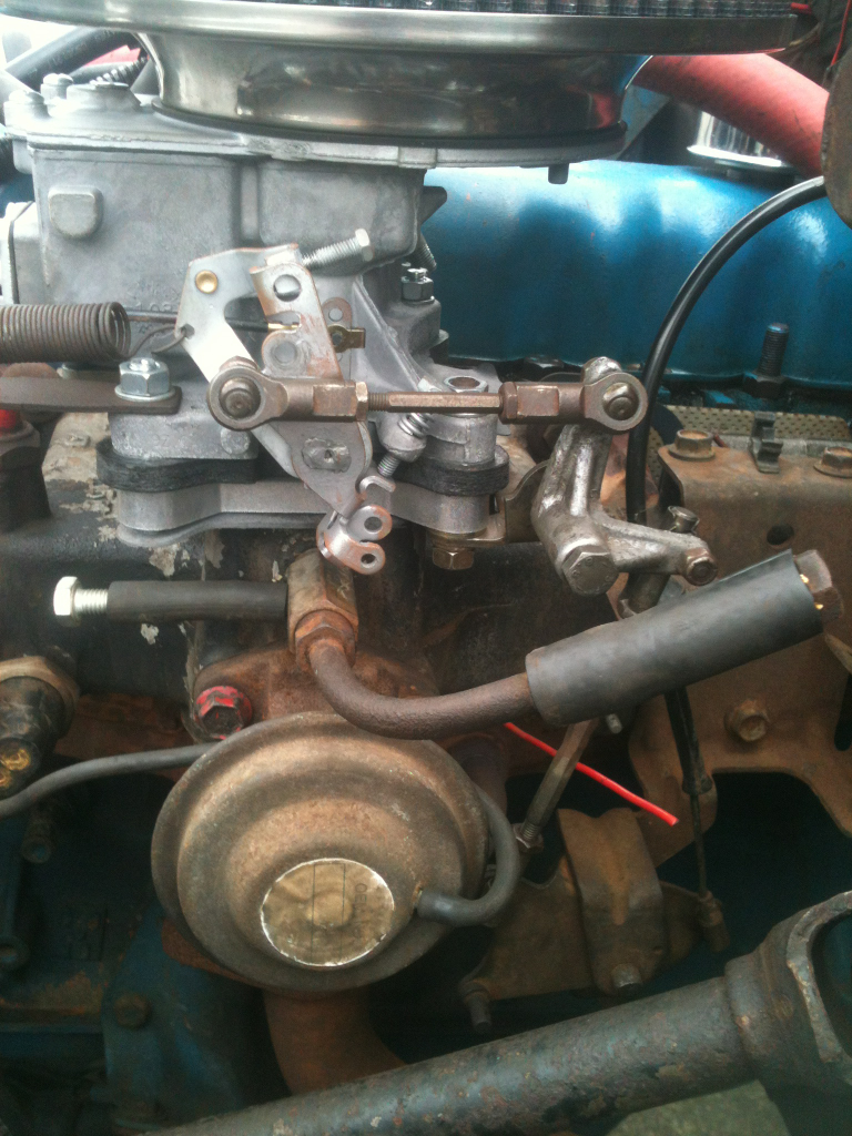

And the award for best photo documentary goes too.......Superj haha lol. Mines on the top hole also. Don't like how it feels. I also used the pivot bracket from the weber. I see yours is direct to the carb. I'm going to try that. The way it is now, it snaps the throttle back to quickly.
Here's a picture of mine.
