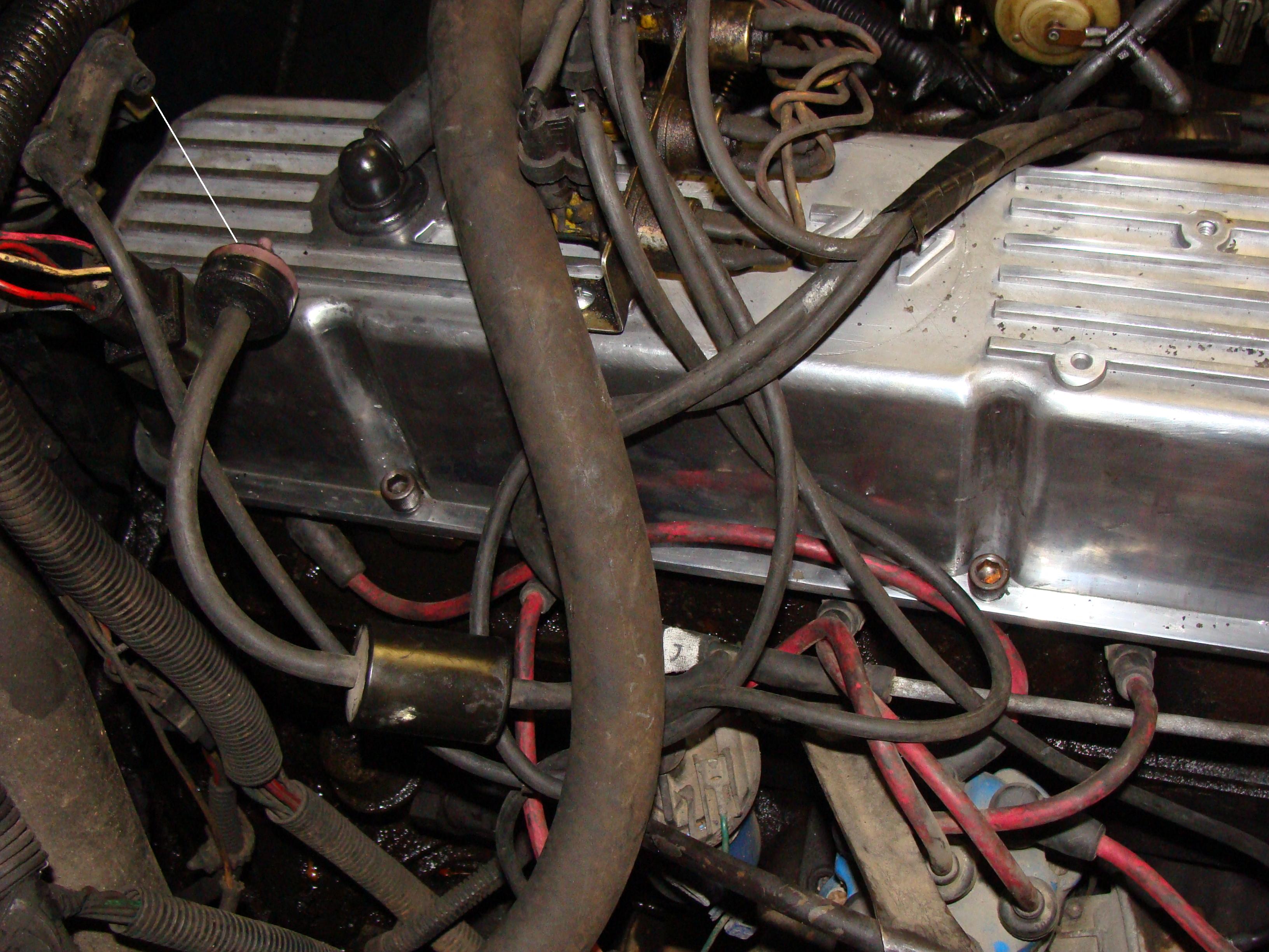

The real reason for this post is the configuration of the vacuum hoses. In the process of taking the valve cover off, I don't think I've got them all reconnected correctly. Before, the engine idled and ran very smoothly...now, it has a rough idle. Does anyone have a photo of the connections? I've looked at the diagram and cannot follow it either.
I think I'll send some pictures tomorrow so you guys can assess all that I need to do first...oh yeah, if anyone happens to know of a good CJ mechanic in the Nashville area, please let me know.

Well, I found the problem. If you look at the photo, in the upper left part of the picture there is a hose that was connected to the port coming out of the firewall. I have drawn a white line to where it was connected. As soon as I disconnected this hose, the engine immediately smoothed out. Now the question is...where does this hose go?
Any suggestions?

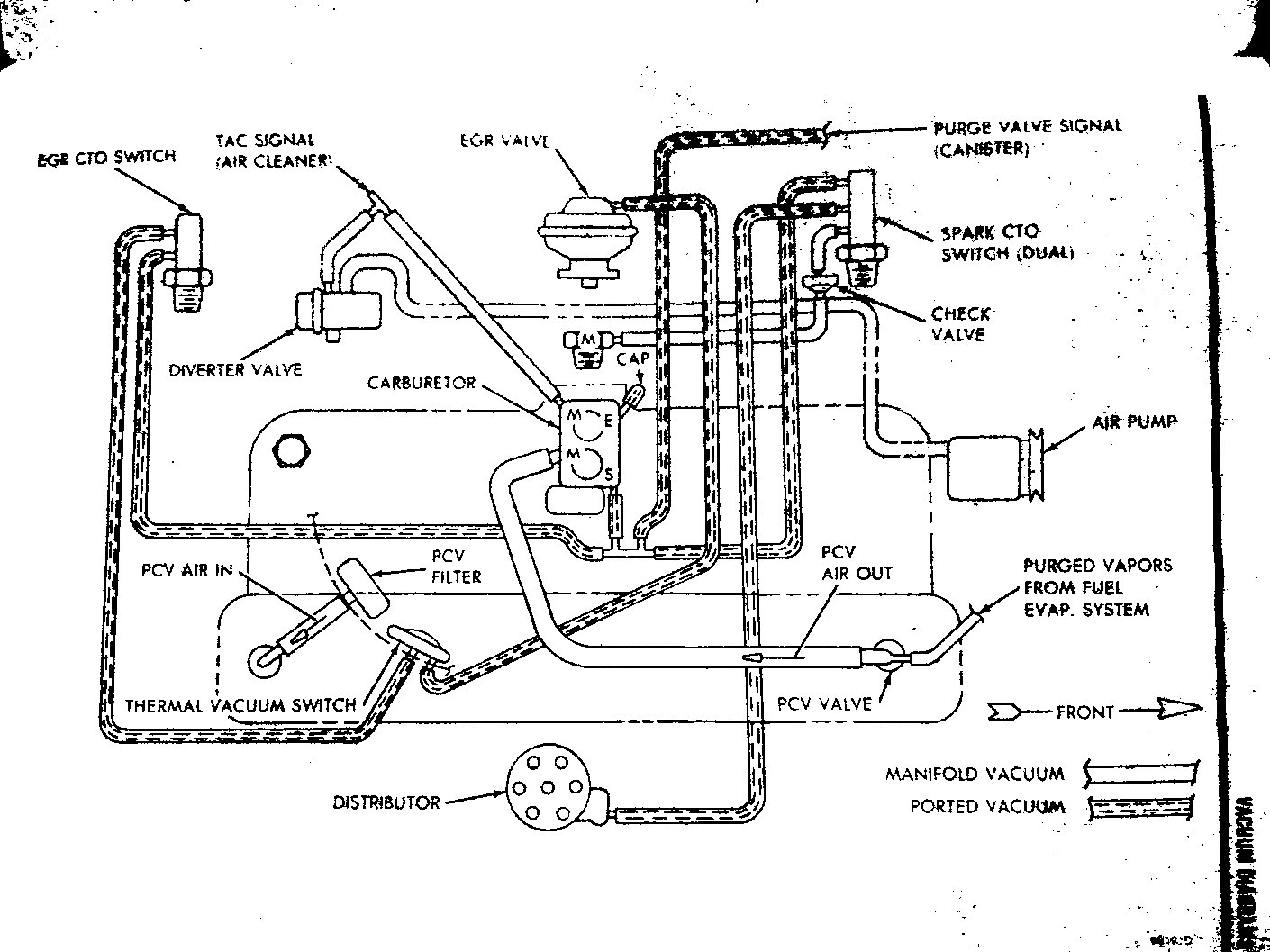

Would this help?

Now this makes sense to me! Thanks for sending this...you guys are awesome.
