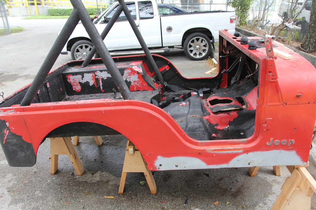

We are just lovin ' this build ! Got a little surface rust here and there , but nothing scary at all , she's solid ! This jeep is a dream ! I'm so glad someone tried to coat it to preserve the body , it worked fairly well . Maybe they did not prep it well enough as it's flaking off , but it helped save the jeep from rusting to dust. I know you'll have everything sparkling in fresh paint soon !
even the wiring harness don't look too bad ! This build is moving at light speed , we better not blink or we'll miss something ! The metal products you have will go a long way to dress any issues with the metal . It'll be fine . You the man mresky !
Thanks Greg, ya the person did try to protect it a little but they used really cheap stuff. its like a cheap spray on thin coat. Doesn't really do any rust prevention and peels off really easily once you get it started. Check back tomorrow cause I'm going to take it all off. And then once i prep the metal I'm going to put a rust prevention coating with two layers of that and then a top coat layer of paint, and then the final coats of paint over that. So it will be very rust resistant when I'm done with it. As far as the wire harness ya its in pretty good shape. theres a few wires that aren't needed so i gotta get rid of them and then just all the connectors need cleaning and are a little lose. so gotta fix that.

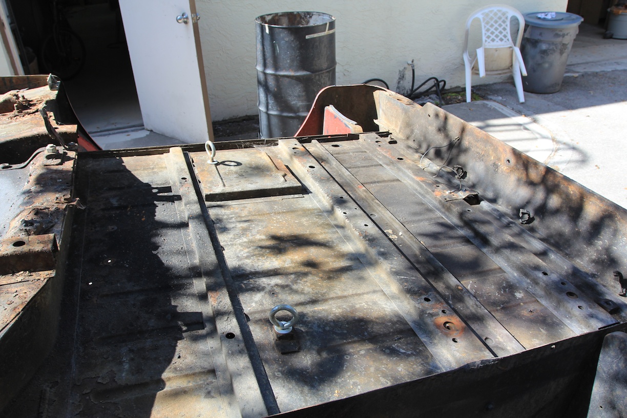

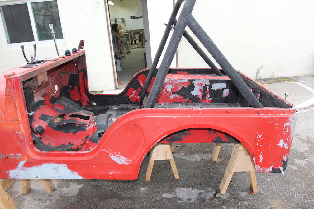

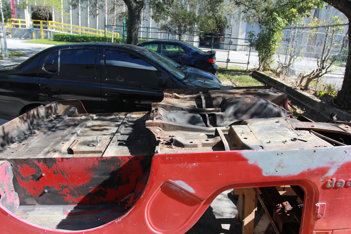

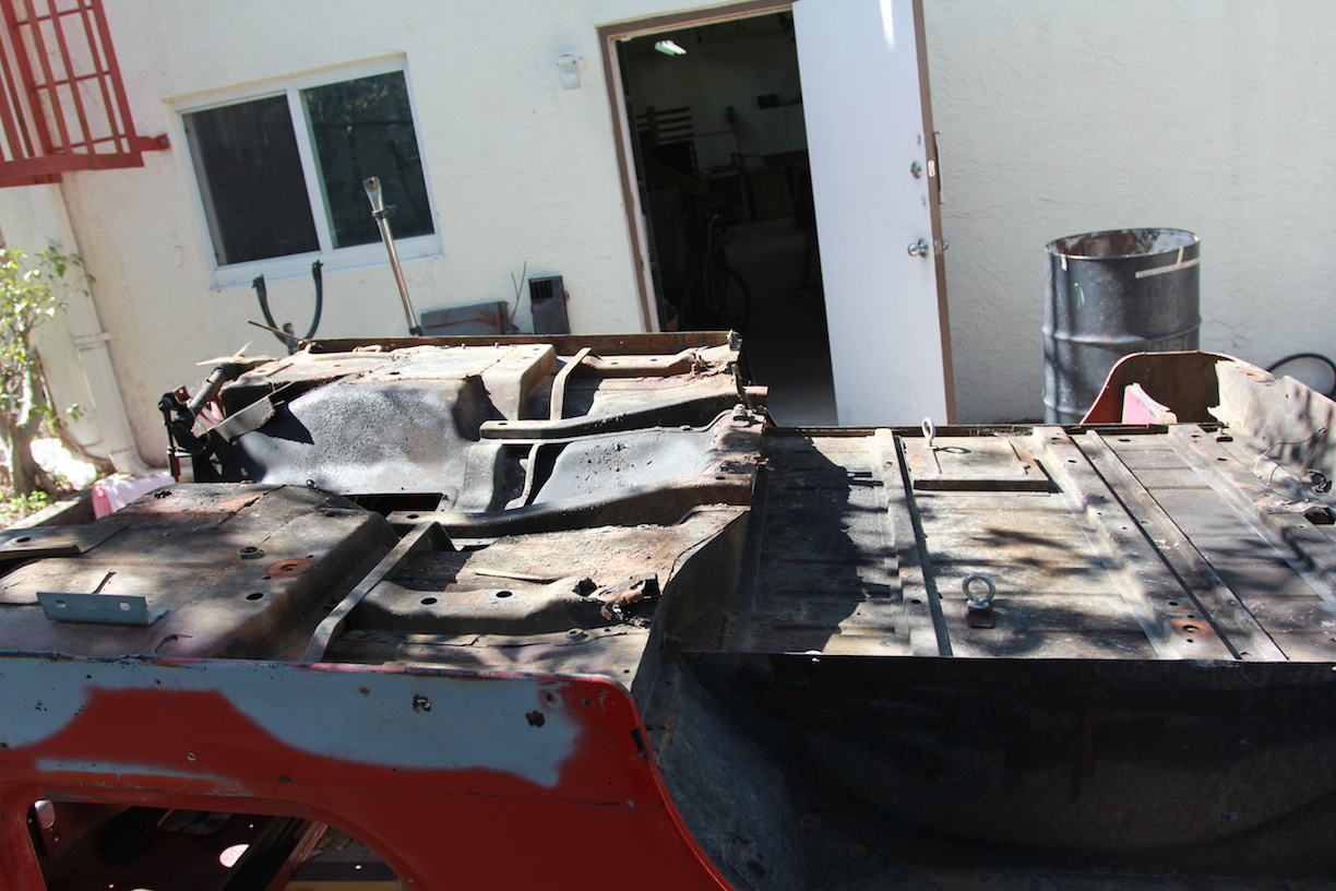

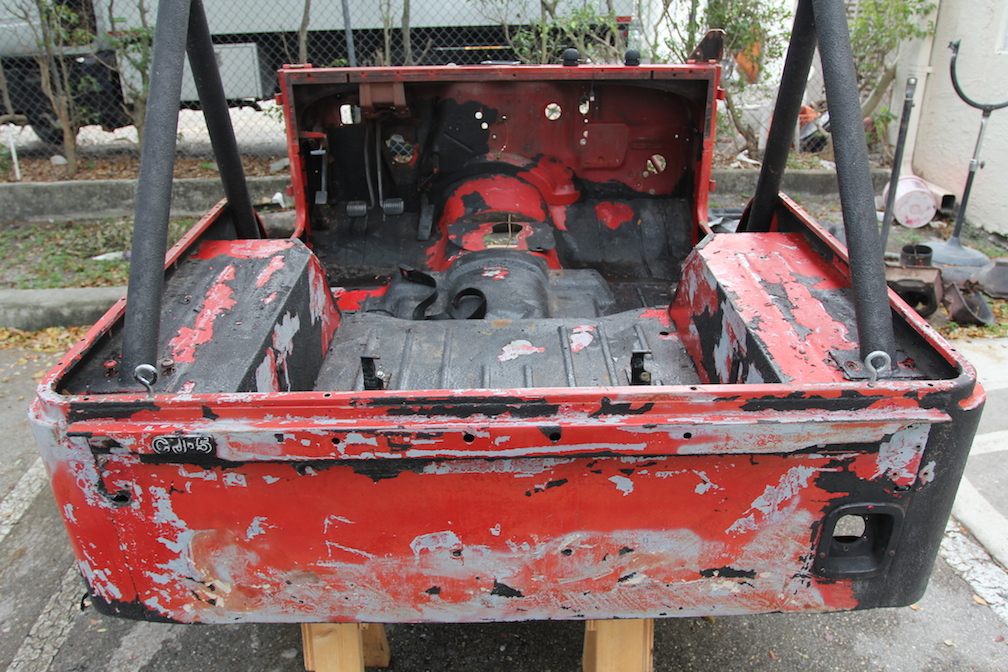

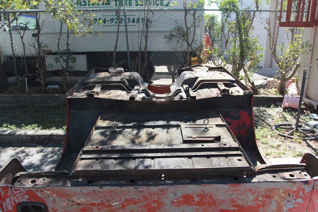

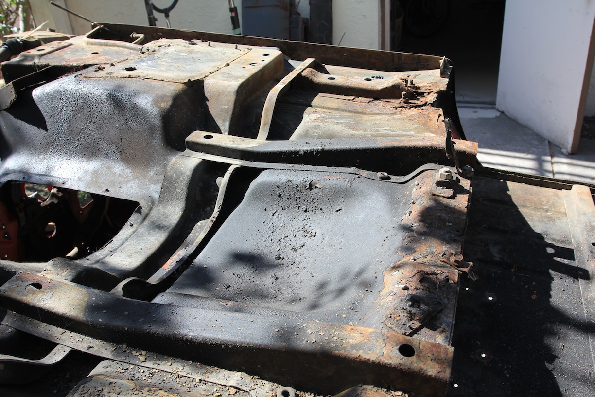

Hi everyone, so today i started removing all the cheap knock off line x that the previous owner spread the entire inside of the tub and rear end. The stuff is on there fairly well but with applying a gel stripper and letting it sit it bubbles right up and comes off. I was worried that maybe they placed the line x on the back of the tub to cover rust but theres actually no rust. Just one tiny little hole, altho theres a little bit of filler in one spot but will be easily be taken cared of. I wasn't able to finish it all in one day so i got some more to go.

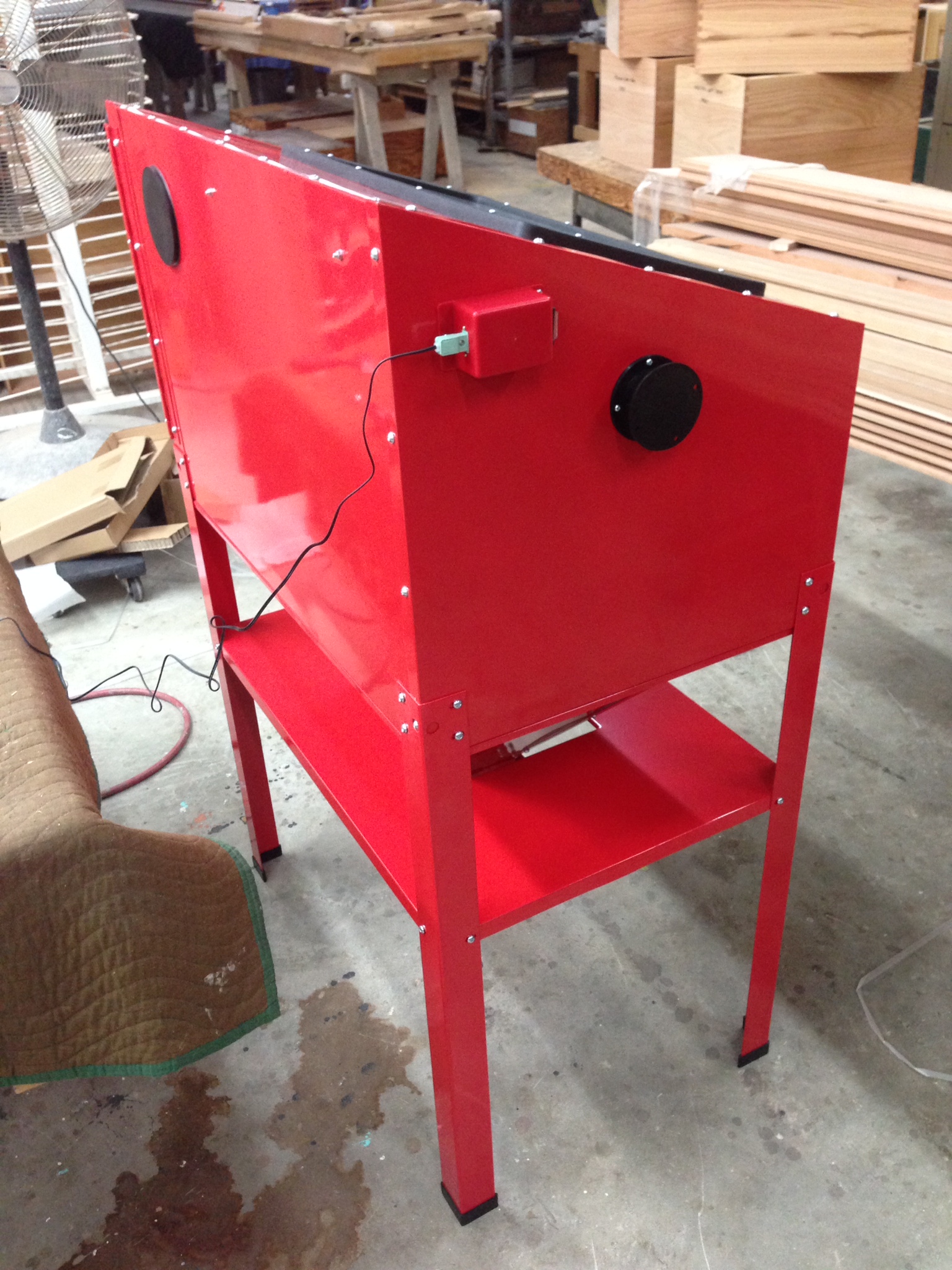

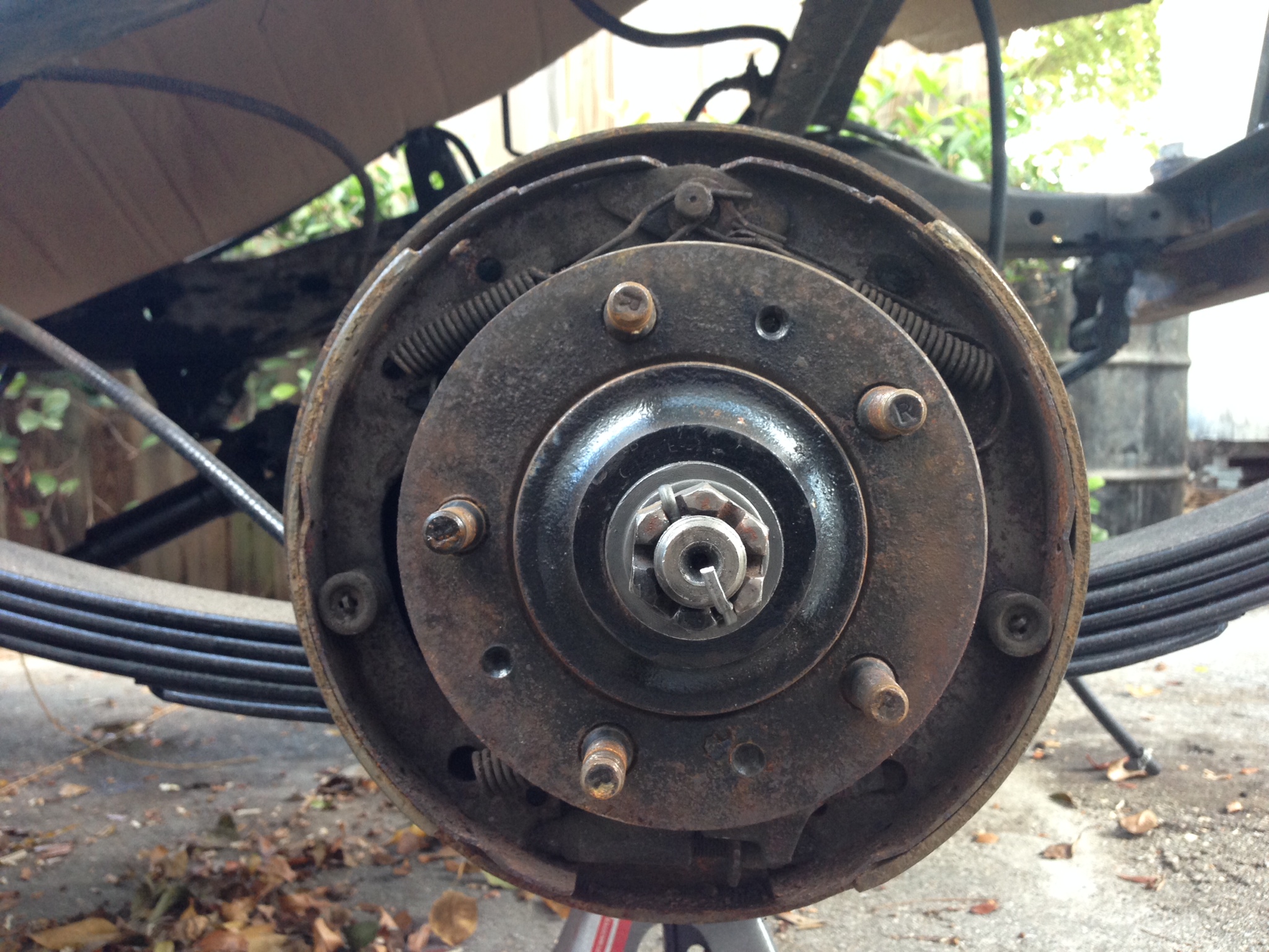

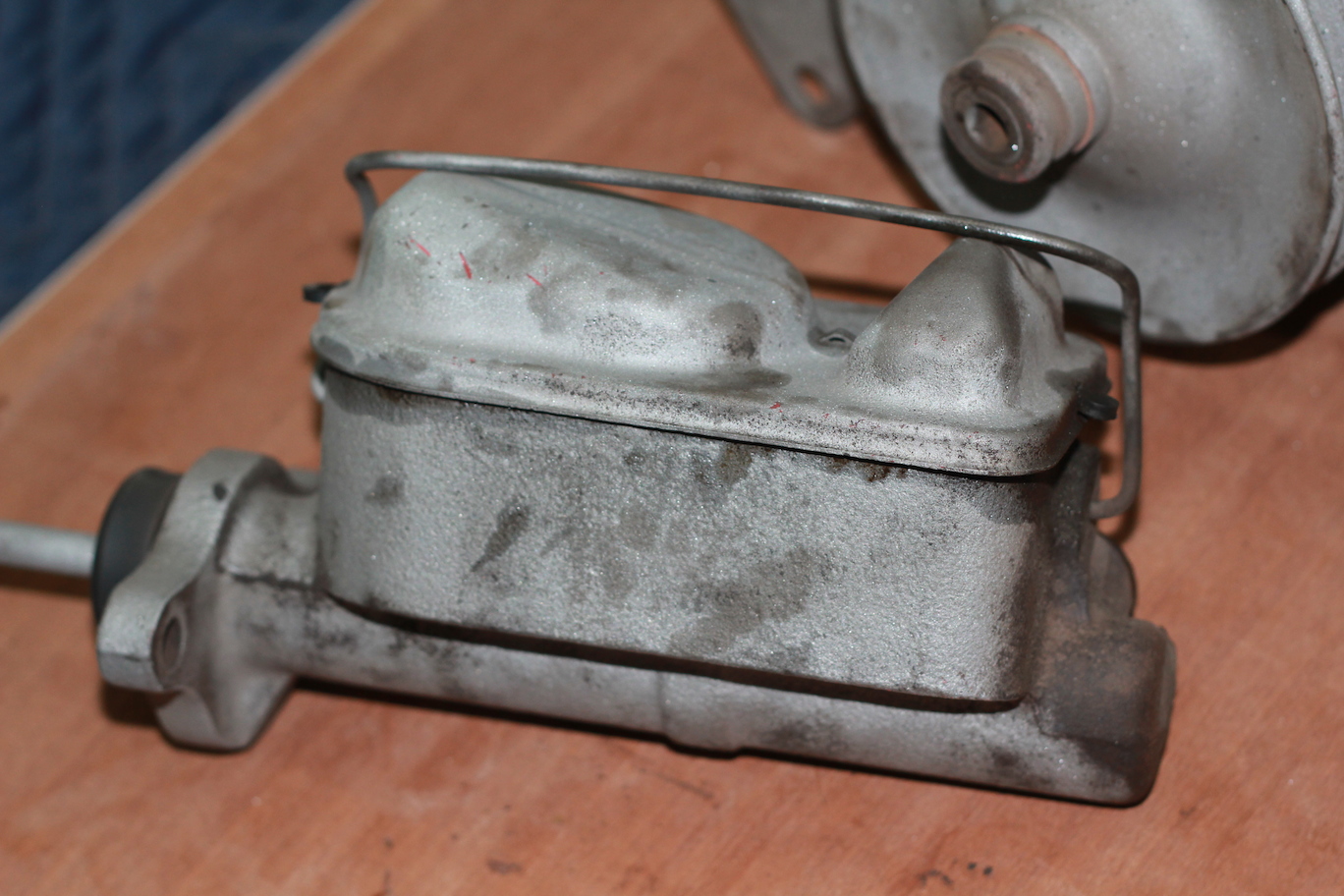

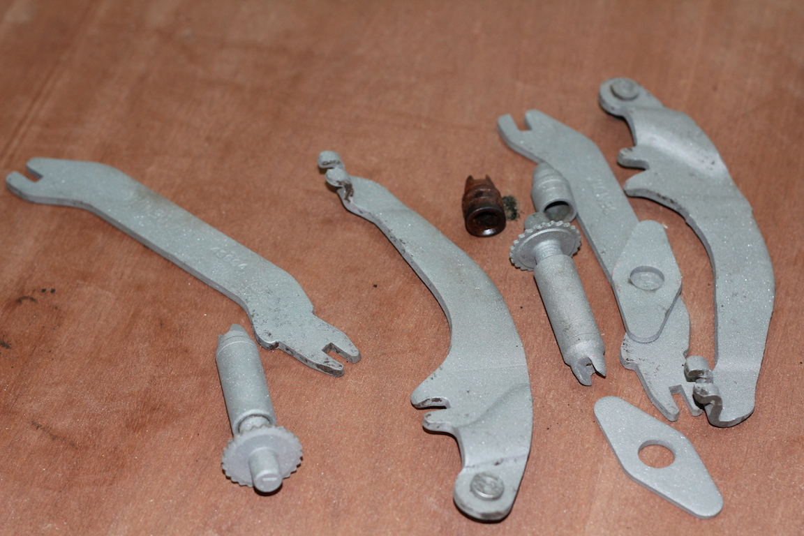

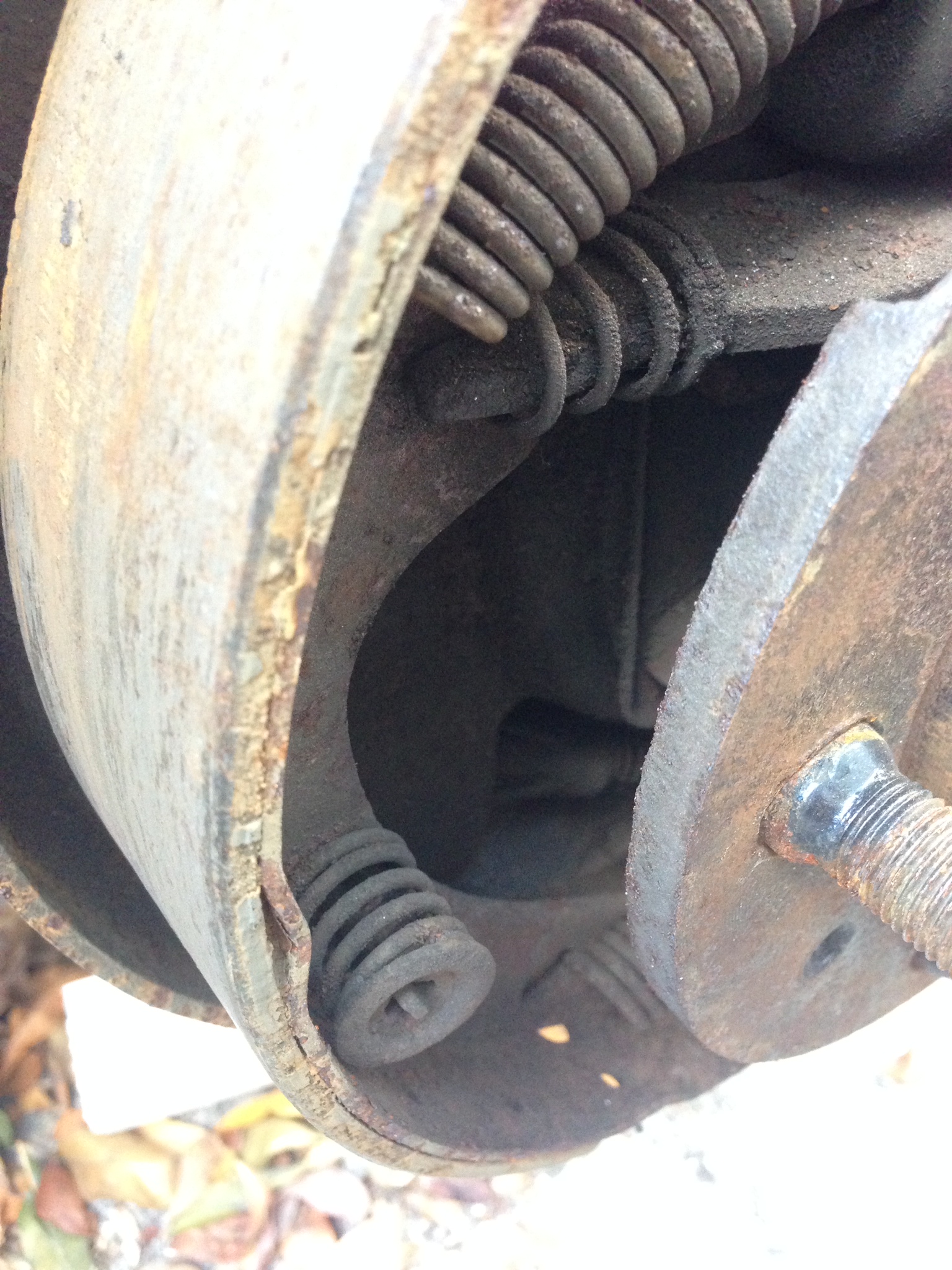

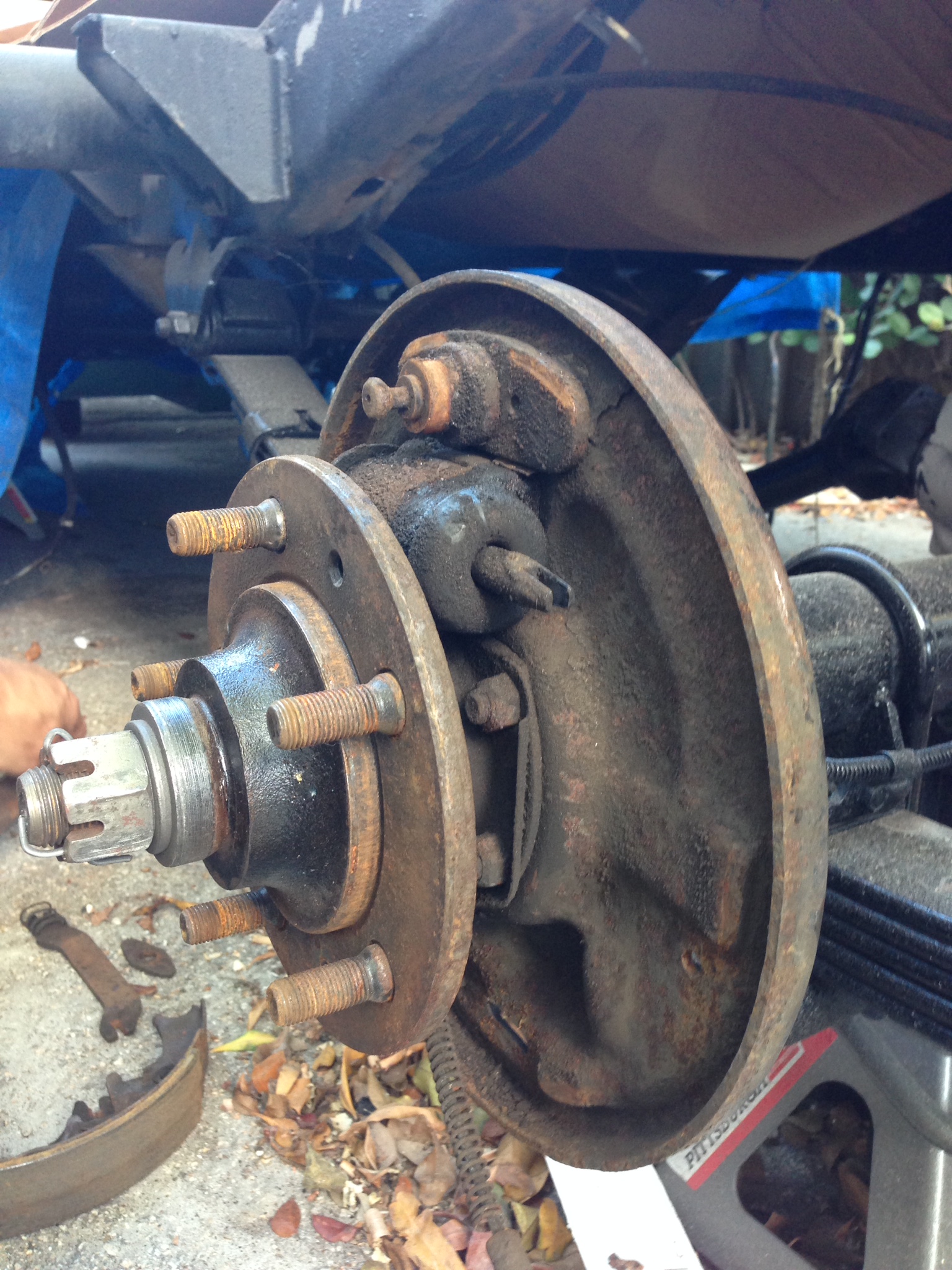

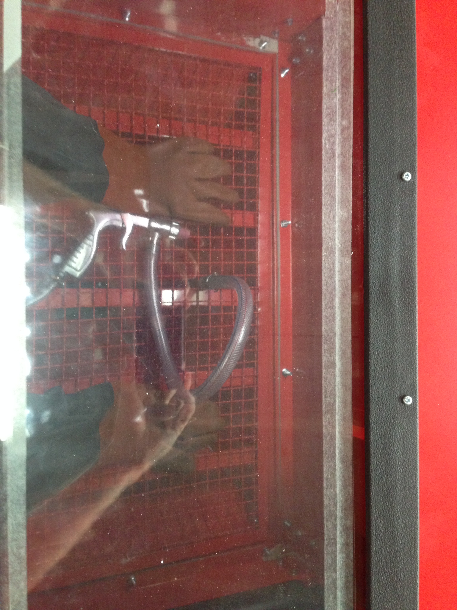

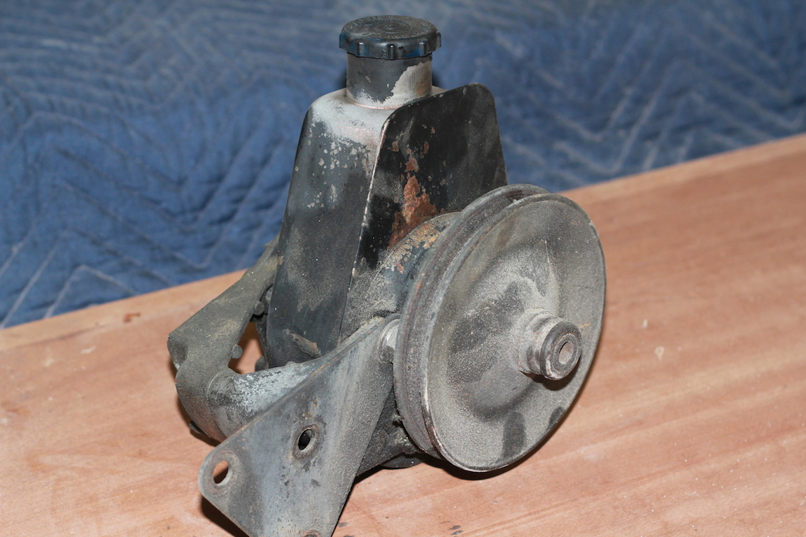

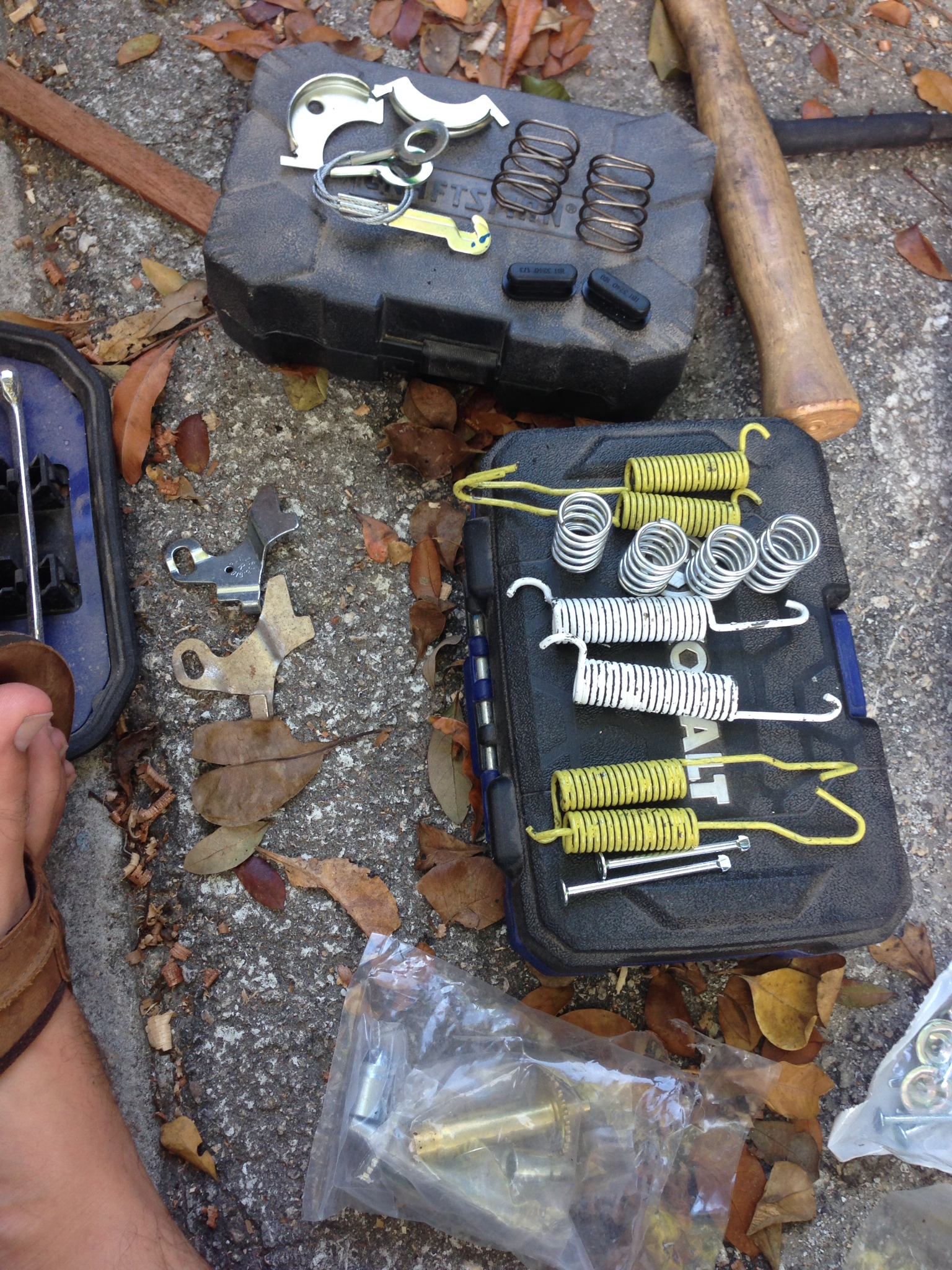

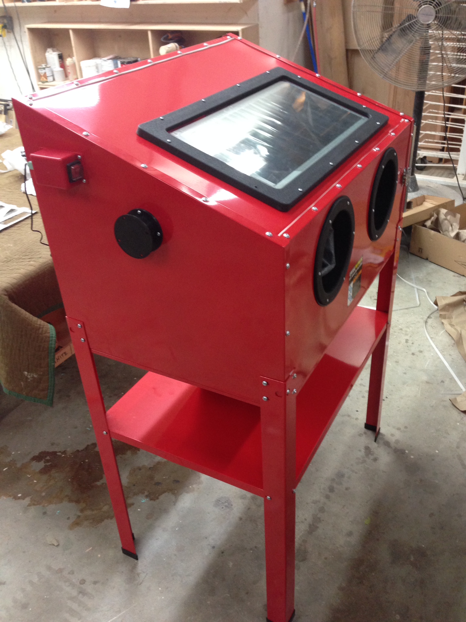

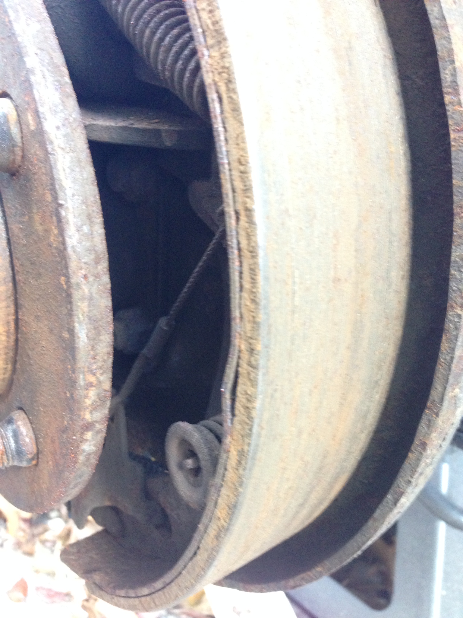

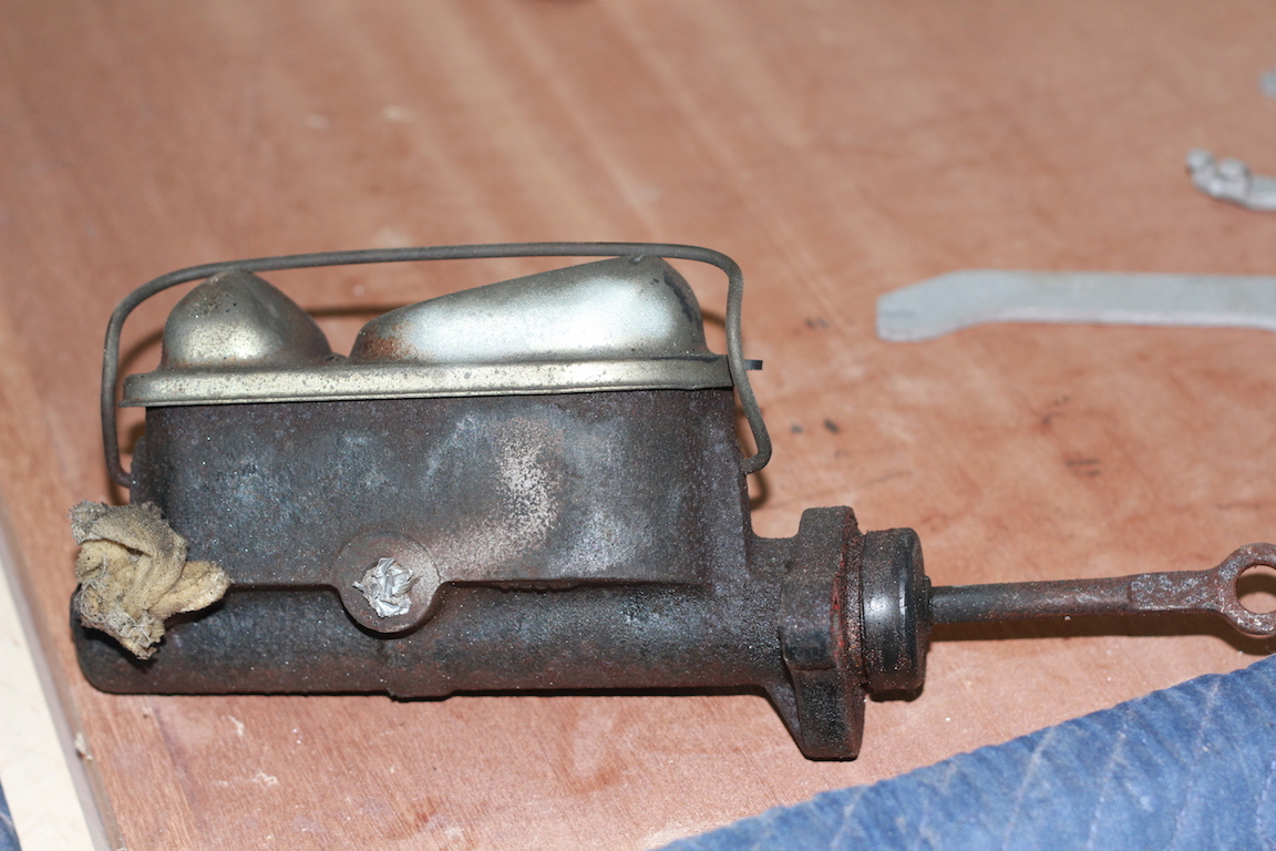

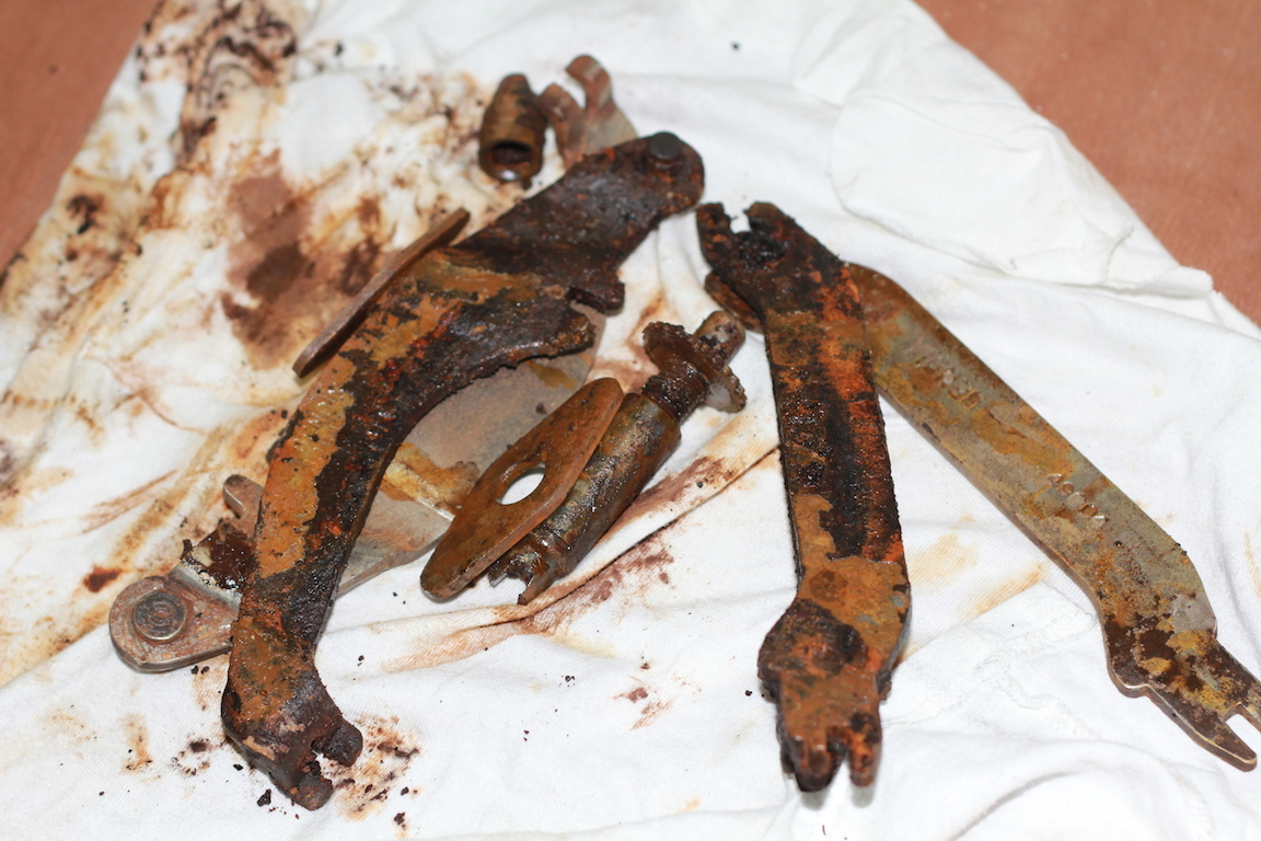

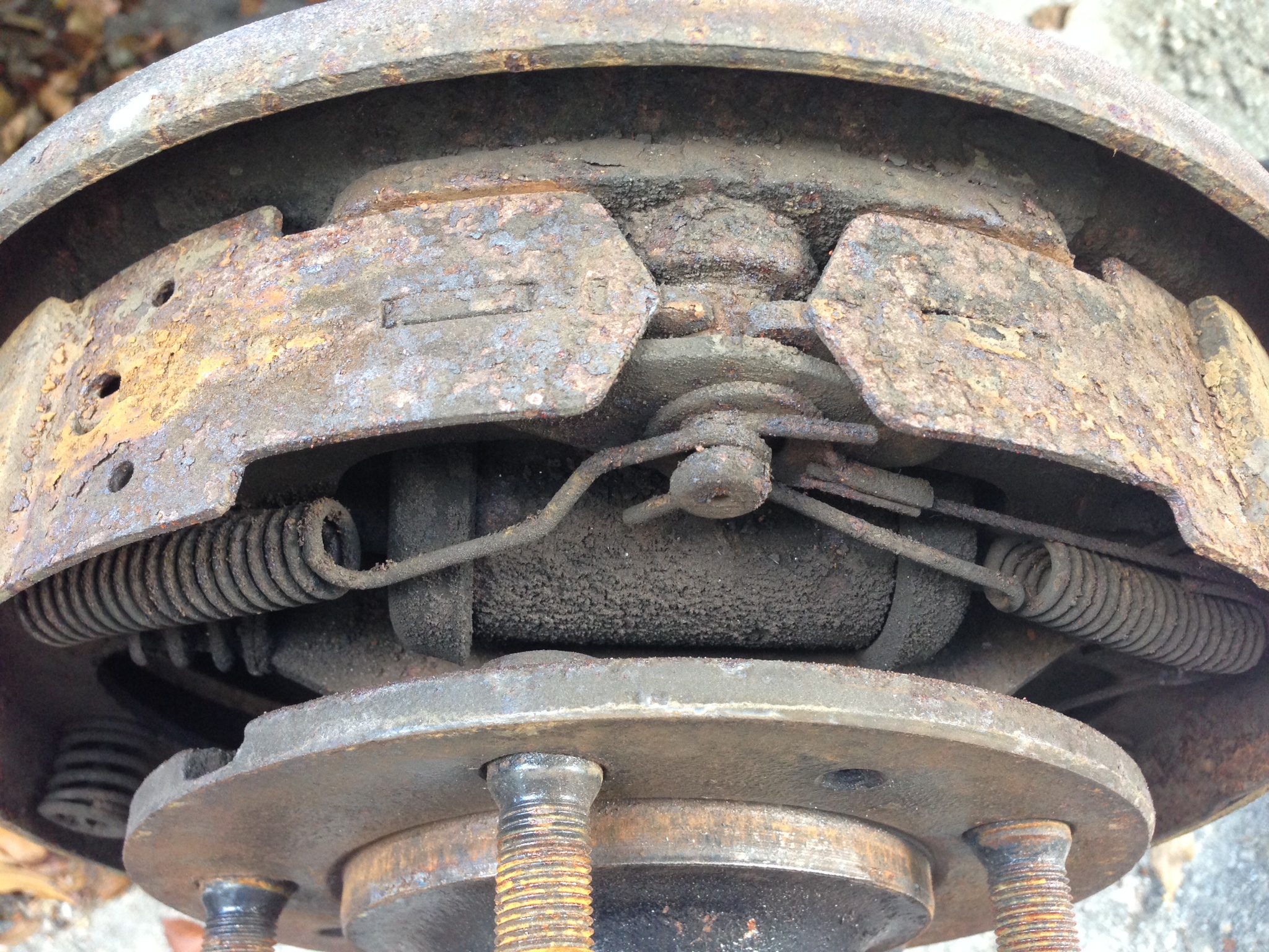

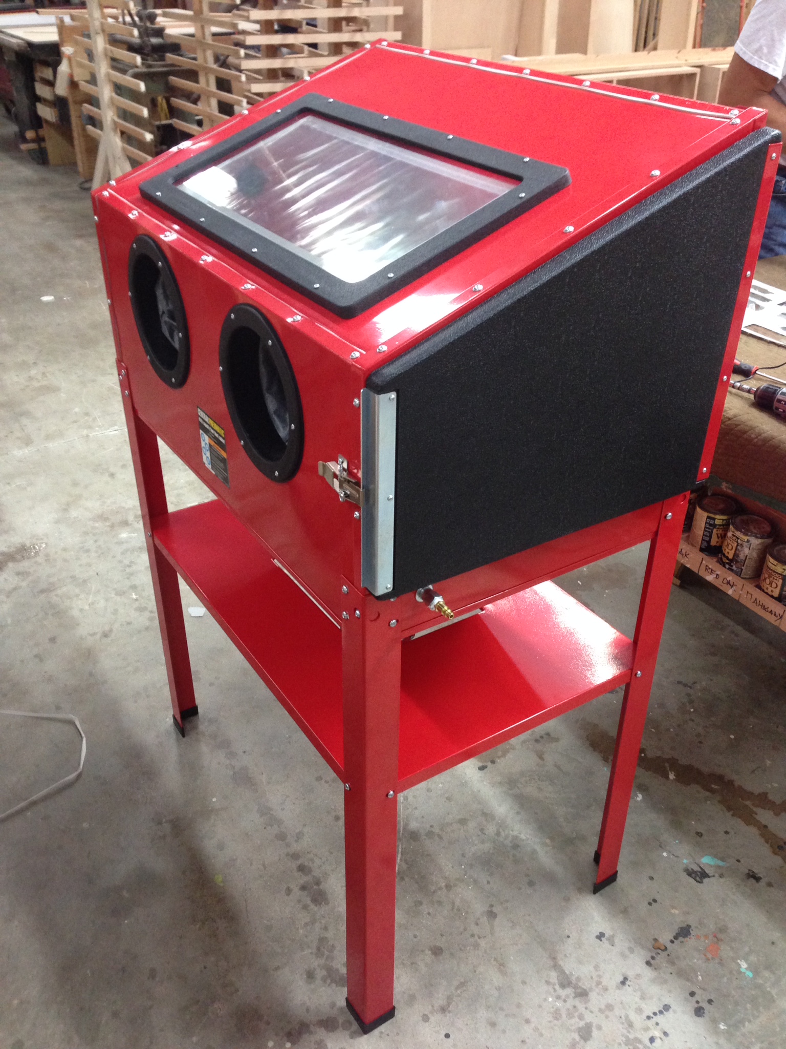

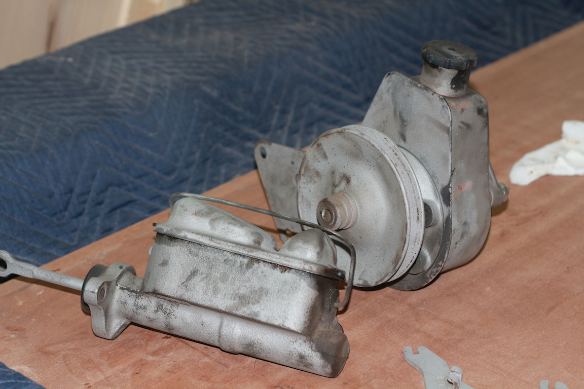

Hey everyone, so I started doing work on my brakes. I got all the springs and pad disassembled and got a rebuild kit and will be putting it all back together. I also got a new sandblasting machine and finished putting that together.

Wow , following your build is now reminding me of a '59 cj5 for sale in the Keys . $5000 , but I cannot get the cash in time and must be sold . Nice clean jeep like yours . Probably just needs a little work and must be fun to drive a classic F head 134 . Got it posted in a thread called " what's wrong with this picture ? " it's red . Gotta love that blasting cabinet !

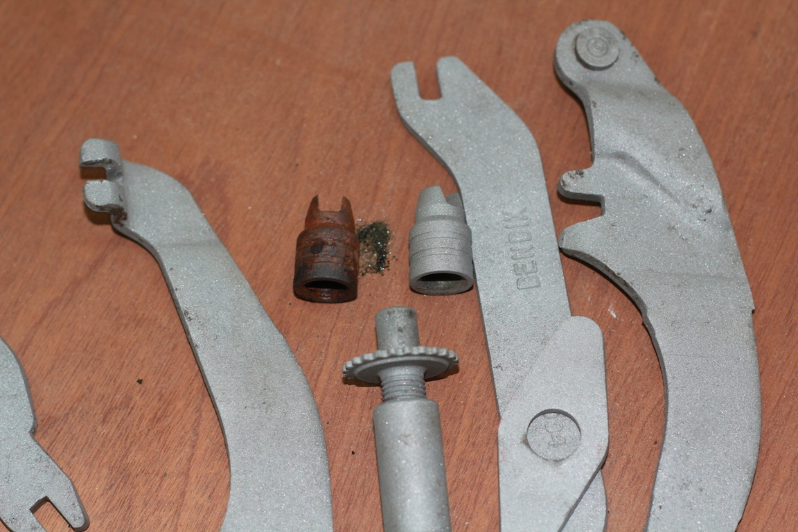

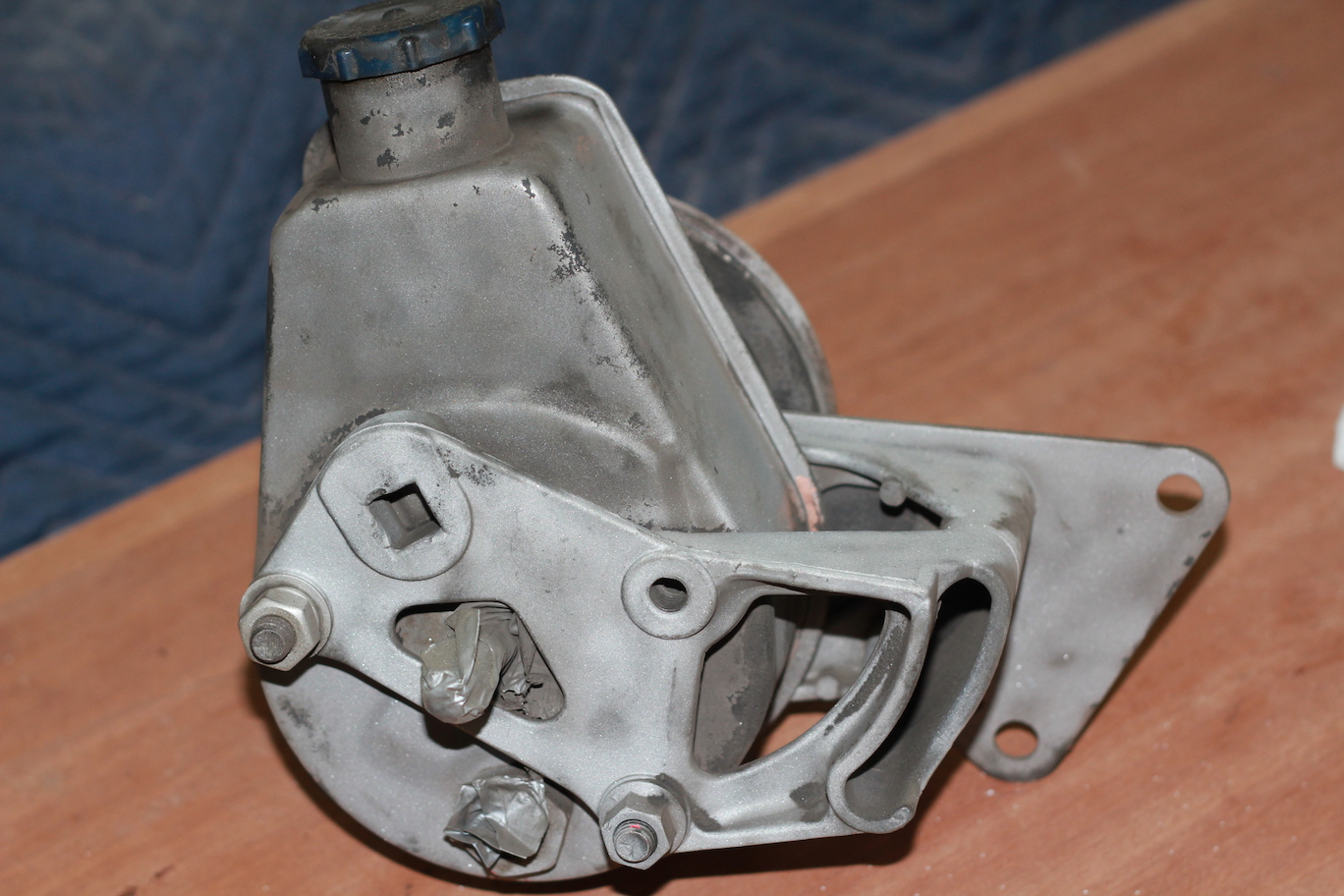

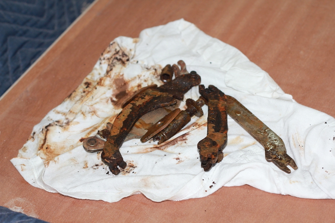

hey everyone, so i played around with the new sandblaster today and the parts came out pretty nice. here they are.

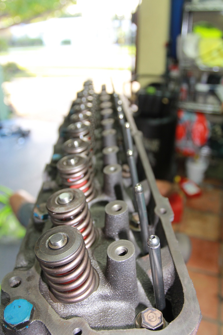

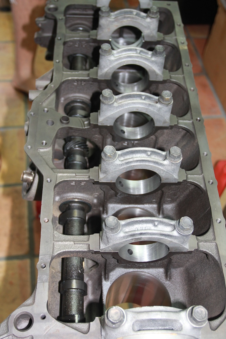

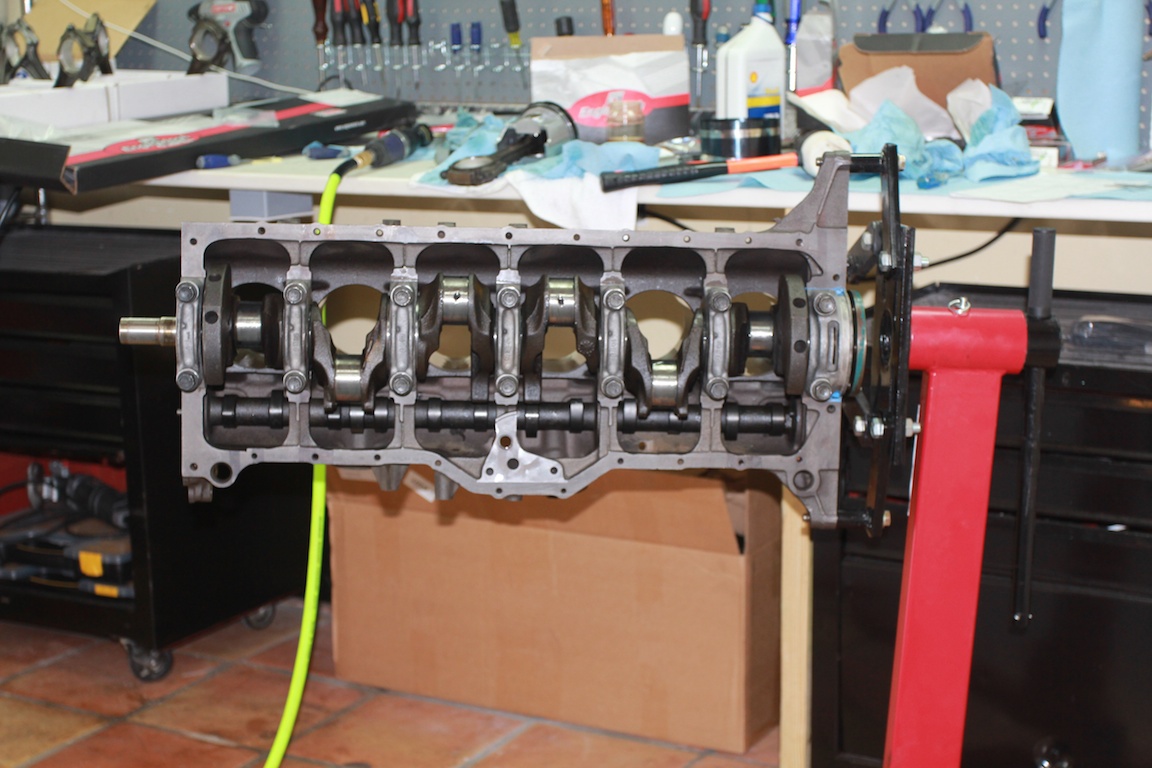

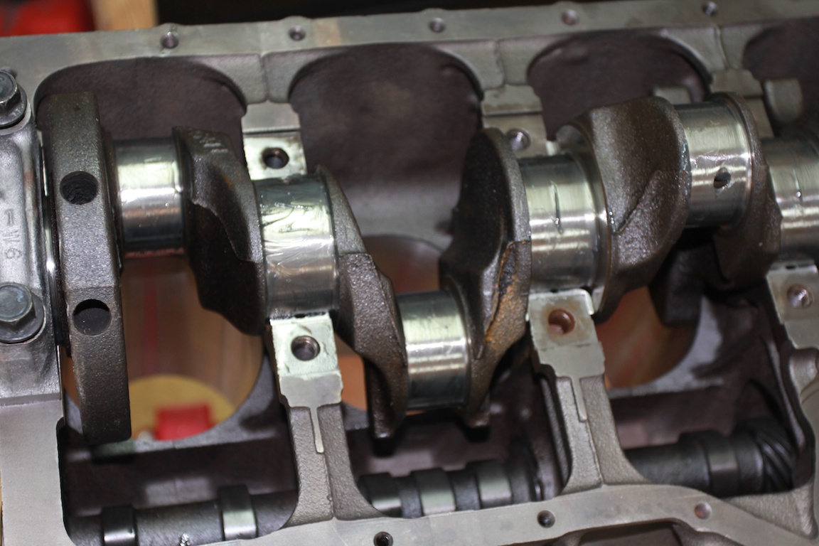

Engine rebuild

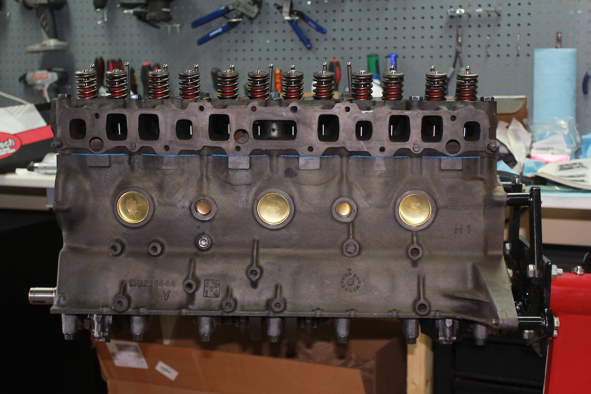

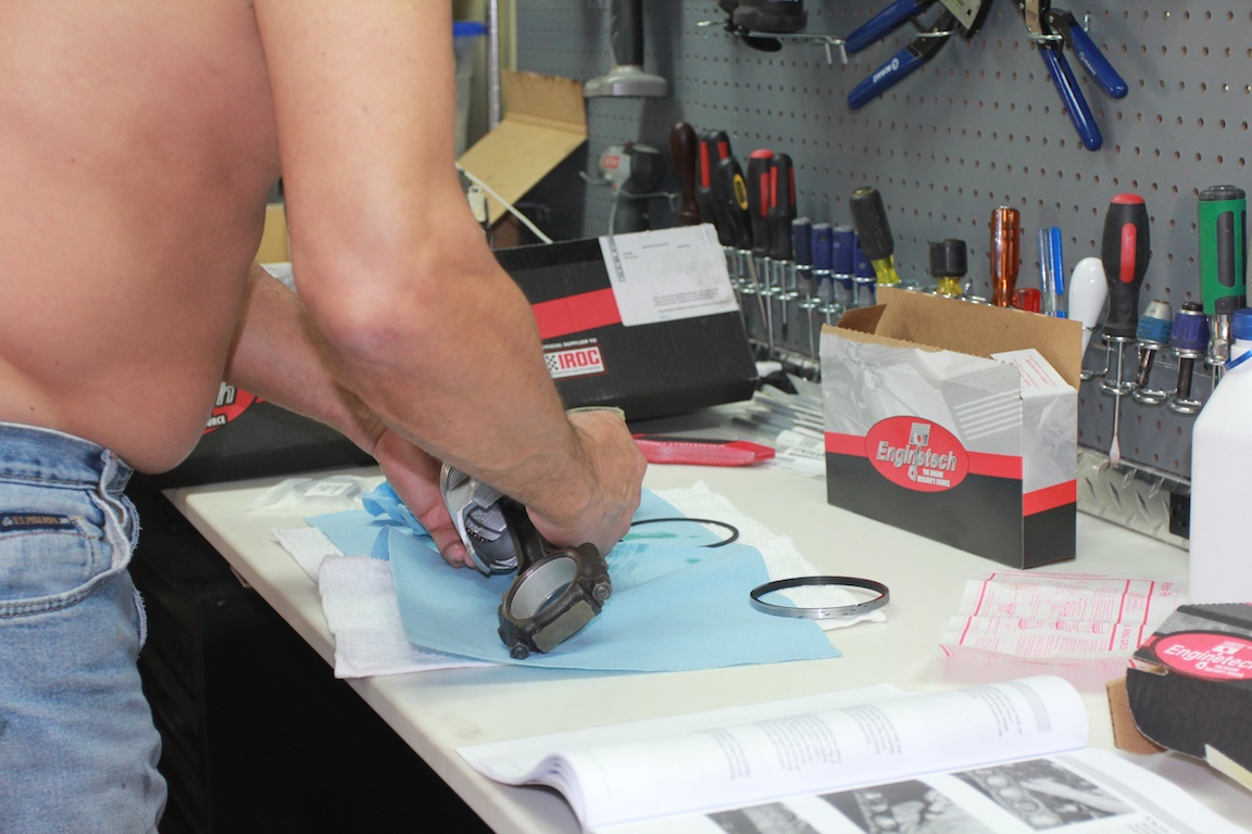

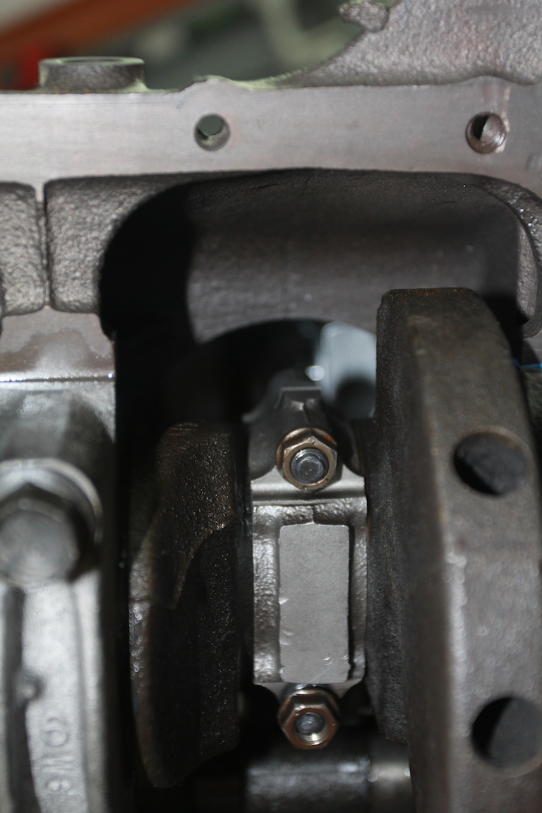

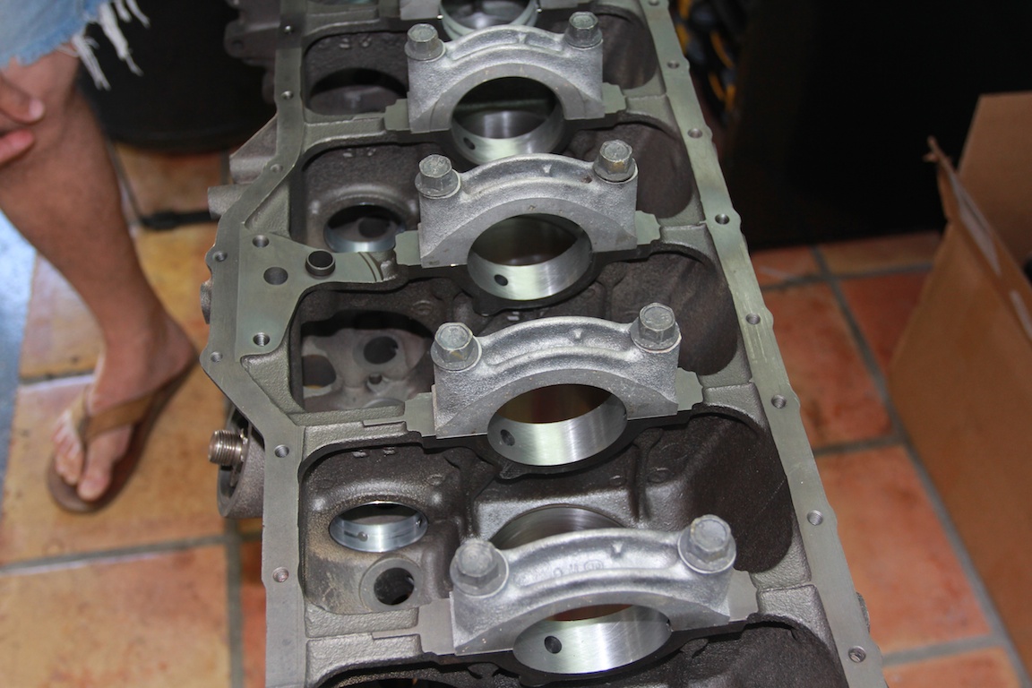

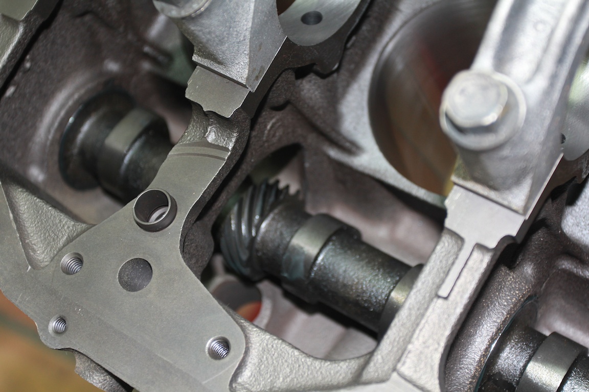

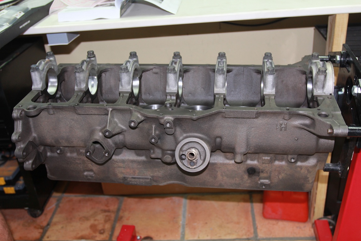

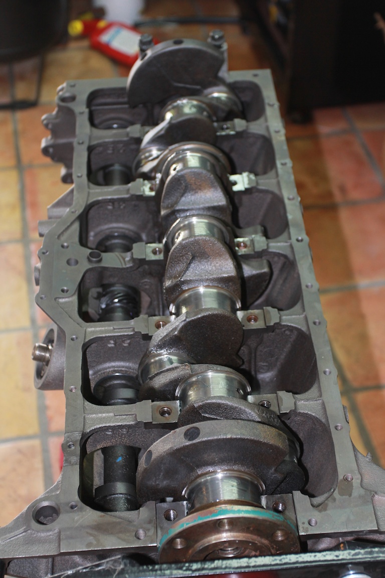

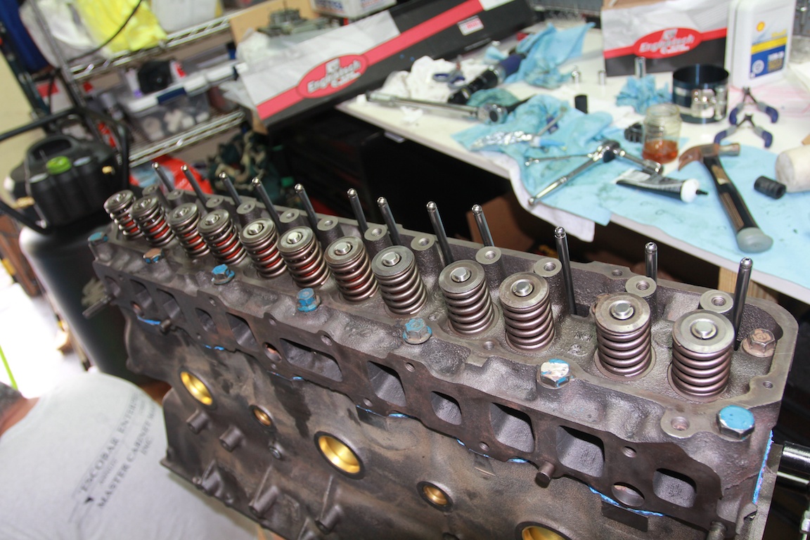

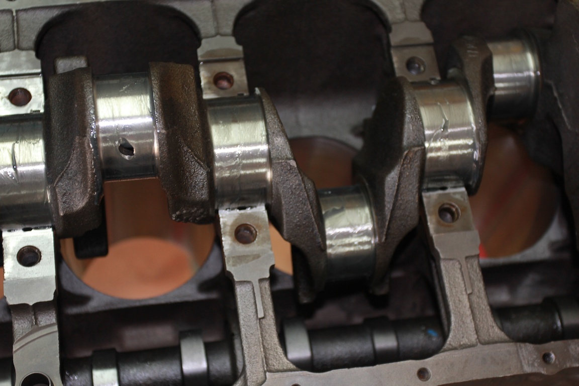

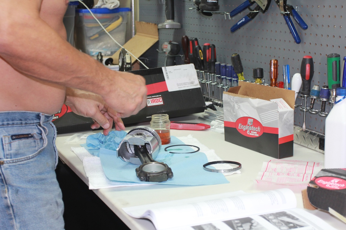

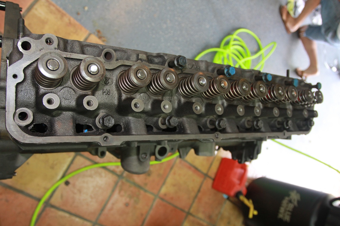

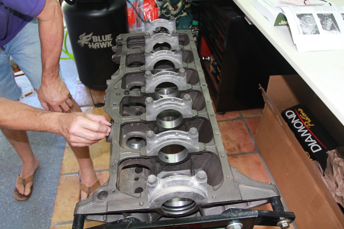

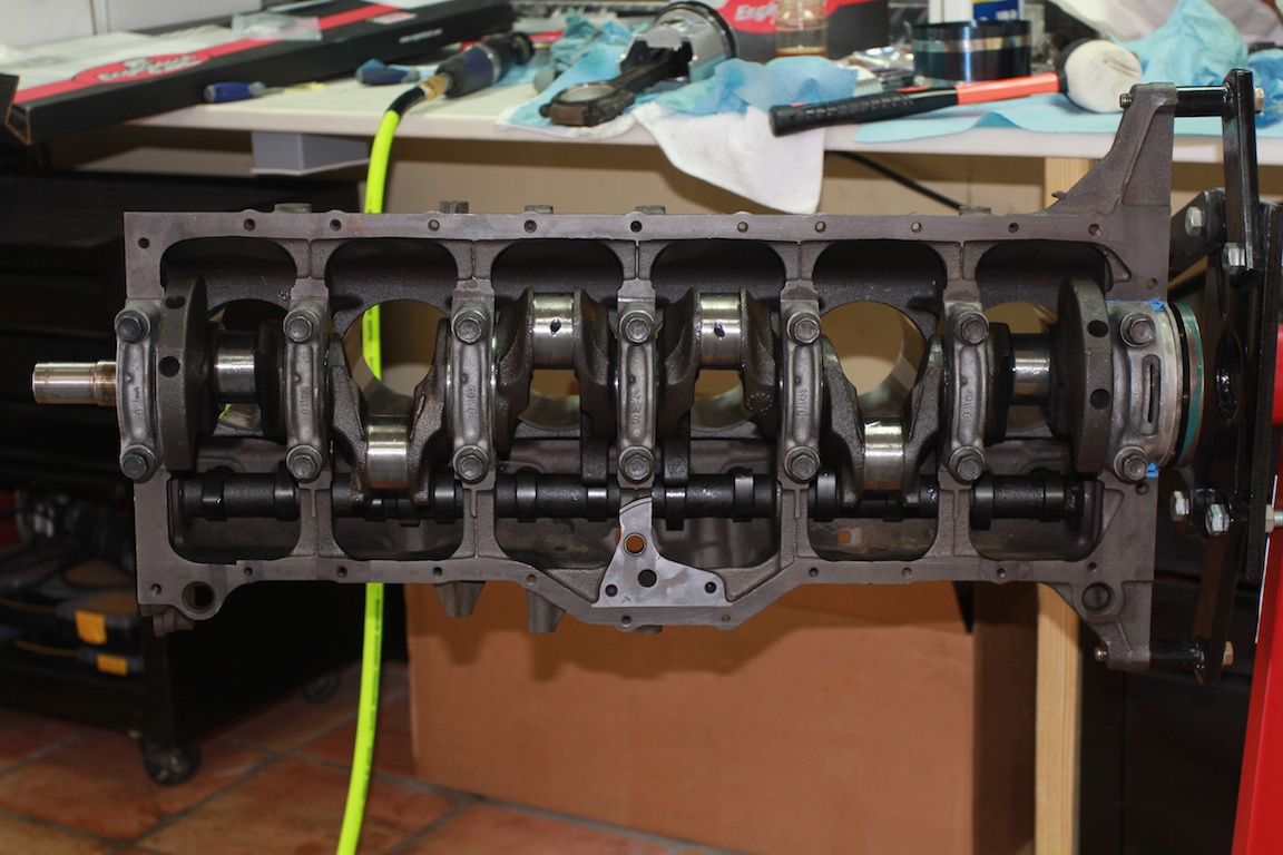

HI everyone. I finally got the engine back from the machine shop. Mike from Total Engine Concepts in Riviera Beach, FL did an amazing job and he has a great shop. I had everything cleaned, bored, machined, and shaved. Redid the pistons, cam shaft and crank shaft, machined the crankshaft and the control arms, shaved the heads, bored the pistons to .40 I started reassembling and got almost everything done except for the rocker arms and setting the timing. here are some pictures

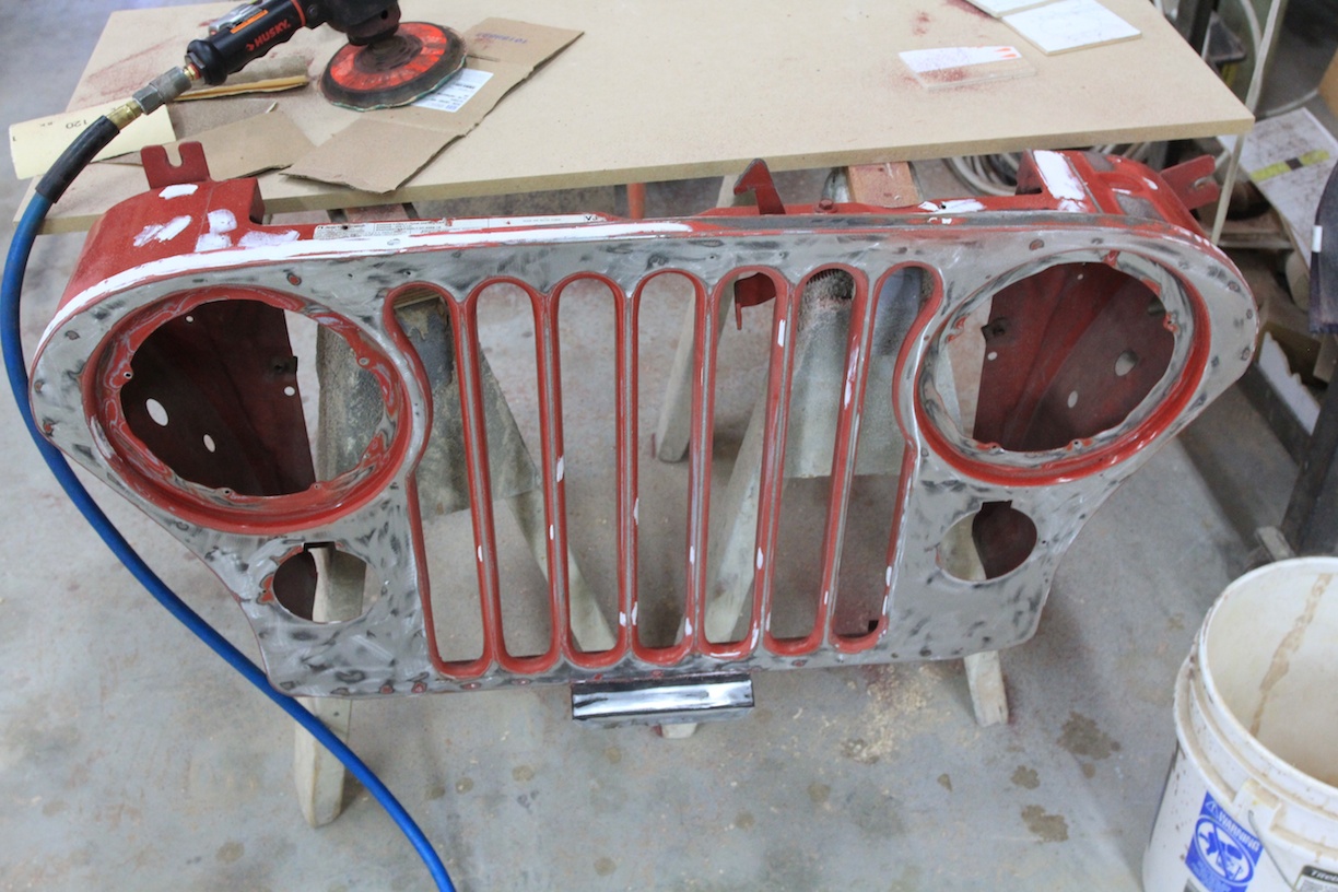

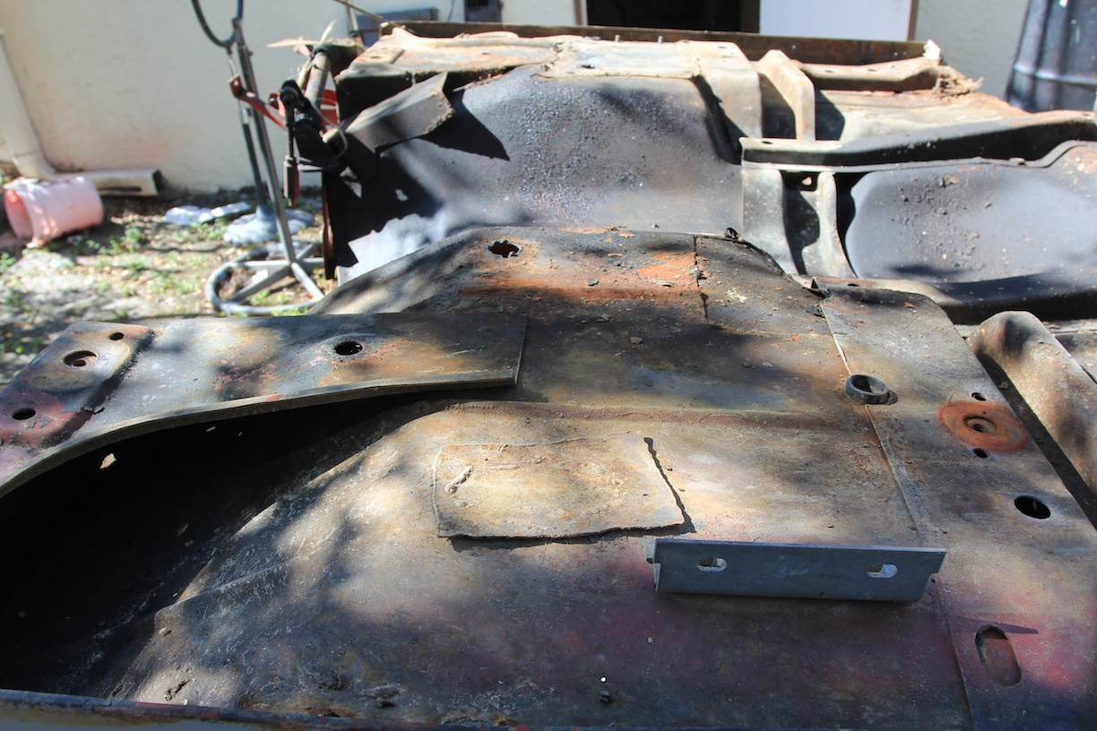

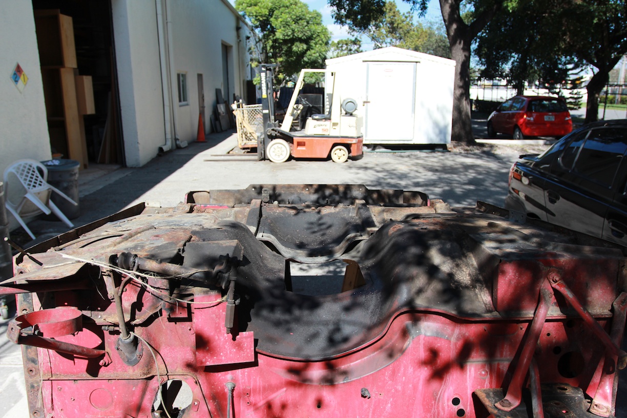

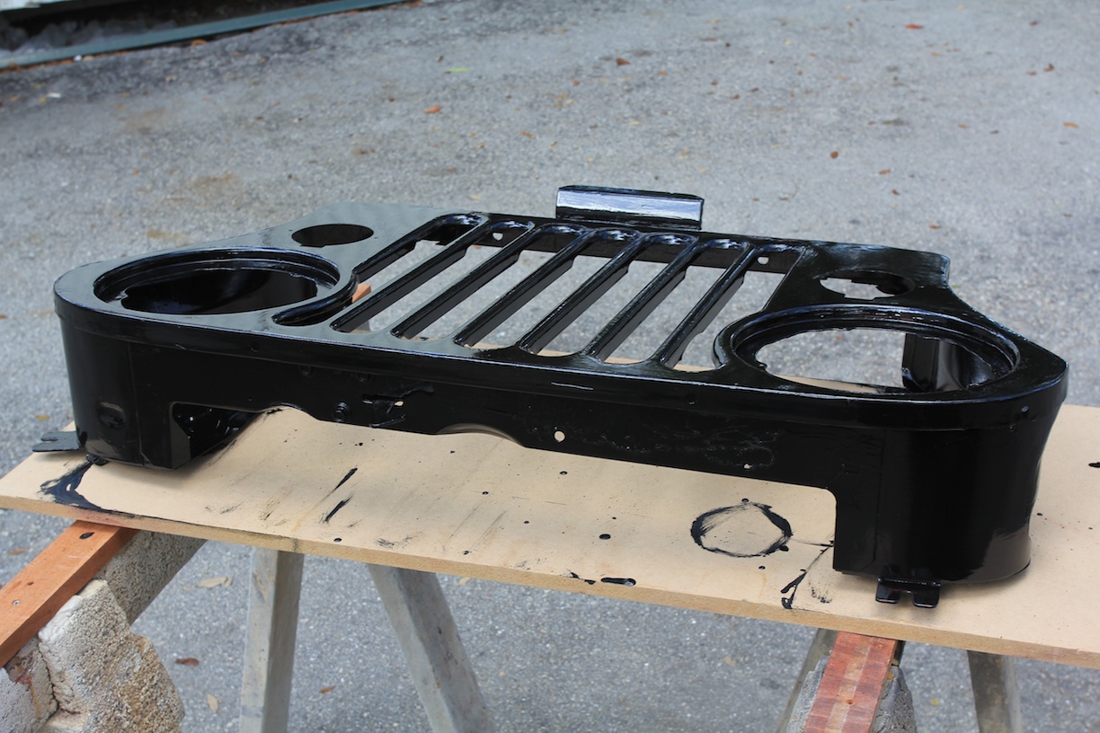

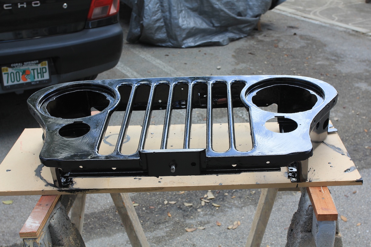

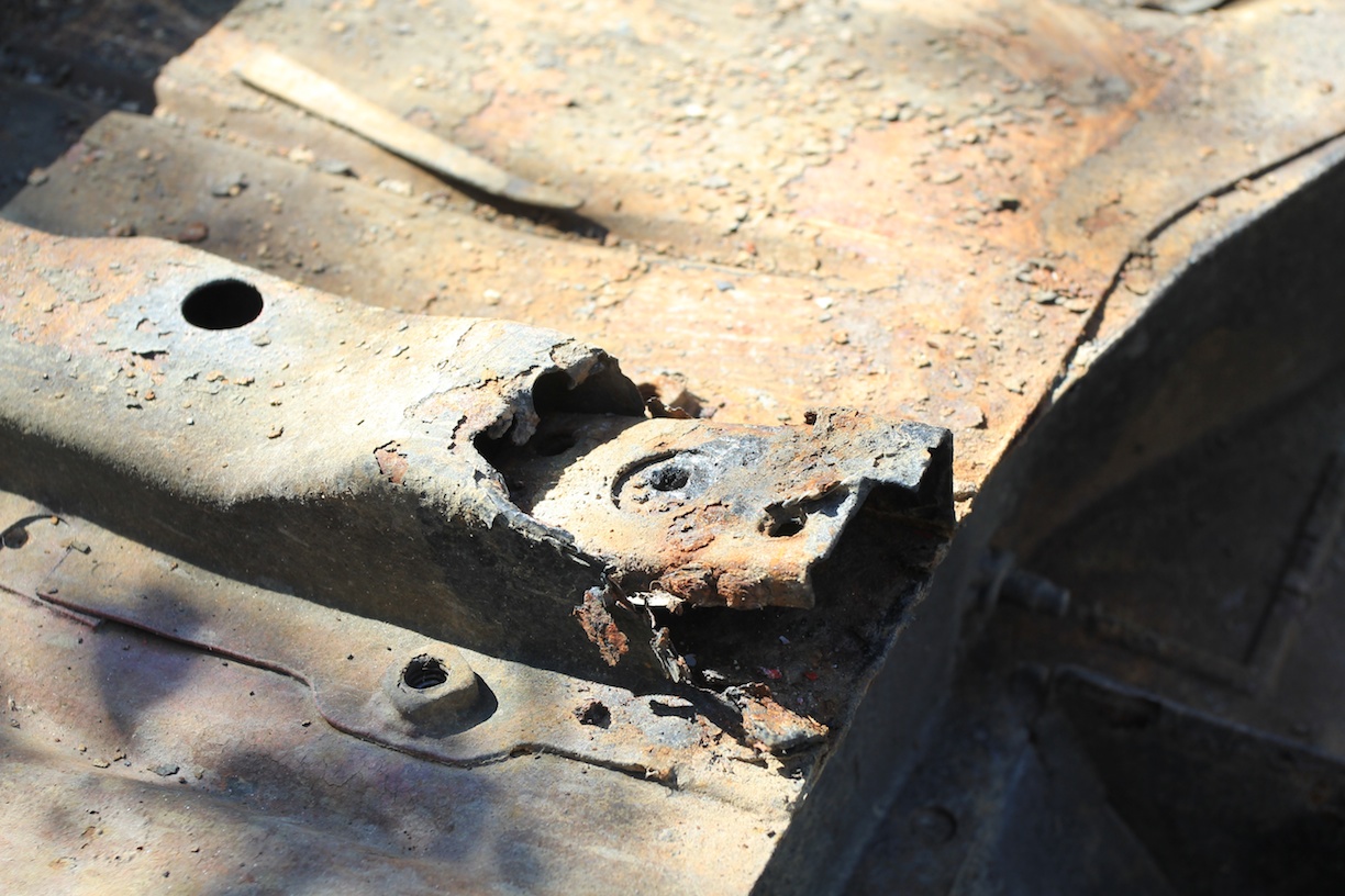

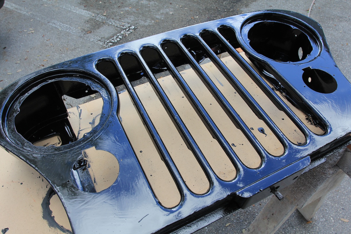

Hey everyone. So I have flipped the tub upside down to prepare it for paint and have started preping all the fenders and hood also for paint. I was able to apply the KBS rust seal to the grill and it came out very nice. I took the pictures in-between coats so theres brush strokes in the picture but its self leveling so theres no brush strokes now that its done. I also have been using this liquid metal to reinforce some of the small spots that have needed it.

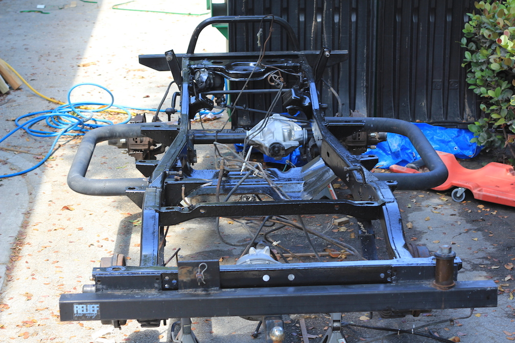

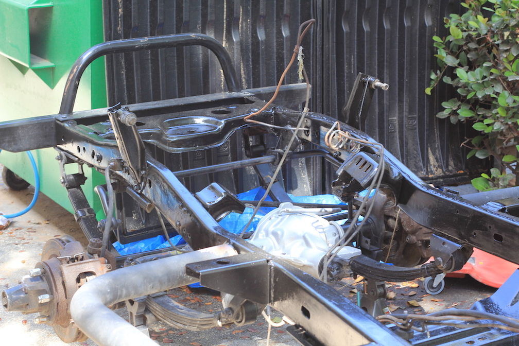

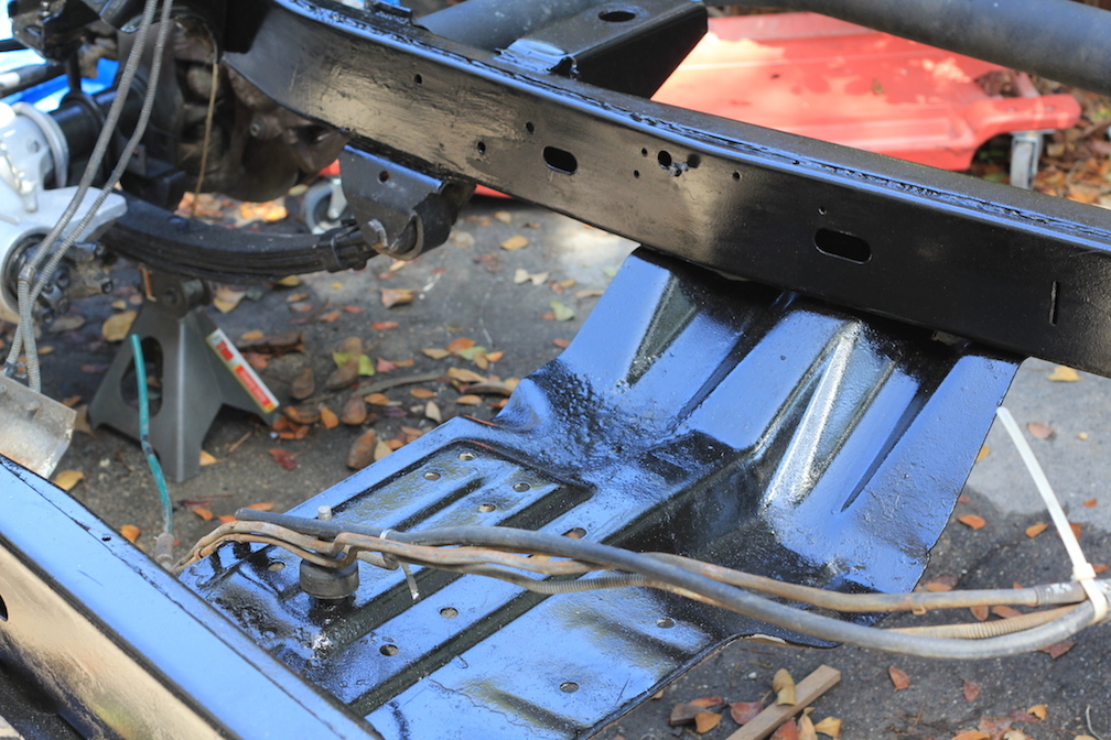

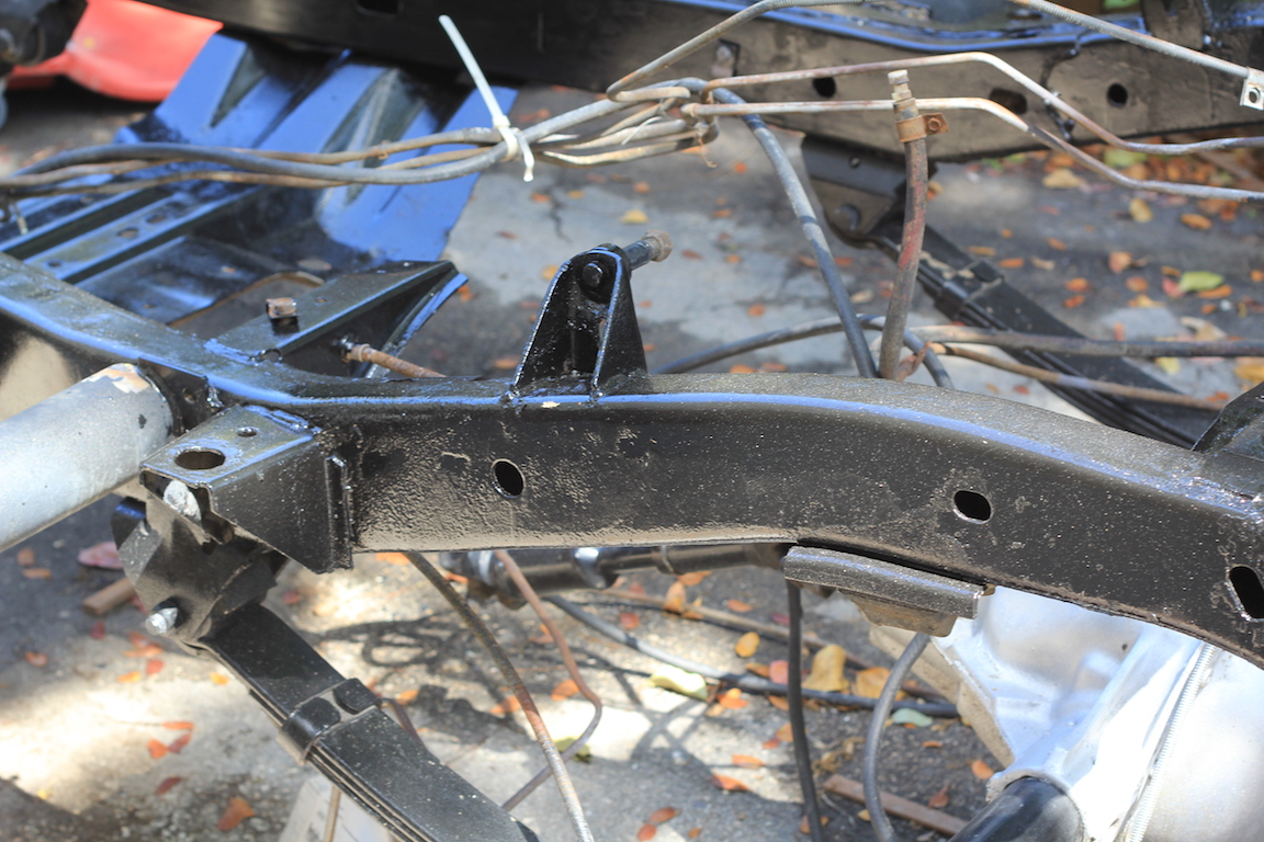

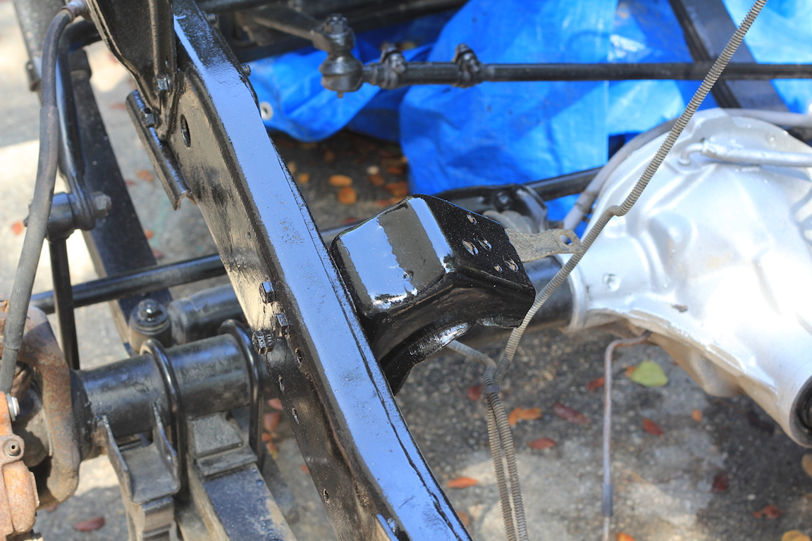

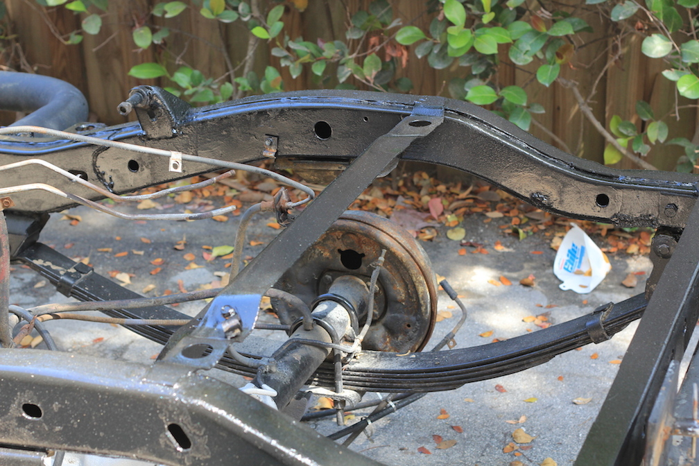

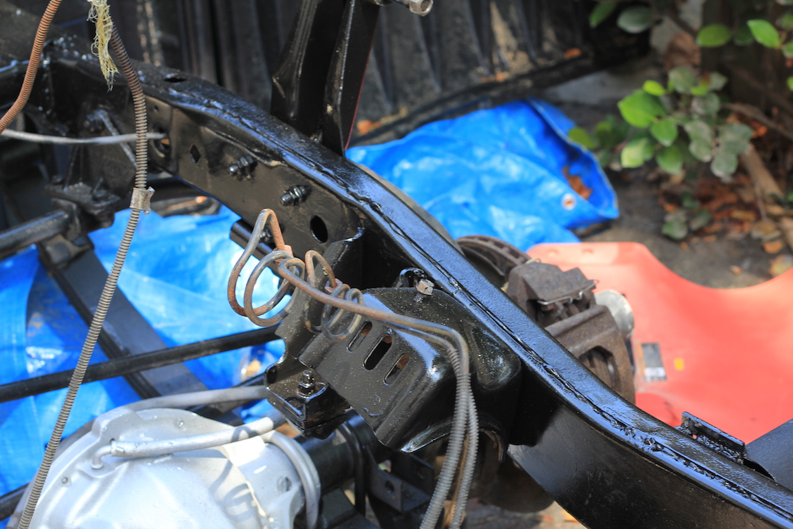

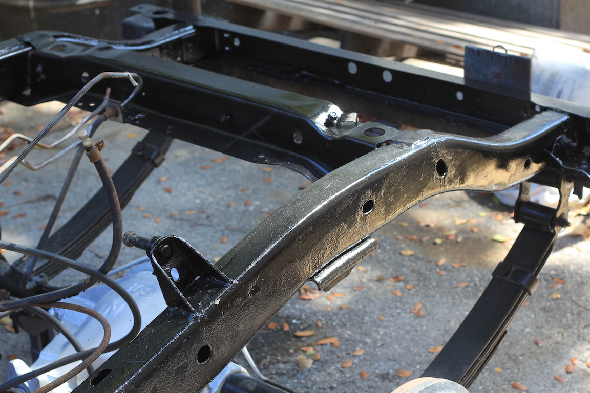

Hey everyone. so Today I painted my chassis. I used KBS rust steal, which i applied two coats. and then I used their final Black finish paint as the final coat.

Looks sharp! Are you going to paint the nerf bars as well?
Yes. I'm thinking about covering everything except the nerf bars and having them Line-x so that way you have more traction when you step up plus the texture wouldn't look bad either.
