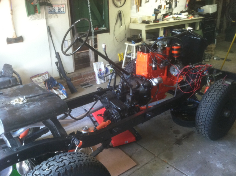

1956 CJ5 Build
The engine starts with the new SOLEX carb but will only run for a few seconds. I have seen other threads about the Solex carb crapping out right after starting. I'm sure it's a choke and adjustment issue but the carb didn't come with any instructions. Any ideas how to adjust it?

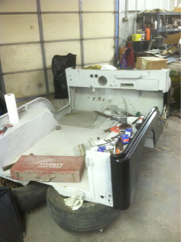

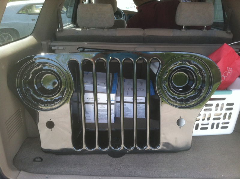

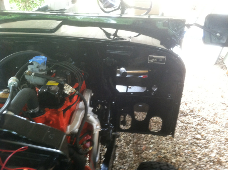

Body work is progressing slowly but surely. The grill is complete and will be mounted this week. The rusted side panel was removed from the body and the new panel has been installed, going to be welded in this week. I am using POR-15's "Hardnose" paint in black. This stuff is indestructible. It is immune to rust, humidity, cracks, chips, etc. plus it looks really good!

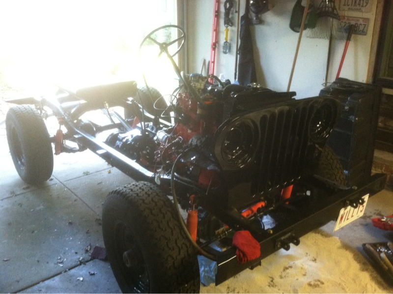

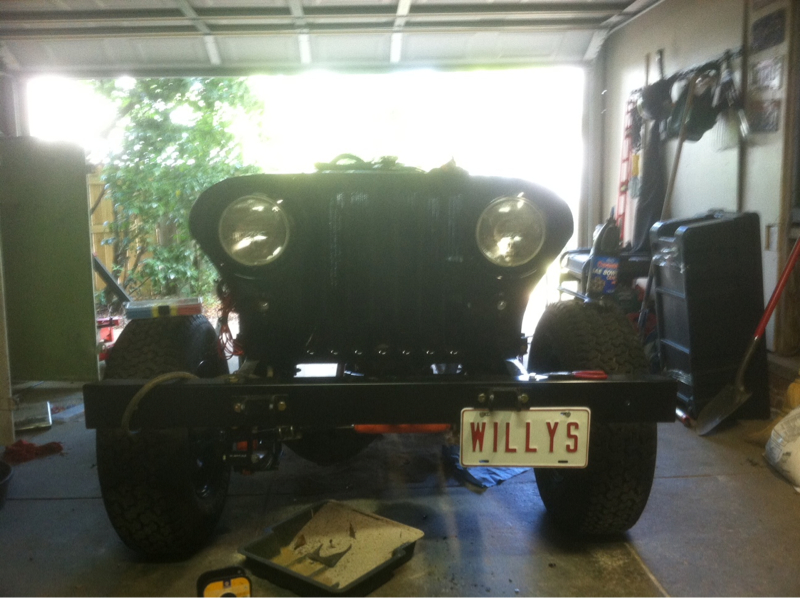

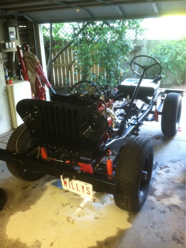

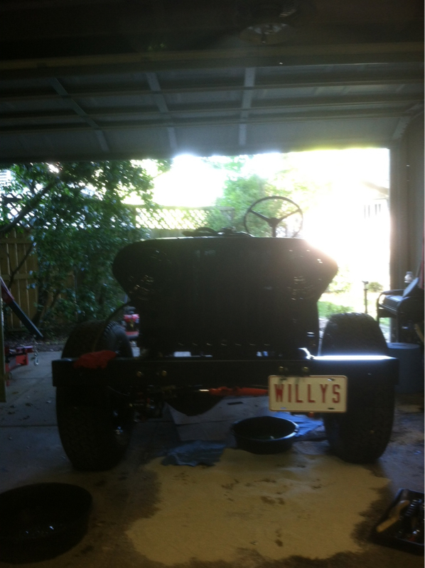

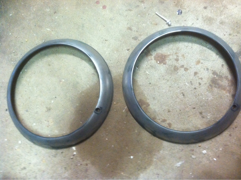

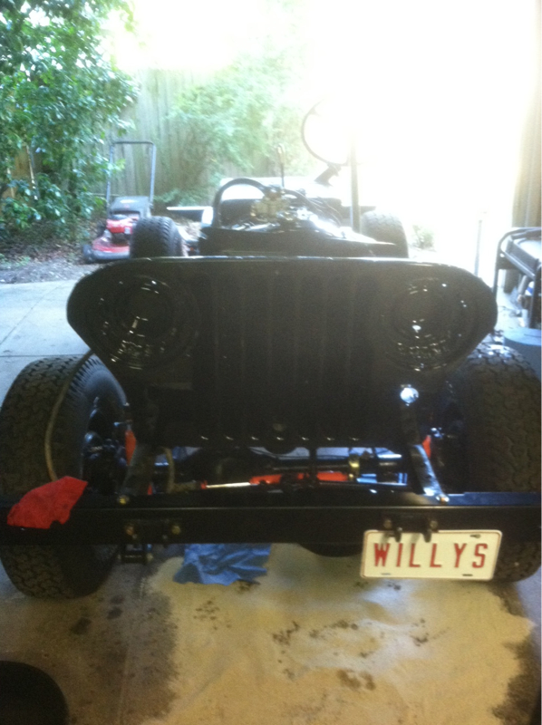

I mounted the grill to the radiator today. I had to cut off about 6 inches from both radiator hoses to get everything to fit right. In that process I had a somewhat severe leak of radiator fluid. Hence the pile of kitty litter on the floor. I sanded the headlight surrounds, prepping them for POR-15. I will be installing headlights, marker lights in the next few days.

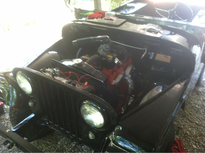

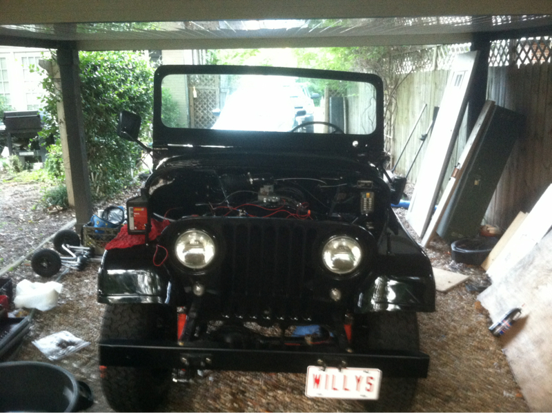

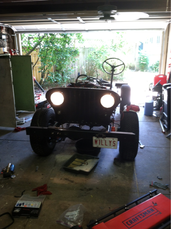

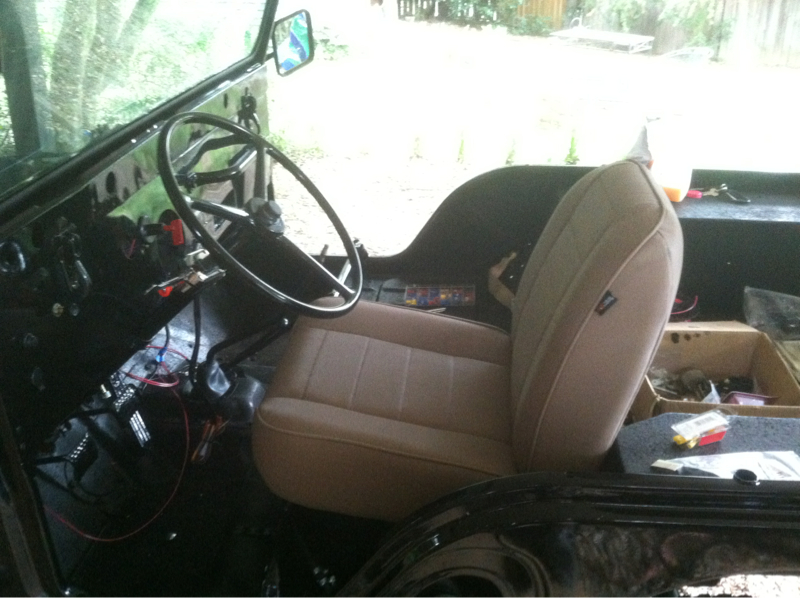

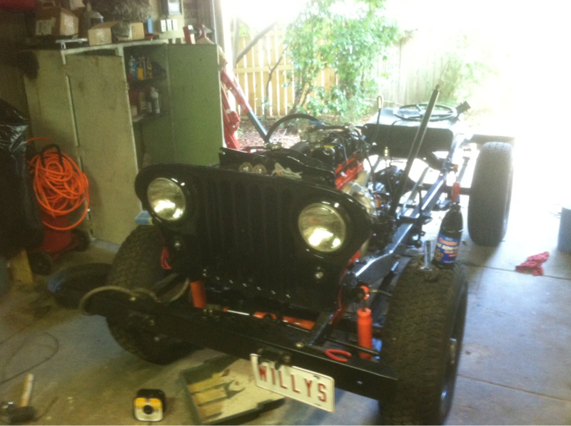

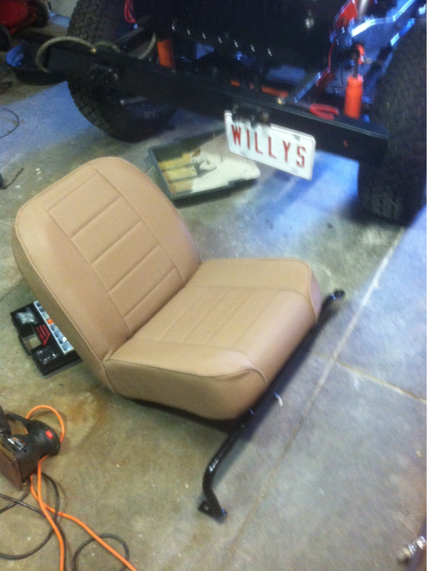

Headlights and marker lights installed and wired. I got two new low back tan seats from Rugged Ridge. I painted the seat frames with POR-15 and mounted the drivers seat to the frame today, passenger seat tomorrow.

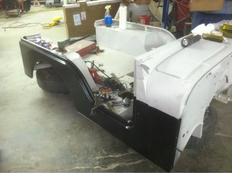

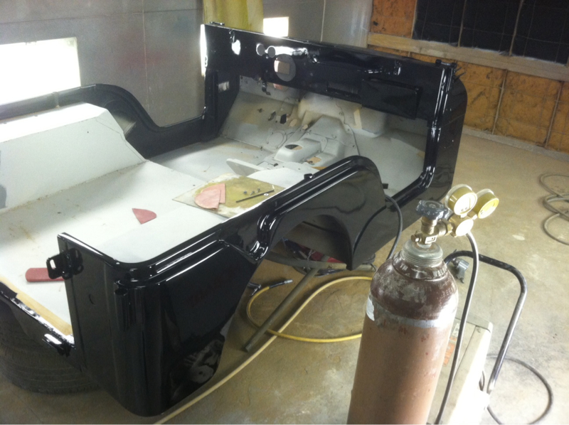

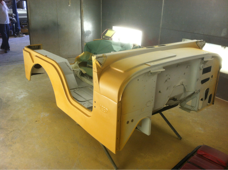

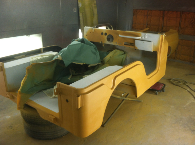

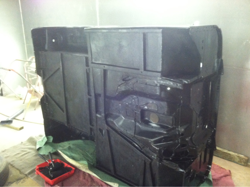

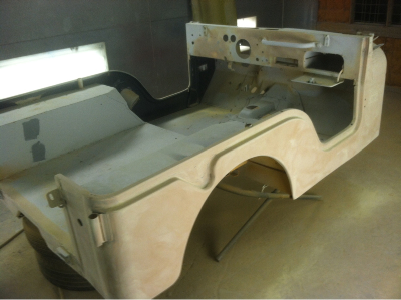

Body tub complete and primed. It has two new side panels. Substantial welding work was done to put the letters, gas tank opening and soft top bow indents into the new panels from the originals. Nobody makes entire side panels fir early CJ5's. Applying POR-15's "hard nose" paint in gloss black tomorrow.

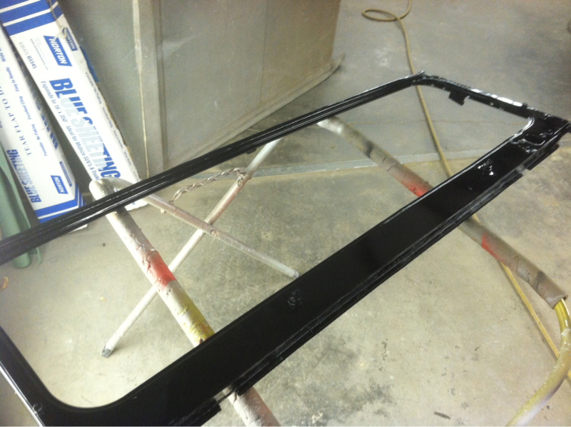

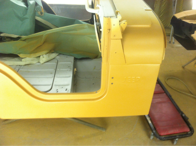

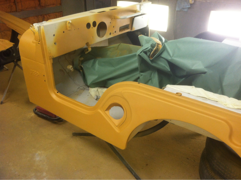

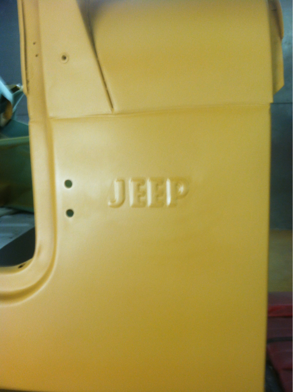

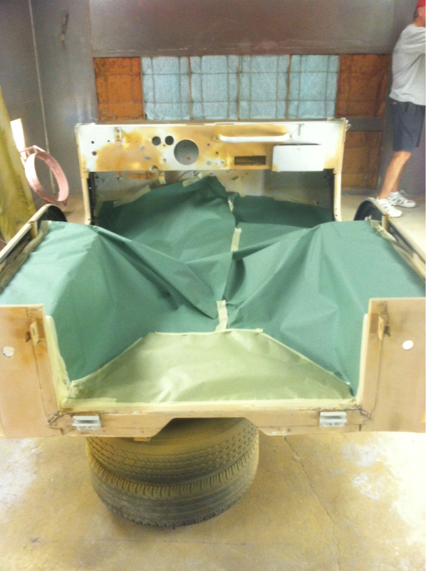

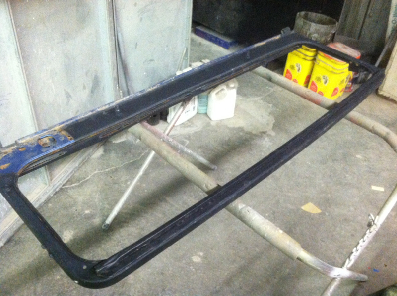

Body tub and windshield frame sanded and prepped for paint.

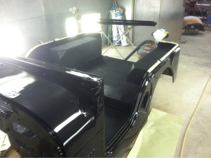

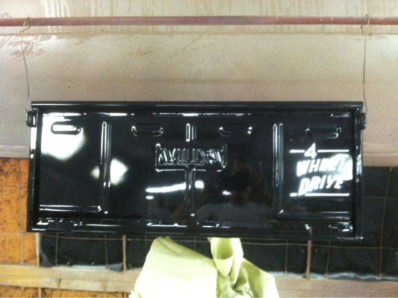

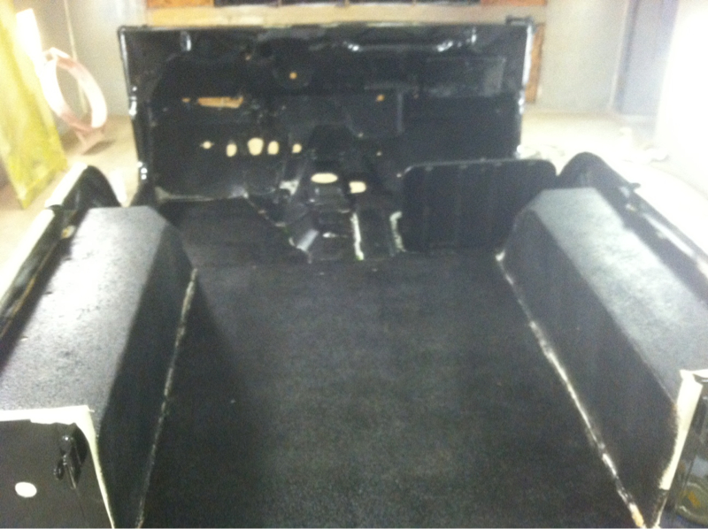

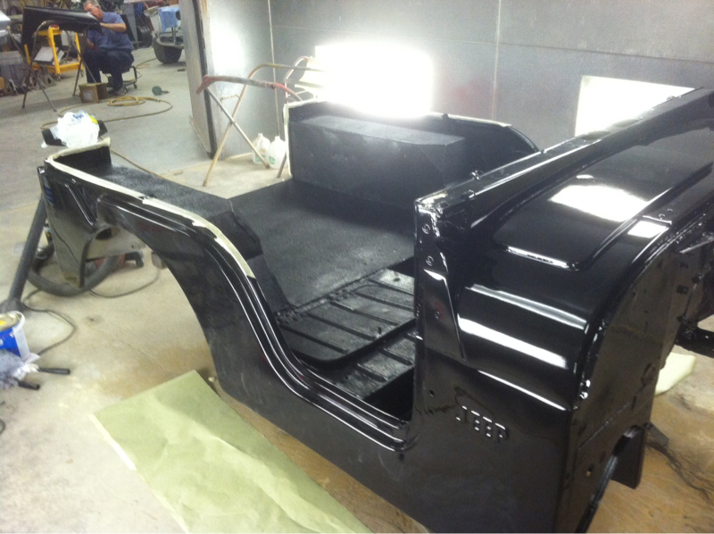

The body tub is complete. I sprayed it with POR-15's "Hardnose paint" and painted the interior and undercarriage with Durabak-18 coating. It turned out very nicely. I also sprayed the windshield frame and tailgate. Fenders and hood are next.

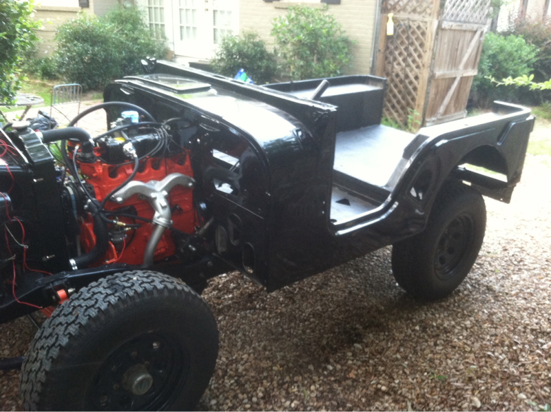

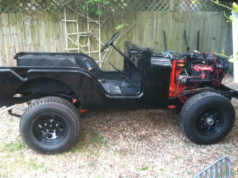

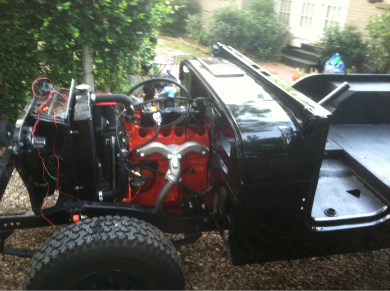

Body tub mounted on the frame.

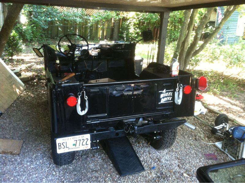

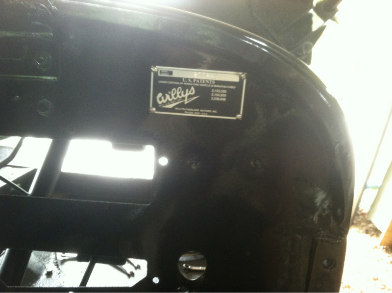

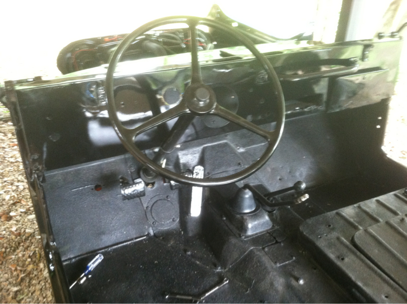

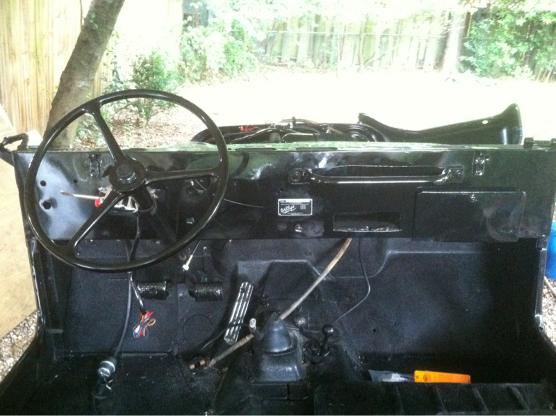

Now that the tub is on I am installing lots of parts. Steering wheel, tail gate, mirrors, turn signal lever, data plates, etc.

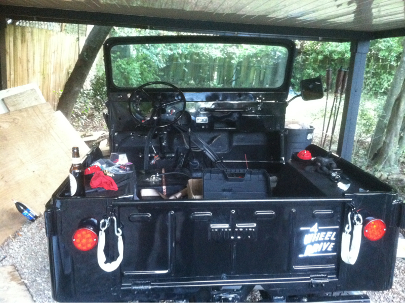

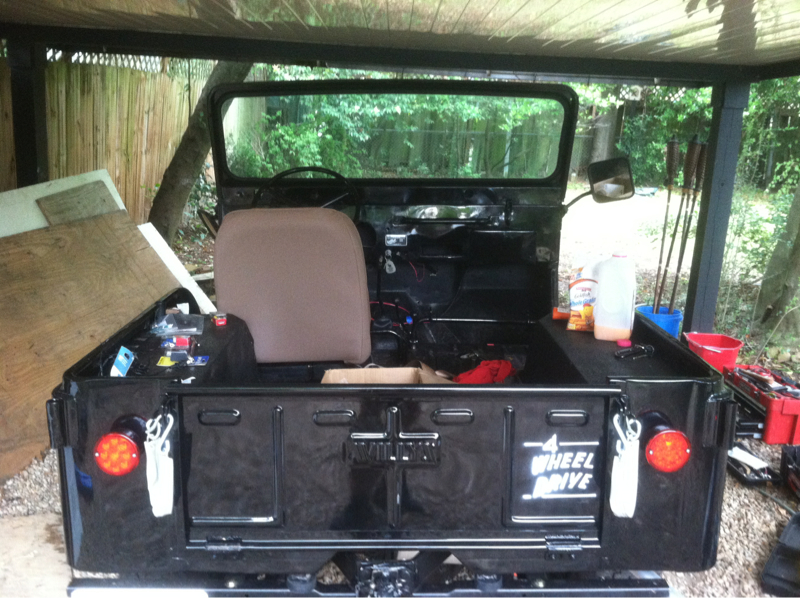

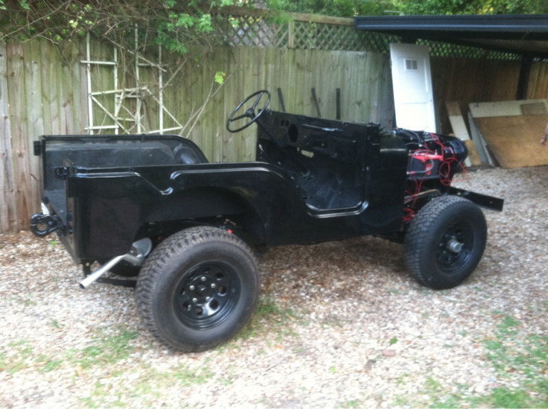

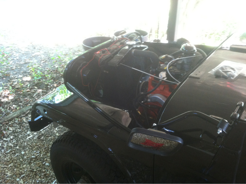

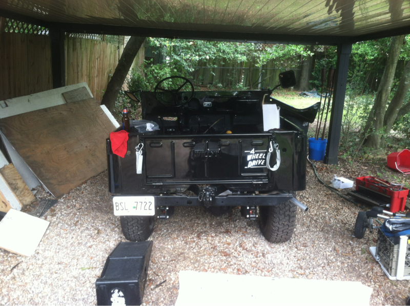

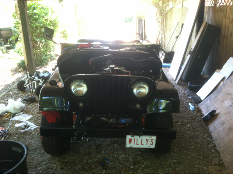

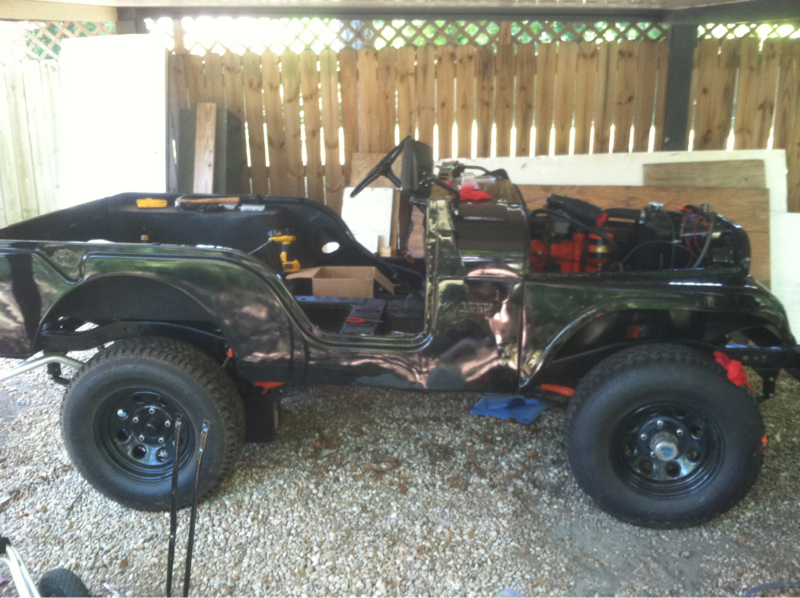

All body components. Except the hood installed. Tail lights, gas tank, air cleaner, fuse block installed.

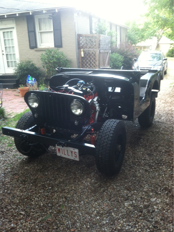

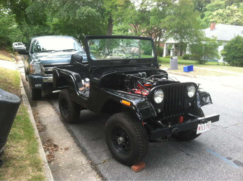

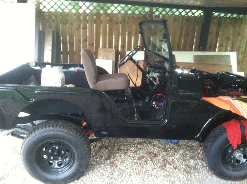

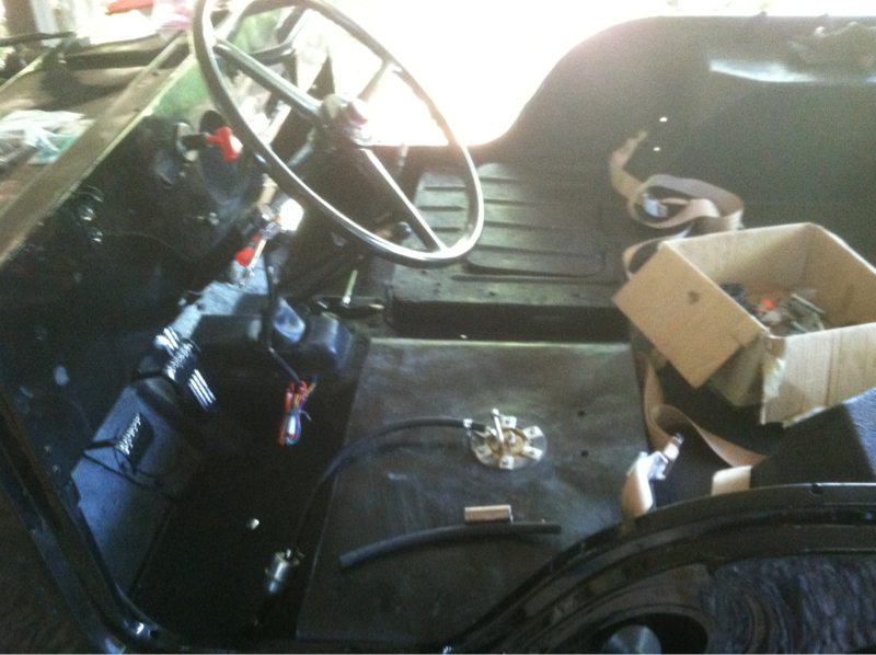

Drivers seat installed. Put the first few miles on it test driving around the block. Tuned the carb and it now runs beautifully. Next up is passenger seat, finish wiring lights and gauges.
