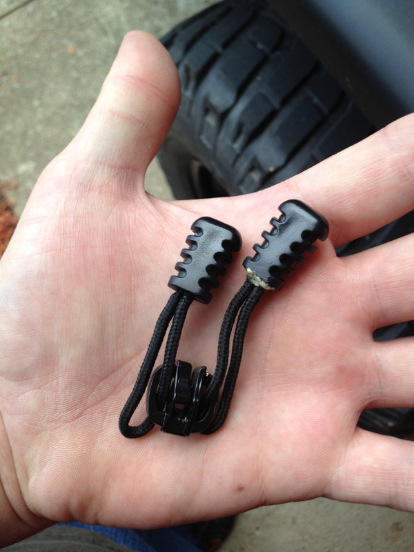

Hey guys. Is there a trick to putting a zipper back on or am I screwed? I'm a big dude with meat hooks for hands and don't know my own strength sometimes. One of the zippers on the back window came off when it got in a bind. Can it be pried apart then pinched back on? I know about the soap lube trick but the top is only 2 months old. Any input will be appreciated.. Thanx.. SB TJ

You can try putting them back on and pinching the back. I've pinched the backs on mine at least once a year.
When you do get it fixed be sure the top is warm and pliable before you take the zipper up or down.
Also the zipper pull is a size 10 available in many material shops and possibly wmart or Michael's.

Wooooo hoooo.. Fixed the zipper.. Used needle nose pliers and soap lol.. Still took a while. It was impossible to do when I was frustrated. The zipper track got a snag in the right corner. It took a few try's, it kept messin up but finally got it. I may not take it out anymore. Just going to drop the top with it in. Guys, thanx so much for the replies. Every bit of info was useful..
The mess up in the corner could be a few things. One you put in in cold. Or you need to pinch the back of the pull a bit more. One last is look at the sewing of the sipper to see if the stitching is intact. My top right needs to be restitched and makes zippering in that corner difficult.
