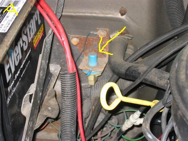

Hey guys let me give you a run down, first off brand new to this forum thanks to hoobness to turning me on to it. I bought a 500.00 bargin YJ in pretty good shape but the vaccum hoses were all messed up. I have(or at least i think i have) figured most of them out. I have some questions about what some of the extra stuff that wasent plugged in when i got the jeep is/are? I have some pictures of this stuff, can anyone tell me what they are and how i can connect them into this system. Also i can't located any of the Pulse air system things, or the Decel Valve, does anyone have any pictures of the devel valve and where it is located. So anyway onto the pics:
photo "a" is a blue sensor on the firewall near the battery, http://pg.photos.yahoo.com/ph/seanlabriestrips/detail?.dir=ec4c&.dnm=c564re2.jpg&.src=ph

"A" is a switch that turns on the 4WD light on your dash when you pull the tcase into 4LO or 4HI.

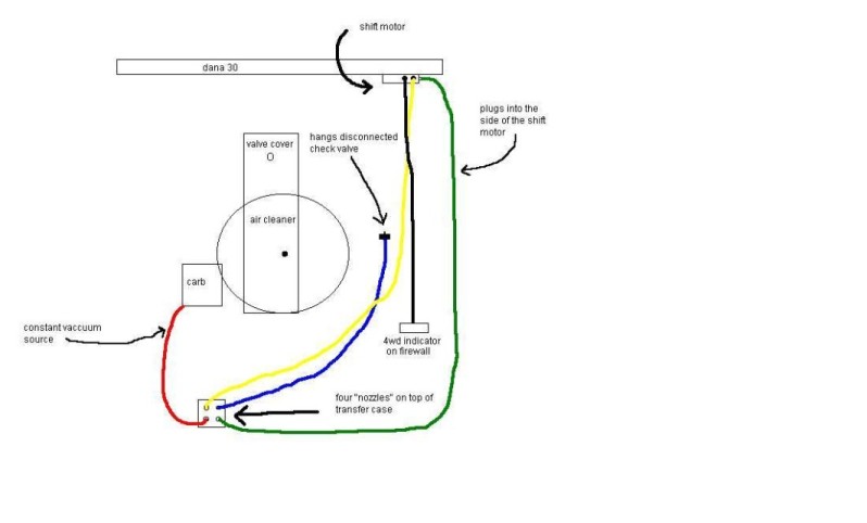

Look at the front axle on the passenger side. There should be a connector with 3 vacuum lines on it. A black, yellow, and green. If it isn't there, and a cable is there instead, the previous owner has installed a manual locking system on the front axle. That would explain why "A" is disconnected and "B" looks like it does. My blue vacuum line has a check valve on it that just hangs down disconnected.
Crude diagram attached below
Good Luck.

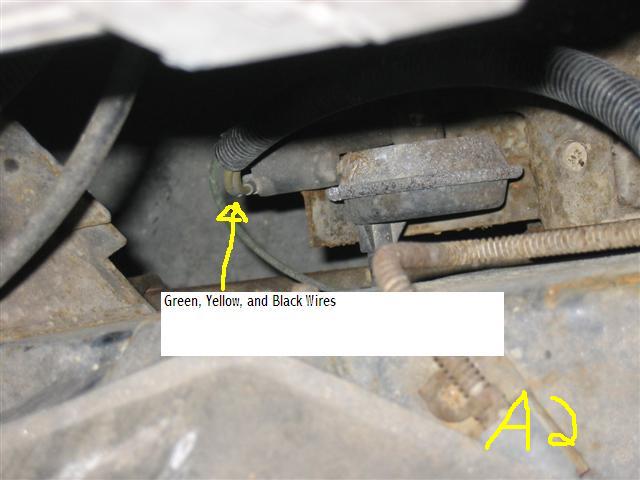

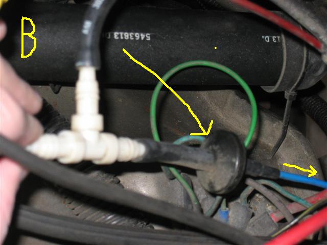

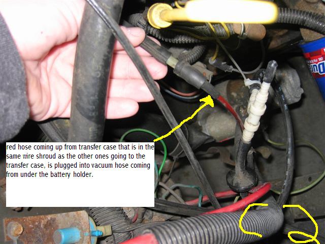

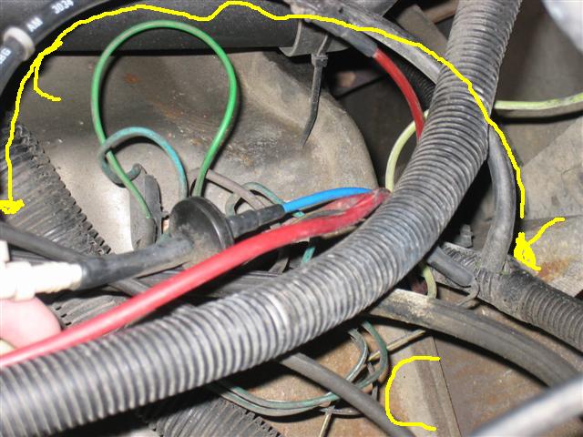

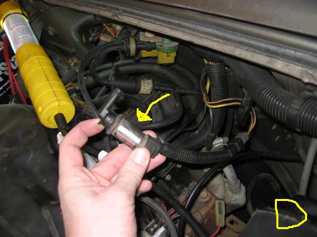

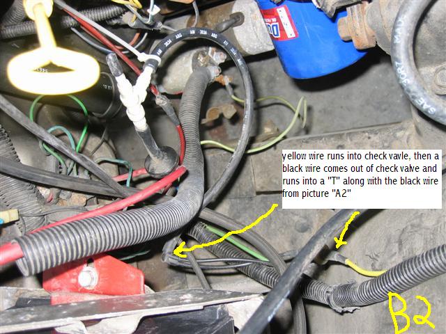

Ok, thanks for the help so far guys, you've all been great. Let me give you an update based on that rough diagram that Lah2420 drew for me. The hoses in picture A2(green, yellow and blacK) all run into a wire shroud and head up towards the firewall along the fender, in picture B2 you can see that the yellow hose runs into a check valve and then on the other side of the check valve it turns into a black hose which in turn connects to a T junction along with the random hose from original picture C which runs into the T juction along with the blue hose and check valve that is supposed to be plugged into nothing. There is also a red hose that comes up from the transfer case(I can't tell if it is plugged into the transfer case or not) and attaches to a vaccuum hose coming from the tank under the battery. Can anyone tell me if any of these sound like they are plugged in correctly, also can anyone tell me how their hoses are conencted into the system. On the diagram that Lah2420 drew does anyone know where the red hose is supposed to plug into the carb? i can't find one plugging into it(maybe that is the red hose from picture C2?)

Of the three hoses coming from the vacuum disconnect on the front axle, one should run to the 4wd indicator light switch on the firewall. The other two should go to the transfer case along with the red and blue vacuum lines. The blue is the vacuum vent line for the transfer case and the red is the vacuum supply to the transfer case.

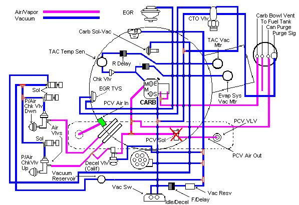

I looked and my red line doesn't actually run to the carb. It "T"s into a line from the manifold vacuum port under the carb. This may not be stock as my Jeep was very worked over when I bought it. The drawing is one I had copied from someone else's site. From there it goes to the transfer case. If you can make heads or tails of it, here's a supposedly complete YJ vacuum drawing.

The red line needs any manifold vacuum.
The above vacuum pic does not contain any lines for the CAD (Central Axle Disconnect) system.
there is a line coming from the vacuum reservior that leads to the Vac SW idle/decel switches. the red line is T-ed into this line, should that be OK?
also can i access the transfer case lines by removing the shifter boots from the shifters?
You can access them best from beneath the jeep, reaching around the transmission crossmember.
Pull the two similar vacuum lines from the front axle and check for strong vacuum. Vacuum should alternate between the two depending on if you're in 2wd or 4wd.
