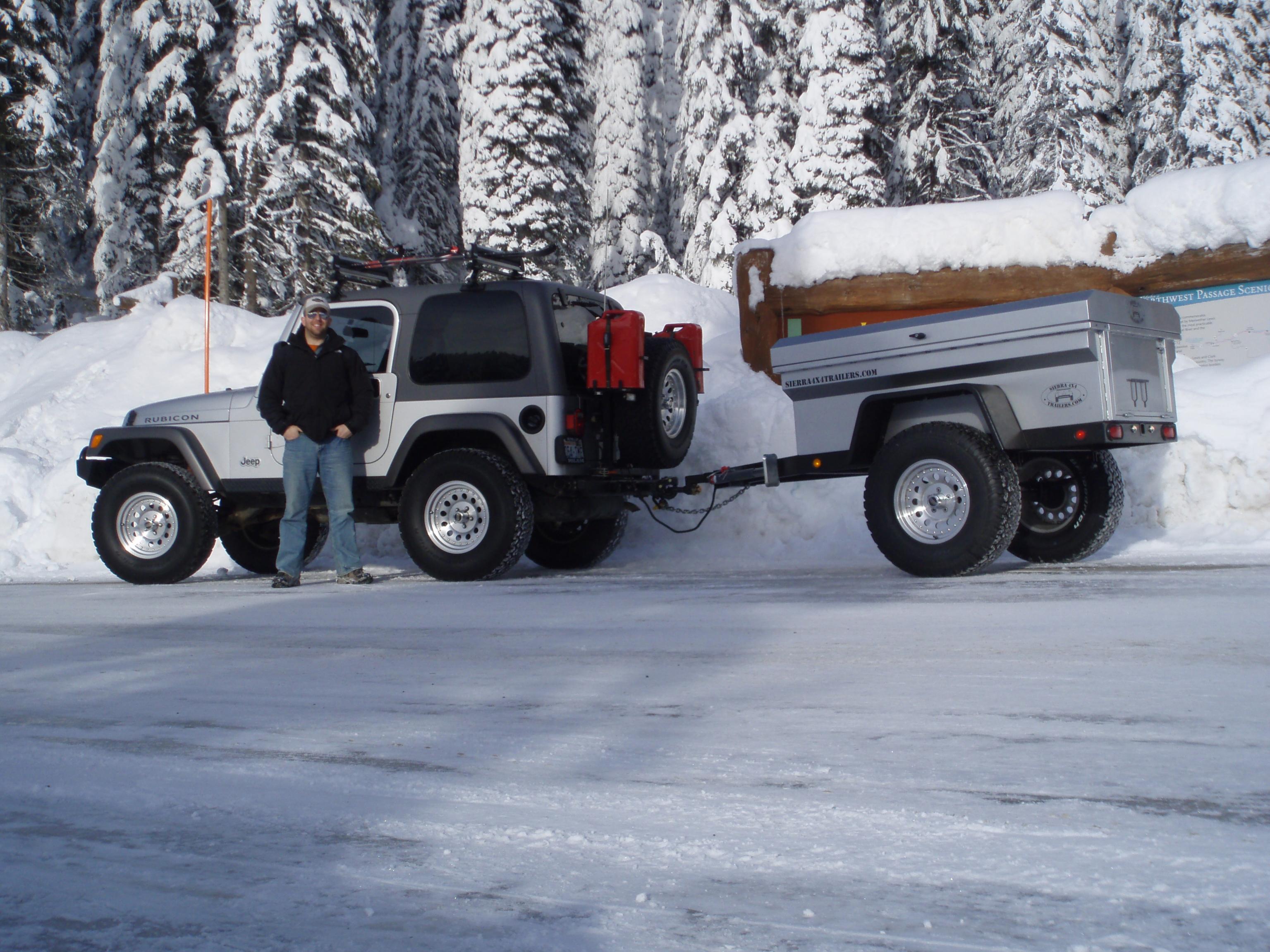

Also, the trailer's awesome and came from seirra 4x4 trailers in Nevada. This guy's a really great welder and I just pulled the trailer (jeep + loaded trailer= 6500 pounds) from Seattle, WA to Louisiana......pulls like a dream.
