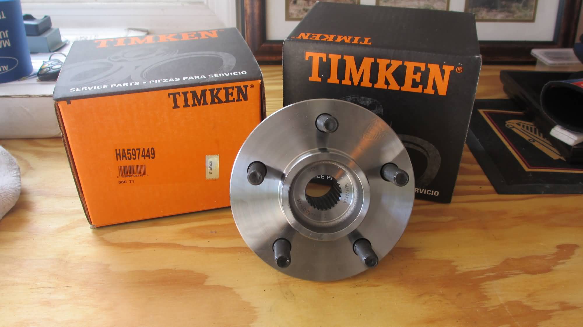

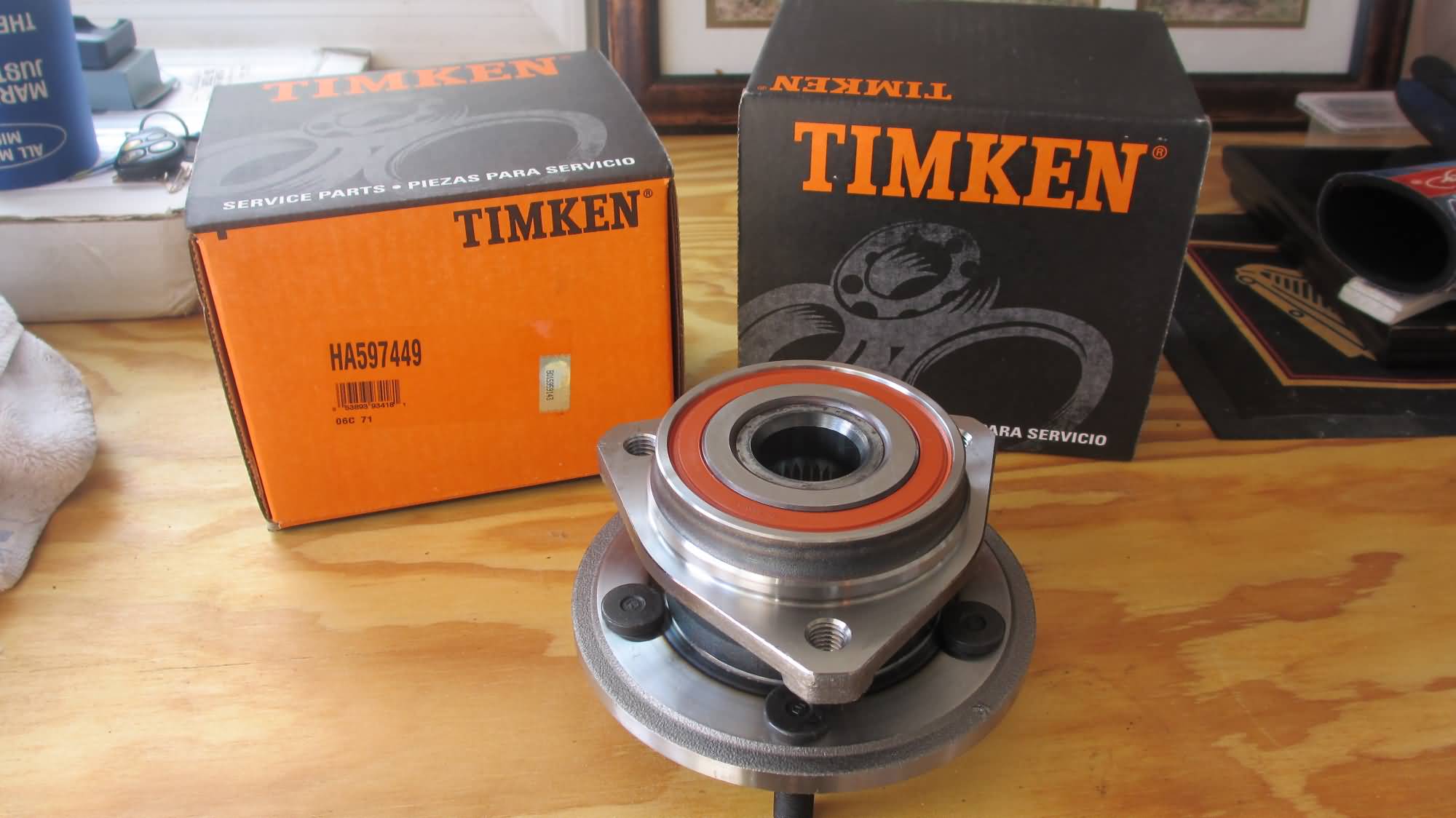

Replacing the hub bearings is a pretty straight forward process, and can be done in your driveway with regular hand tools (the only exception being a 36mm socket). I choose to use Timken hub bearings simply because I’ve read so many positive reviews.

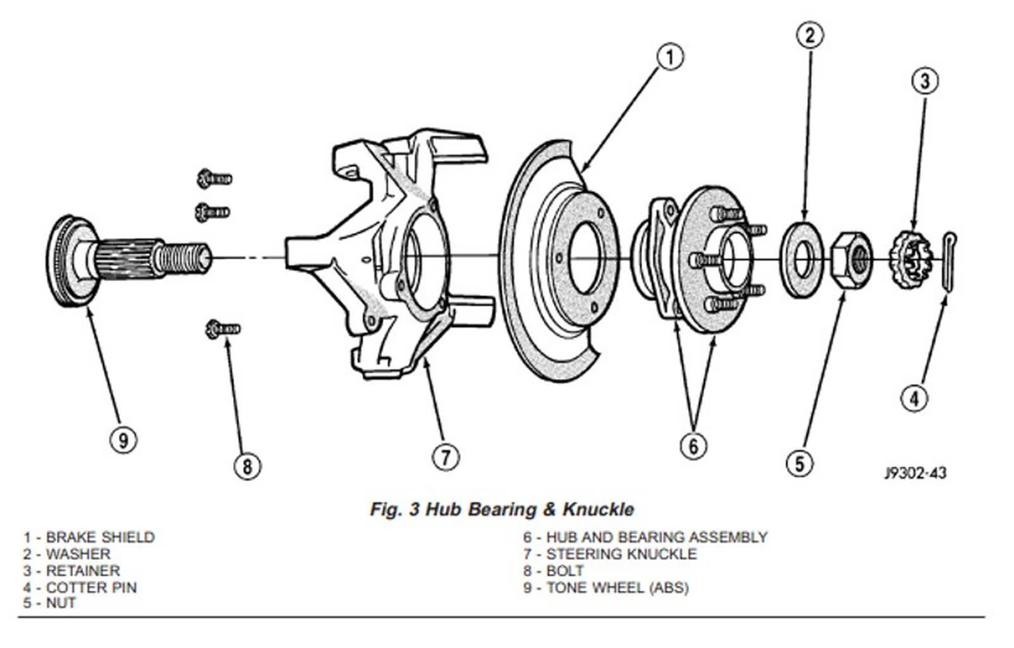

This is an exploded view of a Wrangler TJ wheel hub.

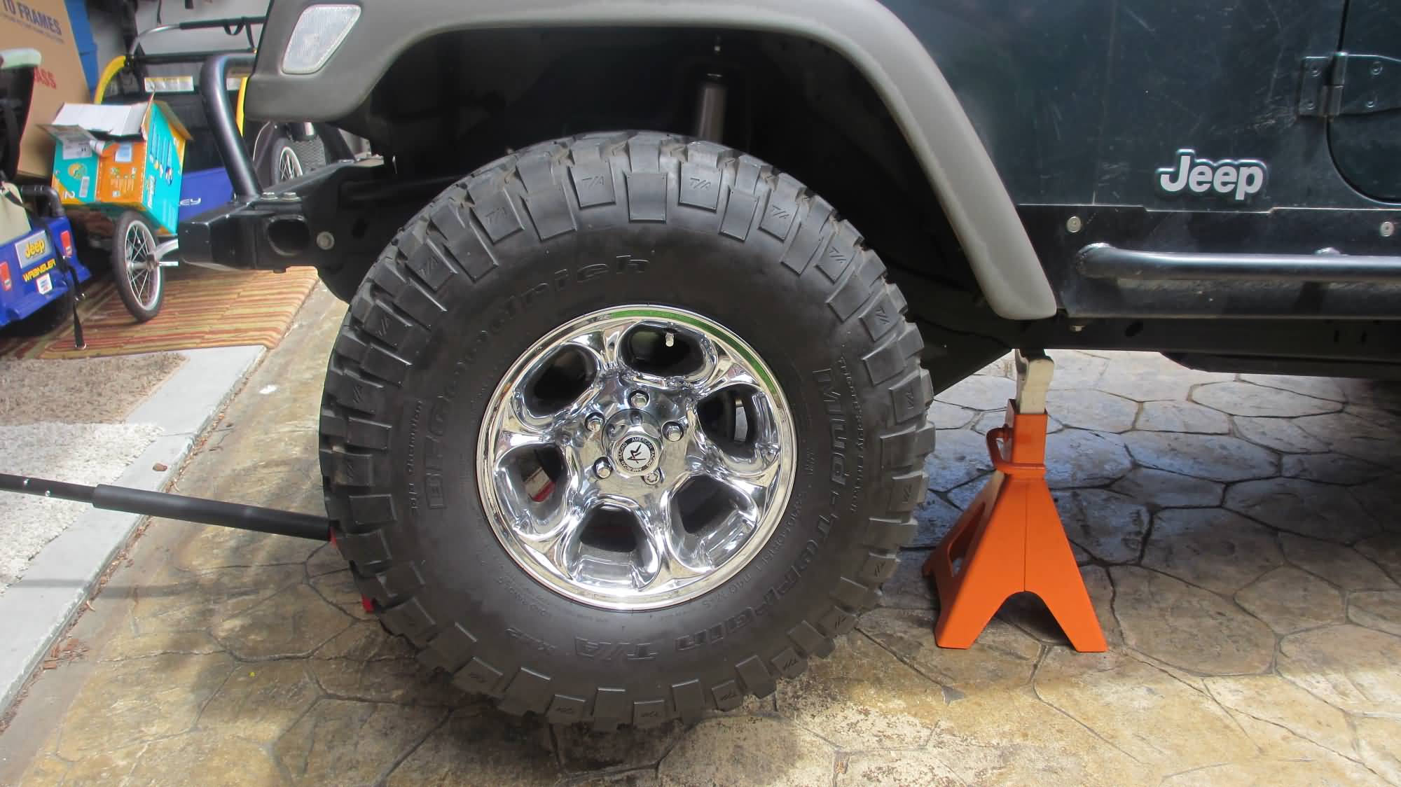

  1. So, to get started, just jackup your Jeep.

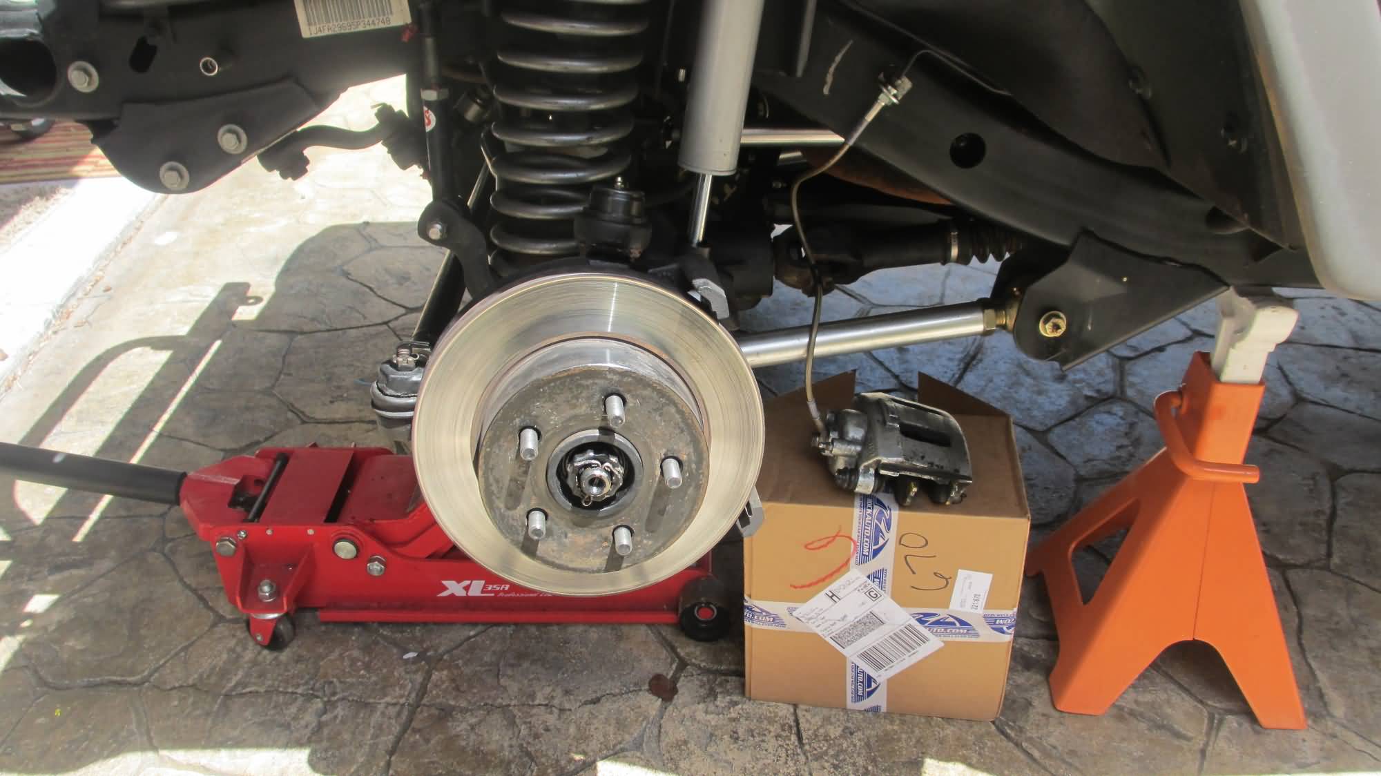

  2. Remove the wheel and brake caliper, being sure to support the caliper (don’t let it hang from the break line).

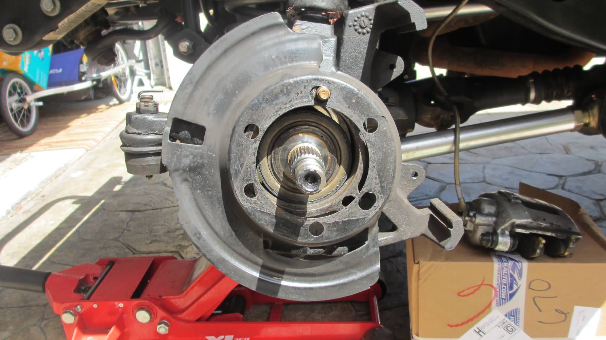

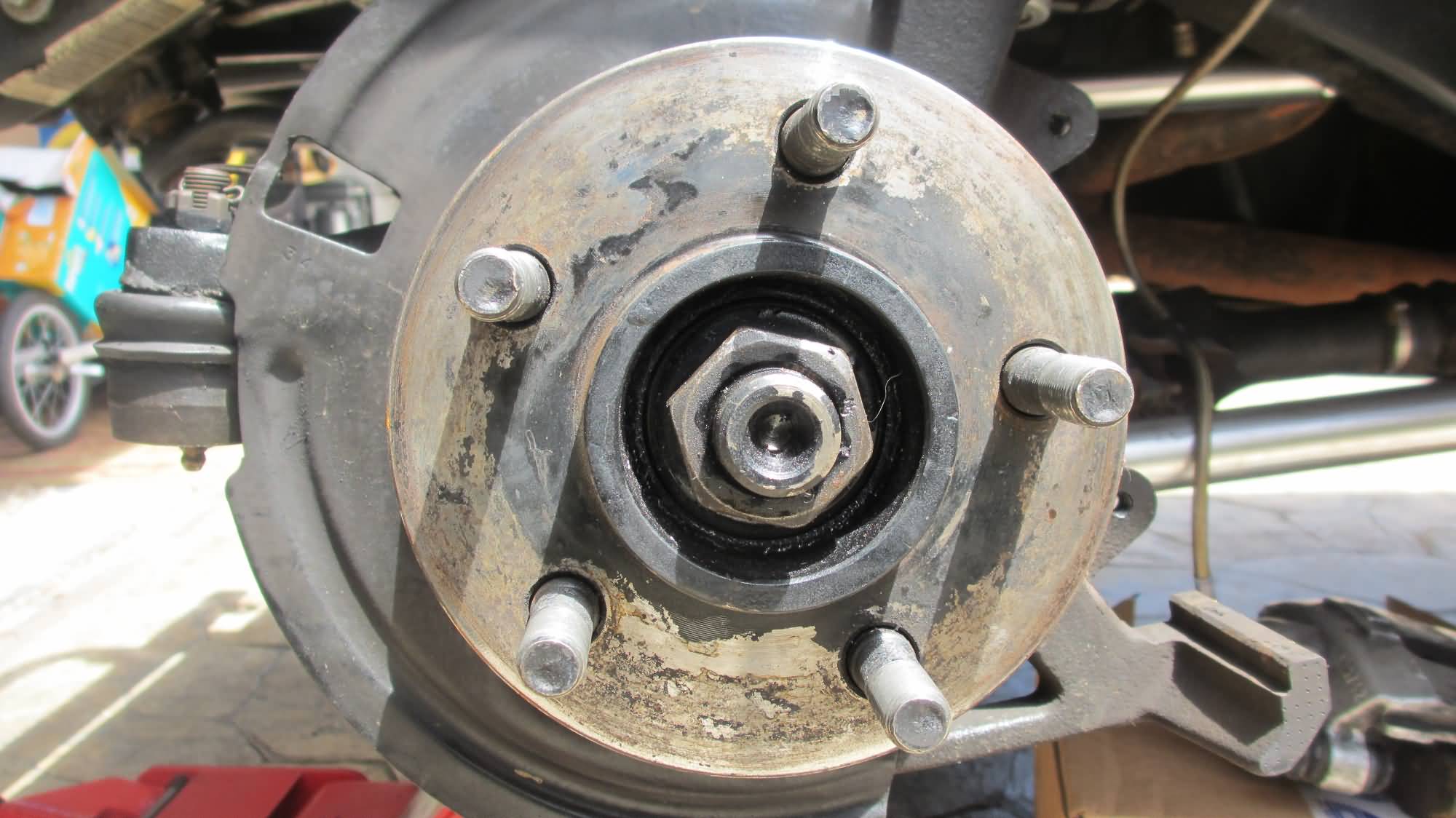

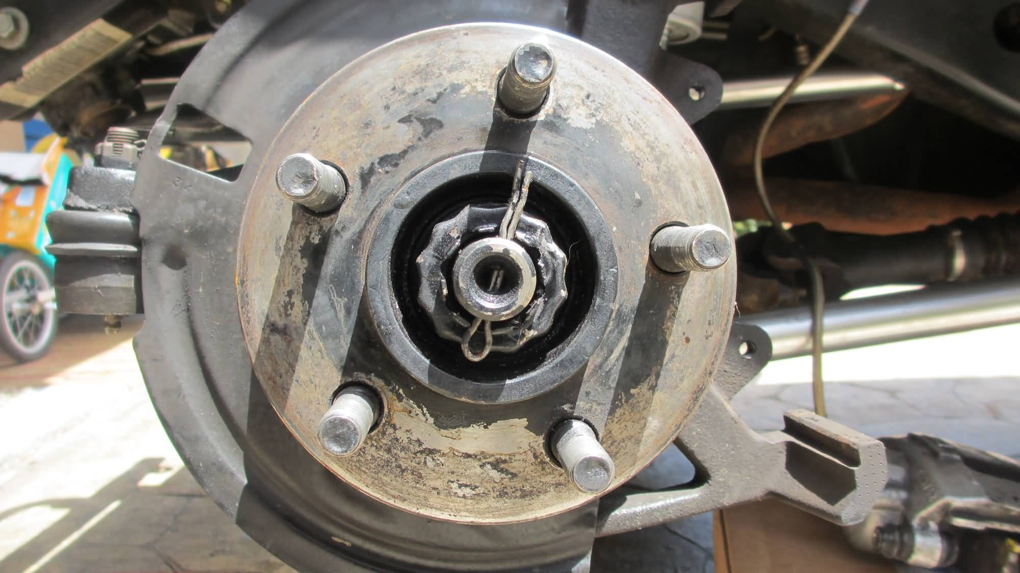

  3. This is what the hub / bearing assembly looks like

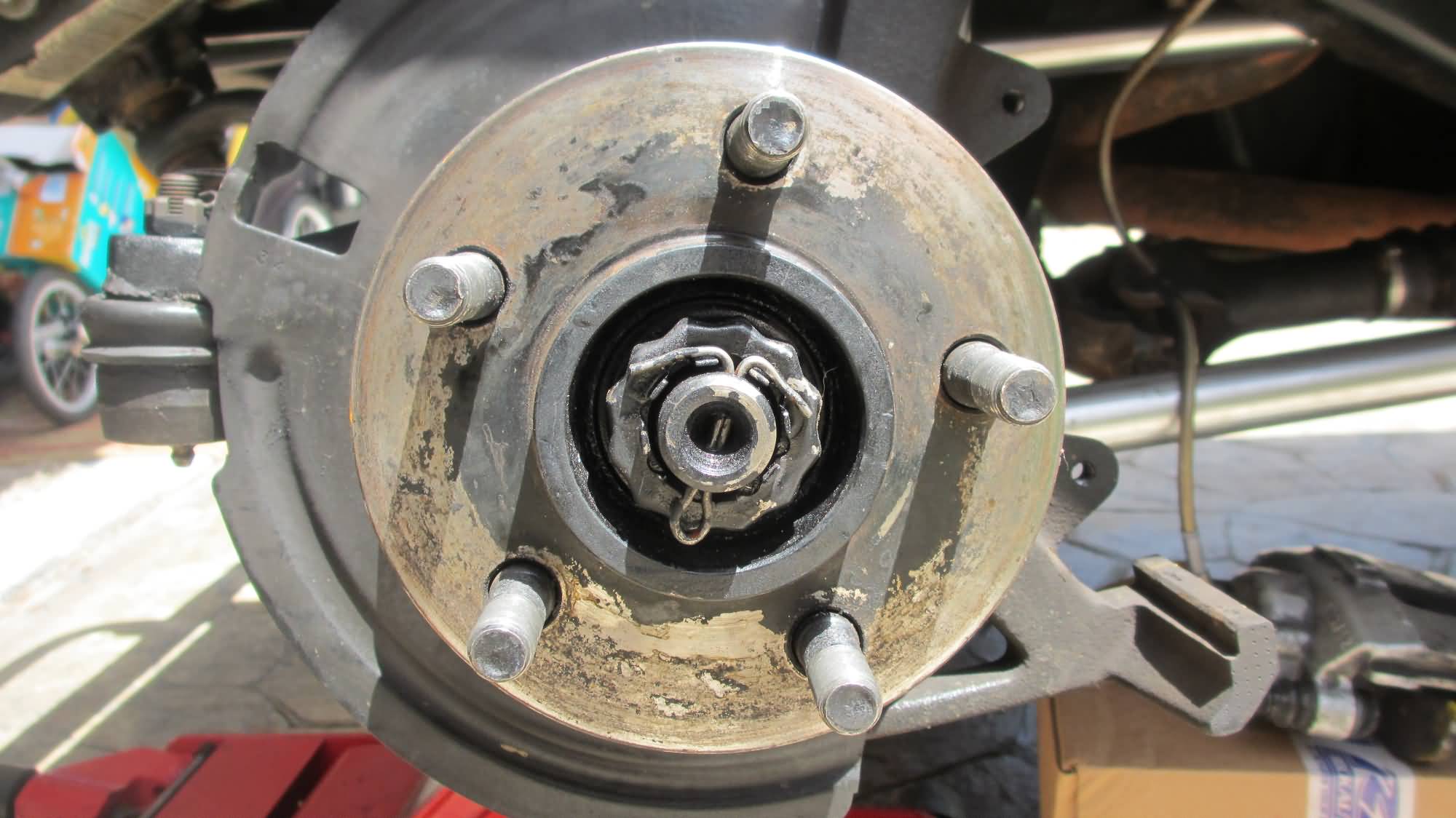

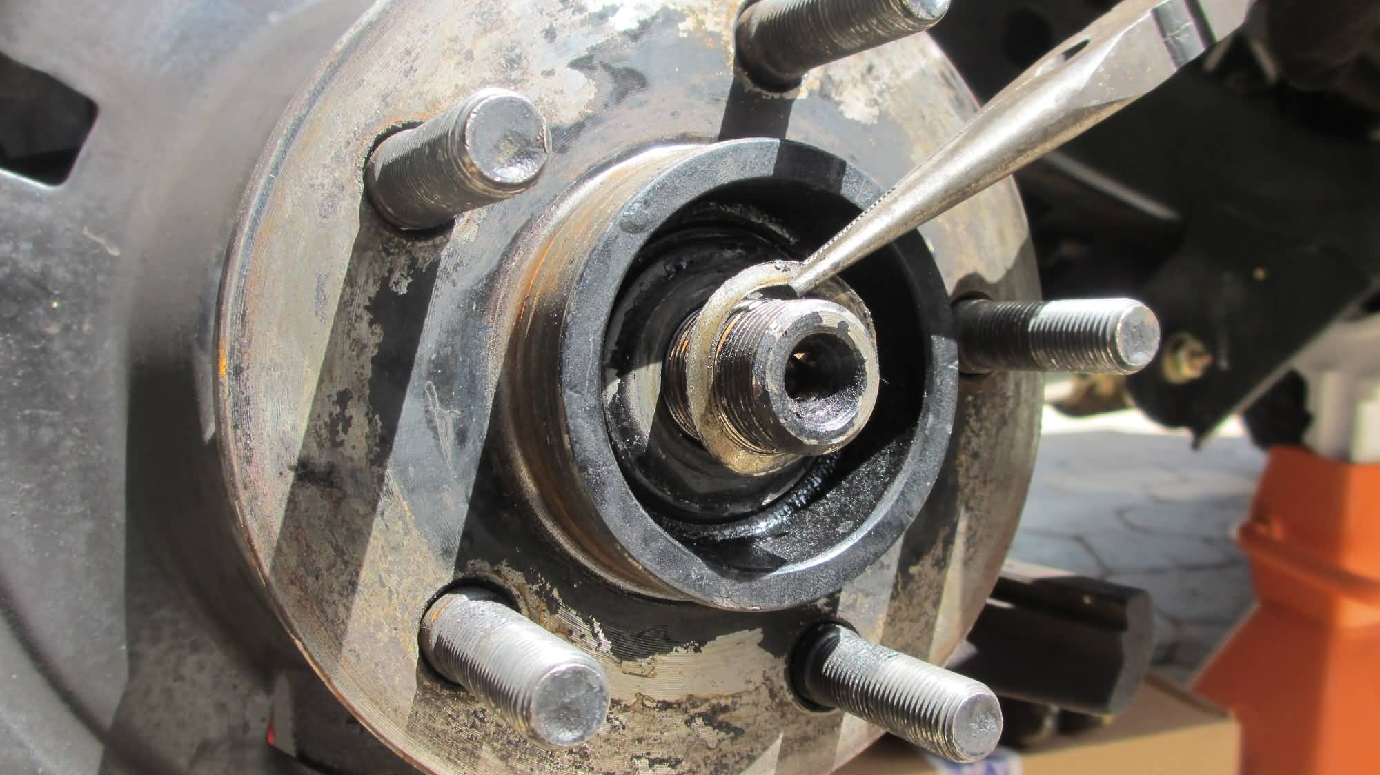

  4. With a pair of pliers, remove the cotter pin
  5. With your hand, pull off the retainer
  6. Here is what the cotter pin and retainer look like

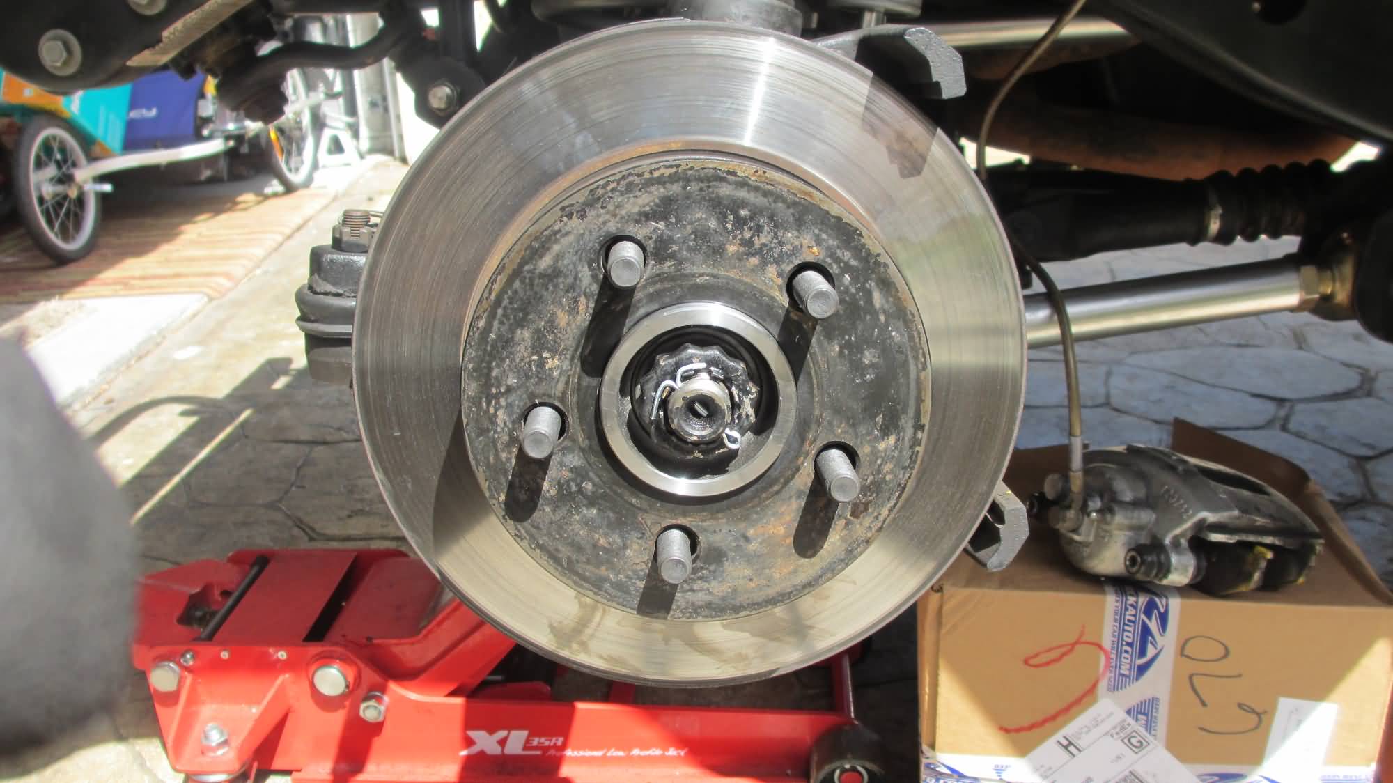

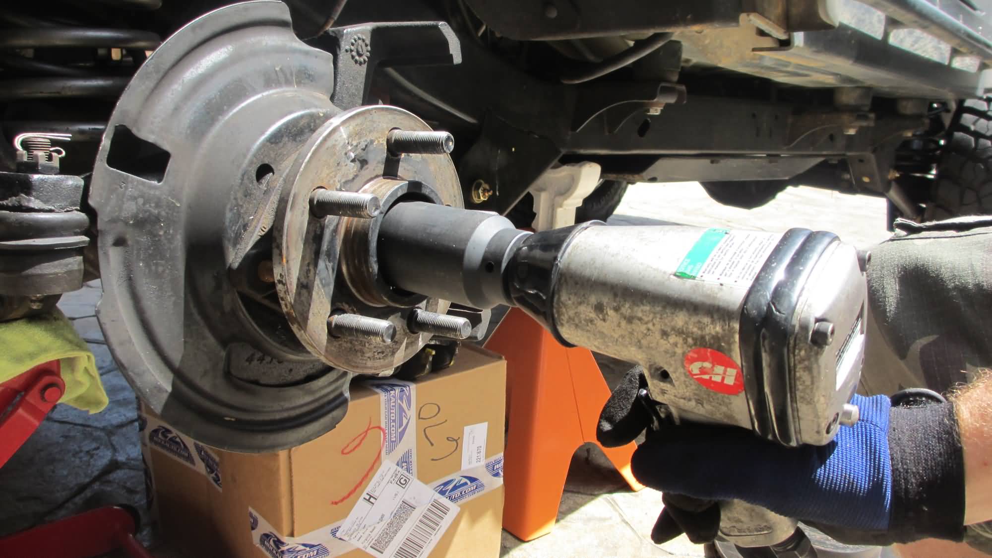

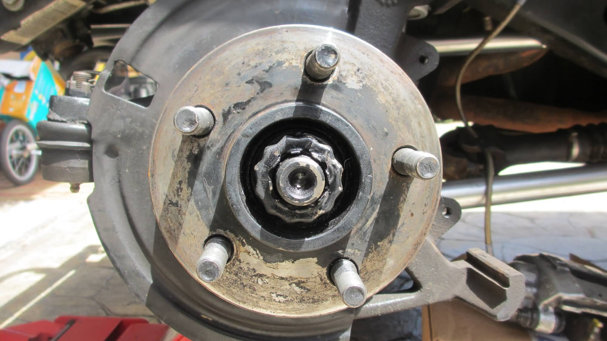

  7. Remove the wheel nut. Air tools make it easier.
  8. Remove the washer

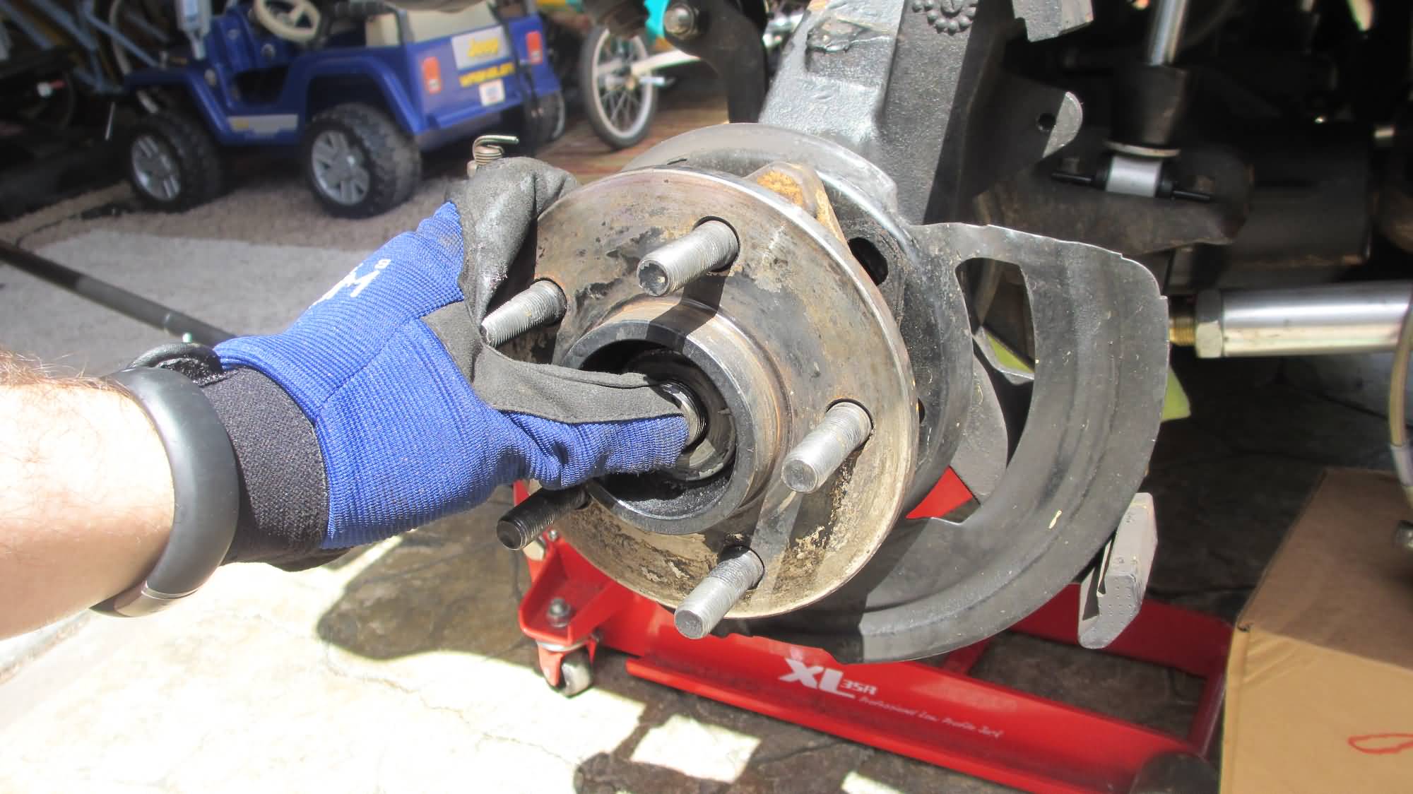

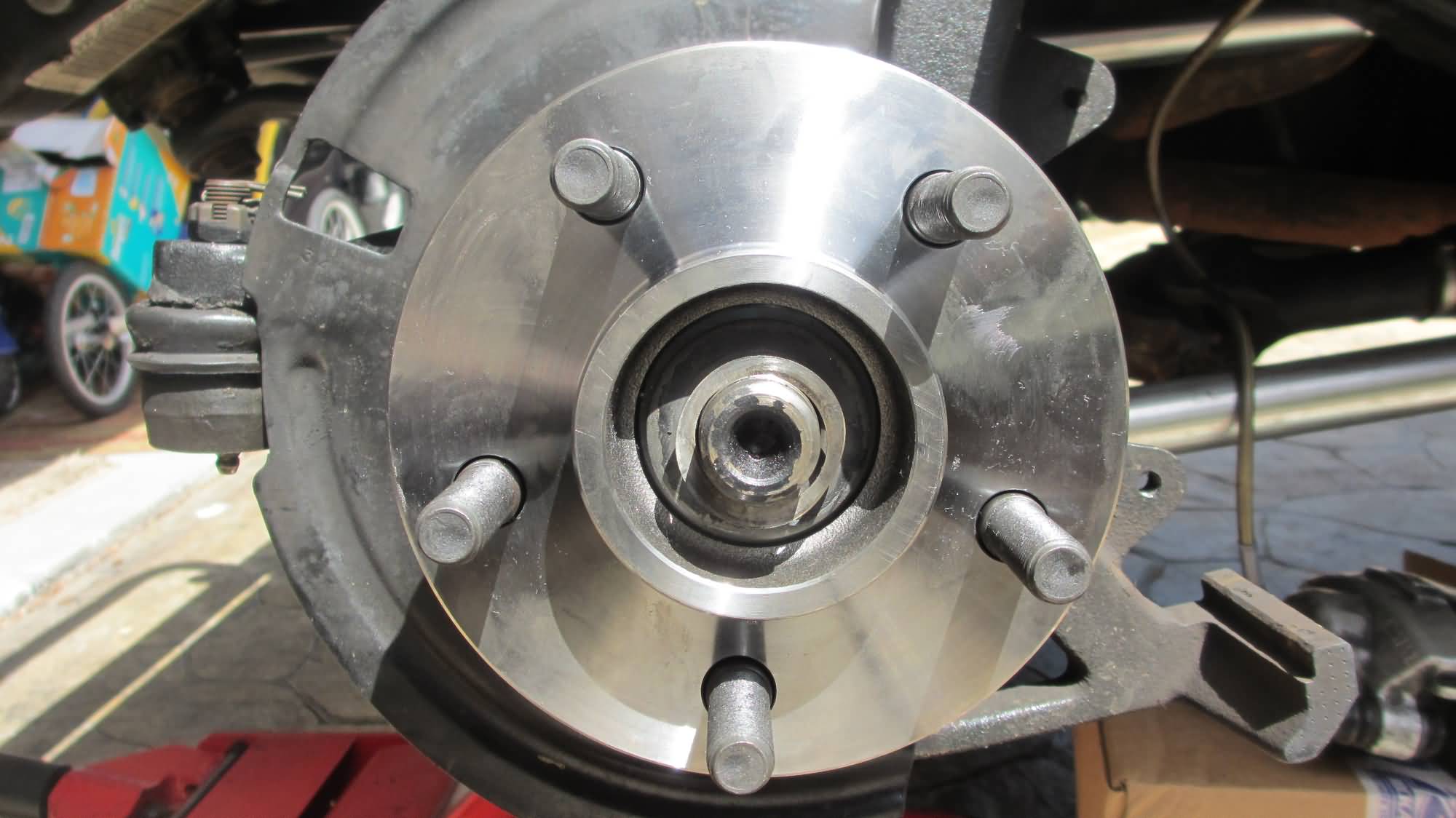

  10. Pull the hub assembly off with your hand
  11. At this point we begin reassembly. Make sure you install the brake shield facing the correct way, or else you’ll have to take everything apart again (ask me how I know).

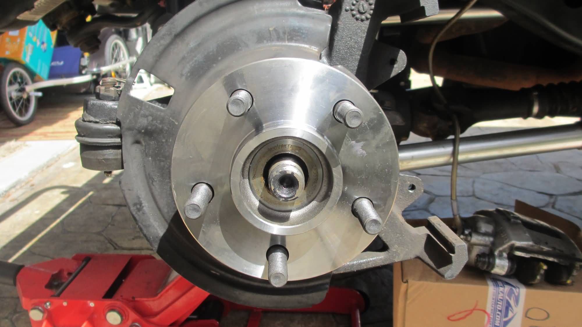

  12. Install the hub assembly, and tighten the three bolts that keep it in place.

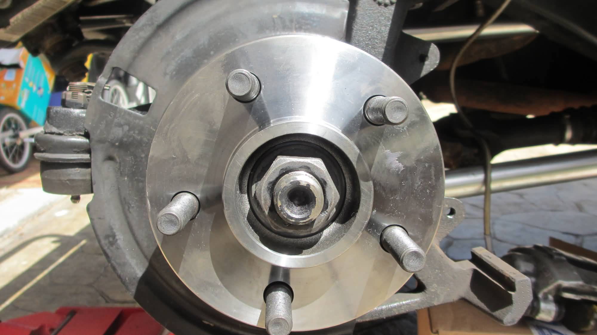

  13. Put the washer back on
  14. Replace and tighten the wheel nut

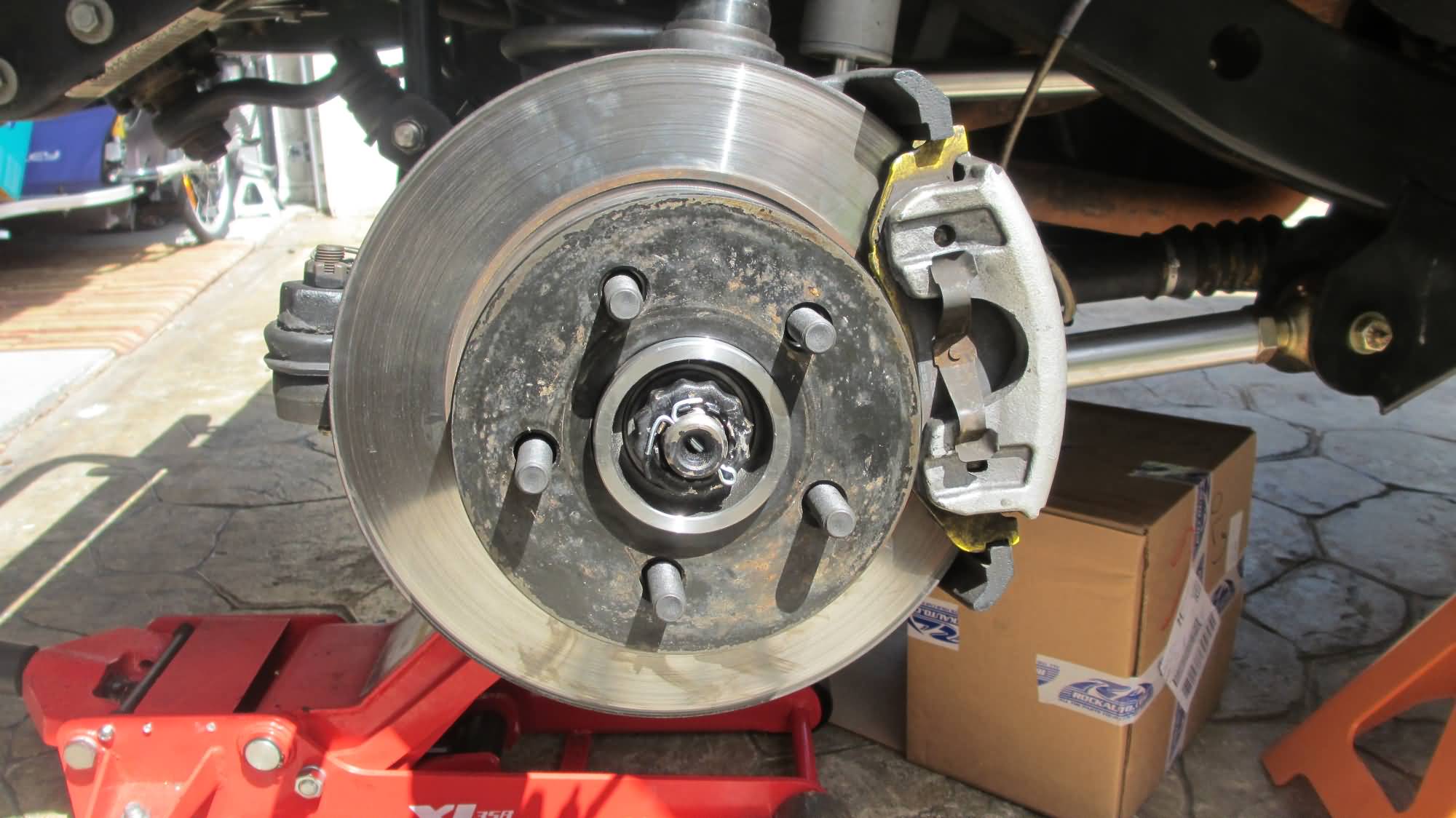

  15. Replace the retainer and install a new cotter pin, and put the brake rotor back on.
  16. Re-install the brake caliper

I believe you want the Timken 513084. You can see it on amazon here
https://www.amazon.com/Timken-51308...utomotive&vehicleId=10&vehicleType=automotive
This procedure should be similar to your XJ.
You appear to have a sealed hub assembly, so you can't just repack the bearings yourself, like we did in the old days. Now you just replace the entire unit.

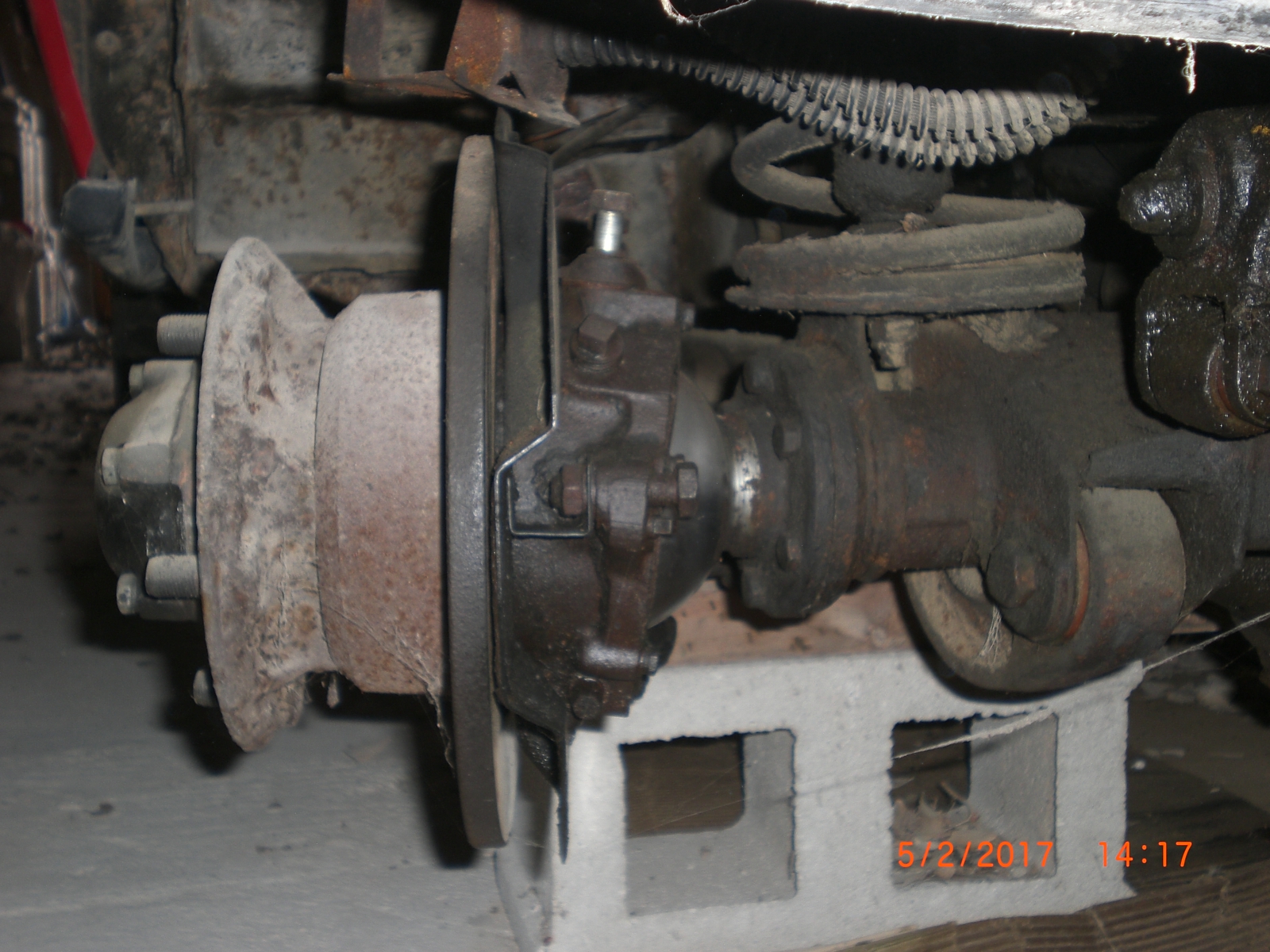

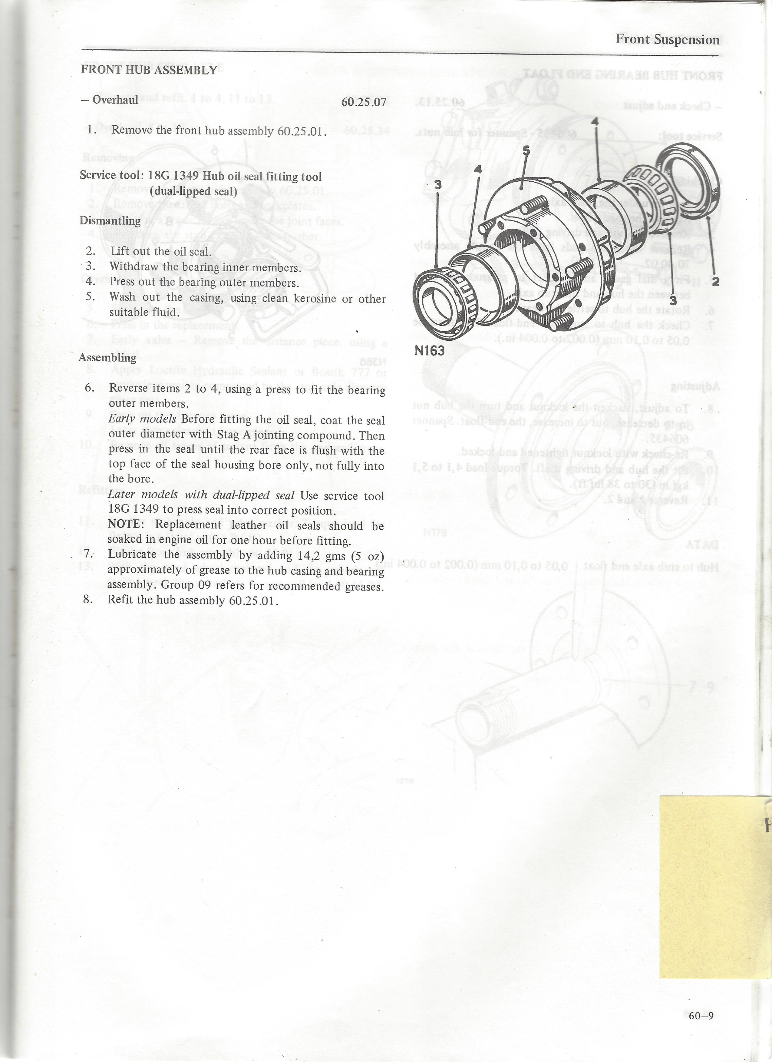

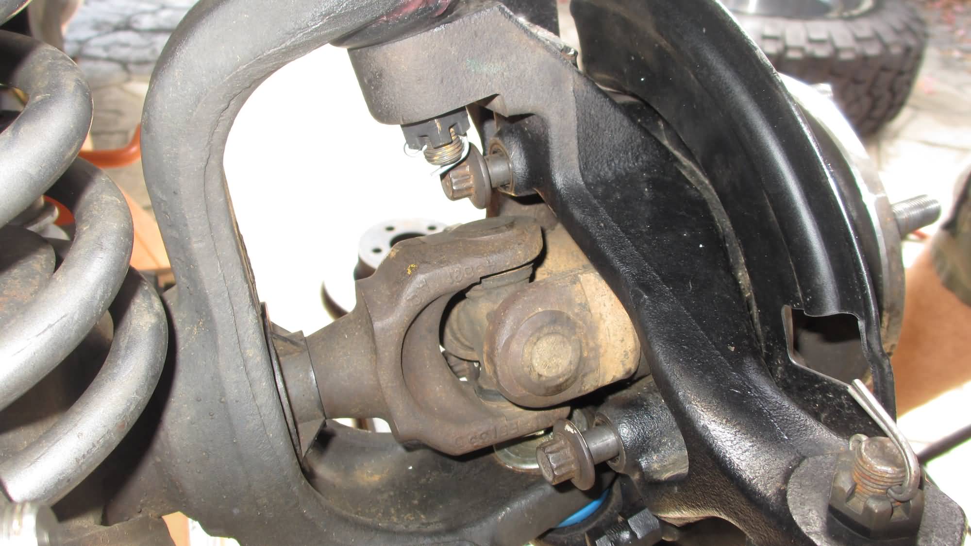

Just for info I have attached the Range Rover steering hub. The bearing bore is about 2ins and the CV joint runs in oil within the knuckle (centre of pic). Far more truck-like.
My greatest sadness in recent years is the demise of the grease nipple and a screwdriver slot you can adjust stuff with.

Sure glad you posted a picture of the front hub assembly of your jeep .
the axle in this jeep , from the Range Rover , is completely different from a Dana 30 open knuckle axle . You could not order parts for a traditional jeep Cherokee XJ as we are accustomed to here in the United States . If parts numbers cannot be gotten from the axle ( possibly stamped on axle tubes ) , you'll have to find out what year vehicle this axle originated from .
I don't know much about jeeps produced for foreign consumption or if this was produced in Europe under license but if it were originally built with that axle from the factory , there should be records from a dealer or at least on line regarding parts numbers of the axle assembly and/or its related parts . Your jeeps front axle is a closed knuckle design and dosen't appear from the photo posted that it has anything at all in common with the Dana 30 open knuckle design we are accustomed to here in the U.S. . I'm afraid the Timkin parts numbers won't apply to your jeep .
Real interesting set up though . If you wouldn't mind , we would sure like to see some more pictures of the jeep . Body , engine and drivetrain would be nice . Would like to say , it appears to be an awesome design ! Love to know more about it !
