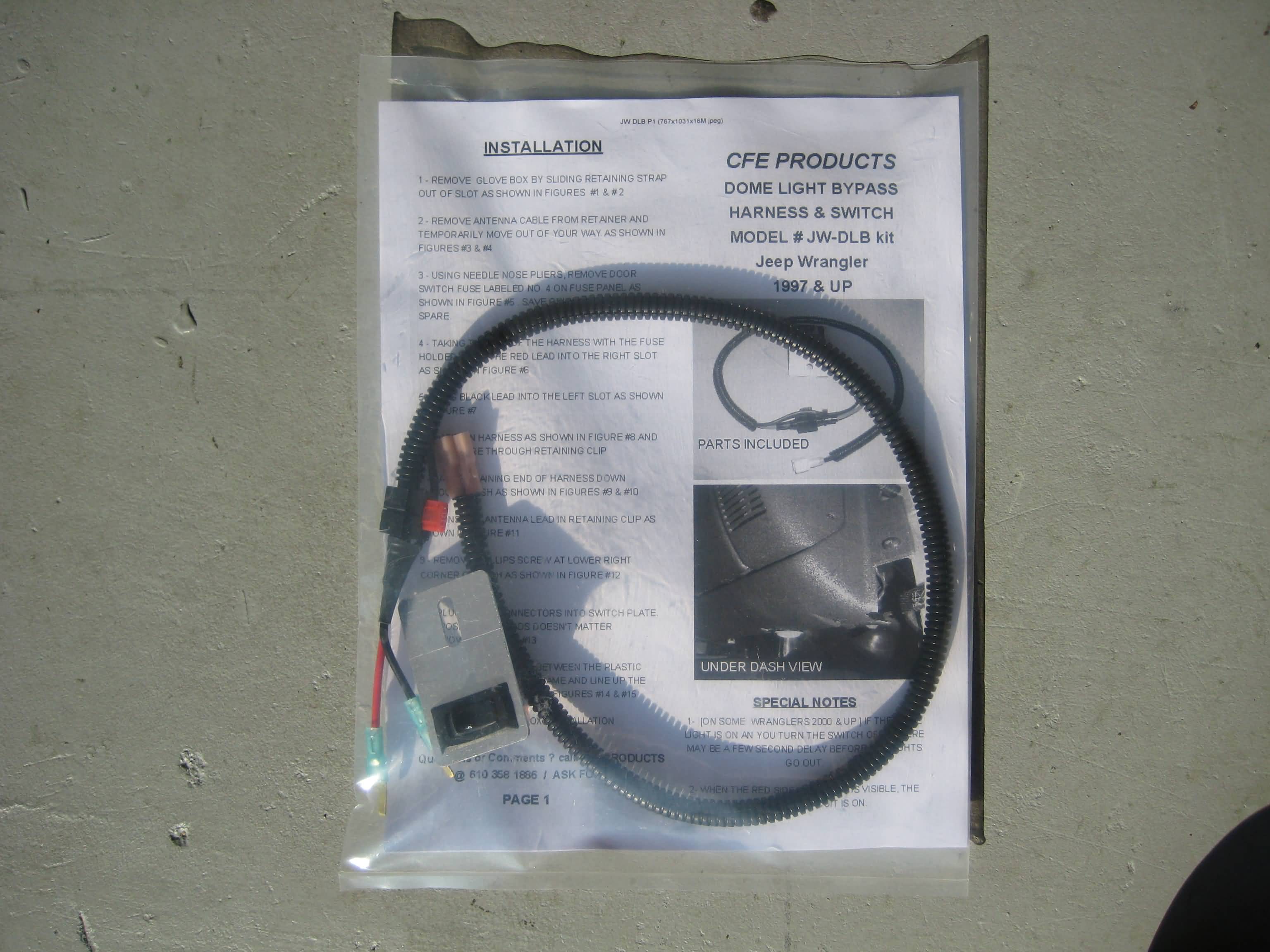

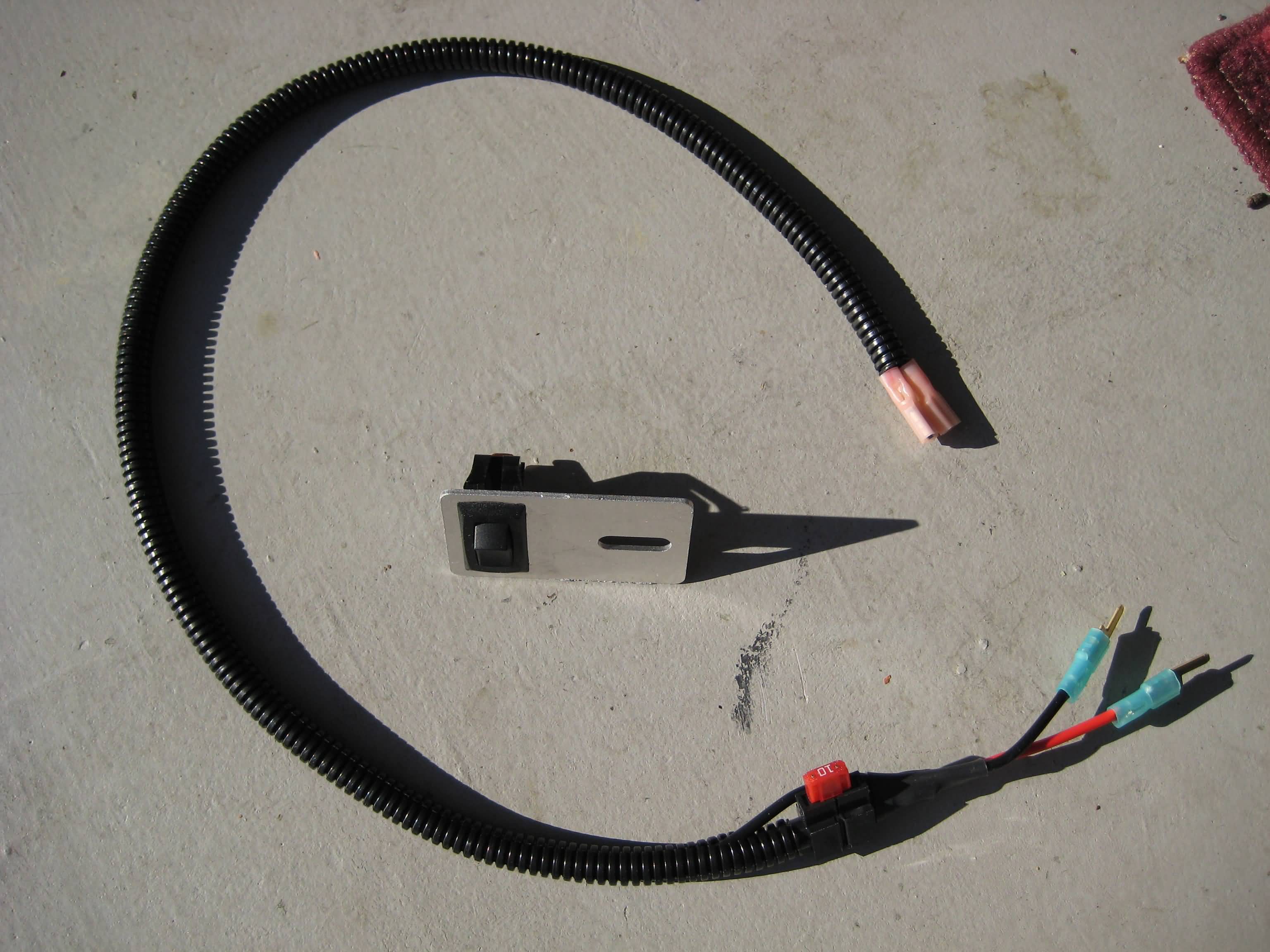

This device is so simple that it's brilliant. You replace the door fuse with two leads that go to a switch (mounted under the dash in reach of the driver). There's an inline fuse to protect your circuit, and the construction of the harness is great.
You can find this switch by going to Quadratec's website and looking for "dome light switch".
The verdict - I love this thing. Probably the best $25 I've spent on my Wrangler so far.
Install instructions and kit contents
Install instructions and the contents of the kit

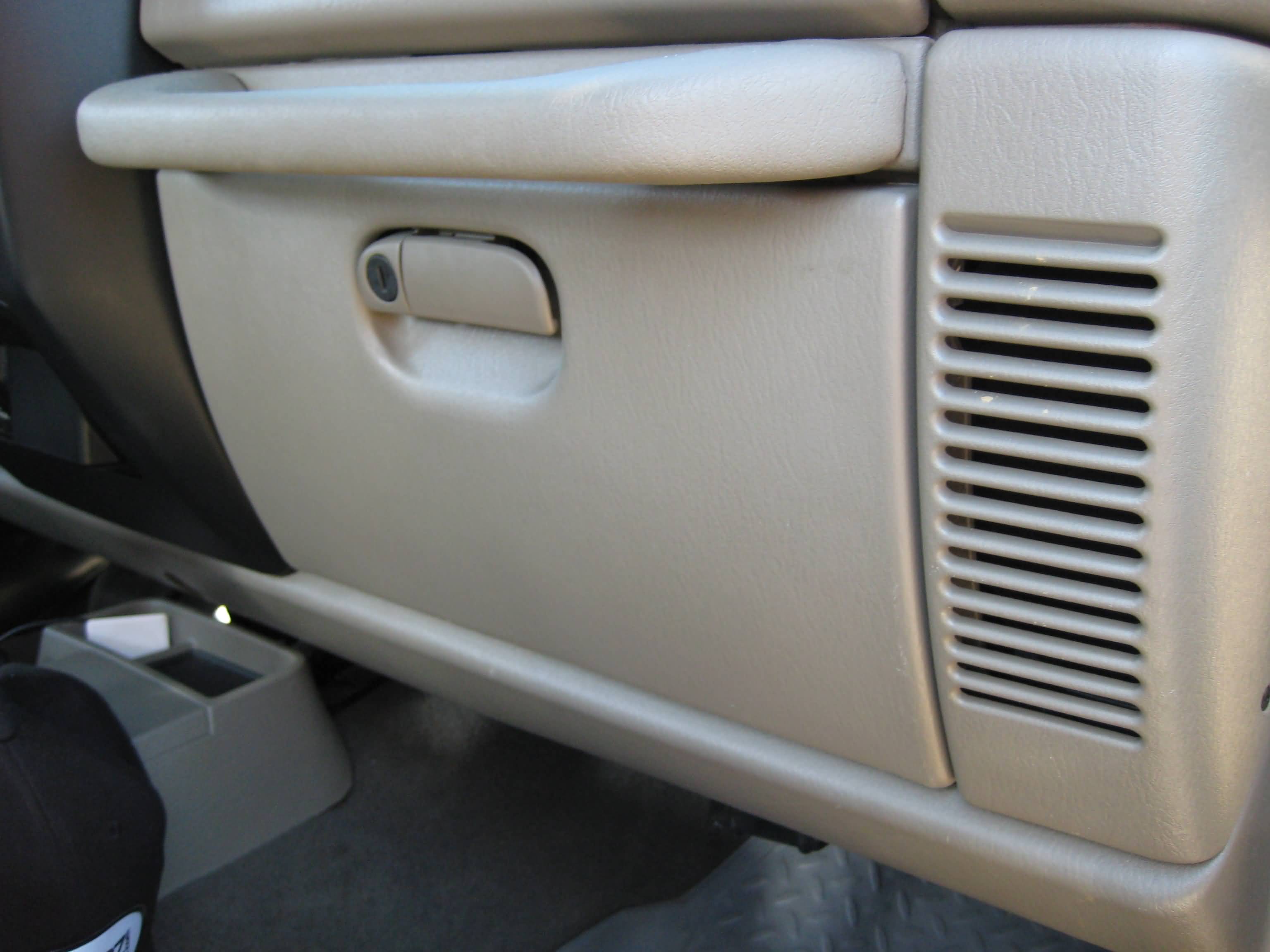

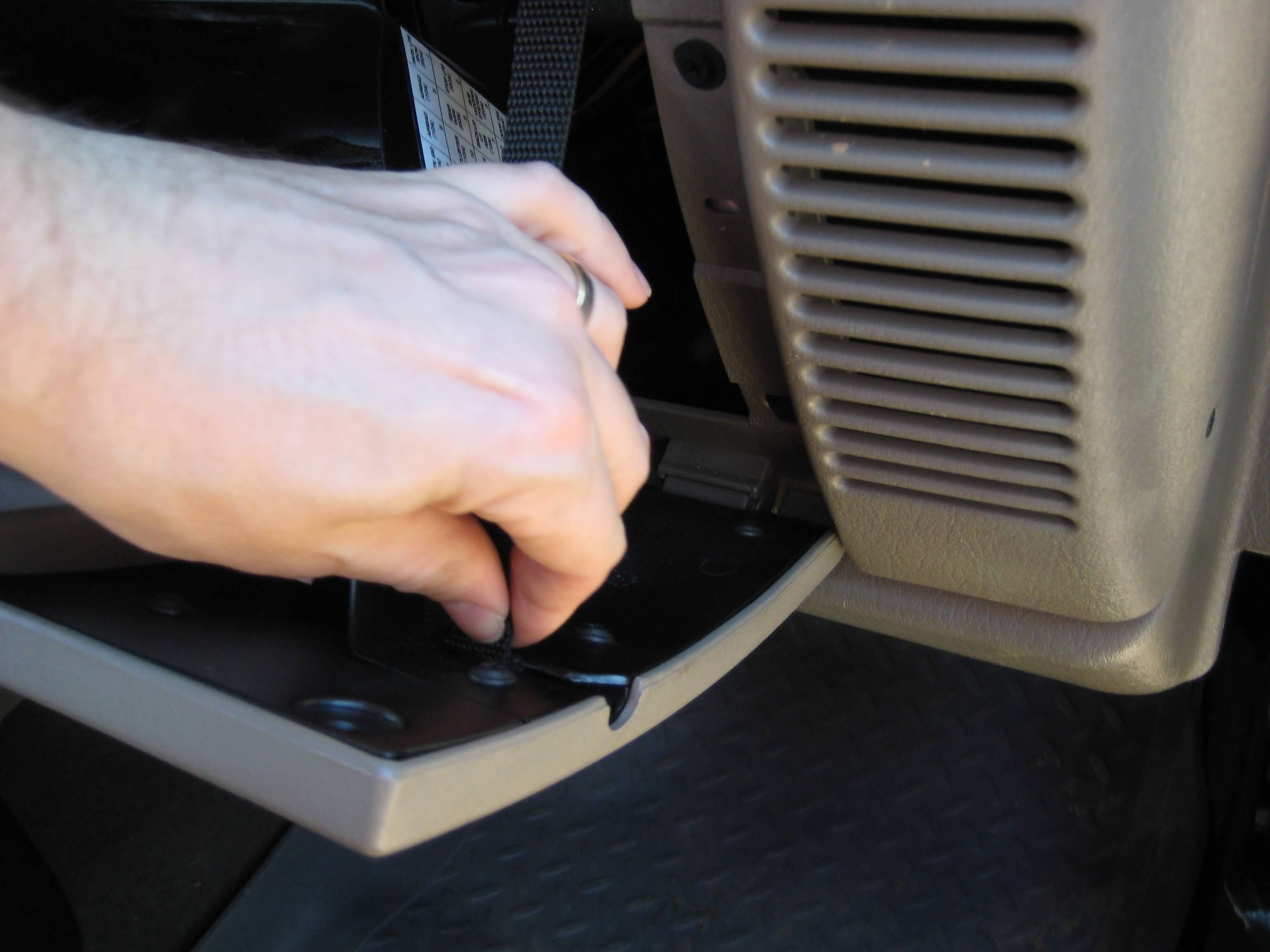

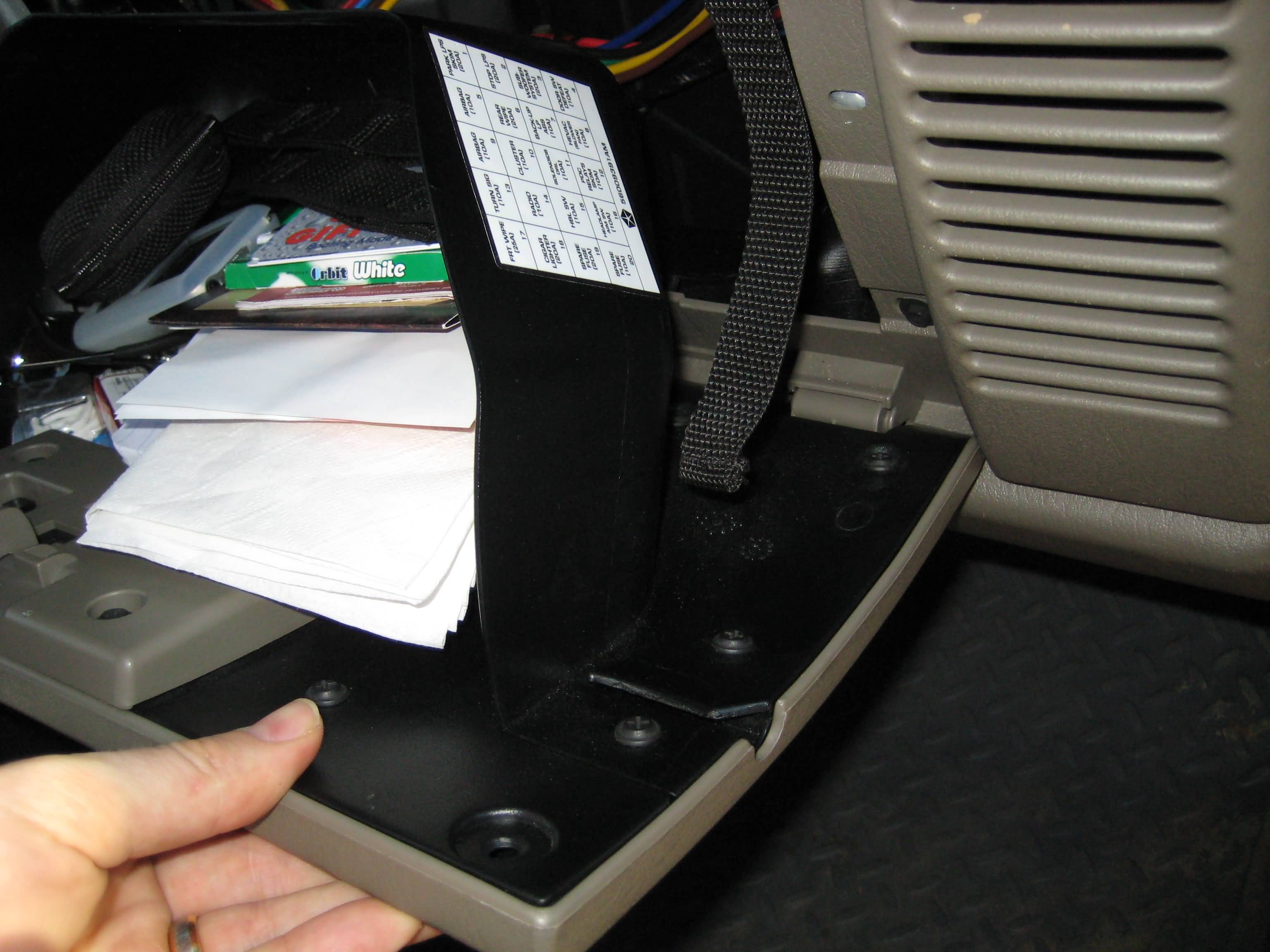

To install the kit, first remote the glove box

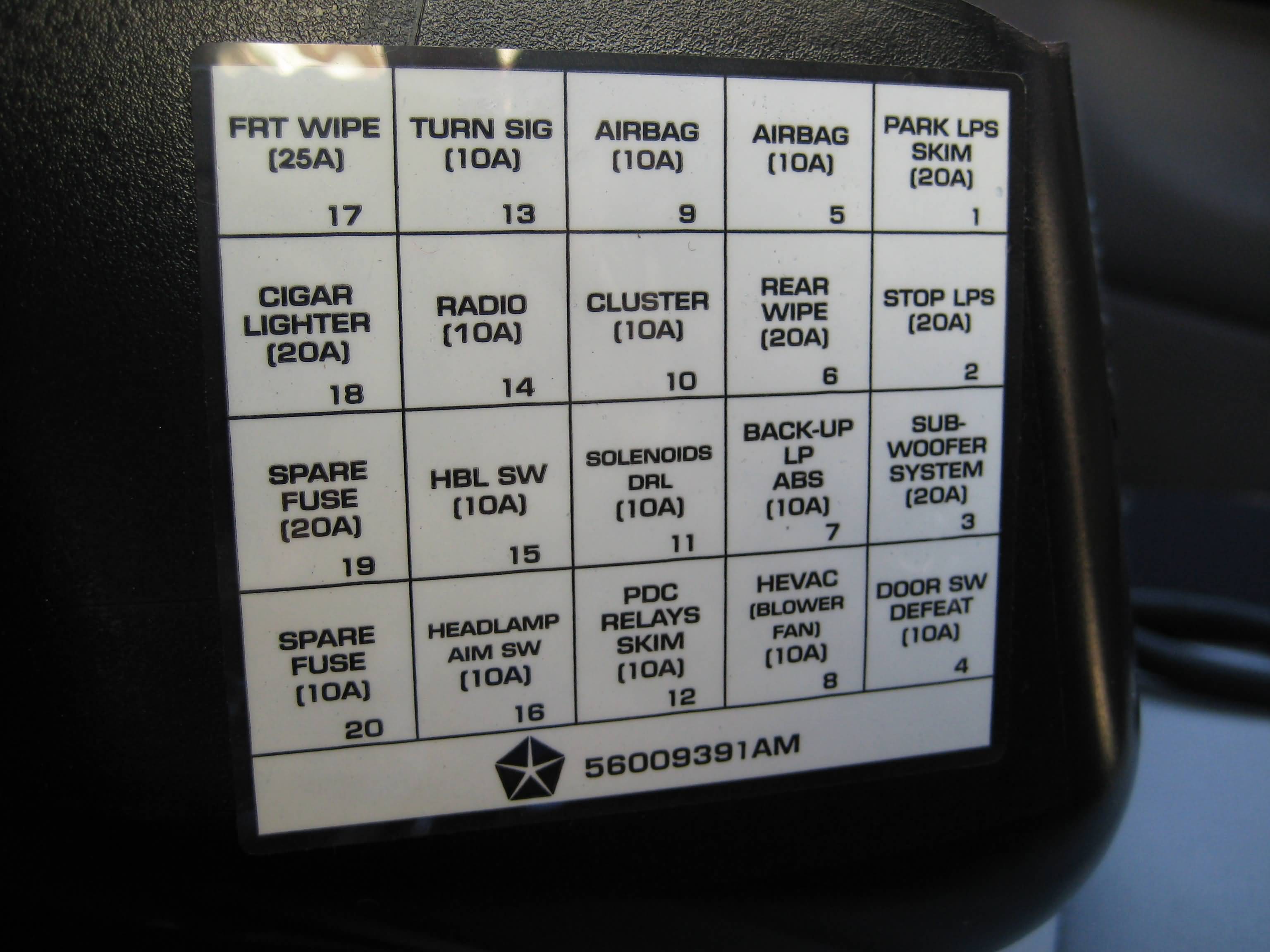

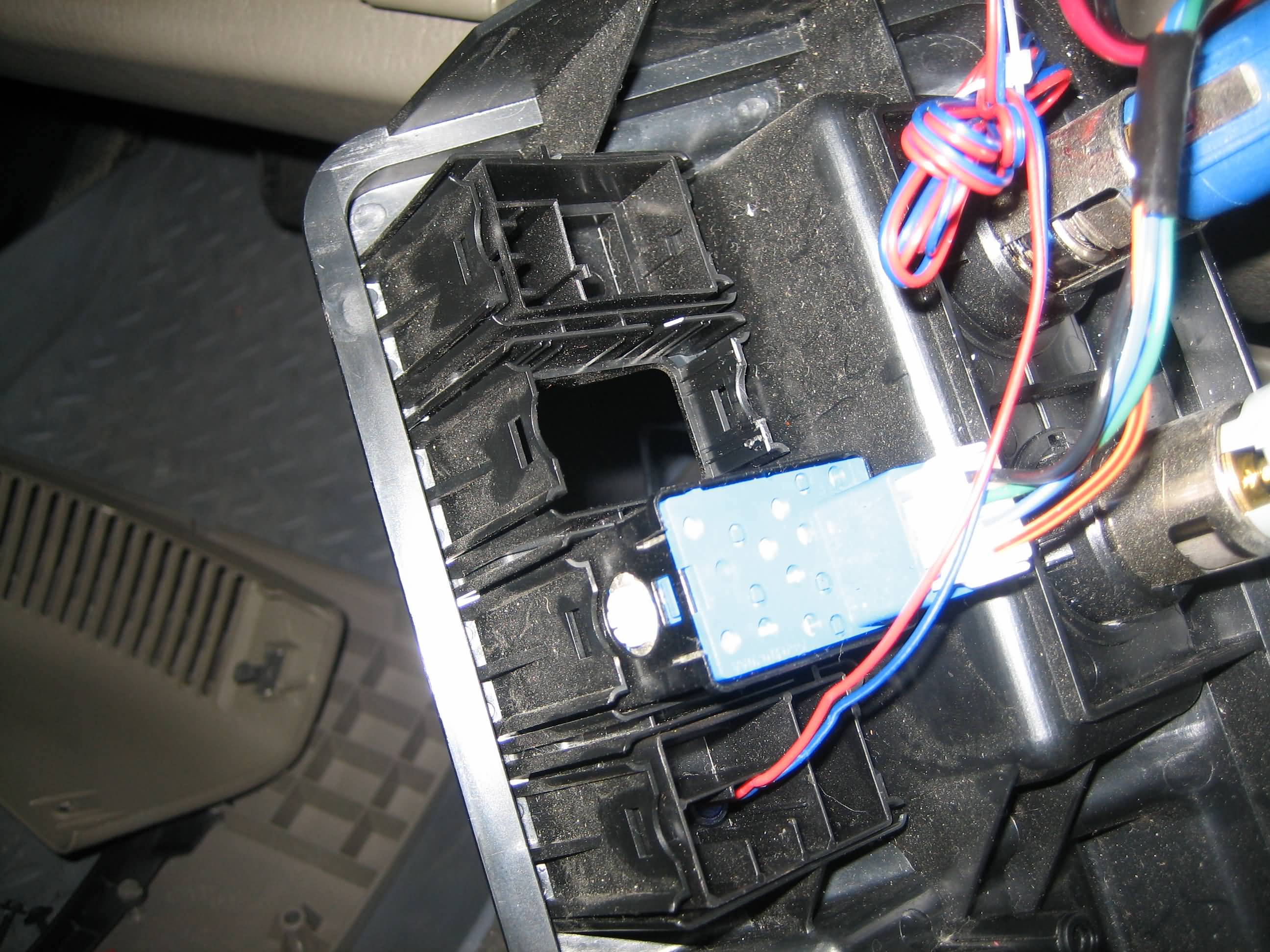

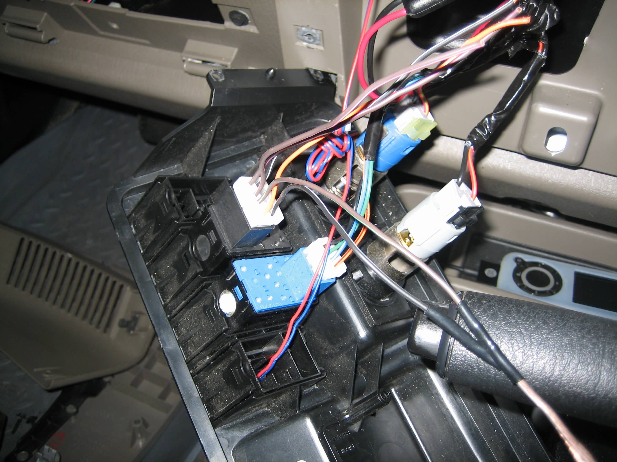

Install the harness
Now, you locate the proper fuse (the legend is on the back of the glove box), remove it, and plug in the new harness

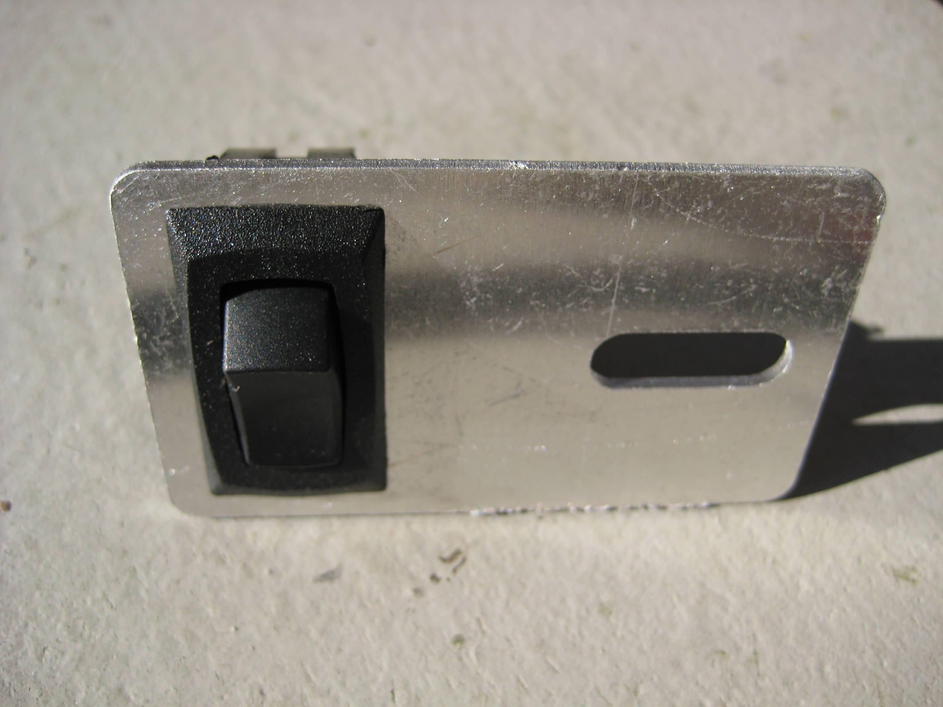

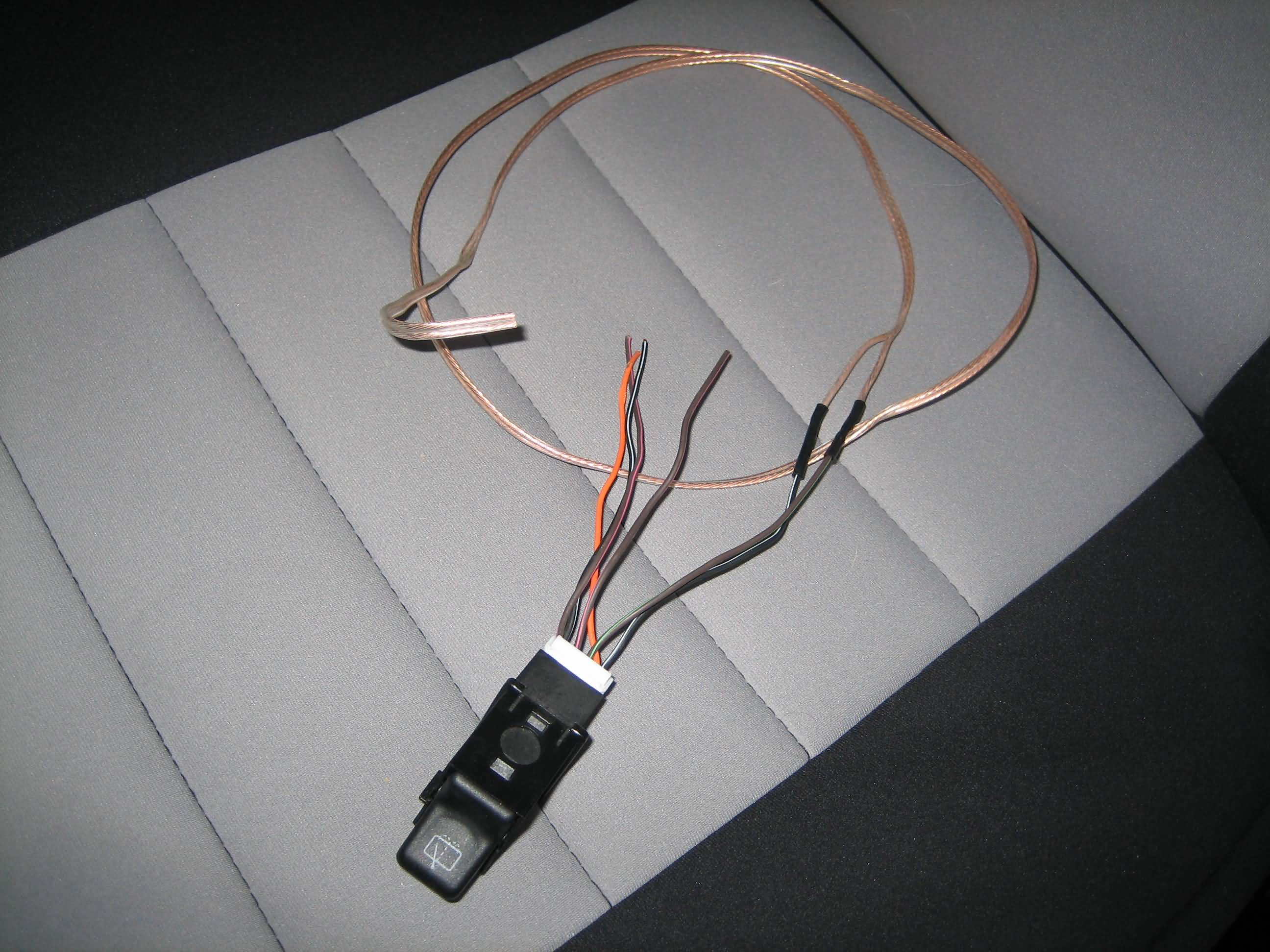

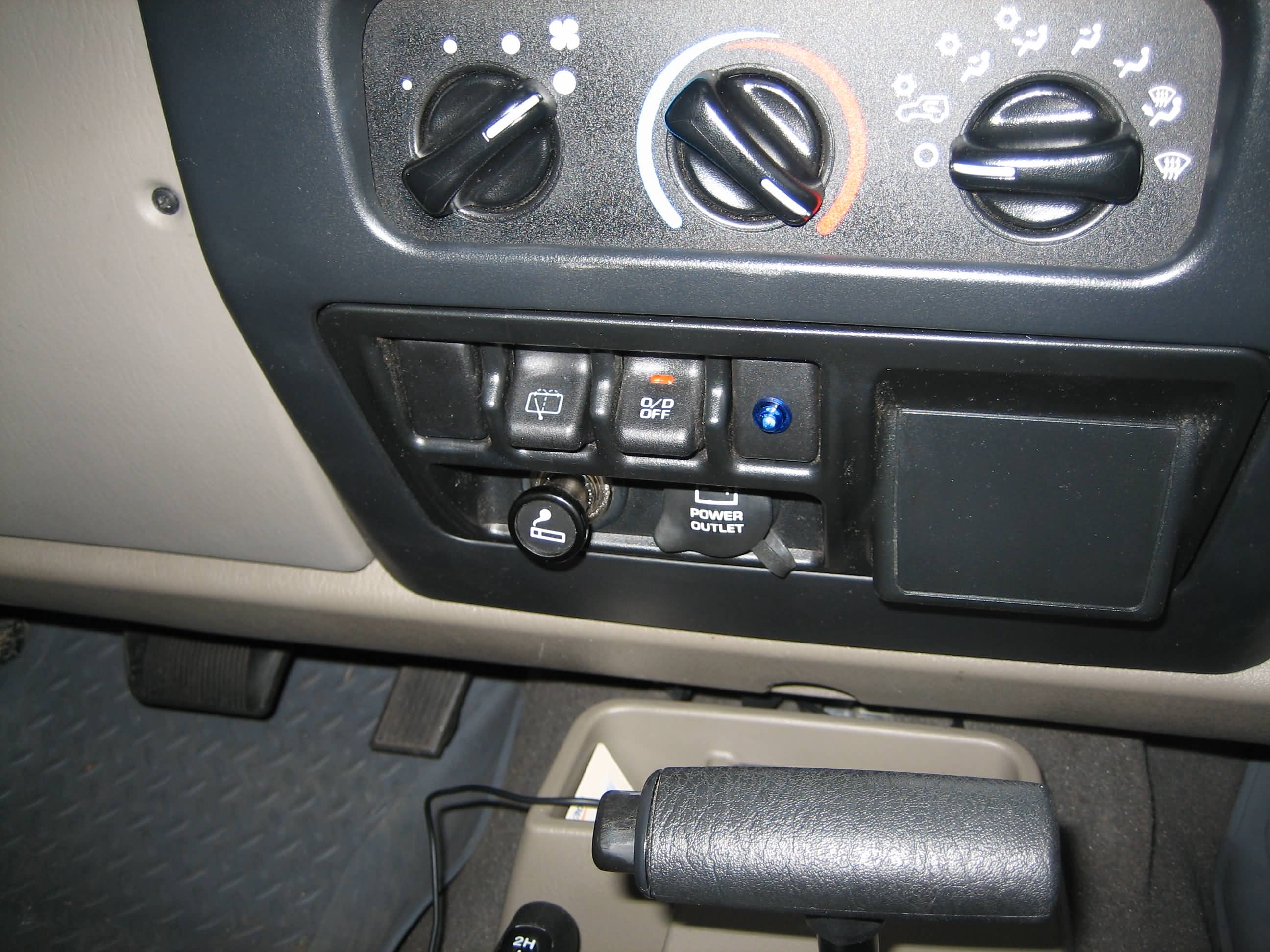

At this point, you are supposed to install the door switch supplied by the kit. I however wanted to one-up the makers of this kit, by using my own switch. I purchased a jeep rear wiper switch on ebay, and installed that in the center console. Purely personal preference on my part.

Where did you get the connector for the new wiper switch?
I bought this also and used the supplied switch mounted to a screw under the glove box. Absolutely worth the money.
Sorry if my Question wasn't clear. The center console switch you purchased from ebay, did it have the wire stubs already connected or was there a connector you purchased to plug into the switch?
The switch that I used was a rear wiper switch. The previous owner just pulled the switch out, and cut the wires, so I got the switch, along with the plug and 6" of wires.

Using the kit from quadratec there is no additional wiring needed. It's plug and play.
I got fancy with my factory switch just because I liked the look of the factory switch over what was included with the kit.

Yeah. The kit comes with the switch and wiring, including detailed instructions (including photos). Take a look at the directions at the beginning of this thread.
but if i get a different rocker switch will i need anything additional? will it still just plug in the back to one of those prongs?
Depends on the rocker switch you buy. The factory rear wiper switch I used only had bare wires (as you can see in the photos above).
