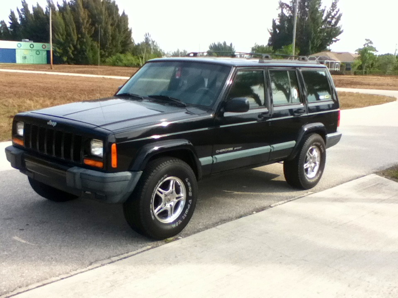

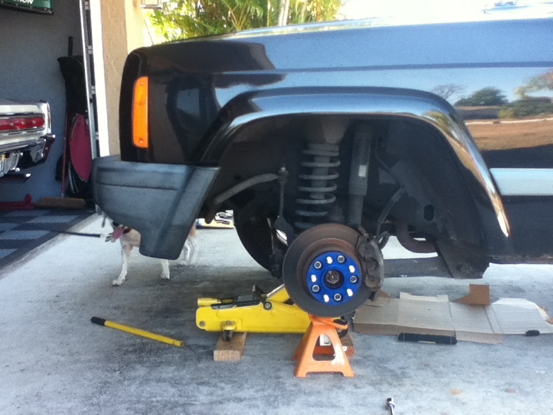

i just got a set on my cherokee in december and i think they work fine, mine were 1.25" from spidertrax and they were the first company to invent wheel spacers, installation is a snap
and it did give me a more aggressive stance

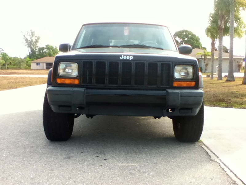

i origionally got them because my tires were to big 30x9.5x15 and they rubbed the front control arms in the front, onve i had them installed i only had to trim a little of the inside of the fender but then they stuck out to much in the back and they dont tuck anymore :/
(thats not sag its a flex lol)

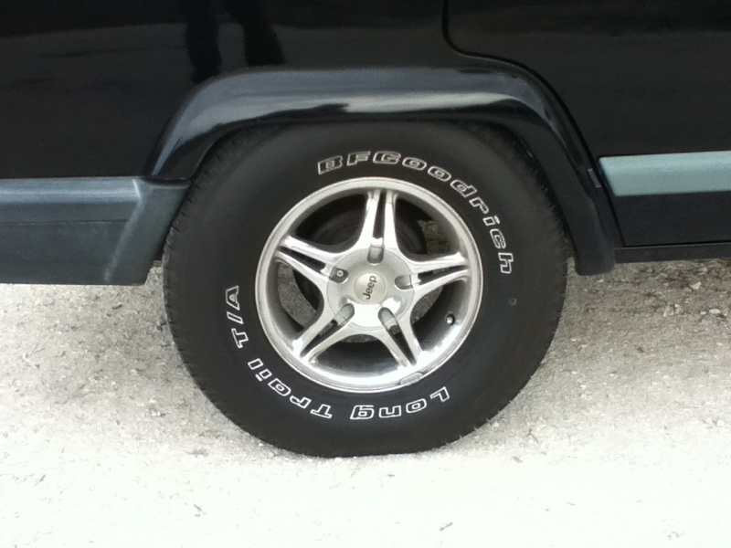

so whenever i carry over 500lb the back en sits so low the fender rubs the tire (a problem i diddnt have before the spacers)
so now i had to buy a lift to get the fender off the tire without trimming it, the moral of my story is, make sure you will be happy with the ammount of tuck you will get with your tires sticking out farther before you buy it :)
