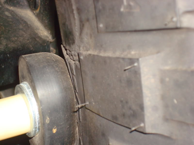

I used ABS rods instead to extend the bumpstops. And I DID have to use a spacer to push the spare back a bit, as it was not clearing the rear bumper. It's been over a year since I've done it, and still no cracks, sagging or anything (and I DO wheel the rig).

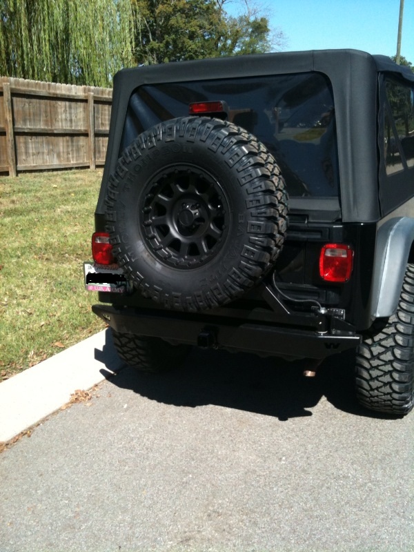

By the way, after taking this pic, I went to an aftermarket LED 3rd brake light to bring it OVER the spare wheel. But you can easily make your own and put it on the wheel itself (have seen it done) or space the 3rd brake light with some metal channel or something similar.

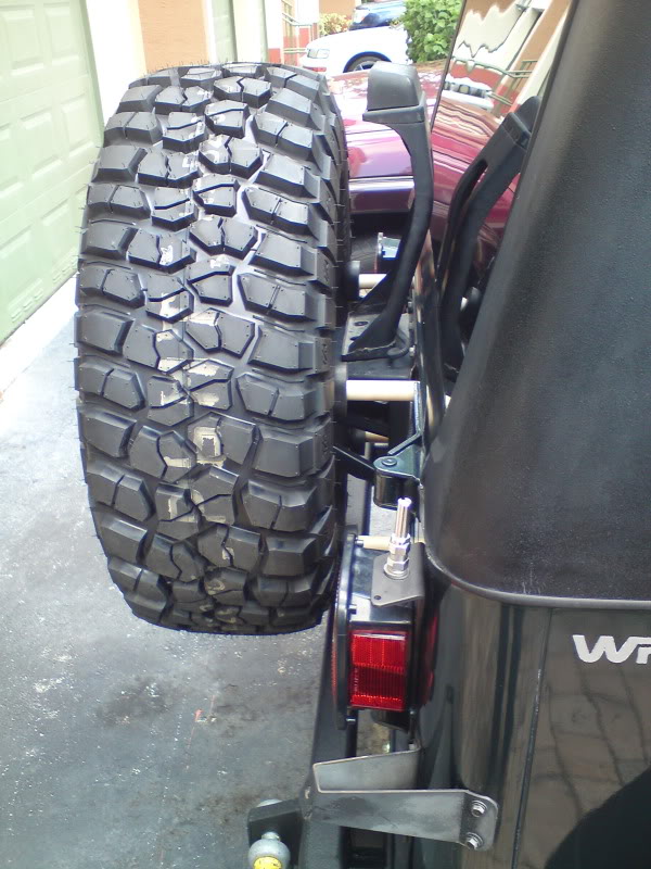

I also had to rig my 3rd Break Light but heck it works and I got a swing tire gate.

The problem is actually not the hinge; the problem is that most people do not extend the bump stops so the new tire ends up wiggling around back there (and the bigger the more leverage it has to wiggle) until it fatigues the metal, and the tailgate brakes (not at the hinges, but the metal itself rips). But if you extend the bump stops, you distribute the force, and whala! problem solved! now the issue can become if you can open the glass with the hardtop on, but that's a whole other ball game (mine BARELY clears the third light).
