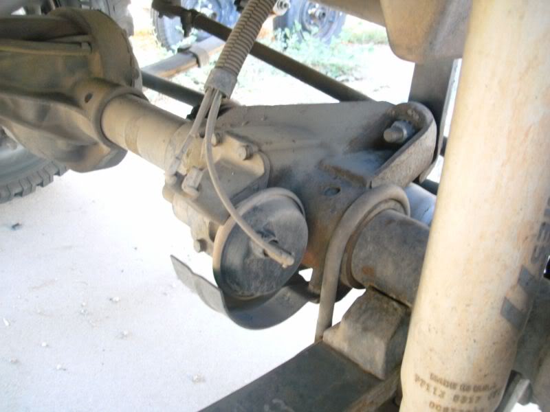

While digging about my Jeep today to try to get myself a little bit more familiar with it, I came across something mounted to the front axle with broken wires hanging off it.
I have no idea what it does.
That is what engages your front axles for 4 wheel drive.It is vacume operated,a lot of folks do away with that set up and get the 4x4 posilock system.The trouble with the vacume system is that the vacume lines ran behind the battery,and acid from the battery would eat up the hose,not to mention dry rot over a period of time.

The dash light he's implying about is the 4wd lamp that turns on when the 4wd is engaged. The wiring on the front axle actuator is for the dash lamp switch and has nothing to do with the actual 4wd engagement since it's vacuum controled.

The '90 shouldn't have any wires to the front axle disconnect, only vacuum lines. The 4wd light switch on a '90 is on the firewall with a vacuum line running to it.
If your 4wd light comes on when in 4wd, chances are the disconnect is working properly.
If you want to test the disconnect, pull the double vacuum line from the axle and feel for good vacuum alternating between the two lines as somebody shifts the transfer case from 2wd to 4wd and back.
It's also a good idea to remove the 4 bolts holding the disconnect to the axle and pull the disconnect out of the housing. Then move the aluminum shift fork by hand to ensure it moves smoothly.

gennybro, being stopped isn't enough for the disconnect to engage, it's highly unlikely the splines will be aligned well enough for the shift collar to move. It's not until you move with the front wheels turned slightly will the shafts rotate at a different rate & align properly.
the vacuum system is slightly better in this respect as the vacuum pressure on the fork is more forgiving until the splines are engaged.
