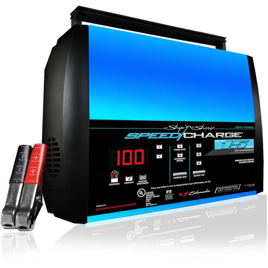

I'm a distilled water fanatic and one of the new Interstates was toast so traded for a new one at Costco. I've got a Schumaker 1500 (15 amp) b16709e3-1b90-494a-9dda-6c6ef93f2287_1.8a2d52891c34f0806f7646d80a52e553.jpeg coming and according to their site has a desulfation feature, I'm rather dubious about that but that's not my issue at this time. It does push 5 more amps than those NAPA ones that're failing though.
