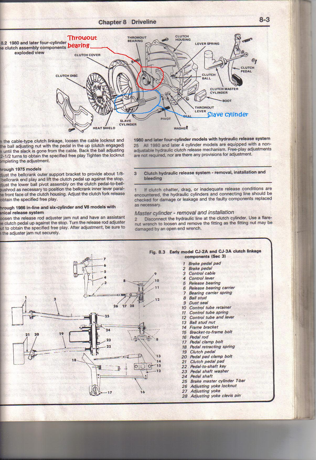

lets see if I can blow it up (click on pict than click again)
thats what the parts store told me the cost was for the throwout bearing. they told me for the '89 xj with the puegent 5 spd the throwout bearing and the throwout bearing are one piece.
Yes, for '89 the throwout bearing and internal clutch slave are one unit, hence the high cost. Wasn't until '94 and the introduction of the external clutch slave that the throwout bearing became a separate piece as indicated the above diagram.
