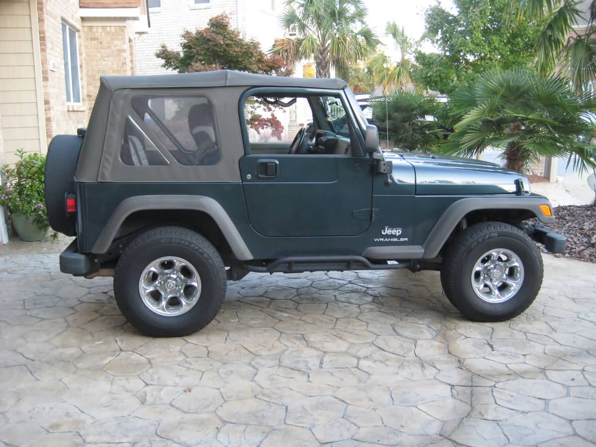

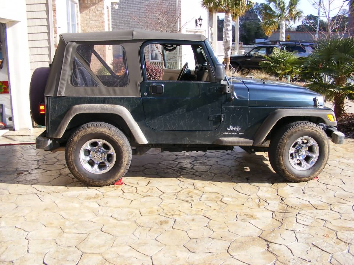

Here's a photo of my 05 with no lift and 31, and another photo with 31s and a 2 inch coil spacer.
