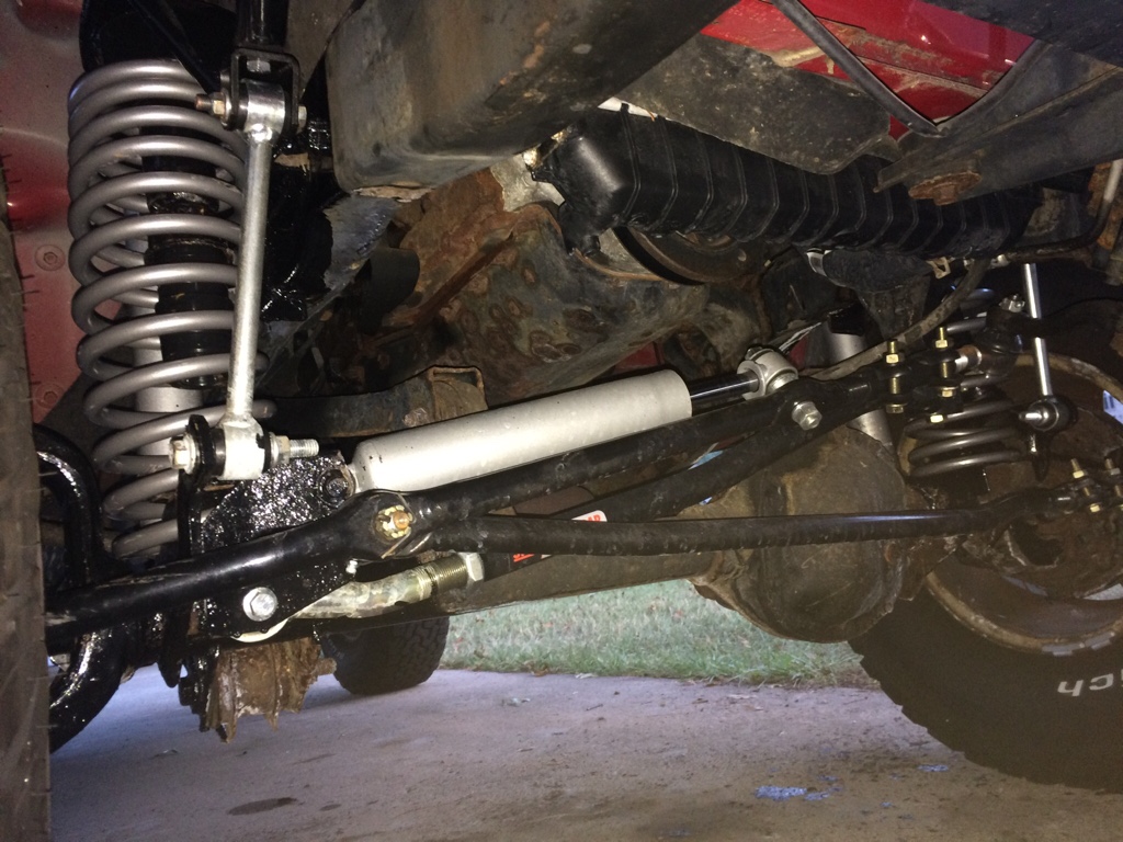

It's been a couple of years, and my steering is sloppy again. I'm planning on using some ZJ parts on my TJ this time around, and replacing everything:
DS1430 TJ OUTER CONNECTING TIE ROD END - PASSENGER SIDE-Right Outer (Drag Link) (x1)
ES3096L TJ FRONT OUTER TIE ROD END - AT PITMAN ARM (x1)
DS1312 ZJ Tie Rod (x1)
ES3096L ZJ FRONT OUTER TIE ROD END - AT PITMAN ARM (x1)
ES2079S Adjusting Sleeve (x2)
New steering stabilizer
Moog K3176 Track Bar Bushing (Axle side trackbar bushing on my setup)
Do you guys normally replace the Adjusting Sleeves when you do front end work? They don't look like a part that would wear out. At $25 for the pair it won't break the bank, but I'd rather spend that money on candy.
Any thoughts on my parts list? I'm looking at the ZJ tie rod as it's supposed to be solid, and a direct swap.
