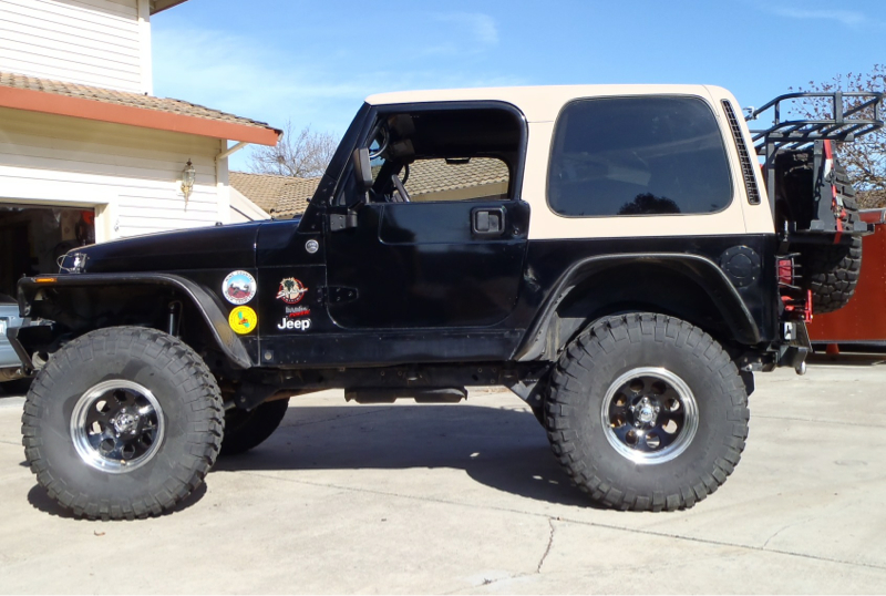

Next project, Teraflex tera low231 transfer case upgrade and a Rokmen Tummy Tuck. Switching out the 4.88's for 4.11's and installing the Teraflex tera low231and 2wd low. Tired of 10 mpg.

Terry, looks great! I've previously installed everything you mentioned. Hopefully there will be no surprises.
