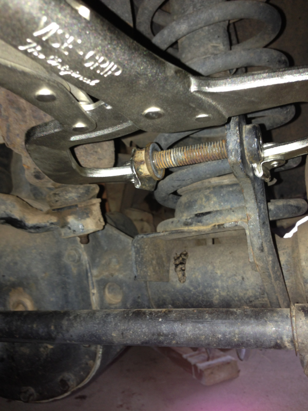

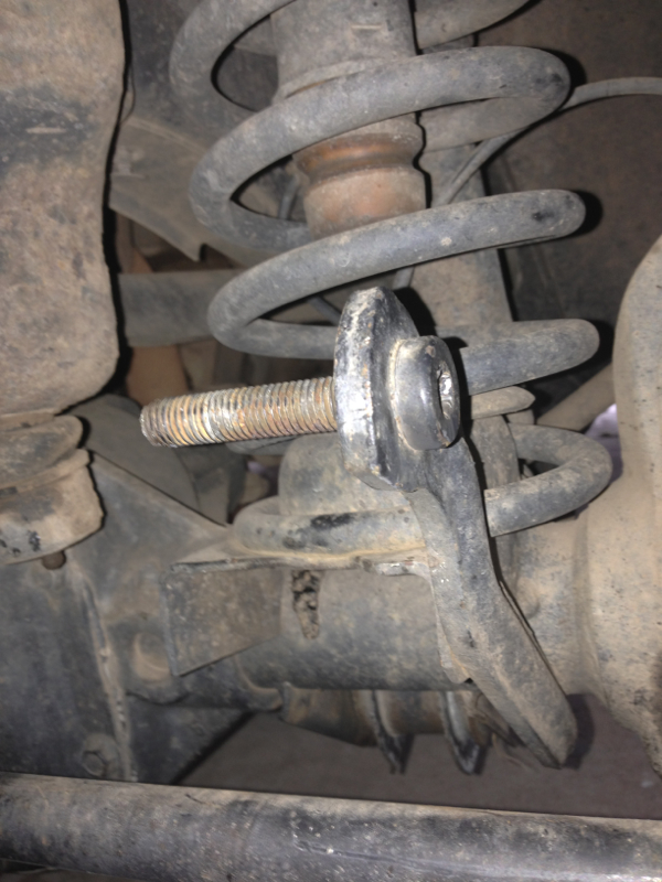

Though so do they come in bigger sizes(probably a very stupid question.) and this is a picture if my exact problem which you also probably figure I took the sway bar completely off hoping for it to be easier which it makes no difference
Can you put the nut back on and give it a few whacks with a hammer
Sent from my Samsung Galaxy S3 using Jeepz
With the nut on? What would that do?
And I stuck a jack in between it and cranked it pretty far didn't want to damage anything and I can't get a vice grip to get on the end of the bolt and something else
I know it's crazy this vice thing is really tight and isn't doing anything not even a little
And is it supposed to look like that I assume so but just wondering

Got some liquid wrench penetrating oil sprayed it in ever thing around it. Gonna be driving without the sway bar though just until after work tomorrow. Hopefully these suckers come out with ease.

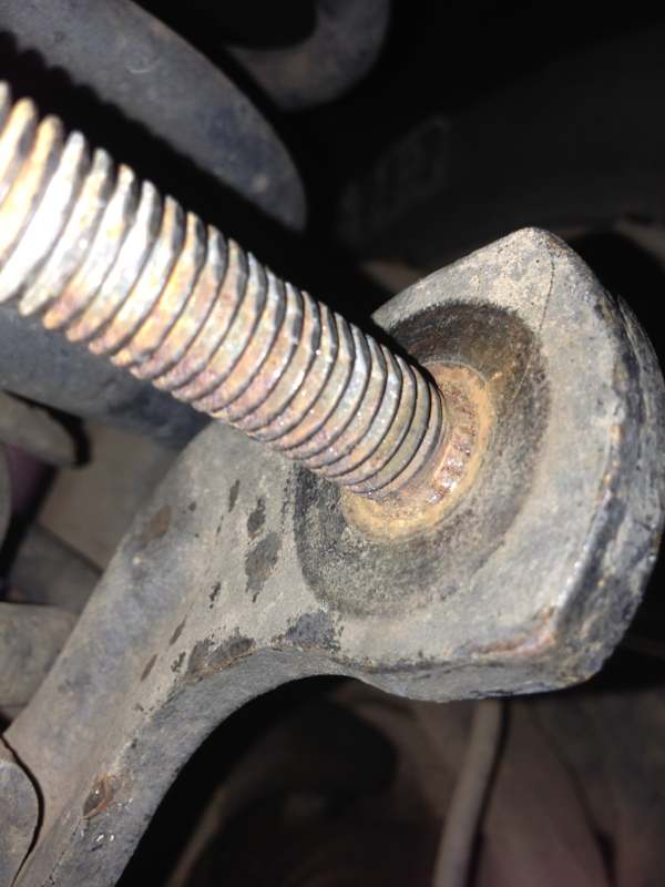

It will allow you to hit the end of the bolt and not destroy the threads...
From the looks of your last picture it has a spline ike a wheel stud, take a hammer and hit it....
Clearly it's a strong bolt. Give it a good whack. I would start with a couple days of liquid wrench. That stuff is a miracle worker.
