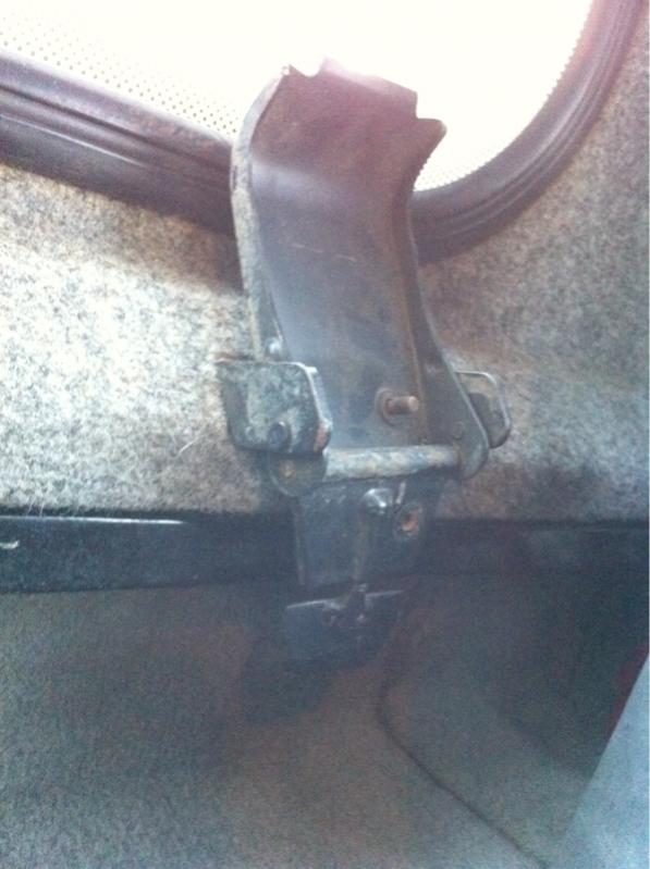

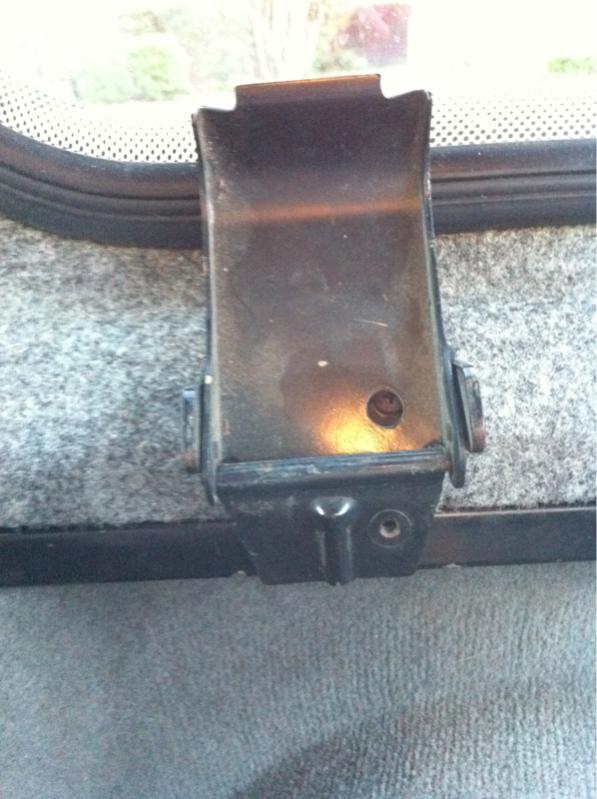

Has anyone had experience with them? I have their hard top and hard uppers and the uppers use door pins that have screws in them, does anyone know where I can get some? Also, where can I buy the catch for the hard top latch downs?

if im not mistaken steel horse automotive went out of buisness a while ago. I have thier 2 piece hard top not sure if the hard uppers i have are steel horse or not but they supposedly screw into the lower doors. i dont think i have the pices that go into the holes that the uppers screw into to hold them tight mine basically just sits loosely ontop of my half doors and ive never had an issue running them this way. are you missing all of your latch downs or just 1? if your missing all of them i can probably take a pic of mine so ya can see what your missing if you need to know what they look like or how the function. my new jeep has a fiberglass tub so i havta figure out a way to get the latches to work as the glass tub has a different lip then the original steel tub and the latches dont catch the glass lip.
I'm just missing one latch down and I want the door pins to cut down on wind noise. I don't mind it but the girlfriend and family do a little bit.
