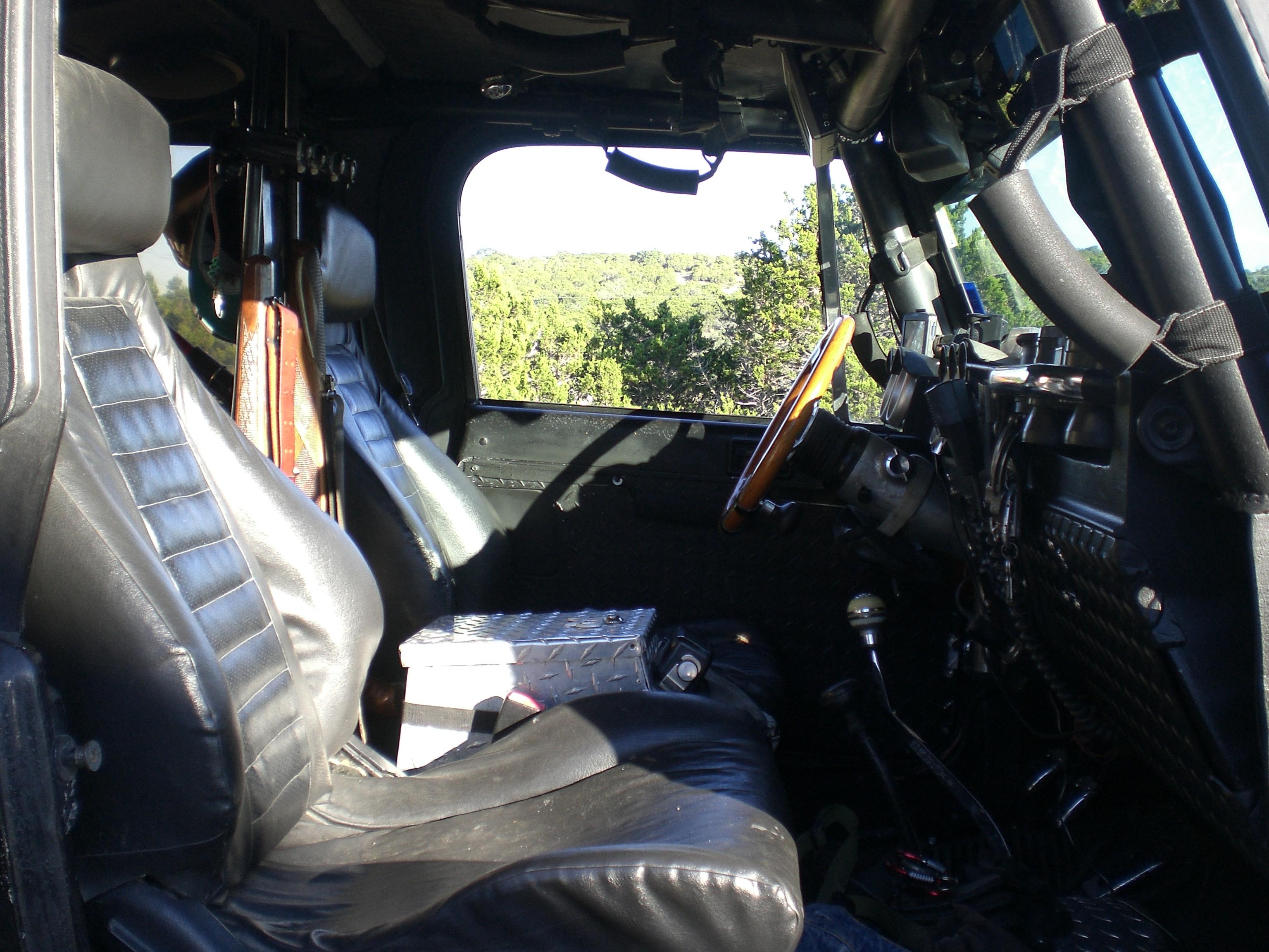

I bought these seats from a junkyard. It had a torn outer lumbar cushion and upholstery on the driver side and the stitches on the passenger side are coming apart. I don't remember what car it was, but it was a 2 seater sports car. My lovely wife helped me re-upholster both seats. The Material is special ordered from a local upholstery shop. Its the same upholstery found on the GMC Yukon Dennali. The Cost for the Material was $200.00, Junkyard seats $50.00/ Pair, Labor , Priceless. I custom built the lower frames for the CJ7 Body.

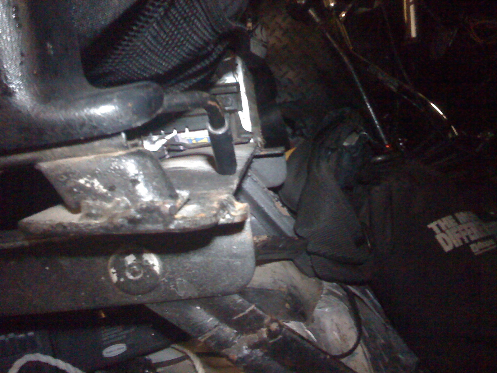

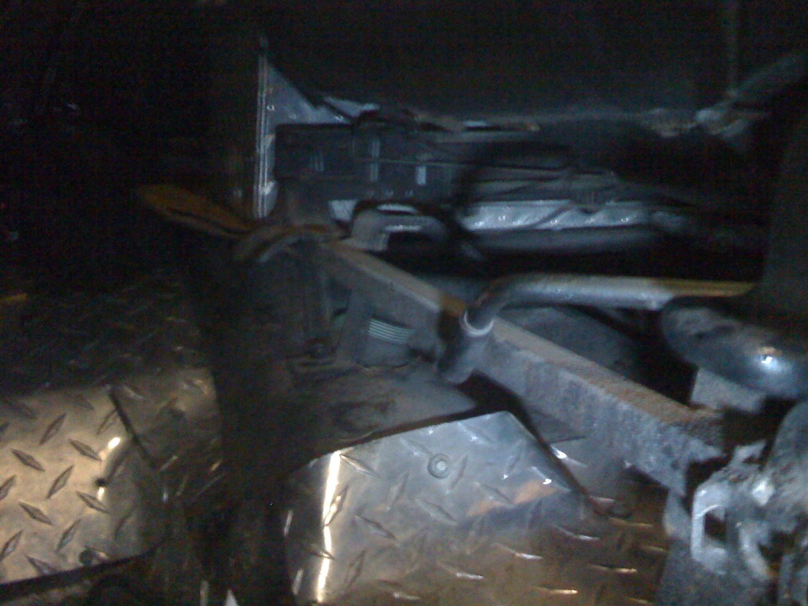

I've re-used the lower frame and built a new square frame for the seat slider brackets. It's hard to see in the pic. I had to drive my Jeep in the building to keep it from getting pummled by hail. We are getting hit hard with this storm.
