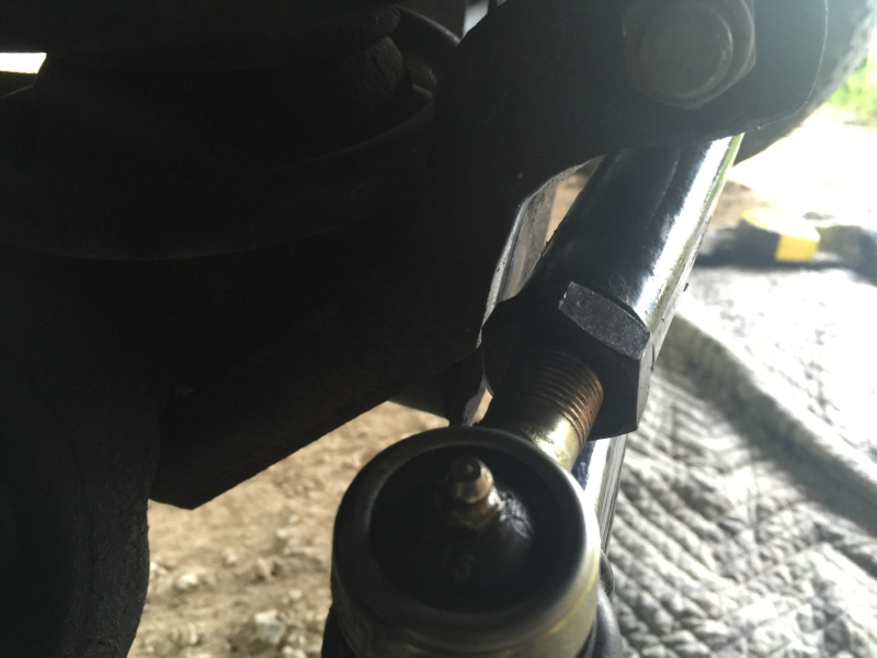

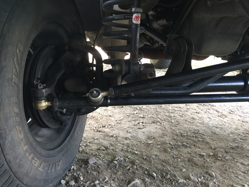

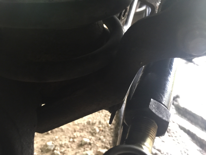

image-3054929221.jpg. Before

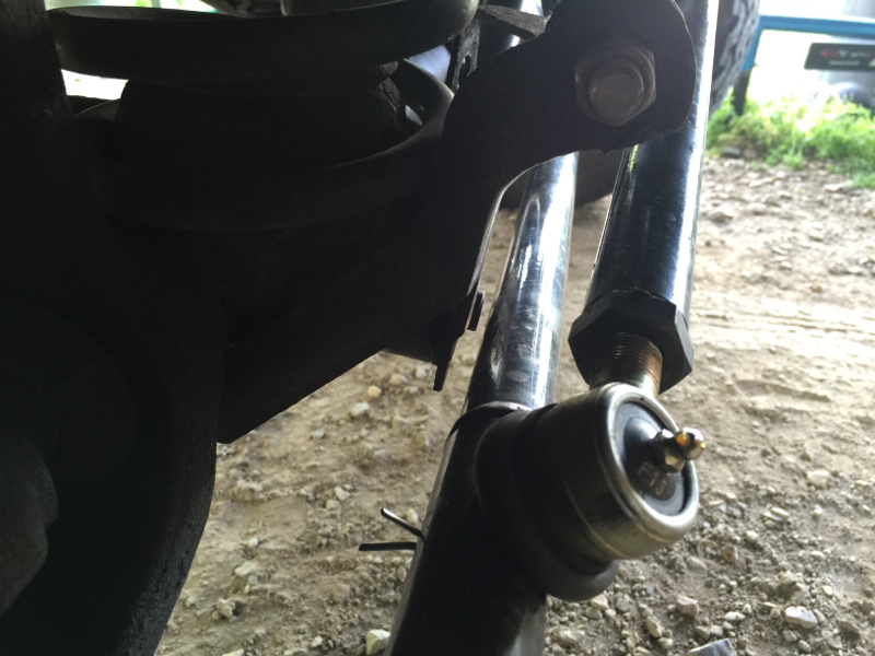

After

So finally adjusted my steering for the last time, turns almost as much as stock. Tie rod rubs just a touch on the new replacement bolt for the track bar from Rustys. Feels great, firm. Still think offset tie rods would be better. With that said I give it 5 and 3/4 stars.....
