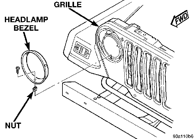

I'm driving a 1998 TJ Wrangler.
This is the first time replacing headlight to my jeep.

HEADLAMP
REMOVAL
  1. Remove the screws that attach the headlamp bezel Headlamp Bezel

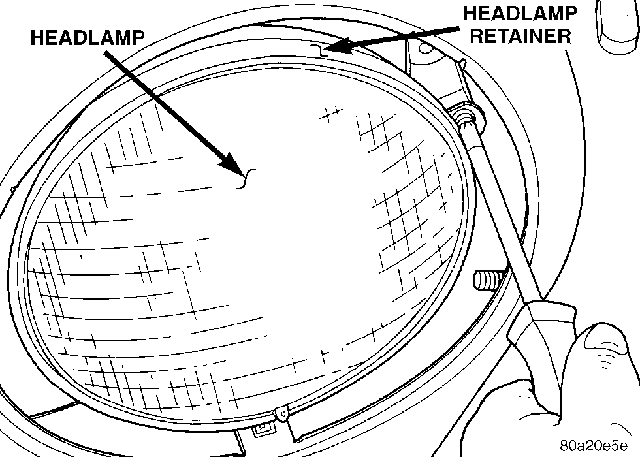

  2. Remove the screws that attach the headlamp retaining ring Headlamp Retaining Ring
  3. Disconnect the headlamp wire harness connector and remove the bulb from the bucket Headlamp Connector

  1. Connect the wire harness connector and position the bulb in the bucket.
  2. Position retaining ring on the headlamp bulb and install screws.
  3. Install the headlamp bezel. Tighten the screws securely.

THanks so much !
HOnestly i did find instuction like this... BUT only for the Grand CHerokee. I found atlest 45+ great references for the Cherokee (I wonder why thats the popular one on google and not TJ Wrangler) when i specificly typed "Removing TJ Wrangler headlights"
anyway
THANK YOU
FOr both the typed and the pictured instructions. Its exactly what i wanted.
