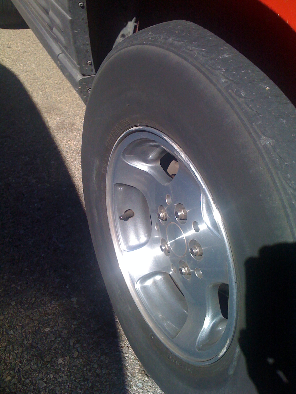

2. I scraped against the curb one rainy day and now my right front rim has a scrape along the outer part. Unless i need to post pictures to show how bad it is, what can I do to make it less noticeable?
Ouch! Alloy wheels, I assume? Post some pictures if you have time, a good look at the damage will help us help you better :D
But as it is, if the scrape is in the lip of the wheel, you can start by sanding the affected area smooth. There will still be a chunk missing, but at least it will be a smoother chunk. The only other option is to replace the wheel with a matching one from a junkyard, if you use stock wheels.

I appreciate your help. I will take a picture of my wheel (which is the stock aluminum wheel) and send it to you in a message.

Here is the photo, taken with my iPhone.
That's nothing. Half the people I know have minor scrapes like those on their wheels. I thought you had a big chunk missing or something. If you really want to fix it, the only good way is to replace the wheel. If you want to make it look a little better, get some 300-grit sandpaper and sand the affected area flat, then sand again with 2000-grit to make it smooth. Won't be perfect but that's as good as it's going to get.
Also, you might want to invest in some new tires; that one looks quite bald.

Thanks for the help.
