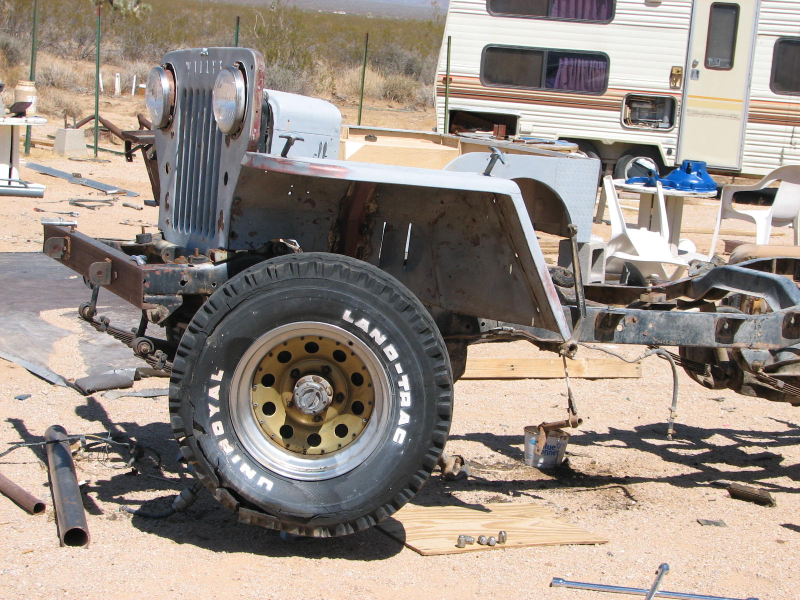

Lets see some pics of those suckers!!!! Then maybe we can give you some good advice! :p
this is the BEST of the bunch. (Should I get new tires too? still some tread left:lol::lol::lol:)

Uh, wheels? I didnt notice any wheels in that pic.........all I see is beautiful flat fender, and a "bug" grille! :shades:

I think that jeep has bigger problems than wheel color. :D
Well, that it does, BUT the tub now sports a new fender and floor, the transmission/tc has been rebuilt. it soon will sport a rebuilt F134 Hurricane, (watch out, 72 raw Willys HP) new brake parts are on the way, and in a pay day or two, I'll have seats coming and new gages. I also, in a few pay days be ordering lock-right lockers, not to mention the wire harness, shocks and bushings. I need to get wheels under this thing to move it around and I don't want to mount and dismount tires 3 or 4 times. :shades:
