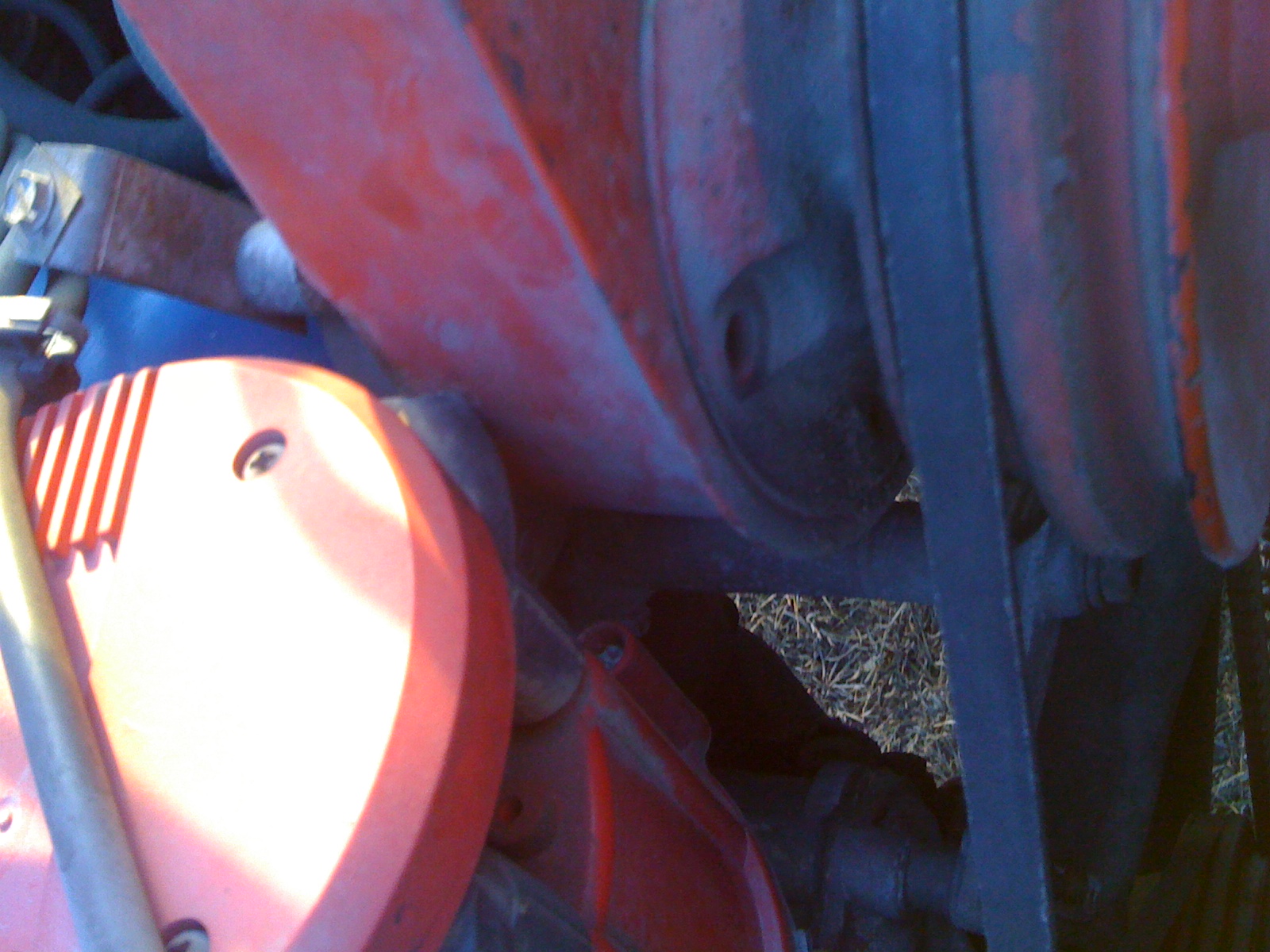

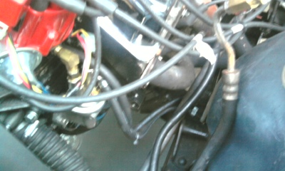

no i know it fits perfectly in the holes but the pump is in the way of the bracket. here's a picture so you see what I'm looking at.

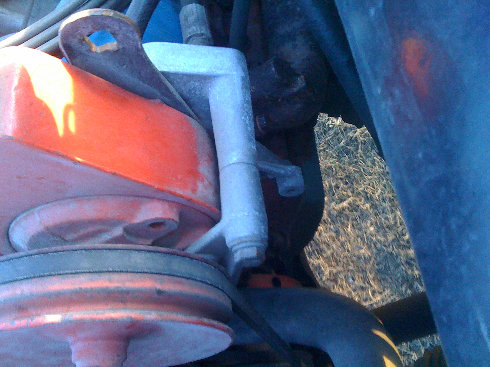

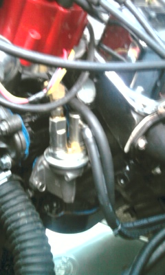

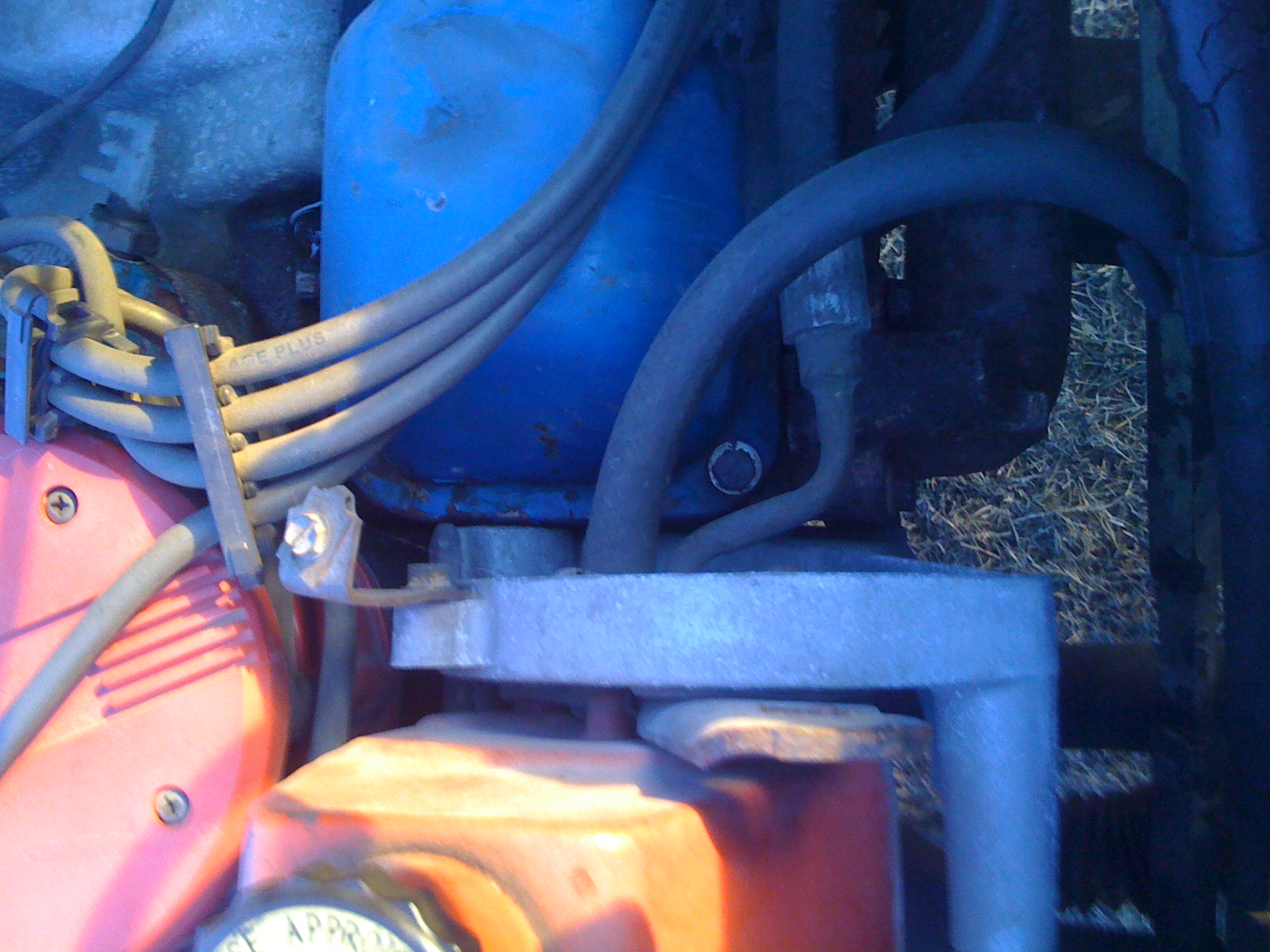

Sorry the pics didnt turn out that great. If you want me to get a better shot let me know.

304 fuel pump, obtain the 360 power steering pump brackets you can still buy those new, or make your own! Good luck to you!
idk if I still have the old 304 pump, i think i sold it along with the engine. I might just have to bite the bullet and get an electric pump. :piratenanner: there goes food for 3 weeks lol jk
You can get a decent electric fuel pump from Napa for around 30 smacks and last you quite awhile. You can use the current manual fuel pump to make a template for a cover on the fuel pump mounting hole on the block. I used a 1/4 in steel plate.
