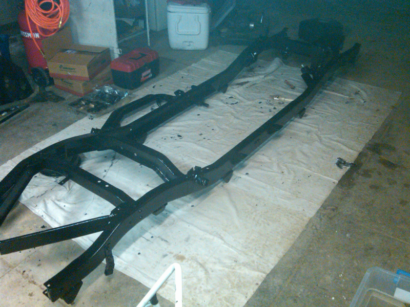

I used POR-15 on my frame and top coated with POR-15's Chassis Coat Black top coat. I sand blasted it all first. Came out beautifully!
