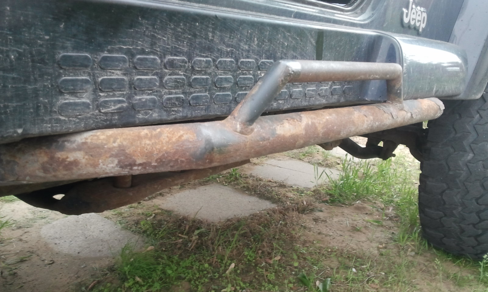

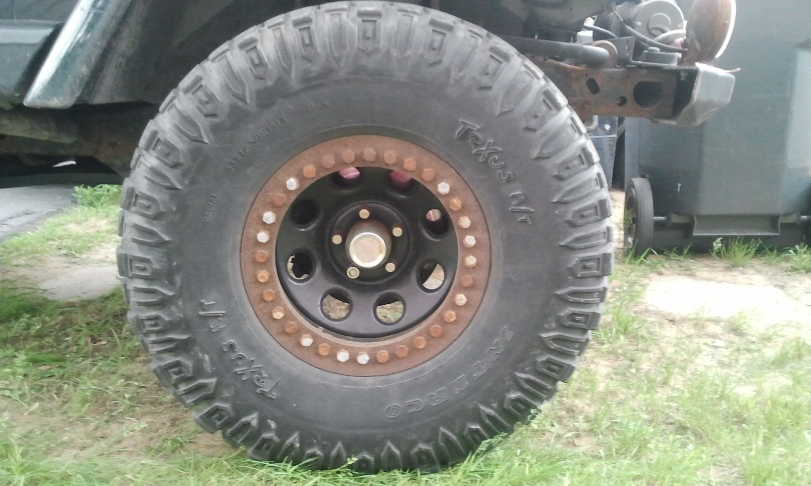

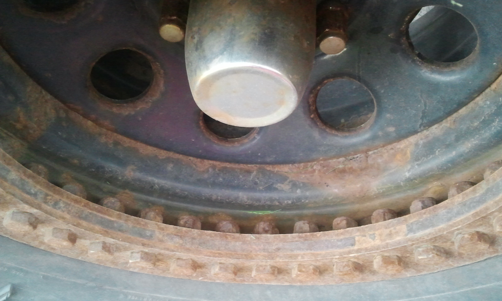

Hey was wondering if anyone has the time to give me a run down, well more of a step-by-step, on how to PROPERLY use POR15 on my Beadlocks? No one wants to touch them, so Im doing it myself! Also I want to use it on my nerf bars and bumpers. Some folks are saying get rid of all the rust, others say leave it. I got the "Starter Kit" that has the cleaner and the prep, as well as 2 cans of semi gloss blk.

Number 1 most important tip - wear gloves and be careful not to get it on your skin. It'll last as long as you do.
I'm a fan of POR15, but remember that it is UV sensitive, and technically should be top coated with something. Sun won't hurt it, but it'll change the color.
I usually sand the rust down so that the surface is smooth enough to make me happy. Don't worry about removing all the rust, just go for a uniform surface then paint away. It does tend to leave brush strokes, so you may want to dilute it and spray.
I've attached the general POR15 instructions
I'd sand [ or wire brush ] the places your going to see so that it'll look good and smooth when your done. A cupped wire brush on a drill or grinder will probably save you some time and effort [ use safety glasses ]. The places you can't see I'd hit 'em a lick and a promise, it'll stop the rust anyway as long as it's fairly clean and free of grease when you put it on. A friend put it on the frame of a 50 Chevy truck and didn't go to much trouble removing the rust and it's still not come back after 6 years. Like mentioned above, it does need to be top coated for UV protection.
