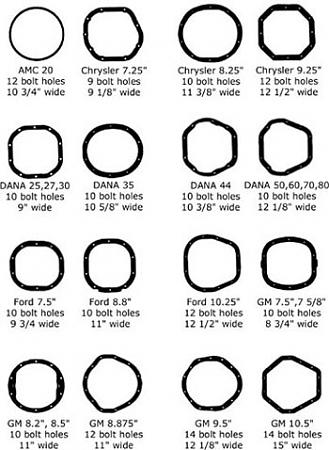

If your jeep is stock you will have the Dana 30 front axel and the dreaded AMC 20 rear. The AMC 20 comes with two piece axels that allow the hub flange to spin and fail leaving you stranded right where you sit. If the axels have not been changed to one piece units, do it now. Take a look at this:
http://www.jeeptech.com/axle/amc20.html
The Dana 30 front is OK but not the best either. Upgrade it and forget it unless you are going big.
http://www.jeeptech.com/axle/d30.html
http://www.offroaders.com/directory/info/dana30.htm
