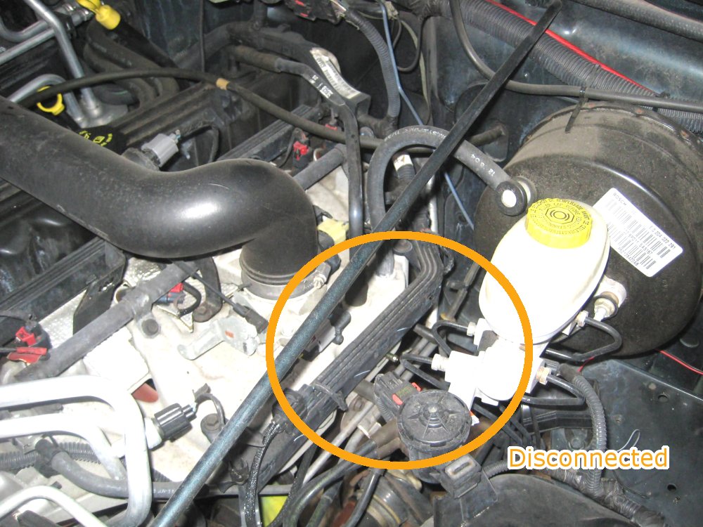

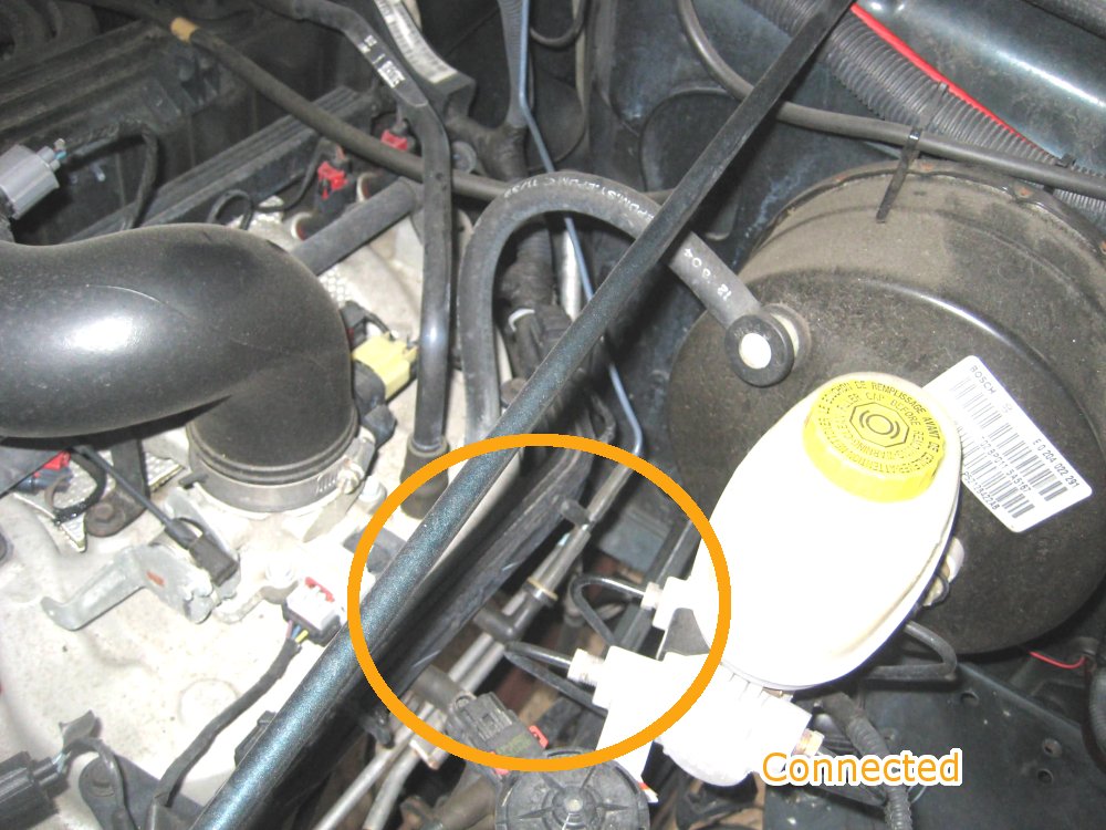

Wrangler Defroster problem fixed
OK, so I"ve fixed my defroster problem. It turns out that the air selectors in Wranglers are powered by engine vacum, and one of my tubes had popped off. I've found it, reconnected, and everything works.
