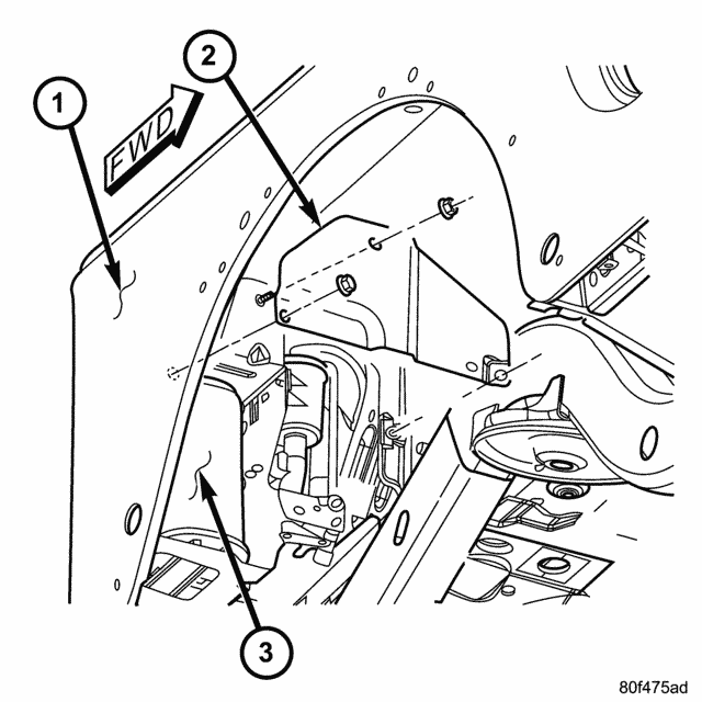

The leak detection pump and the evap. canister is located on the right rear(passenger) fender wheel behind the tail lamp. Check all the vacuum lines for cracks or loose fitting. Follow these lines to the front of the veh. up to the engine compartment and replace the cracked and worn vac.lines.
