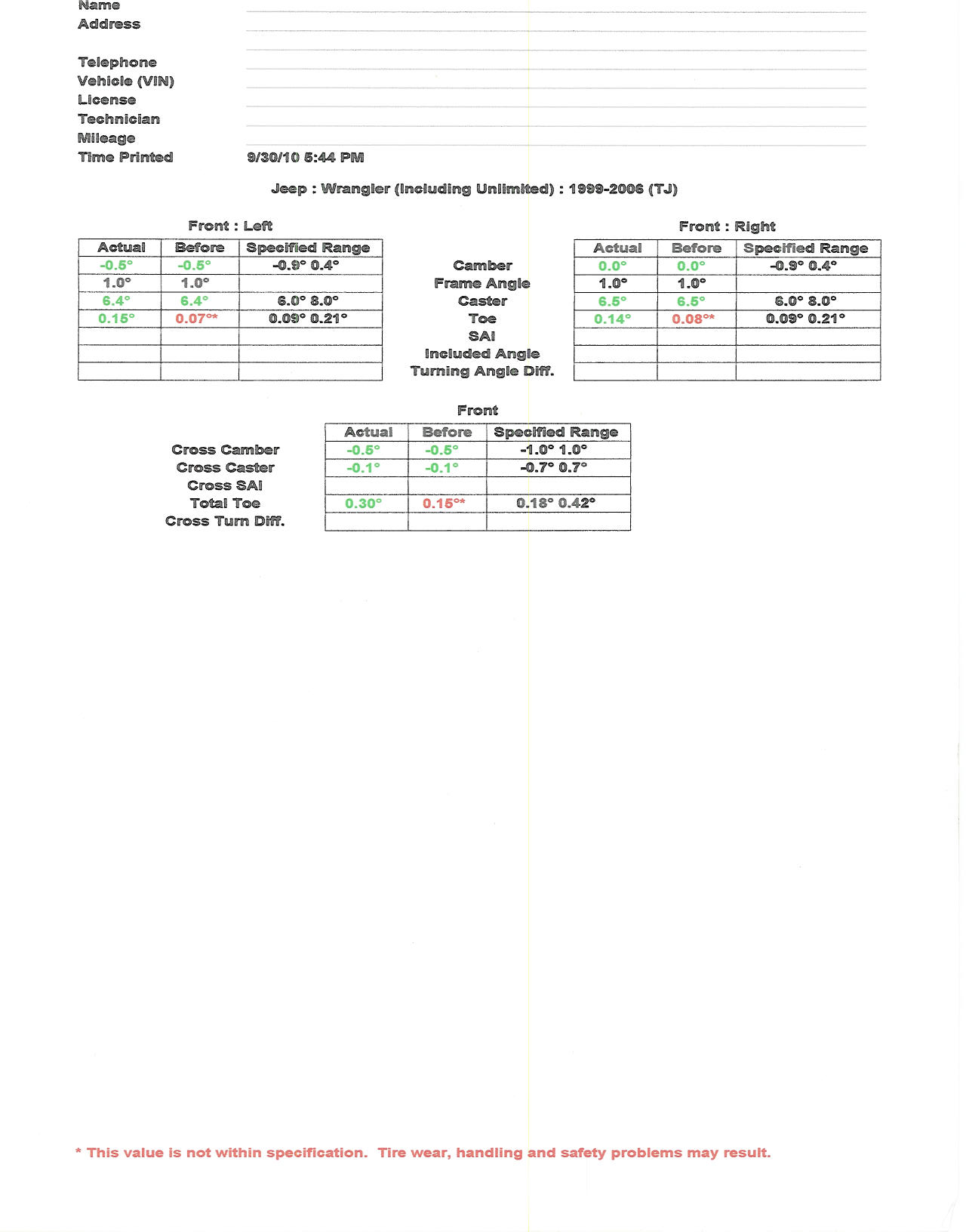

I had it aligned after the new tires were installed. I took it today to have the tires rebalanced, and they found that one of the wheel weights fell off in the 4 miles between the shop and my house :rolleyes: so they added another 3.5 oz the the rear pass wheel.

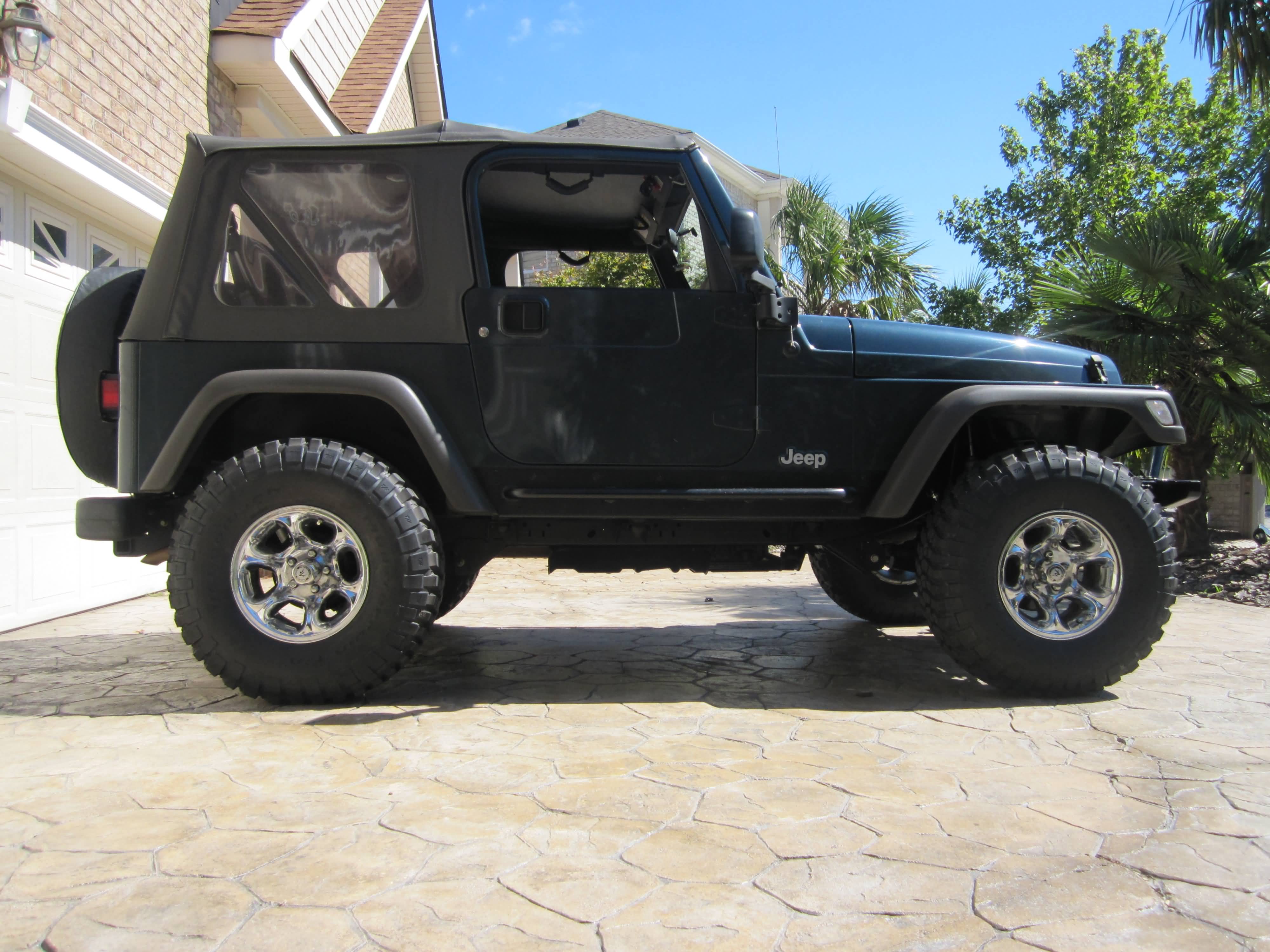

Some of the looseness will be the type of tire (MT with less rubber on the ground) and the fact you have more sidewall than before. The shake is a tire balance issue, I'd recommend using a tire shop that can check road force of each tire and place it on the jeep accordingly.

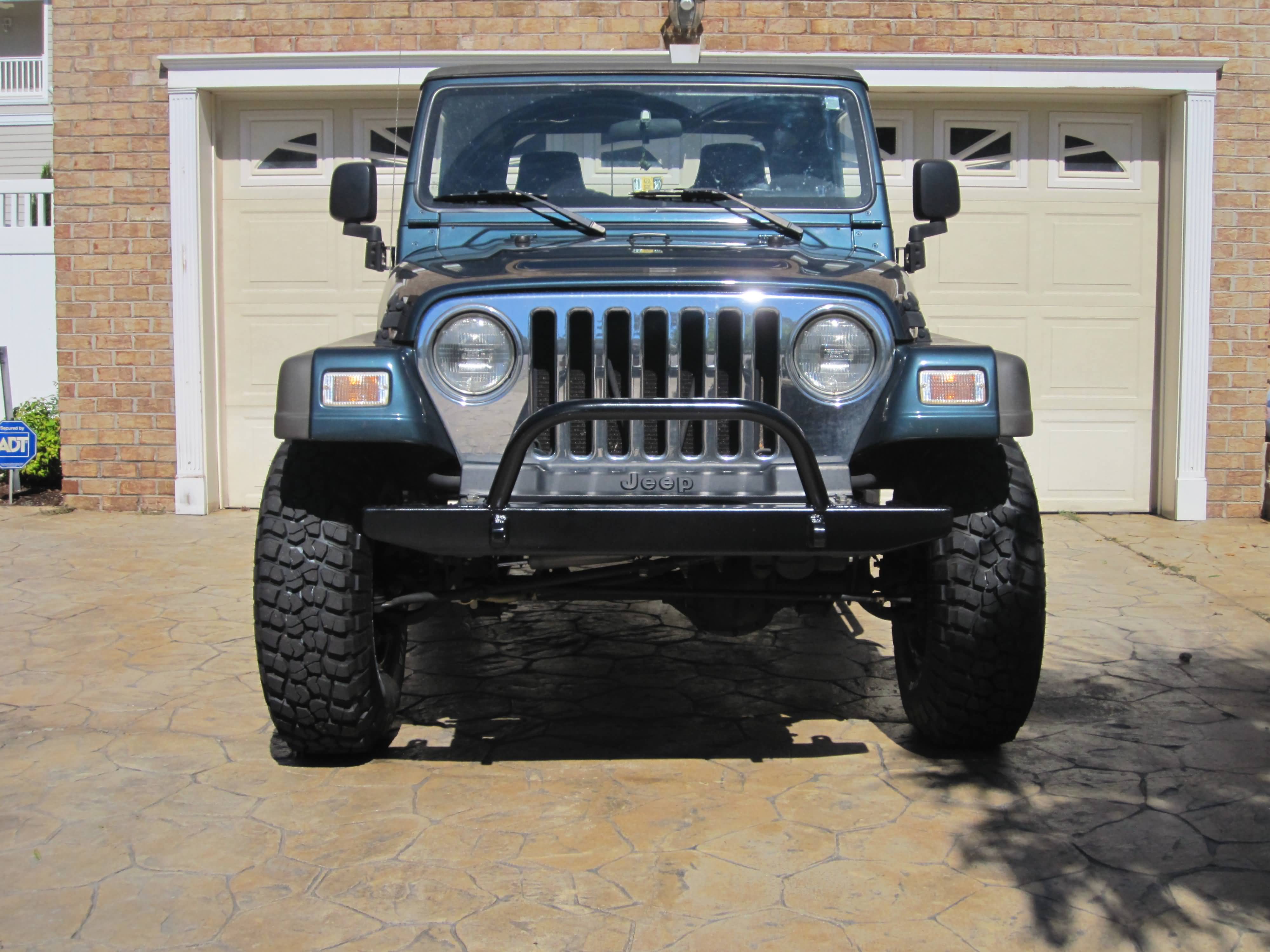

Have you posted any pics of your jeep with the new 33's? I'm still leaning towards a 3" lift with 33's but curious to see how it looks with 2.5.

I'm going for something like this Jeep TJ Suspension Lift. A 2.5" suspension and a 1.25" body lift. I think it will end up just right.

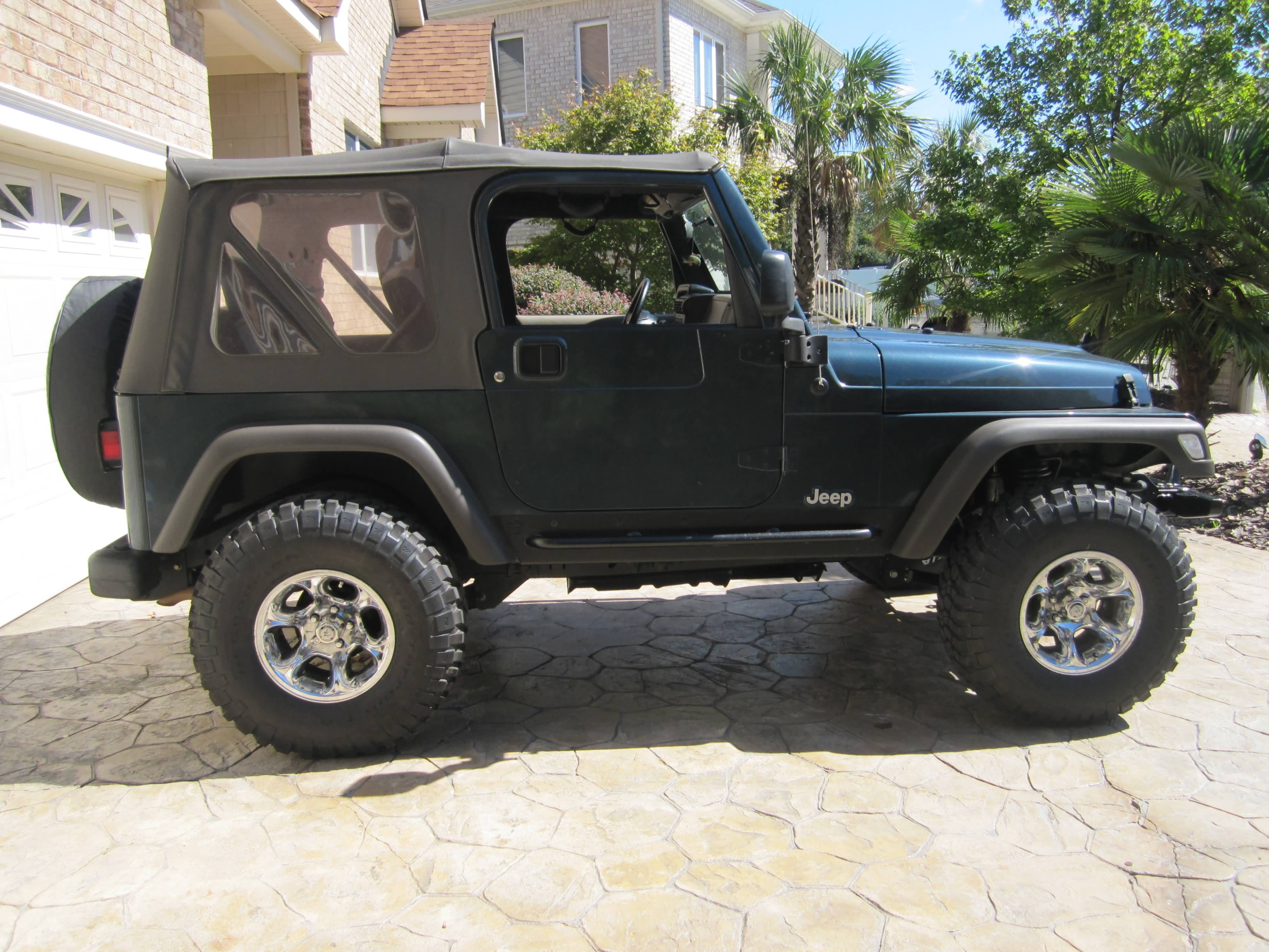

these are BFG KM2 33x10.5 with a 2.5" lift (and no body lift)
