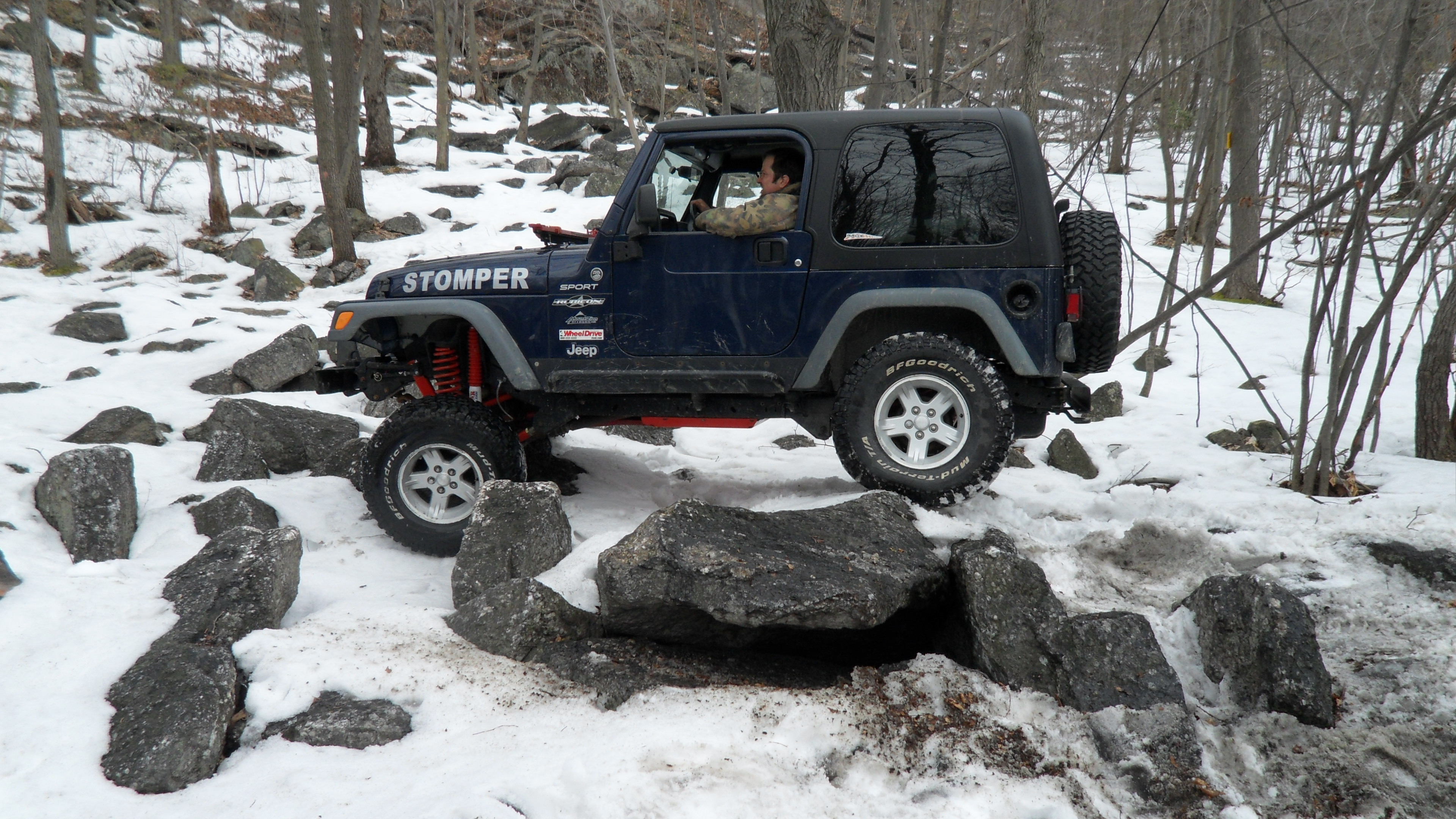

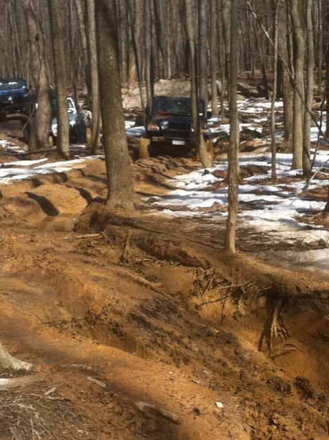

I have a remarkably similar plan to yours - My '06 TJ just got the 4" lift treatment back in November. I have a short arm kit for now but will eventually upgrade to long arm. I also have 32" tires right now (BFG KM1s). I was originally going to go with 33s but am now seriously considering throwing on some tube fenders and running 35s (I have a 1" body lift which will help clear the tires as well). I was originally considering the Super 30 kit but I think I would rather swap out the 30 front for a 44 front if I'm going with 35s (and I want OX lockers). I also have the 44 rear.
You can check out my build here: http://www.jeepz.com/forum/jeep-builds/31221-jason4x4s-2006-tj-project.html
