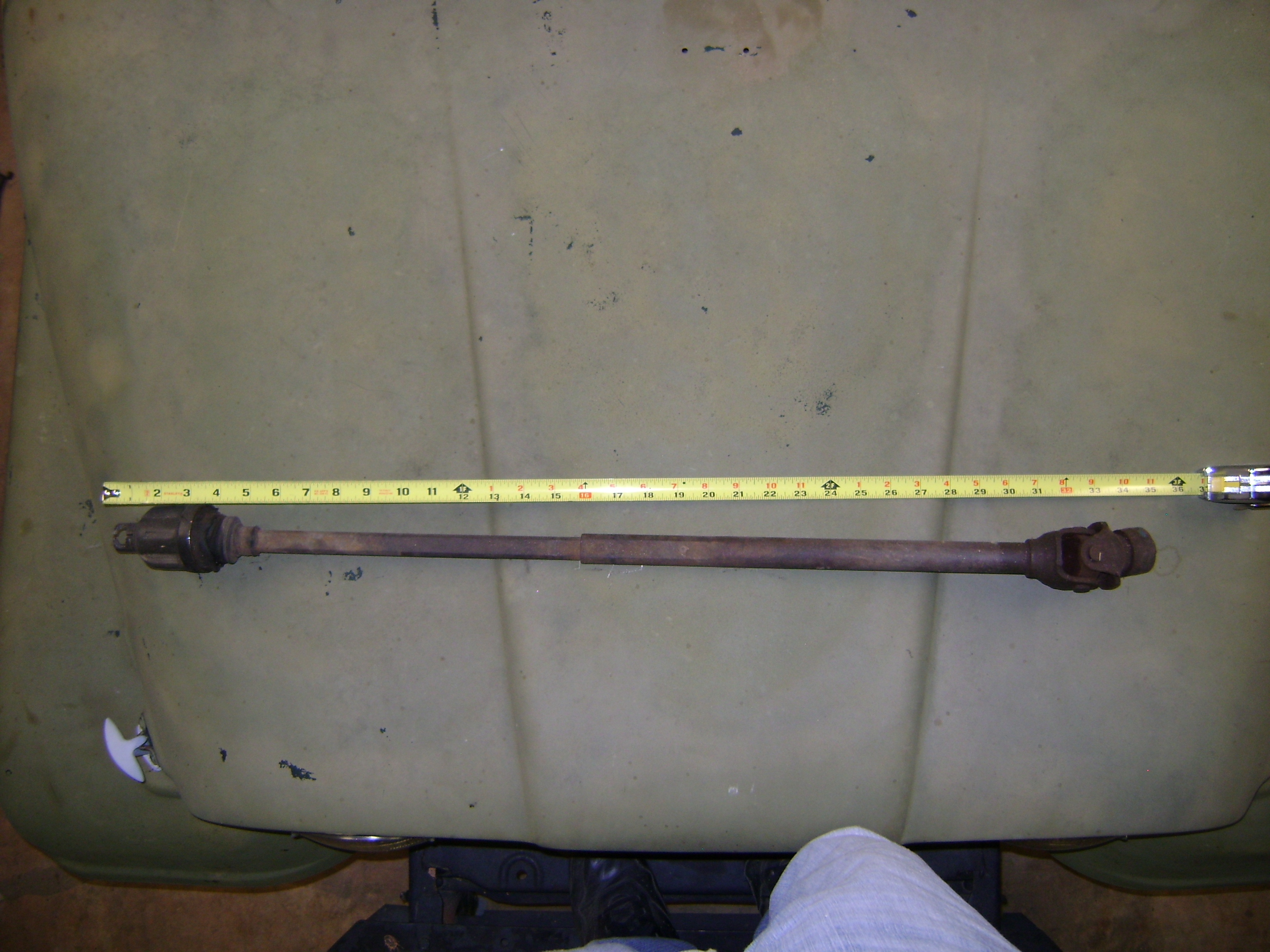

Mine came out of my 78 CJ5, no power steering. It is in need of a new of rebuilding.

Let me know if you want a picture of it.

Took a picture with a tape measure beside it.
Hopefully this will help.
If you can use it, I'll be glad to ship it to you.
It does have play in the knuckle joint, not real bad. The guy I bought my Jeep from, already had a real good spare, so I stuck it on.
