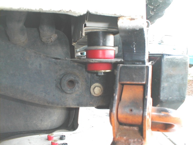

4. Get a body lift. This is probably the best solution to your problem. A body lift raises the body of your Jeep (the colored / painted portion) off the frame (the black "skeleton" of your Jeep). This is done by just adding spacers (rubber washers) between your body and frame. Since the body is an inch or two higher, and the frame is the same your wheels (attached to the frame) will have an extra inch or two from the body.

In the picture, imagine the red body mounts as being stock, and the black washer / puck as being a one inch body lift. The highest body lift I'd recommend would be 2" (for safety reasons), but you can find higher.
