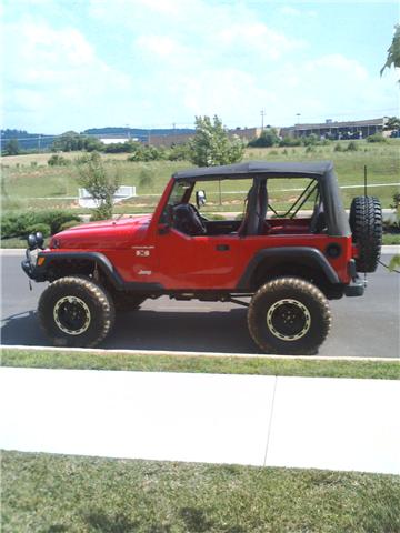

i managed my to trade my way into an 02 TJ. it has a six in fabtech long arm kit, it has super 35, super 30, arbs front and rear. i absolutely stole this thing. ive got 7800 in it! :) i ve got a couple of questions. ive never had a long arm lift or arbs before, so i was wondering if there was any type of maintenance i should be doing besides just greasing the lift. thanks. also it has not ac and would like to put it on. anyone got a wreck laying around or advice. thanks oh one more question. the bumpstops on this thing are enormous like six inches. can i take these off, what is it protecting?

Careful wheeling 35" tires on those small axles, IMO they are a little on the light side for 35's. For a DD they would be fine.
BTW really nice lookin Jeep you got there.
it has a super 30 and 35 kit. hope that will hold up, but im not too heavy on the skinny pedal! most of the time.:D thanks for the advice on the arbs. i will take some pics of the bump stops when i get home. they look really big to me and i noticed the tire doesnt travel all the way to the fender. i guess thats the reason for it:???:
if you swap axles, you can easily run a 37-38" tire with that lift. Also I would perhaps try to sell those springs for something more in the 3-3.5" range, lower your height a bit and offer more stability, plus you will get a little cash for them.

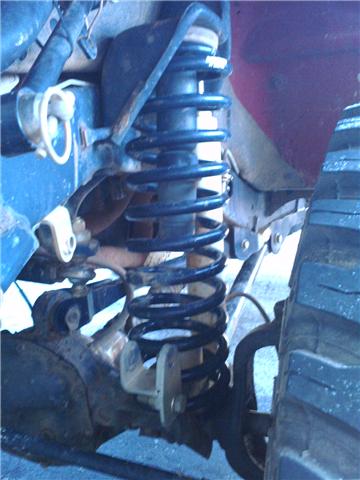

thanks for the advice and compliments. i really like this one. its the best riding jeep iv ever had! :-) i drive it 20 miles one way to work with the swaybar disconnected. here is a picture of the bumpstops. is this normal? they are almost half the spring height. can i remove them or make them smaller?

Yes it is normal. if you articulate the suspension the full cycle of the spring, 1. you will prematurely fatigue the spring, two you will probably unseat the drooping spring and it will pop out.
If you wanted to cut them I say go for it, but I would make sure your coils are captured on both upper and lower buckets.
